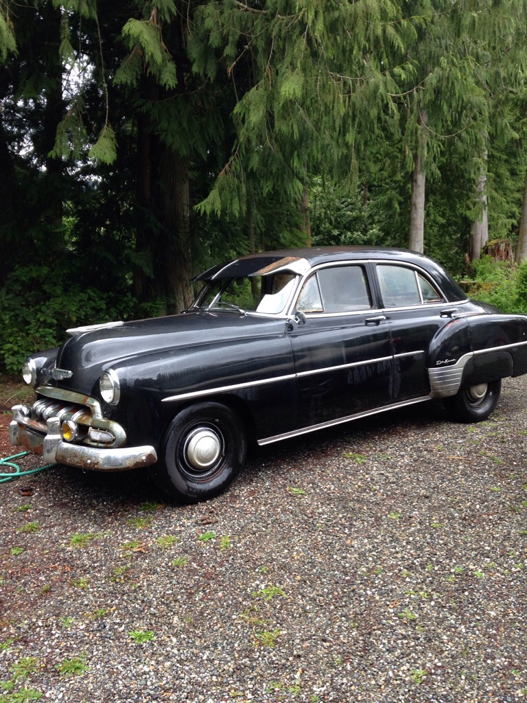

    Nice project, I am getting ready to start on my 52 4 door, and I appreciate your project updates, mine has a bit of rot, but too bad considering it sat in a field in Oregon since 1972. All original and about 80% complete. Runs and drives too! ImageUploadedByH.A.M.B.1399221193.820401.jpg thanks for your posts!!
