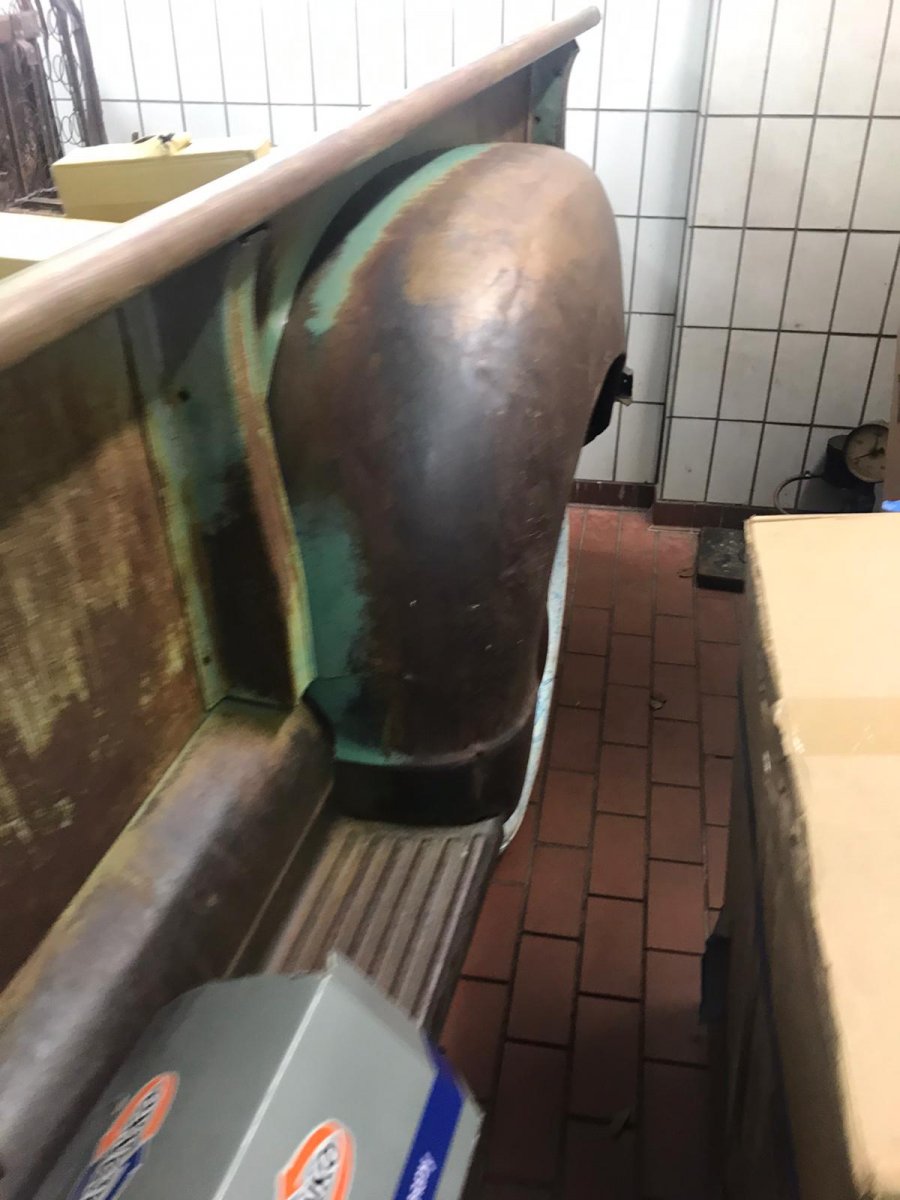

    It seems like I did "it" again and although I have run out of space a long time ago I got myself another project- A pretty solid sun burnt but unmolested 51 Chevy truck with a cracked 216ci stovebolt. I was thinking about replacing the 216 with a 235 ( which I don´t have yet) or a 283 ( which I have a couple of), keep the stock transmission ( maybe replace it with a 3 speed OD out of a 55 Chevy 210 that I also have) and maybe put more highway friendly gears in the rearend... Before I start making guessitmates I would like to learn from you guys abou the ins and outs of the AD trucks....what gear ratio a 3100 came with from the factory for example. I think maybe 4.11-5.13 would be in the ballpark, right?
    Did the AD trucks have an open drivetrain or the same torque tube setup as the p*** cars?
    I have an early 60s 283 from a stick shift car ( along with flywheel/ clutch/ bellhousing /etc) , would that setup be likely to bolt up to the stock 51 3 speed box?
    If it turned out to be a torque tube setup I´d probably think about swapping in another rearend , replacing the closed drive trans with the 3 speed OD I have and go with the 283, unless I can find a reasonably priced 235 that does not need a ton of work. The truck wont be lowered, it will mostly remain what it is, an old solid but well worn work truck with a little highway friendlier habits.
    What would be your approach?

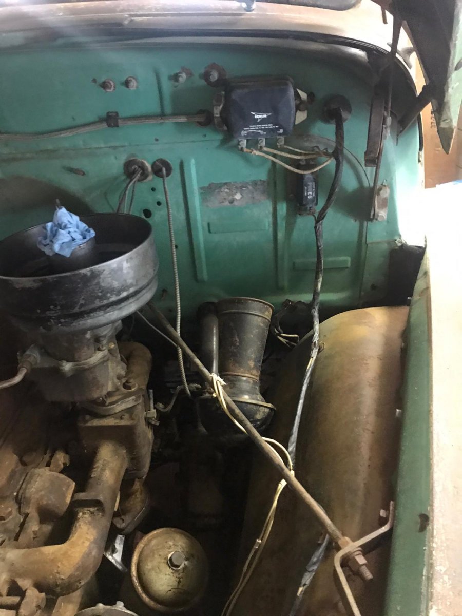

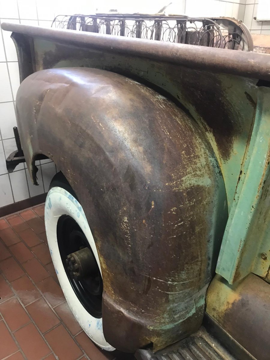

    I know, this thread is worthless without pichers...
    Sorry I can't provide a total view but the seller only sent me tons of detail shots. Dr side floor pan needs to be replaced , but the repair panels are already there.

    Good point Squirrel... I am seeing at least a 3200 with the longer bed as shown in one pic.

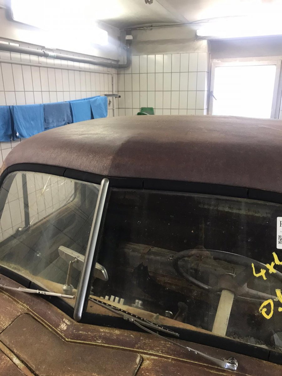

    Looks like floor shift. The picture through the windshield shows no column shift and you can see the knob from the floor shifter.

    The pocket in front of the fender would indicate it is a 3600. 3/4 ton truck. It will still have huck brakes.
    Swap details will be mostly the same, Rear end from factory will be 4:56, or optional 5:11 or so. The frame is slightly heavier material, and the frame is almost straight behind the cab with very little hump over the axle. 1/2 tons have a spread behind the cab, and a larger hump. The 3/4 ton has a heavier axle
    and spindle than the 1/2 tons, 1/2 ton brake kits will not fit. The axles interchange if you want to use
    the 1/2 ton brake kits, they use the same front springs. Body is the same other than bed sides and running boards. Engine and trans were the same, they changed the driveshaft at the carrier to use the open rear end. There are reports of some later rear pumpkins fitting the original rear end, but the
    suggested rear ends are pretty rare, and you would still have the huck brakes. Huck brakes can work ok,
    but replacement drums are rare, expensive if found, and need constant adjustment.

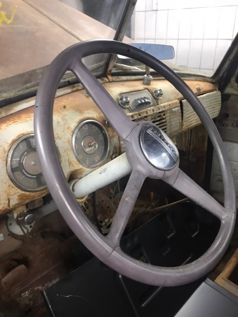

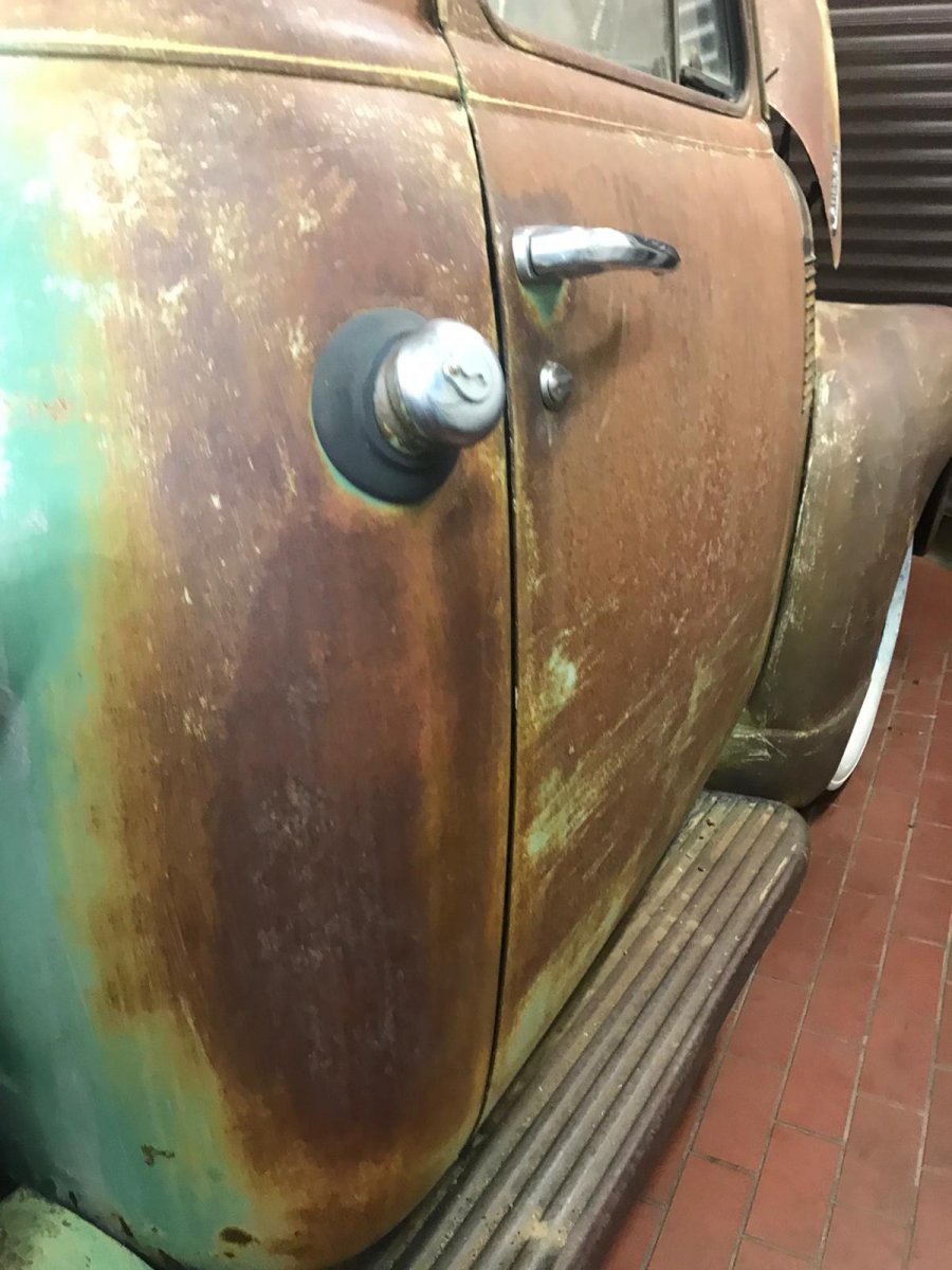

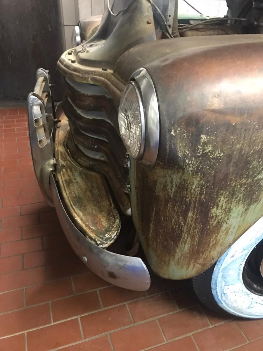

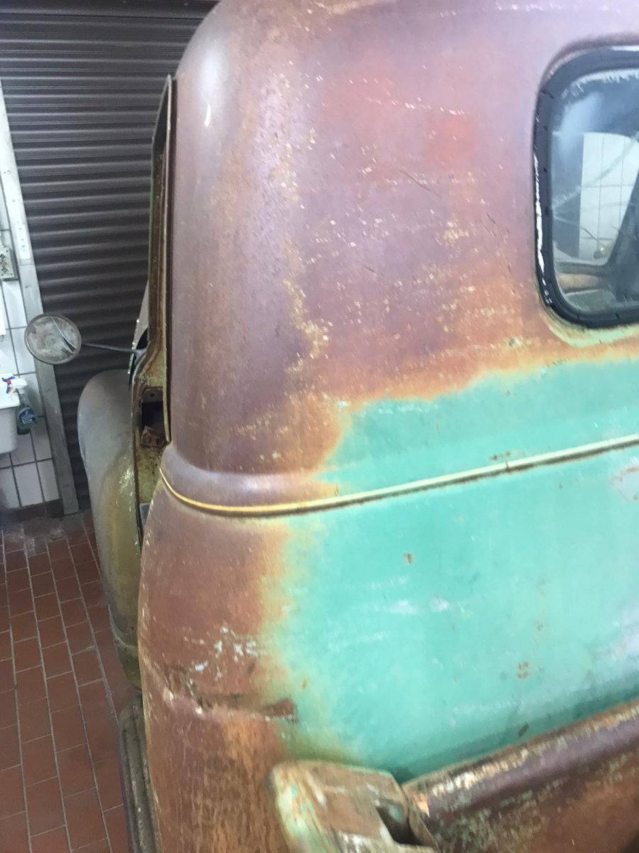

    Wow, guys, you are great! Thanks for all the replies and opinions. It could very well be a 3200 or 3600. I thought it was a 3100. But I´m still learning about the AD trucks. My girlfriend Dani´s 52 Suburban was already clipped and almost FUBAR´ed when we got it, so I have no clue about what the stock AD trucks are about.
    I´m thinking the axles are looking heavier than they would on a 3100 and it does have a floor shifter. There are plenty of wheel studs , that´s for sure, hahahaha

  14. squirrel
    Joined: Sep 23, 2004
    Posts: 60,992
    squirrel
    Can't see lug nuts, but we can we the full floating rear hub. 3600, 3/4 ton.
