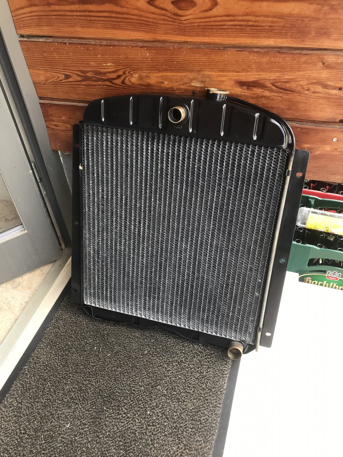

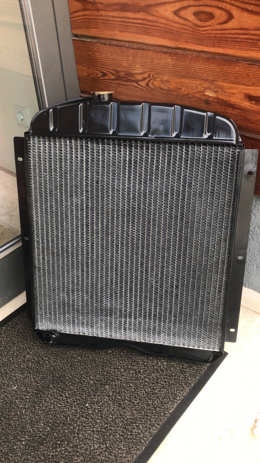

    I also had the stock radiator rebuilt, I‘ll not eat or drink for a couple months now but the rad sure came out nice… I could have used one of these cheap aluminum ones made in youknowwhere but I just can’t stand their looks and how they spring a leak every two months or years . If this lasts another 70 years that‘ll be fine for me,and after that I‘ll figure out something else …

    Getting harder and harder to find any shop to rebuild old radiators here in the States any more. My 50 has the old Harrison radiator in it. No telling how many times it has been tanked and repaired in it's lifetime.

    Dave, I´m glad we still have a radiator guy not far away that cares to do work for guy like us. He recently did a 1940 Plymouth radiator for a friend, and while he is still charging the same amount for his work, the cost for the copper cores surely has skyrocketed.
