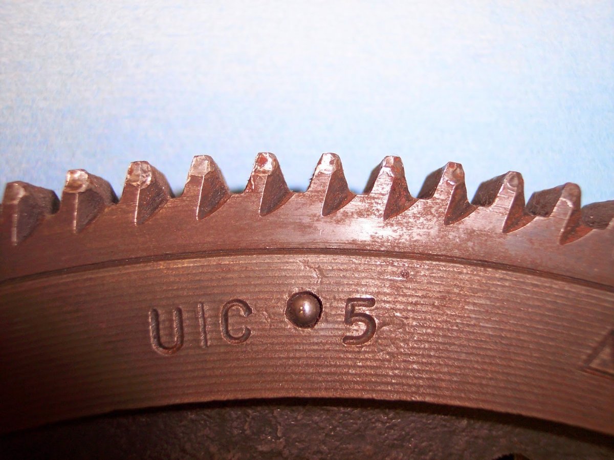

    I'm just wondering if someone put a 12v starter on it, when it really wants a 6v starter, and that's one reason why it never ran again?
    here are some pics from the internet of the two types of flywheels.
    coarse teeth with the bevel is the 6v style, fine teeth with no bevel is the 12v version. You should be able to look in the starter hole, and tell the difference. starter teeth 002.JPG 11 inch clutch flywheel 001.JPG

    HA! Yeah wouldnt that be funny... I guess we'll see! But, the starter I took off definitely had some miles on it. Never can tell with a car like this- one owner, then left on someone's property for over 40 years...

    Forgot to update this- flywheel teeth meshed perfectly to this starter, and engine spins over freely. Time to do some light re-wiring to get it to fire.
