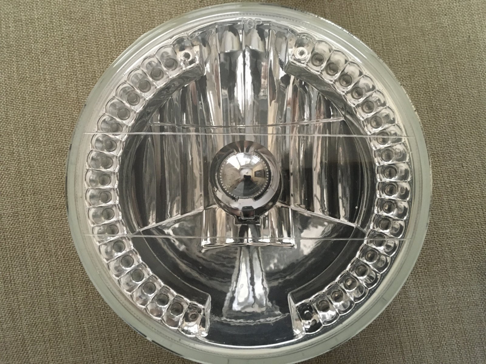

    IMG_3558.jpeg IMG_3557.jpeg IMG_0480.jpeg IMG_0437.jpeg They have aftermarket headlights with the turn signal built inside the headlight itself. Some of the headlights the turn signal is more visible than others. It’s a cleaner look than a motorcycle or aftermarket light hung in the grill, mounted to the bumper, etc. There are also different styles of lens to pick from. Someone will surely say “it’s not traditional” but you asked for alternatives. Examples:

    I don't like those ugly turn signal in the headlights thing and they aren't traditional for hot rods or customs. Even a pair of what look like fog lights mounted on the splash apron but work as turn signals would be better than that nonsense. Screenshot (608).png
