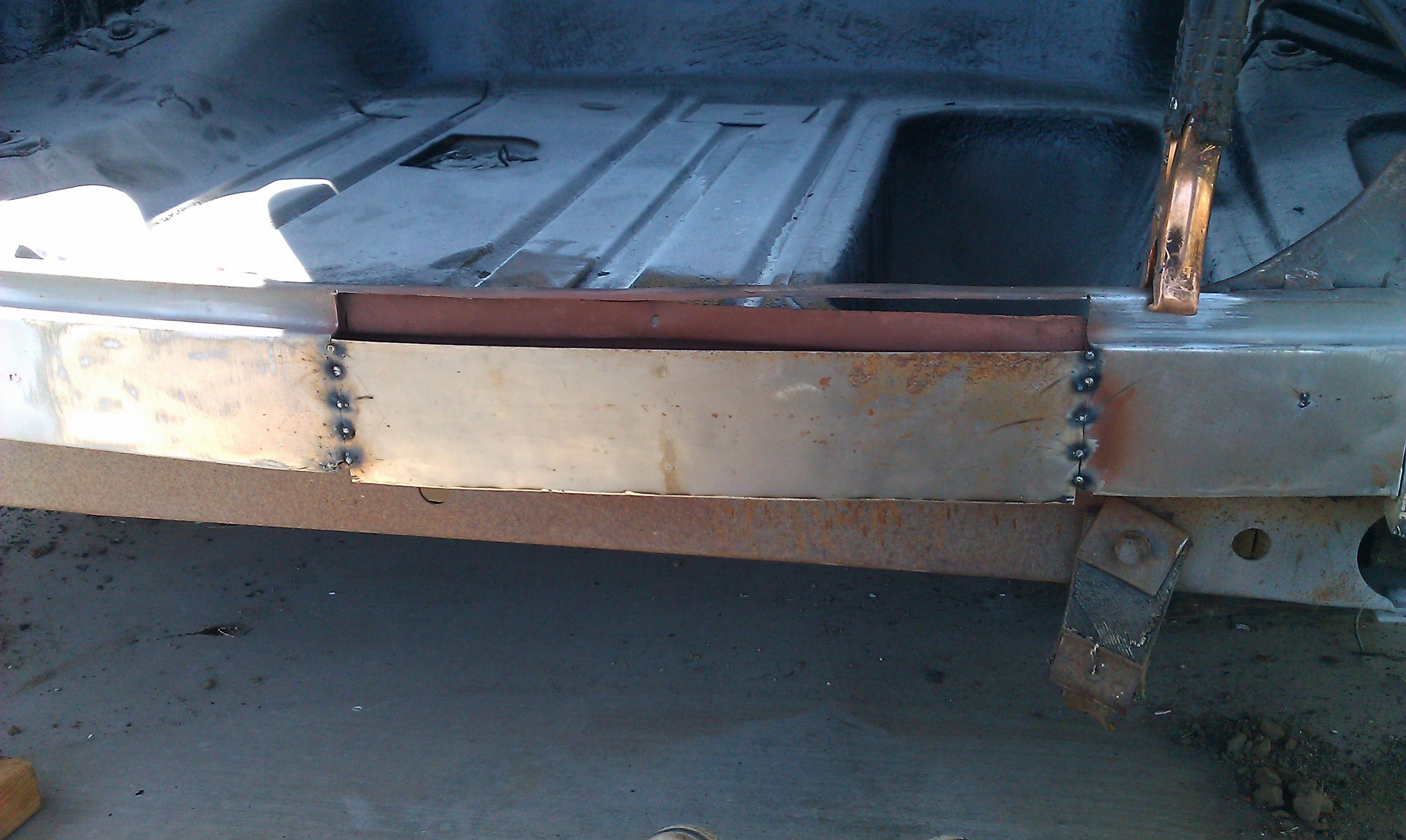

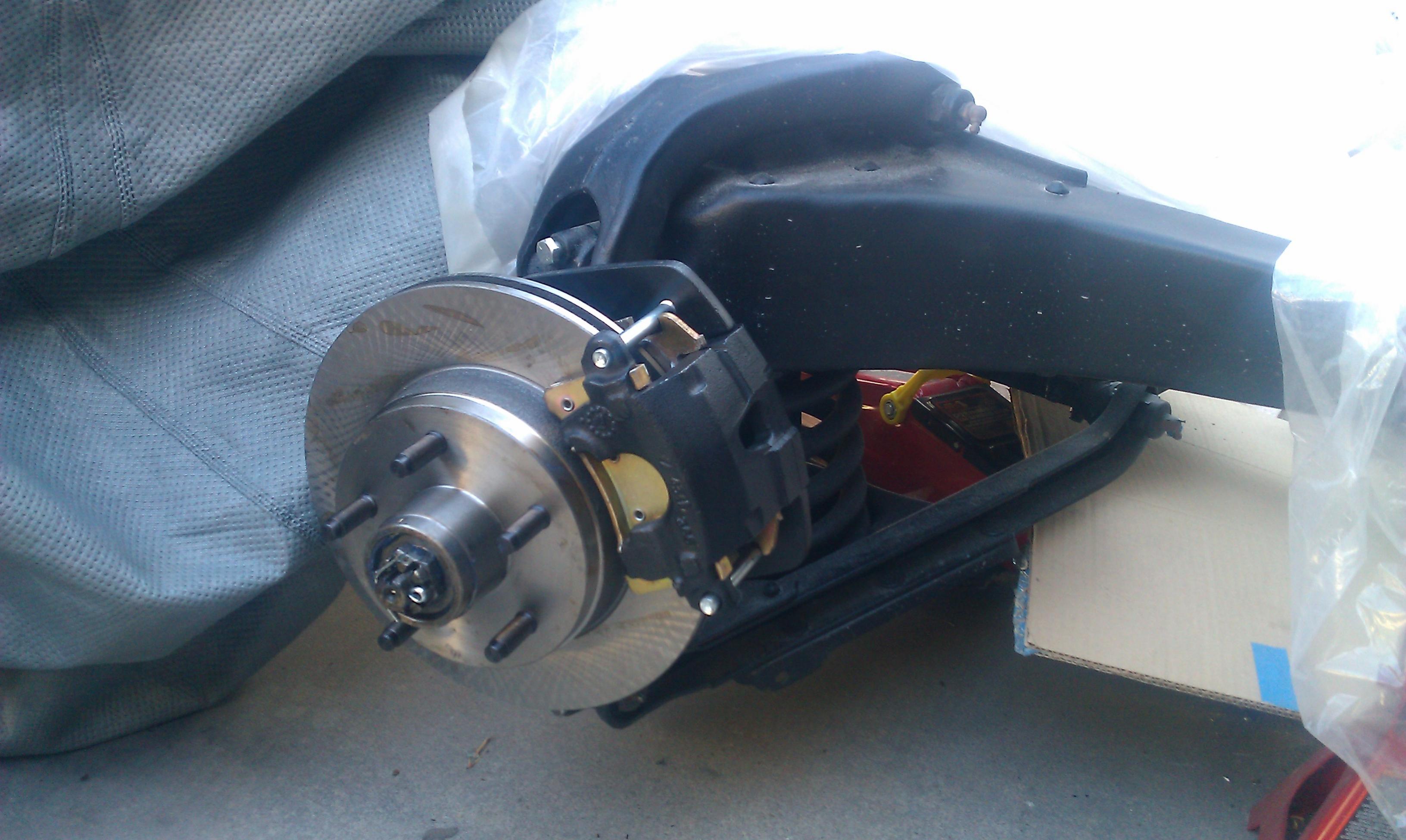

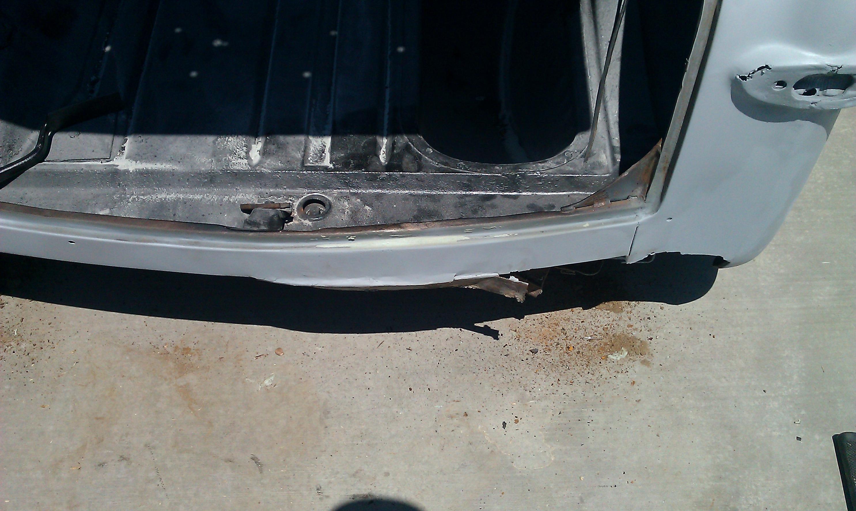

    Fixed the rear apron. Its not perfect, but will work and saved me the money not getting a repop and was way better then that hack job that did it before.

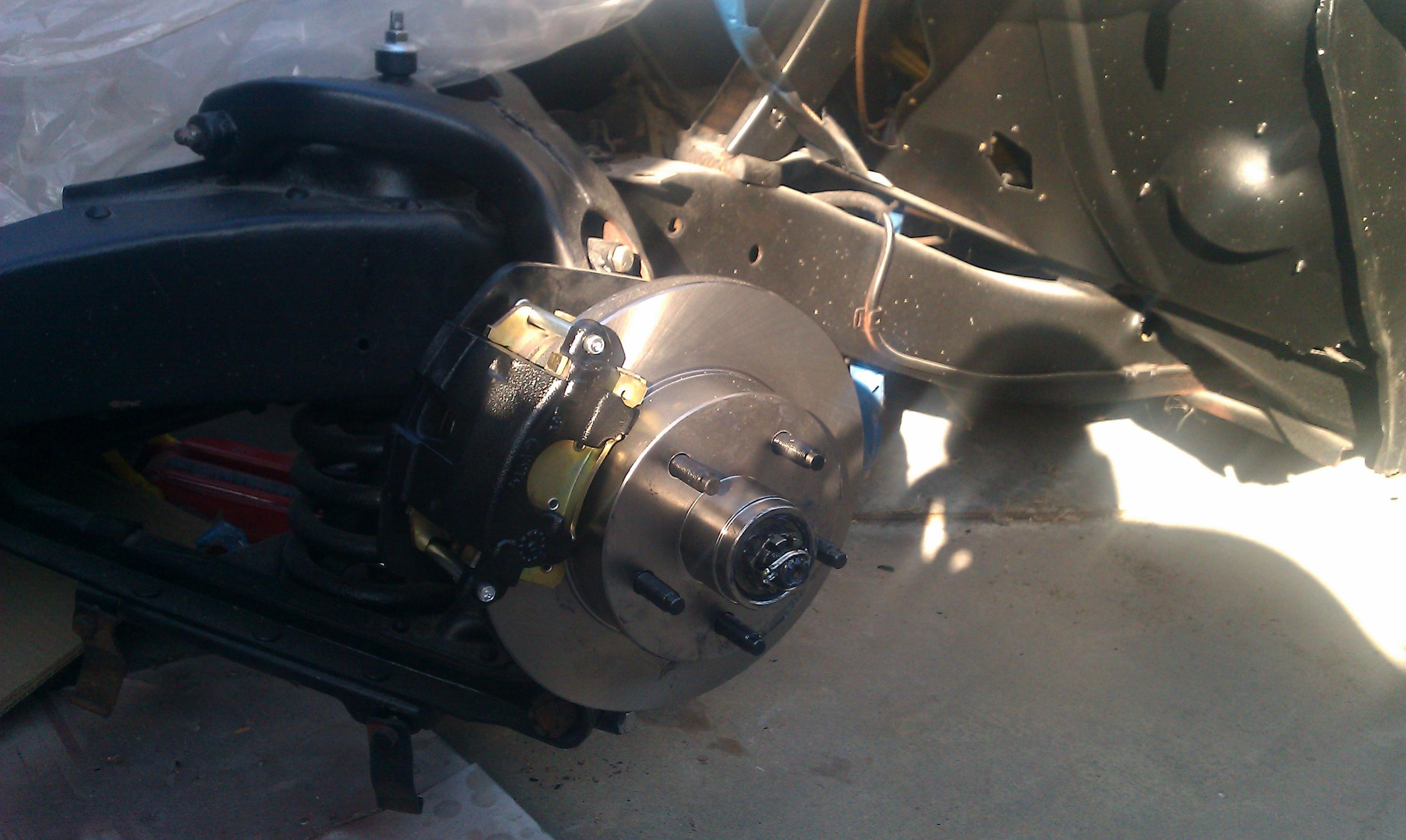

    Installed the disc brakes.

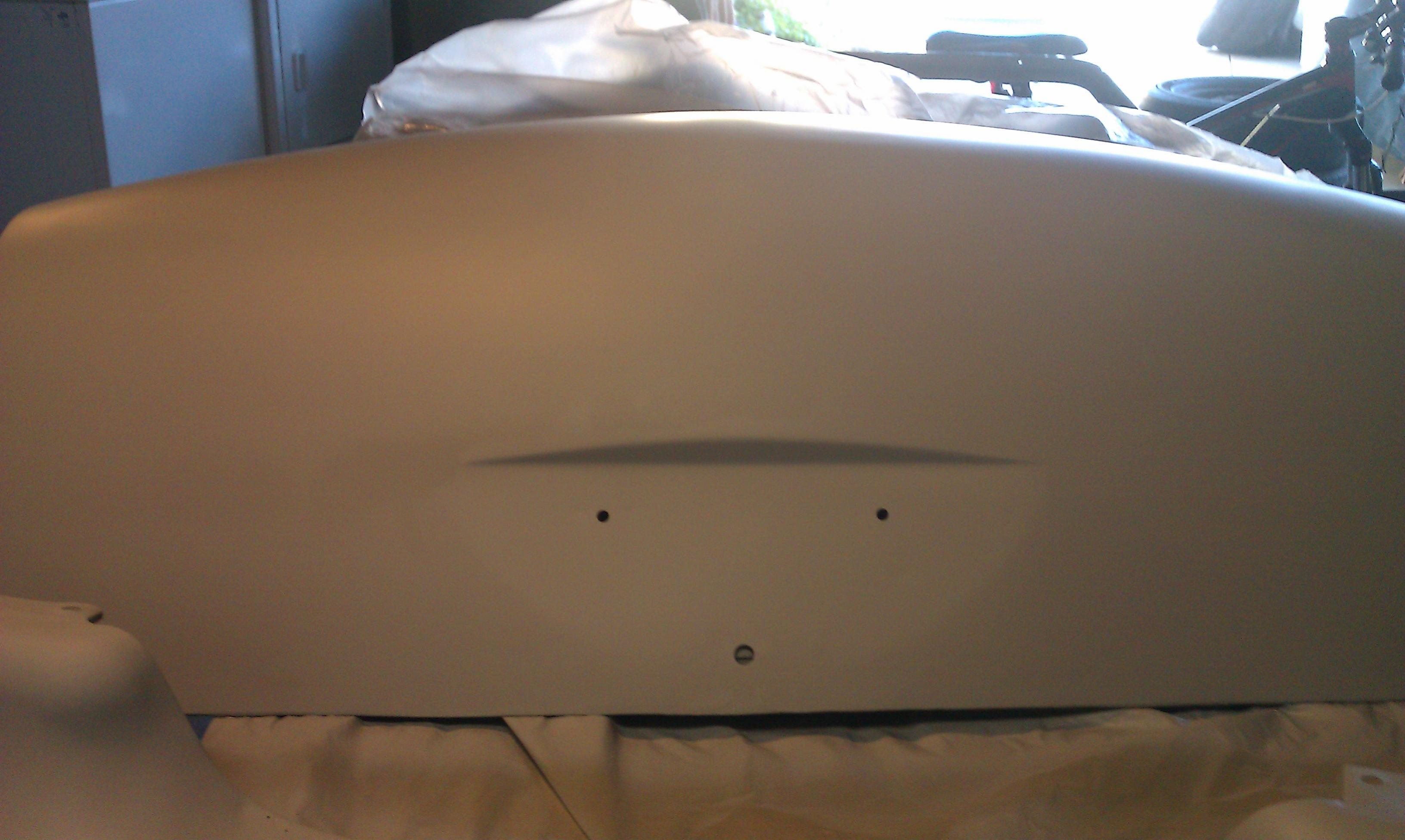

    Since getting my shrinking disc in the mail, I have reworked the decklid, smoothed, etched and high fill primed.

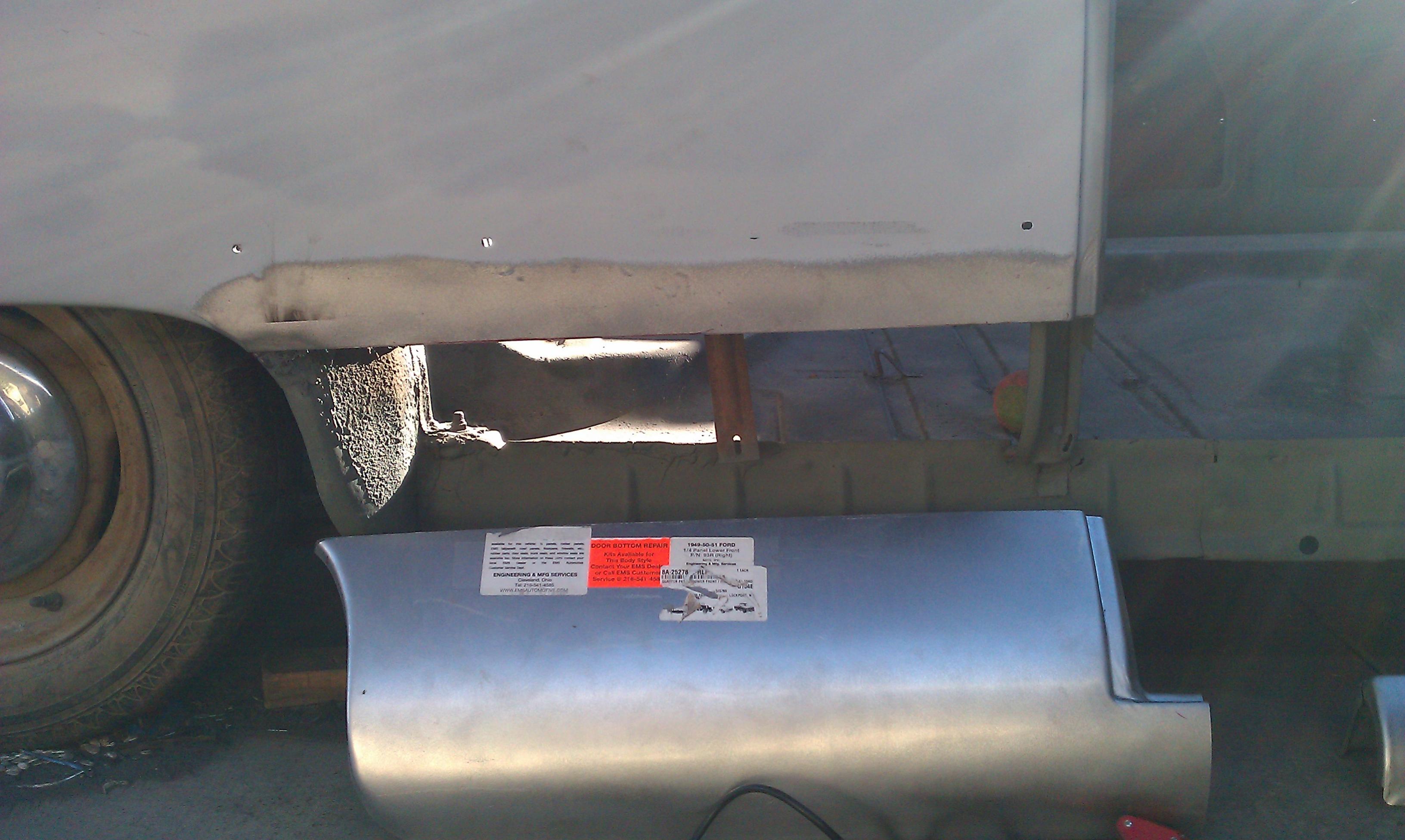

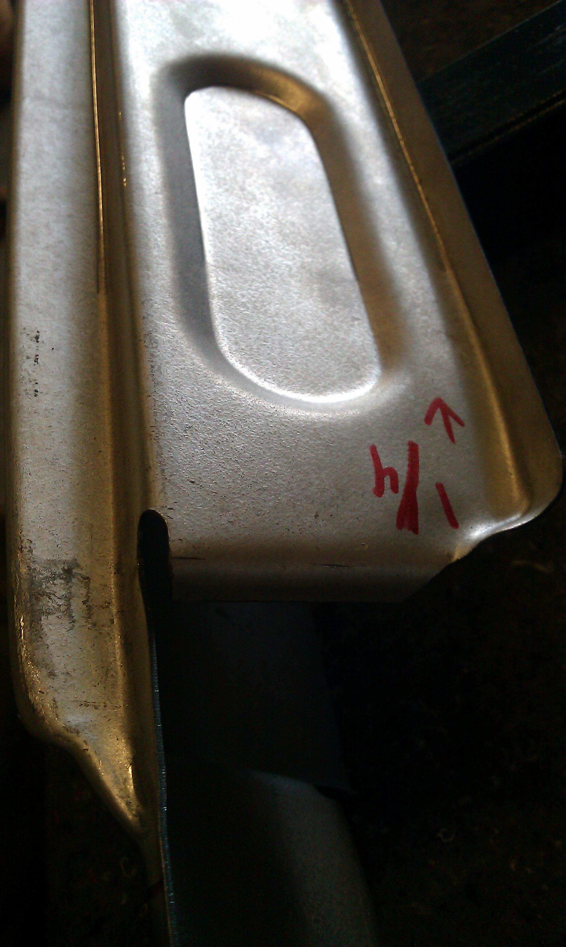

    On P*** side, installed the front rear 1/4 panel patch. (BTW The EMS panel was pretty nice. I have to do some adjustments to the bottom like adding some metal. I think it was more my car then the panel. Would recommend those to anyone looking.)
    P*** Rocker panel fitted and ready to be welded in. (I was a little disappointed when I received them from Shoeboxford.com, they are EMS made. Due to shipping company, they closed up half way. EMS said they would get me new ones, but I cant wait. So it took me a bit to open them up with out warping. Also I ran into the problem where the front of rocker was 1/4 inch to long, causing finder to not fit properly. I have taking full pics of the process I used to fix that, pretty easy fix. I was thinking of making a tech on it. Over all the EMS rockers are good quality, and I was happy that they would replace mine, and gave me some good advise on the install)

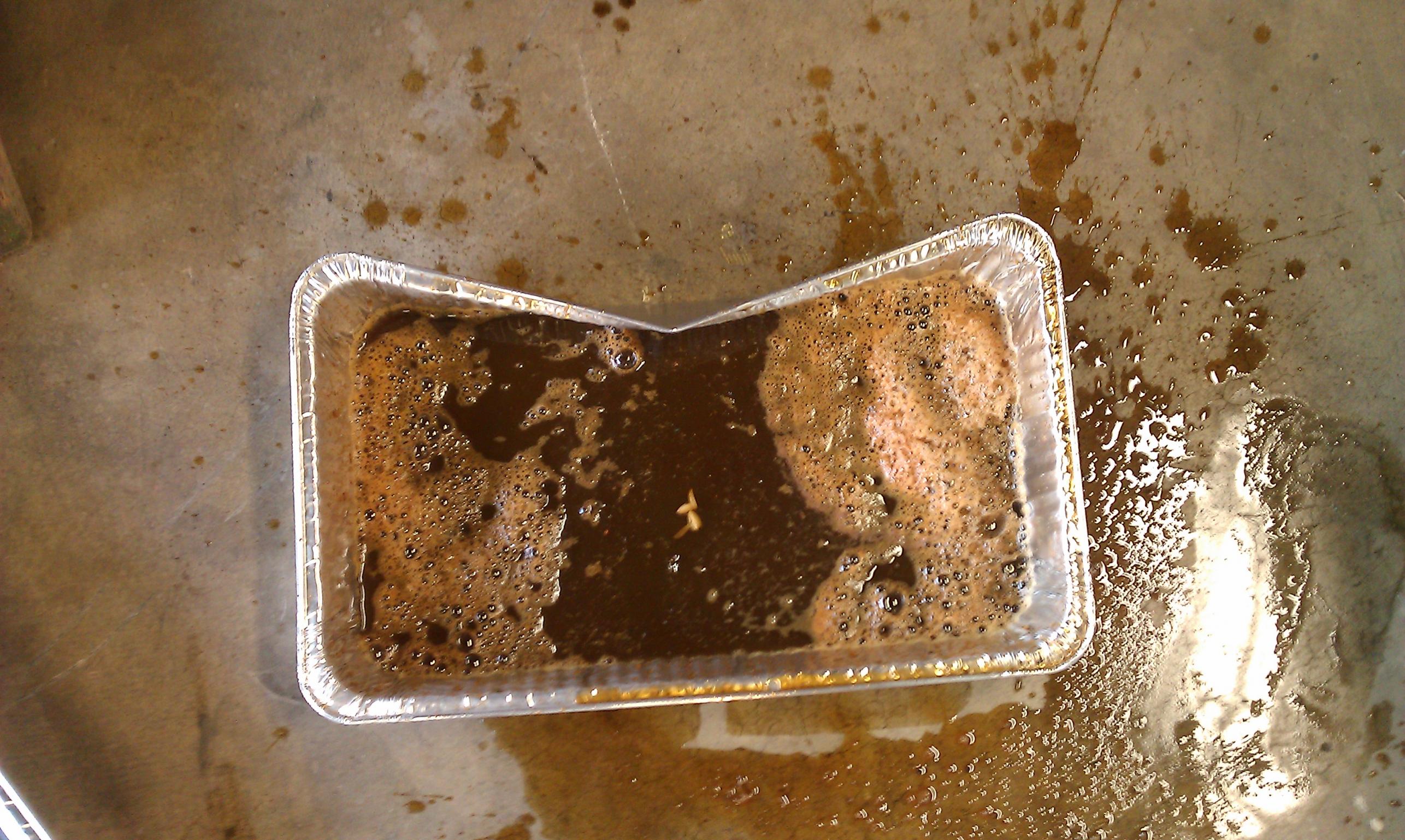

    Also filled up the water p***ages on the flathead with some vinegar. Will be cleaning it out this weekend.

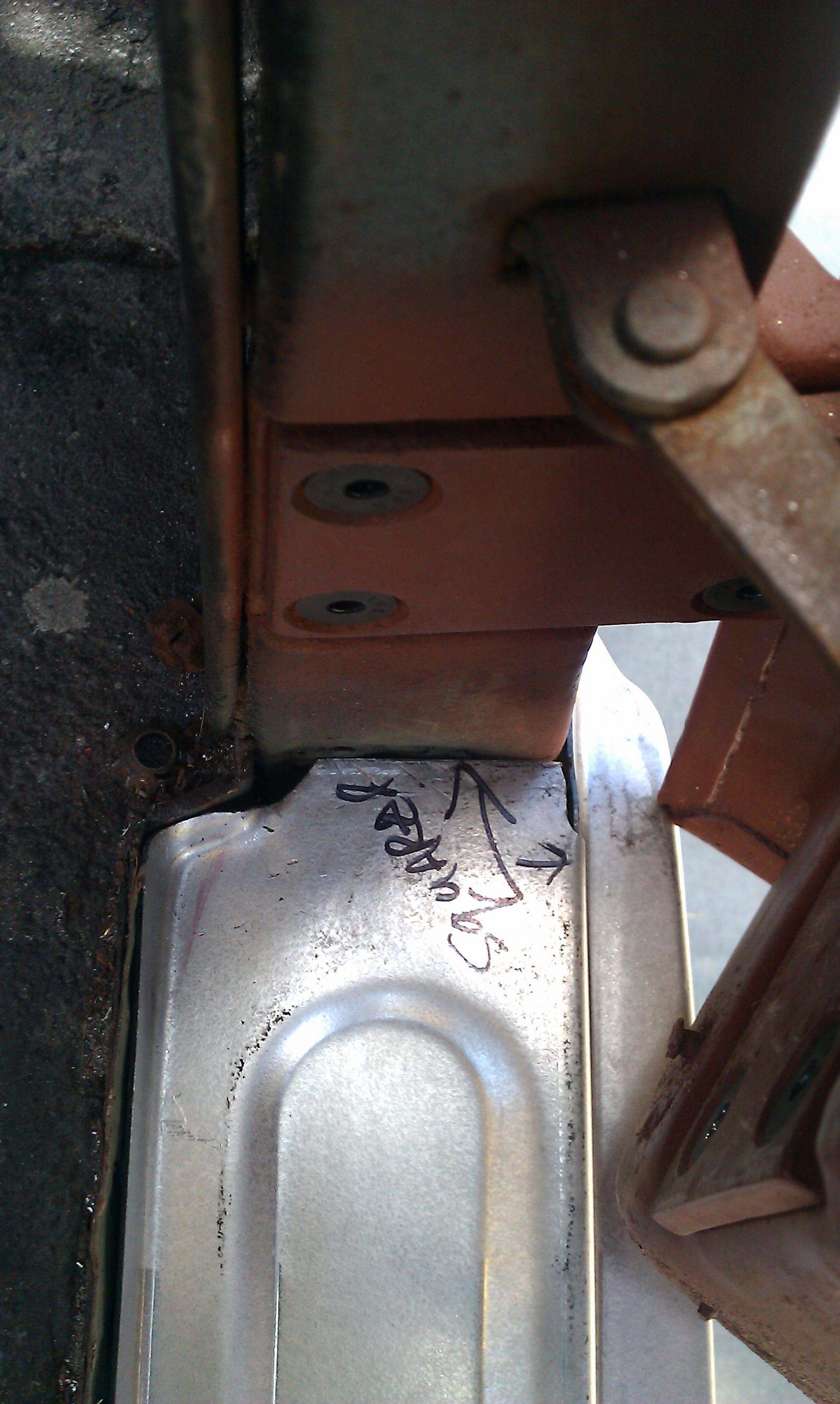

    -The first pick I layed down the self etch.

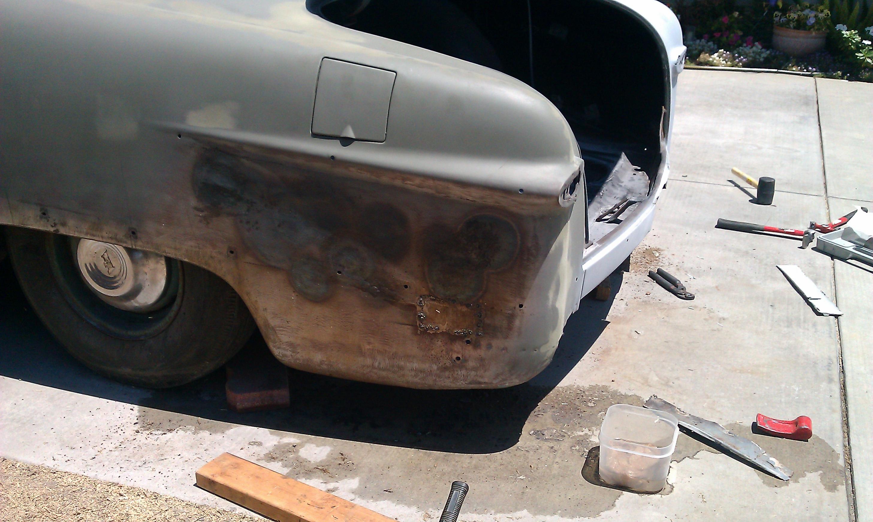

    -Second, after some time using the shrinking disk, hammer/dolly and some light filler. First coat of feather fill.
    -Measured and cut the panel. I didnt want to remove the orig holes. as you can see I am missing a bit there, previous owner cut it all out. Also, I wired brushed by hand and drill all the inner rocker, metal etched, then self etch primed. The door has all new bushings, although I recently opened it up and noticed I installed one upside down, that was a long day when I installed it, at this point I dont care.
    -Starting to s***ch it up. The door had to be bent a bit to fit the 1/4 and rocker. The bottom of the 1/4 panel, barely met the inner rocker. When I placed the 1/4 where it should be on the inner rocker, there was a 1/2 inch gap in the door seal. I didnt want that. so I made do with the bottom barely touching.
    -Test fitting the rocker. Straightened the seal as much as possible.

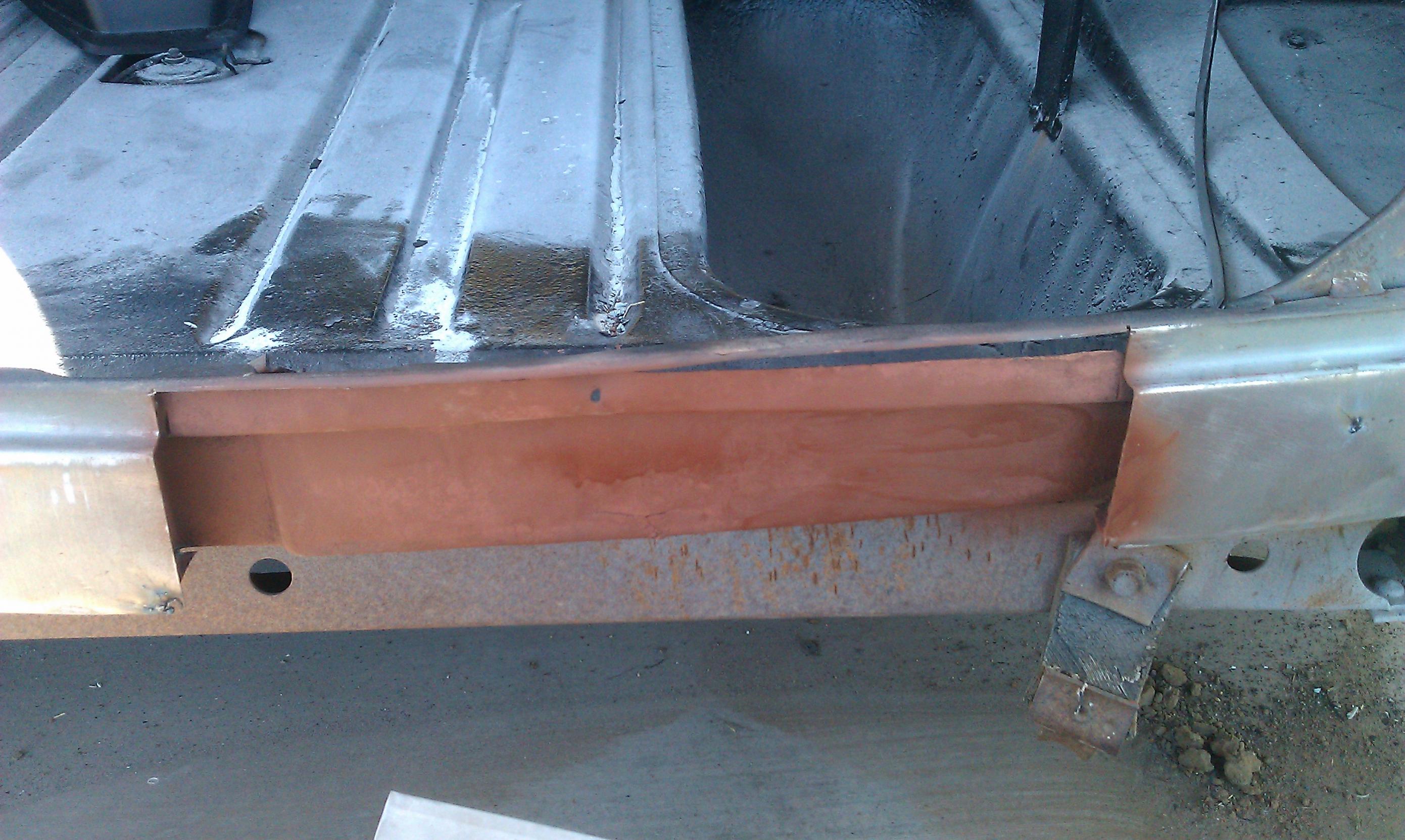

    -So the front of the rocker is to short, so gotta add a little over a 1/4 of an inch.
    -The tab thats bent over, I pulled out.
    -I squared the tab that was pulled out, so now it fits like that. I filled in the gaps where needed.
    -This is the ruff, it ended up moving back untill it was flush with the door.
    I forgot to take the rest of the pics.

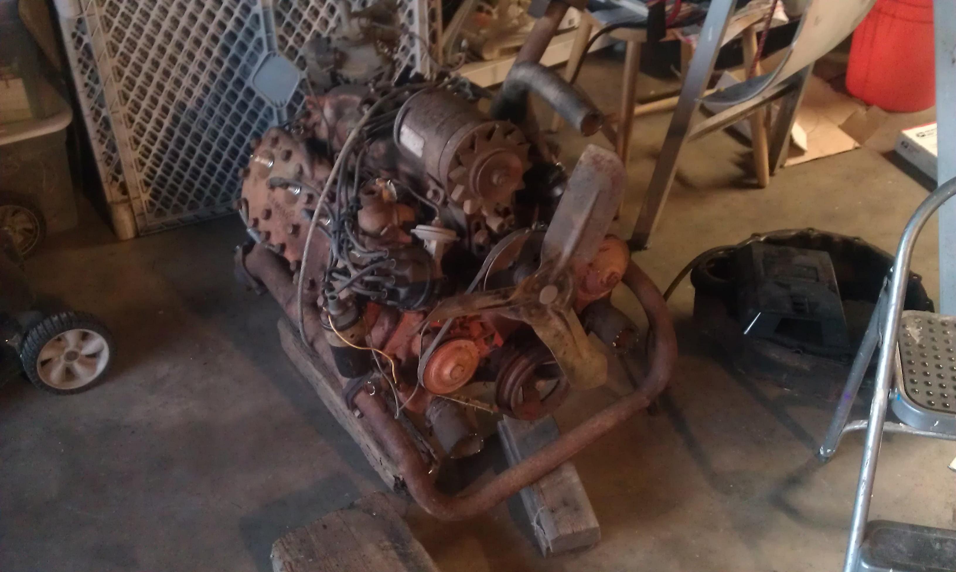

    -The first is what came out of my flathead, well this is part of it. The Vinegar stroke I mean soak was a great idea. Thanks Guys
