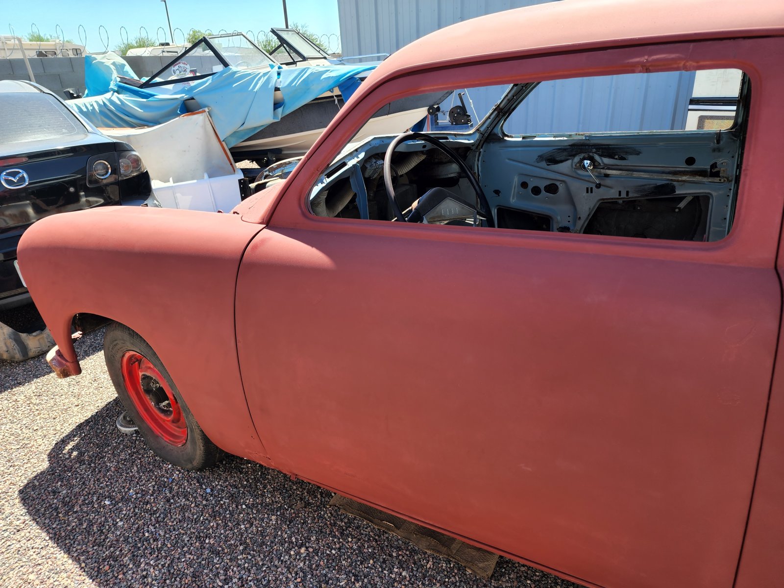

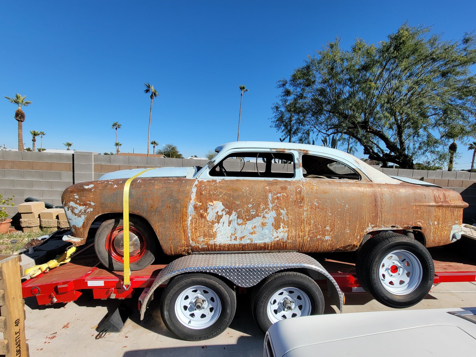

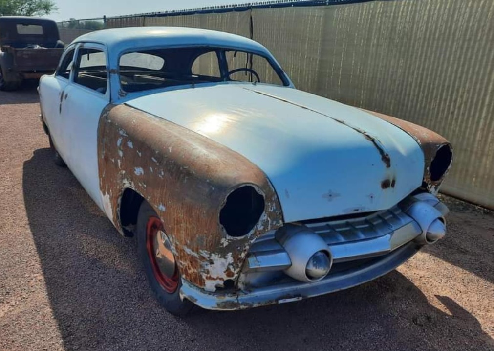

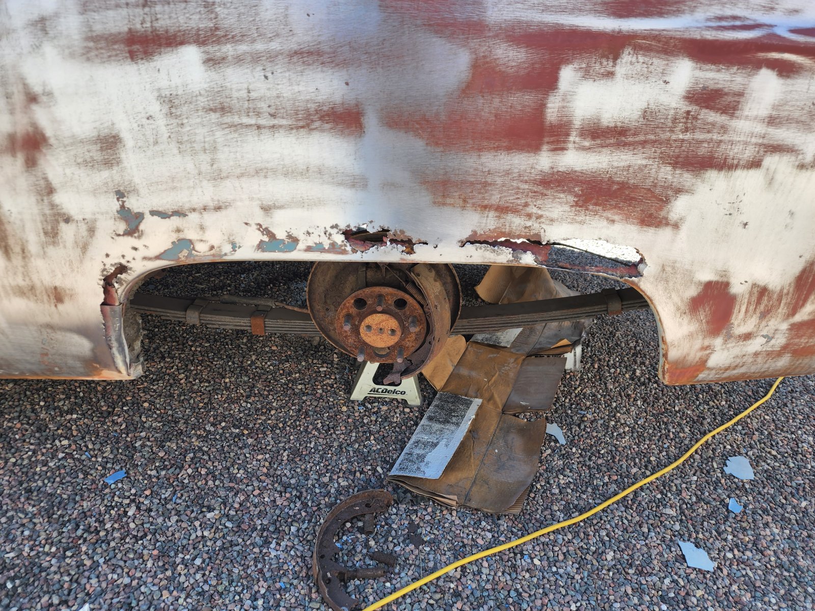

    So, im going to be using this to track my build a little easier, i have posted a few questions on this car so far. so here we go!! from the beginning. purchased this car back in Dec,21 with a plan of having it running in a year for a car show in Tombstone AZ in Nov and well that didnt happen. missed it again this year(show is next weekend) life got in the way and didnt want to rush.
    here are a few picture's of how i got the car
    Chopped 3"( i think)
    shaved door handles and gas door(i hate)....
    Ford 8" from a Granada
    lowering blocks in rear
    lowering spindles

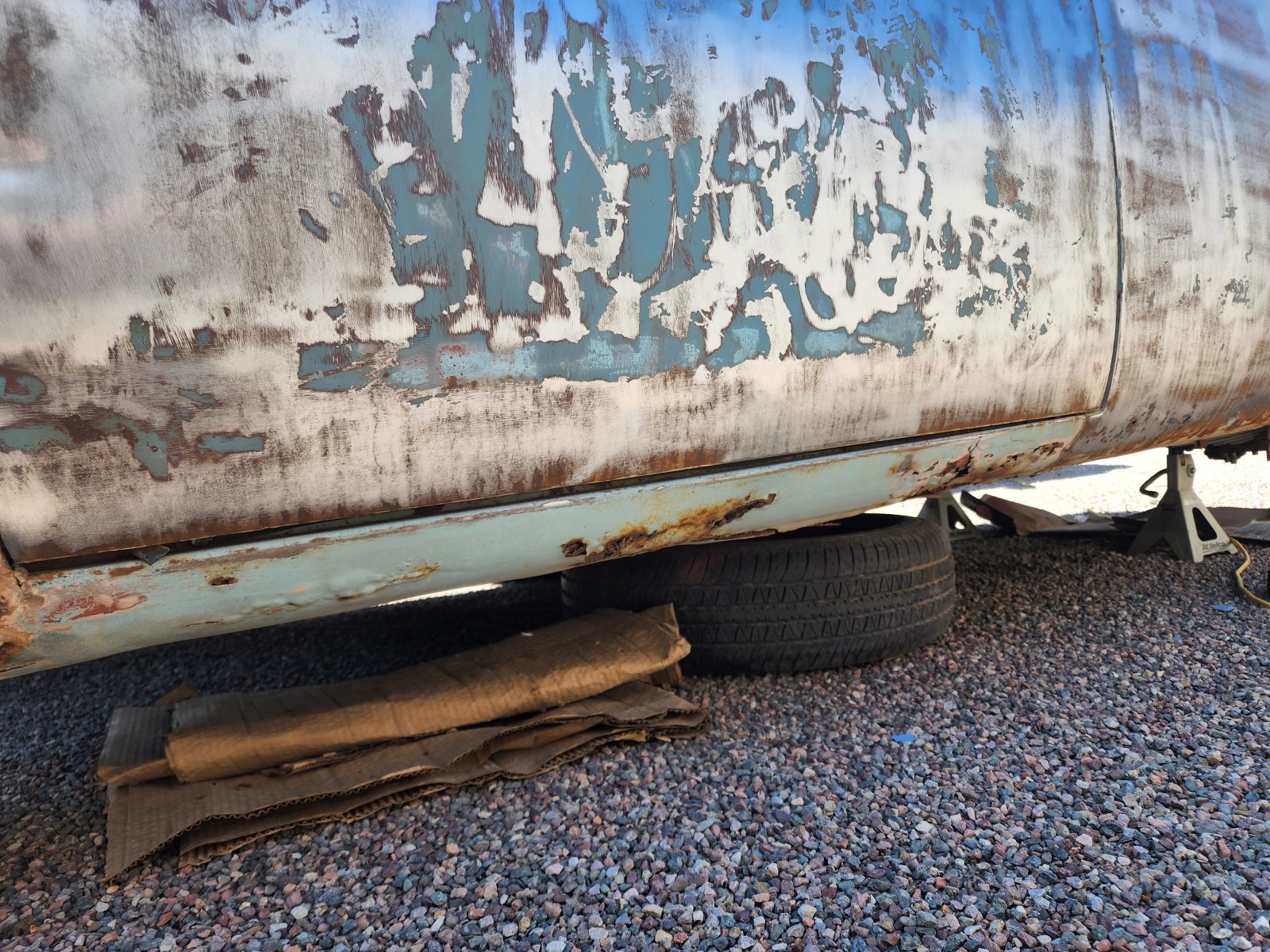

    First thing i did was take a surface conditioner tool to the rust and puddy... a afternoon later and a dozen cand of primer, at least it is not rusted anymore... now a few holes to fix..... later..

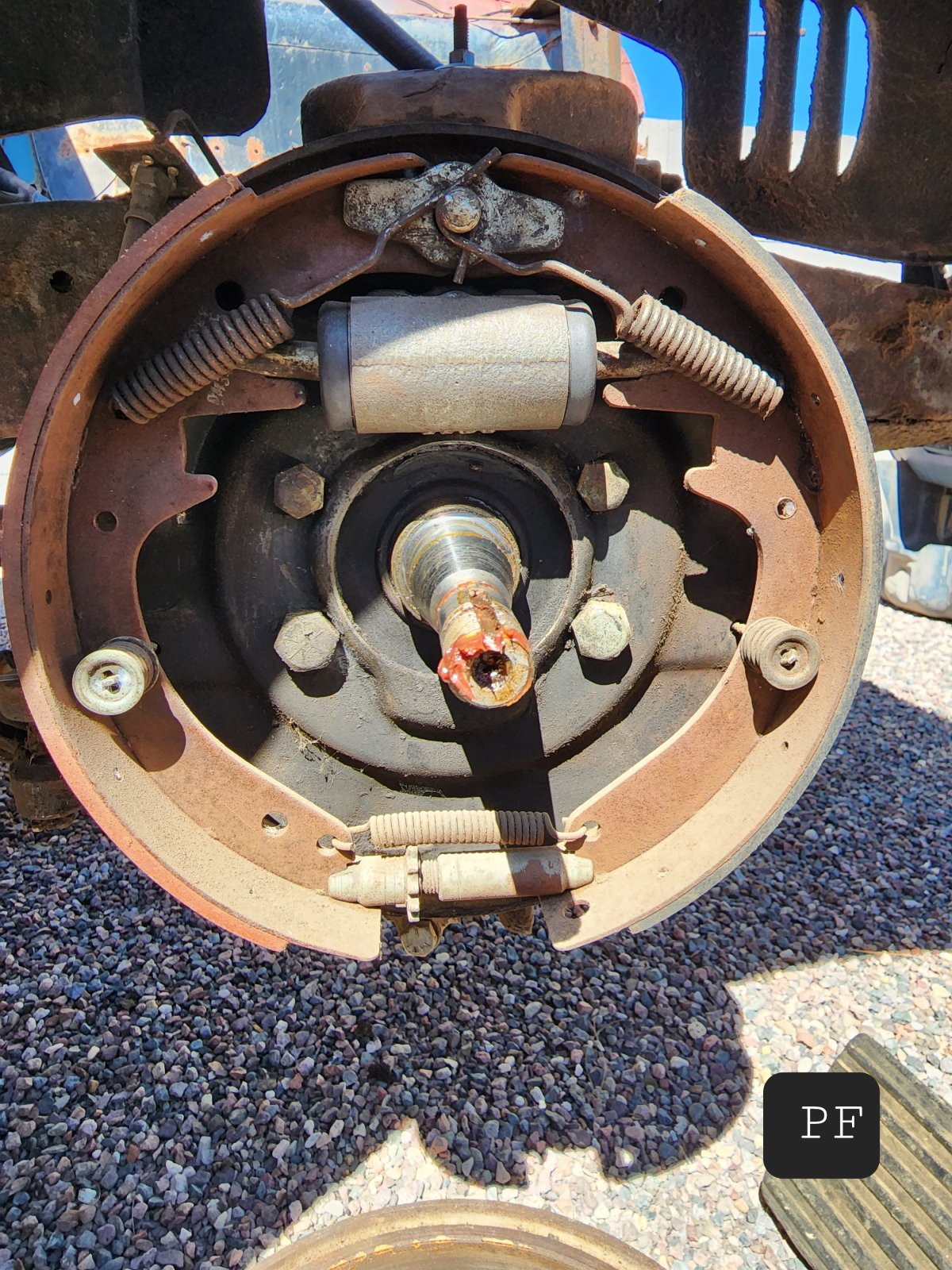

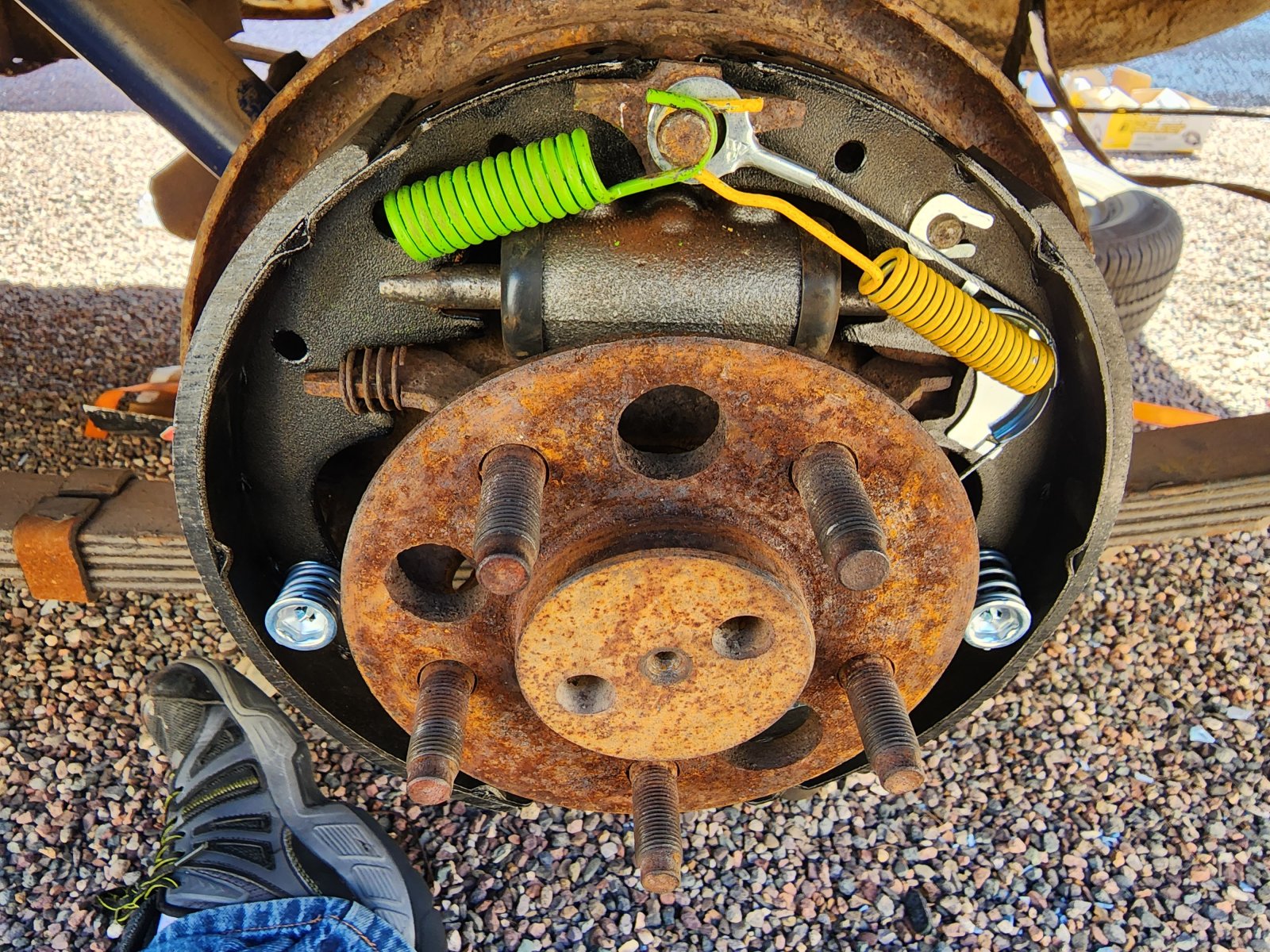

    new Master cylinder installed, all new wheel cylinders and brake lines.... and yes.. i did forget the fitting once on a flare

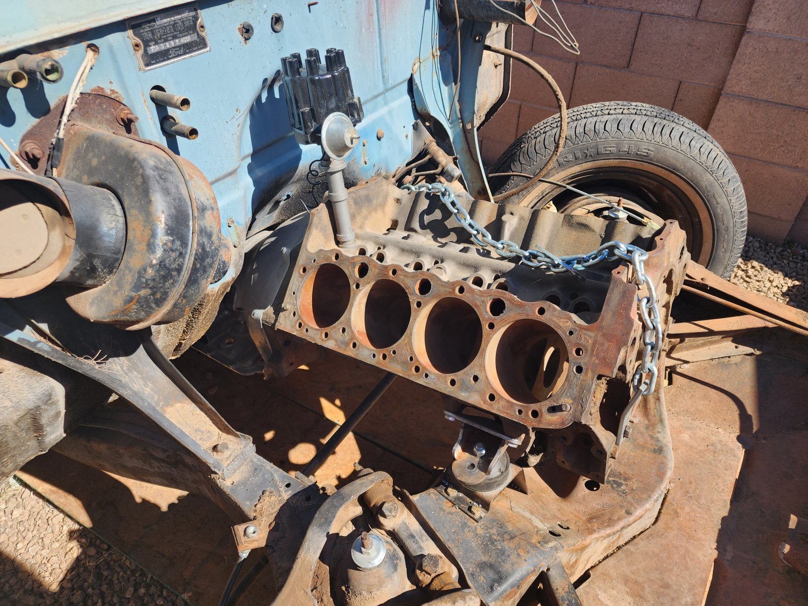

    and this makes it up to today, i had a old block and empty trans case i used to mock up the shoebox central mounts, ill need to cut the crossmember and notch it, going to be very tight at the oil pan.

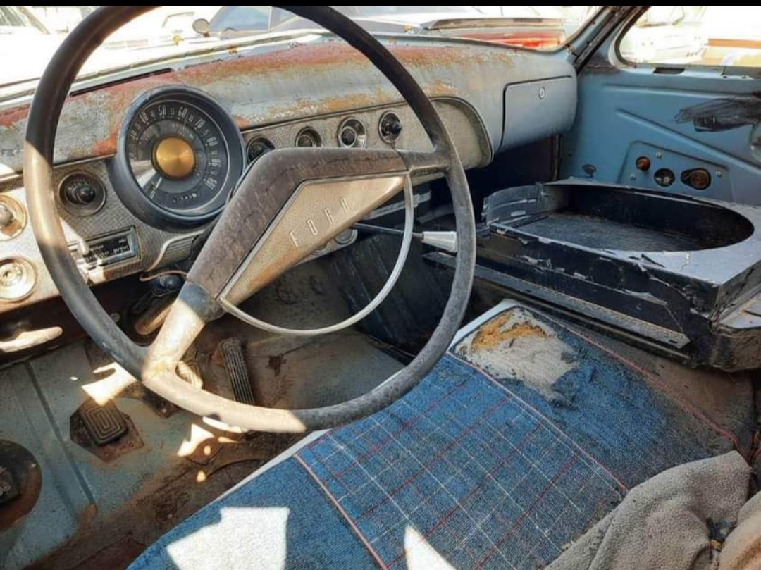

  9. What you doing with the front seat out of that car?
    I also have a 51, Gonna do a "G***er" style build

    I'm not sure yet, debating on just re upholster it. I was given a full roll of red vinyl....

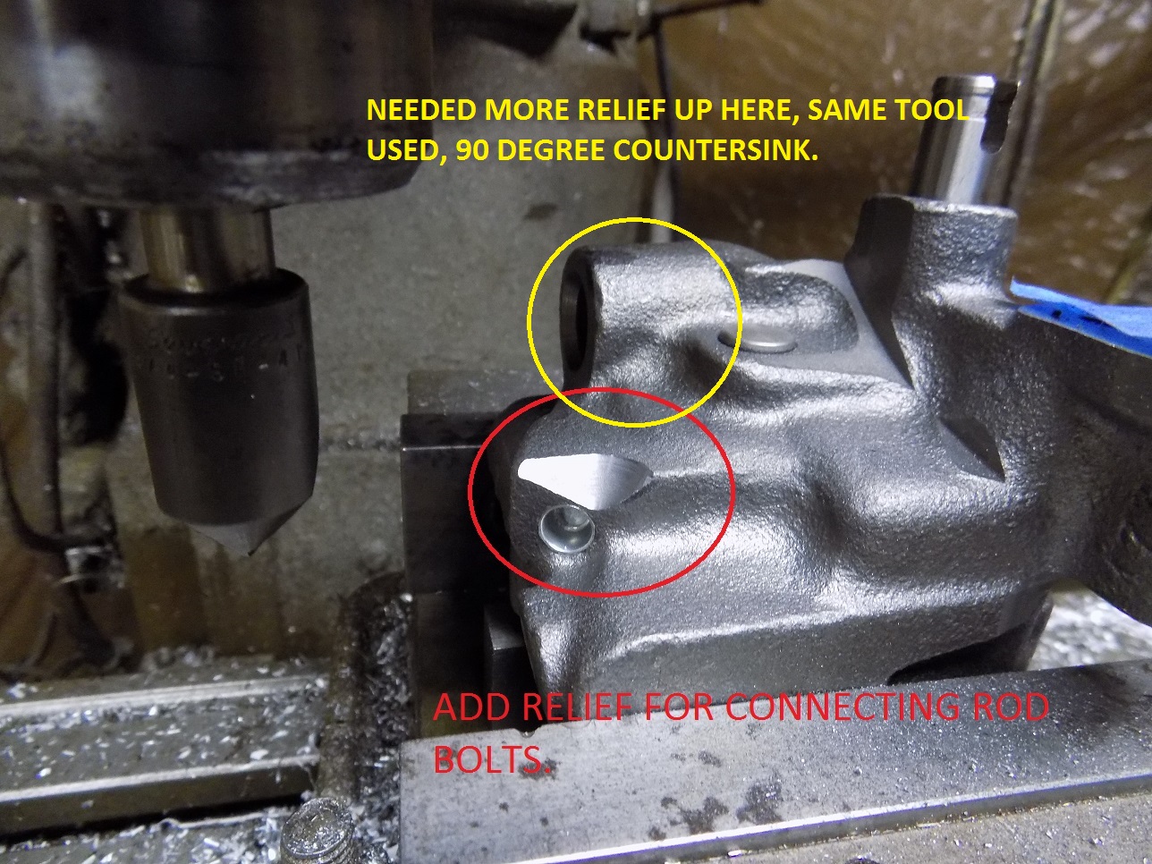

    Didn't do anything to amazing today, just worked on degreesing the sbc400 and removed the factory oil pump to install the chevy 2 pump, tho I behave a problems..
    Mounting the pick up tube. The bracket doesn't line up with the mains in the 400, probably will have to cut the tab off and figure something else out.

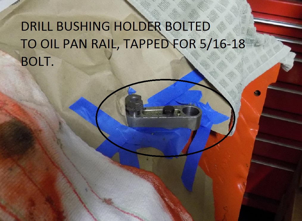

  13. bobss396
    Joined: Aug 27, 2008
    Posts: 18,908
    bobss396

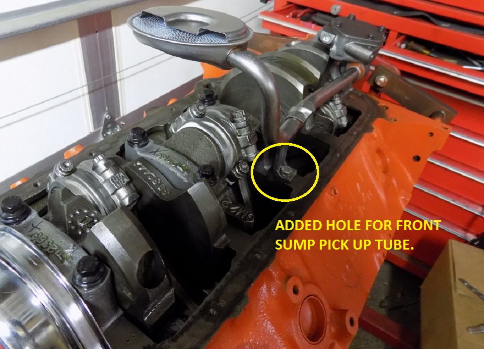

    You have to drill and tap a hole in the block web for a factory-ish installation of the Chevy II DSCN0031.JPG DSCN0032.JPG DSCN0034.JPG pick up tube. Fun to do on a newly ***embled short block...

  15. bobss396
    Posts: 18,908
    bobss396
    One think to watch is that one of the rods may hit the pump body. Bolt it on loose and give the crank a spin. That pump is made for a 3.25" stroke, no bueno with my 3.48" stroke.

    Crenninger
    Well... crank does hit oil pump.... new problem. Need to figure out how to make that work or find a new oilpan that will work or figure something else out to clear tie rods

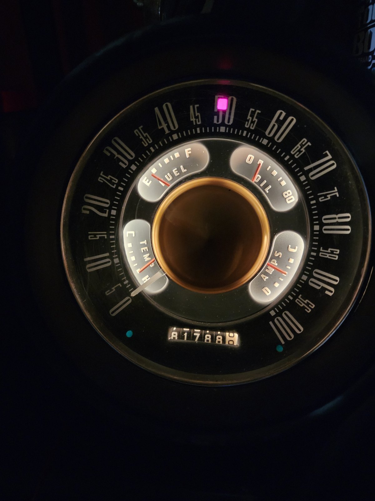

    I haven't gotten more into getting the engine fit, BUT I did get the gauge rebuilt converted to 12v and cleaned up! Along with the dash.
    Tho I need to do some research on changing the milage to match the engine.
  30. Fat47
    Joined: Nov 10, 2007
    Posts: 1,632
    Fat47
    We used to use an electric drill on the speedo to run the milage back. You can contact Rusty of Speedometer Service here on HAMB to get a professional opinion.
