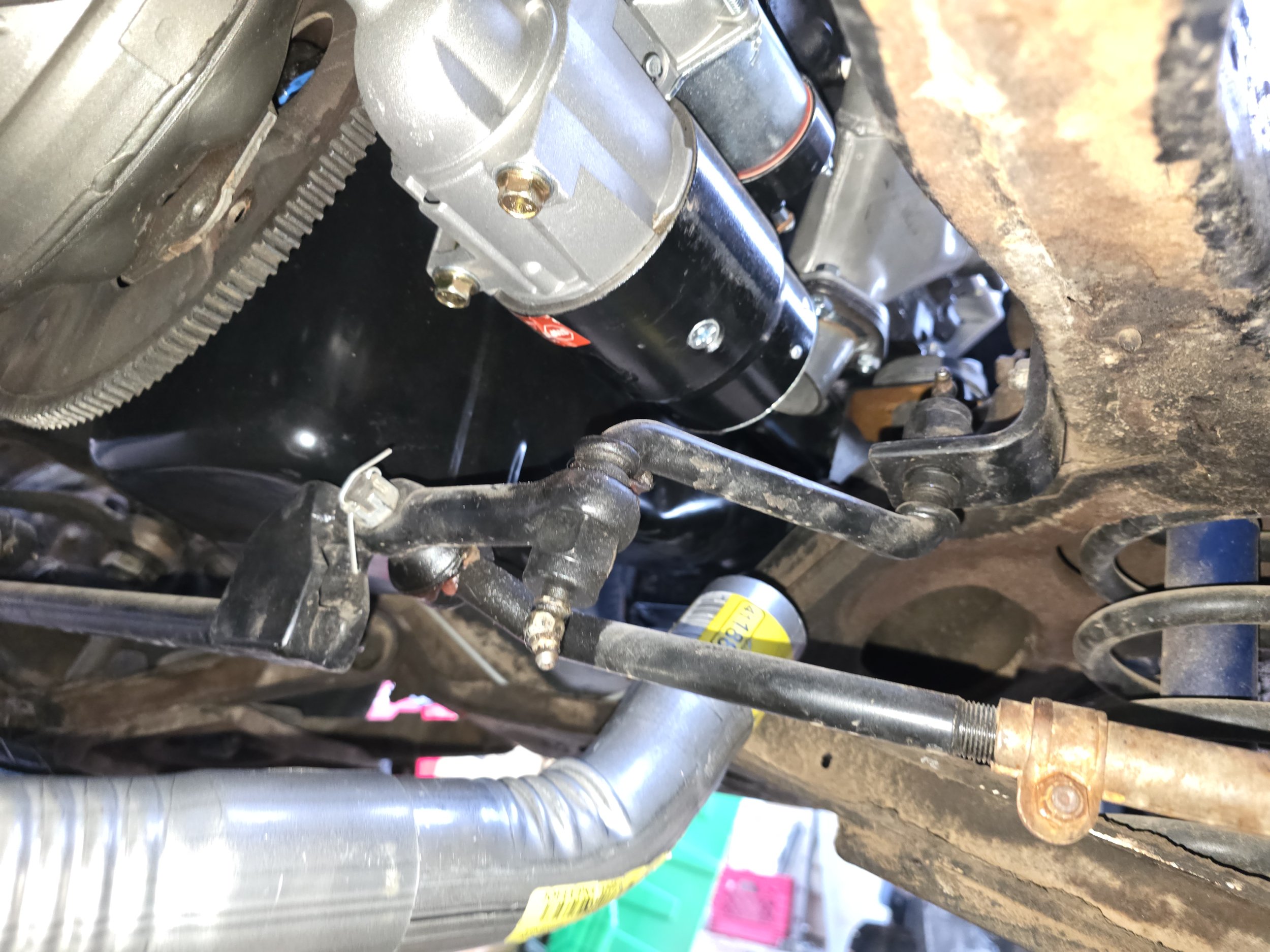

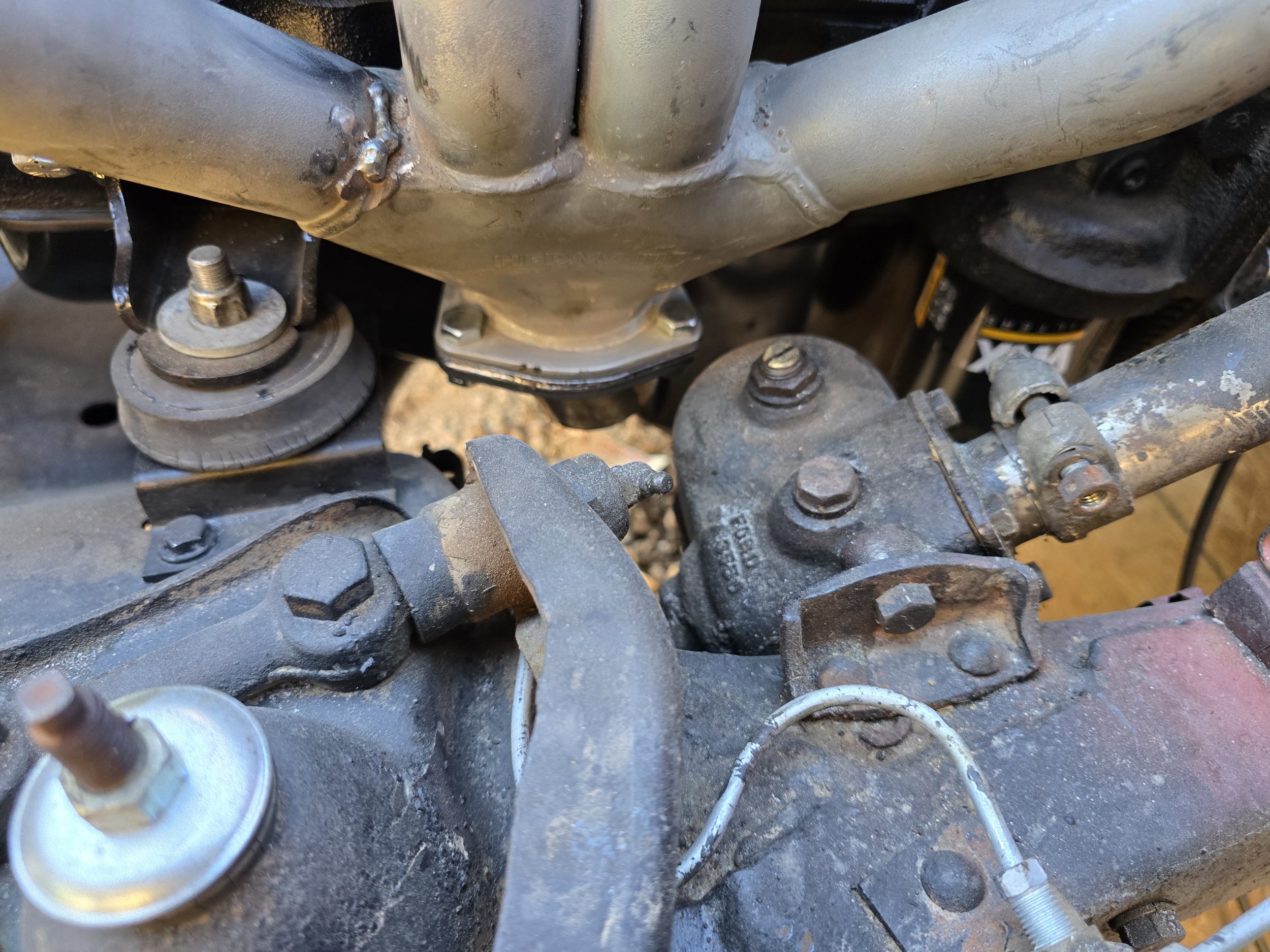

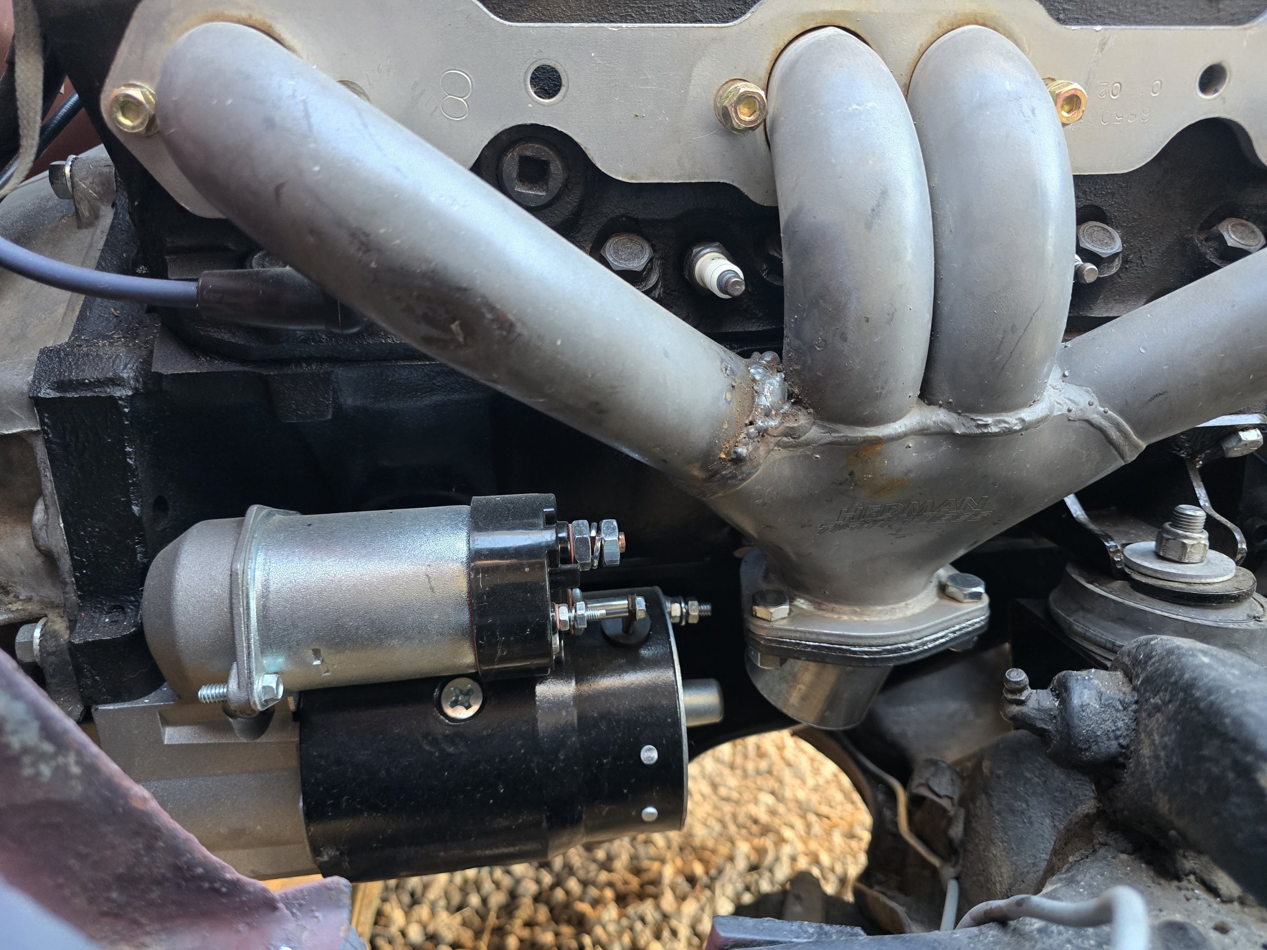

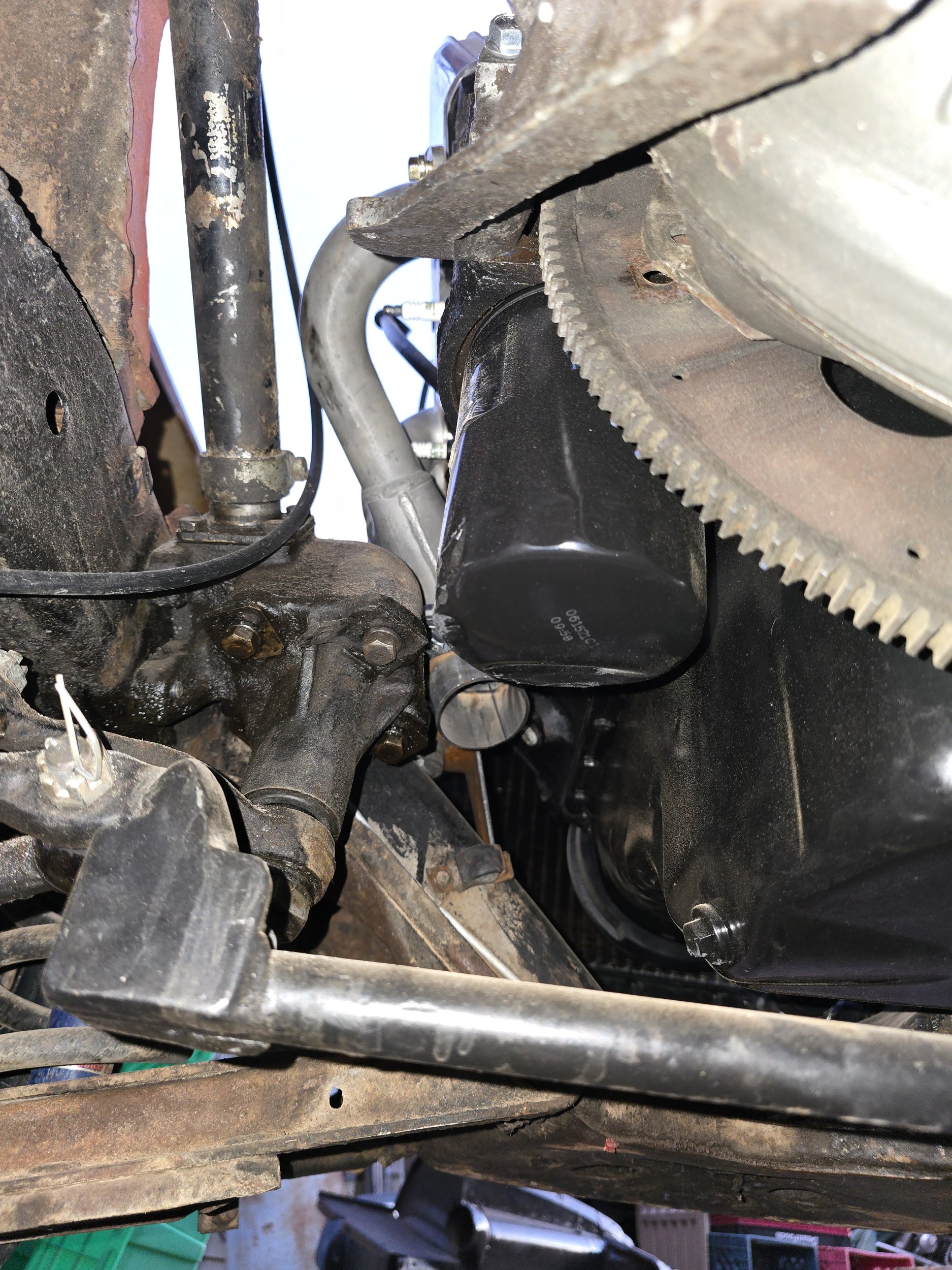

    Well.... headers clear gearbox.... new issue lowered car and tie rods are in the way. Need to see how to route exhaust pipe

  10. You might rob a remote oil filter setup from a 4wd S10/blazer to aid in clearance
    Jacksmith and Crenninger like this.
  11. Crenninger
    Joined: May 26, 2022
    Posts: 85
    Crenninger
    oohh i didnt think of that
    The Chevy Pope likes this.
  12. When I looked at your pics my first thought was with as tight as fit was on the oil filter I wouldn't wanna change the oil lol. And I used to mess with s10s so I have a memory bank of parts lol. Added perk is it'll slightly increase the oil capacity helping the oil stay cleaner and a touch cooler. Also should you so choose you could plumb an oil cooler inline. Those actually help a lot in a hot rod
    Outback likes this.

    Yeah, on my '49 I used a Moroso remote filter mounted off the firewall... solved a lot of issues.

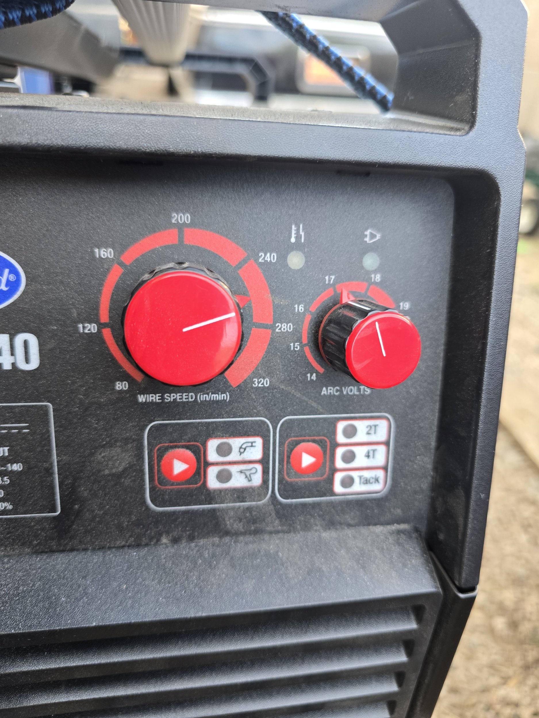

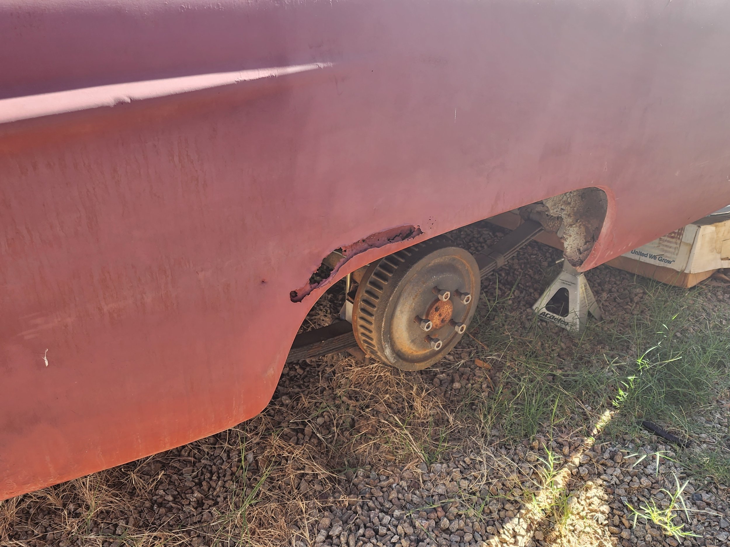

    Well.. got a rusted patch replaced.... tho still learning how to weld by reading books and youtube. i cant for the life or me figure out why I'm burning wholes... or cracking. I was told to much heat but I have it where the settings suggested. Any ideas?
    .023 wire
    80/20 argon
    16gauge steel

  15. Jacksmith
    Joined: Sep 24, 2009
    Posts: 1,859
    Jacksmith
    from Aridzona
    Wire feed rate vs. "heat" setting must be in sinc.

    if i understand... lower voltage lower wire speed?

    In my experience, rust repair is more about technique than welder settings. It takes time and clean steel.

    To a certain extent... As mentioned above, cleanliness is essential for a good weld.
    Rusted metal tends to be thinner in places, hence the burn through. Minor adjustments are often needed as needed. When the metal is rusted, it needs to be completely replaced in that area for success.

    Well I cleaned the metal and wired wheeles the back the welds came out alot better.
    Still by no means perfect, but way better then a rusted hole.

    Cool beans... experiment with less/more wire speed as well as less/more power to get just the right result. Practice is the only way to learn. You'll get it!

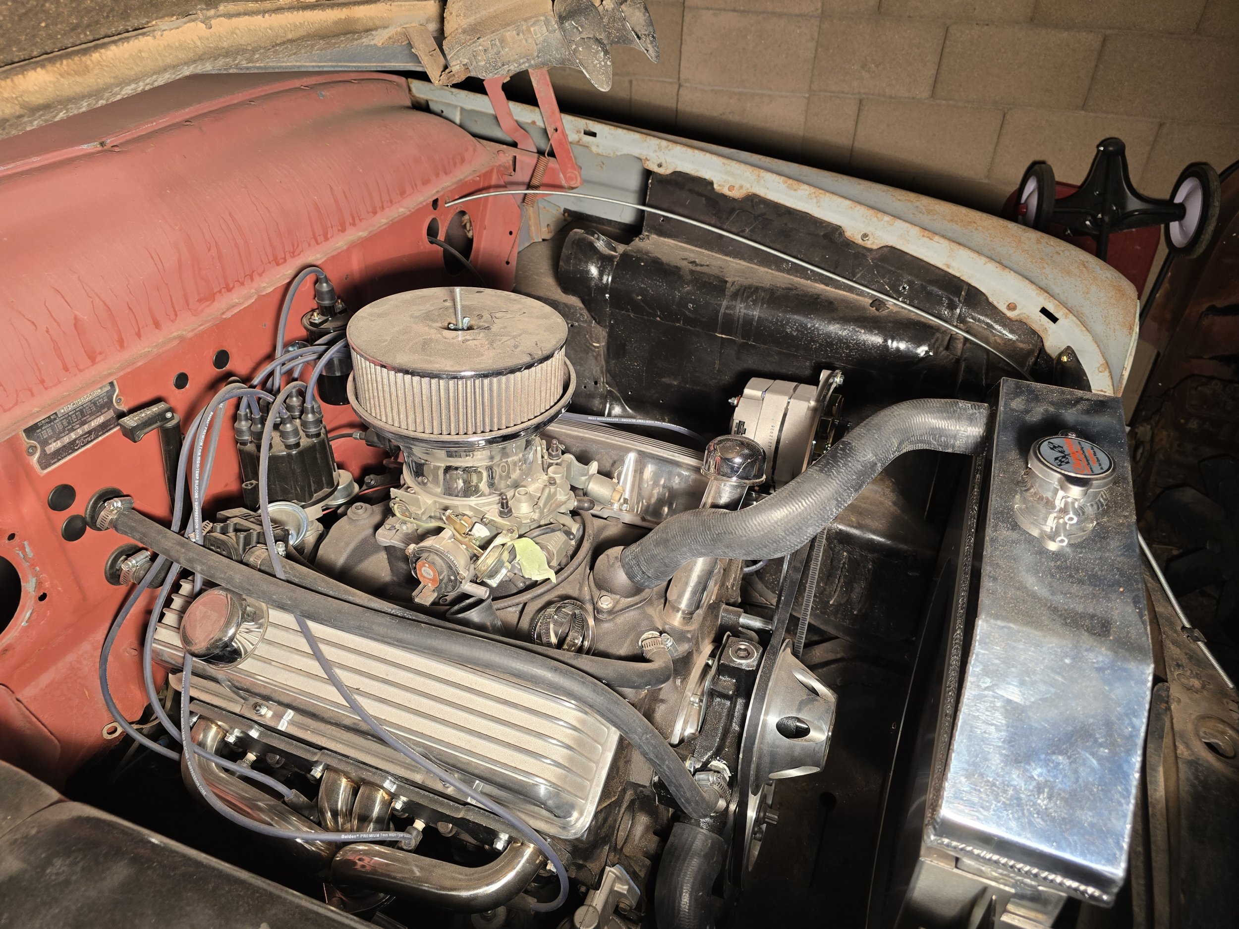

    20241112_181551.jpg hood, fenders, innter fenders, grill. All bolted up.
    I ended up changing water pumps to a short pump for more clearance!. Getting close to getting her running 20241113_181724.jpg

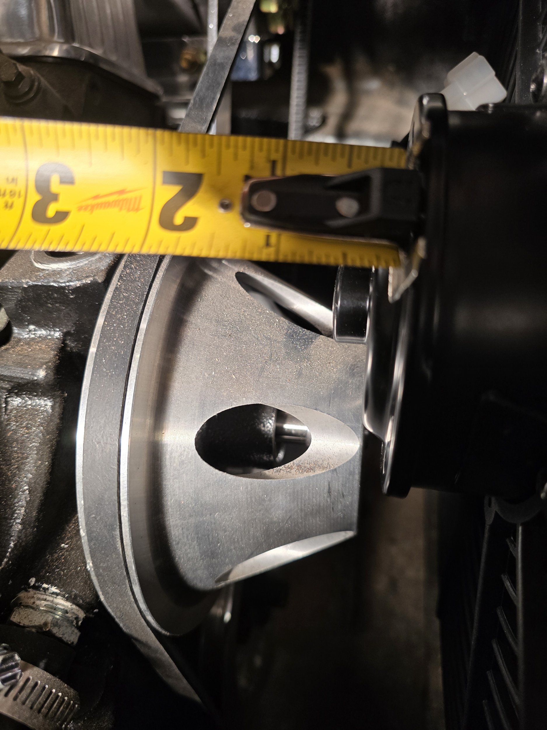

    Well... new problem again.. I had to use spacers to get the rad moved forward.
    The description claims it fits but... nope
    Now I need to find a low profile rad fan thickness about 2.5" total to make work
