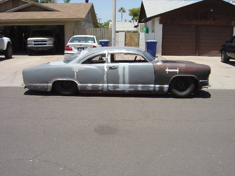

    I found this pic on my hard drive. I think it was from a post on Pirate 4X4. I think I saw a pic of it there just before the HotRod magazine deal. Man it's come a long way! I'd like to say keep up the good work, but it appears that you don't know how to do bad work.

    Hey that's cool! See the ruler taped on the front fender? That was for reference when I was thinking about moving the front wheel-well back. My old long travelled Tacoma is the pic too.
