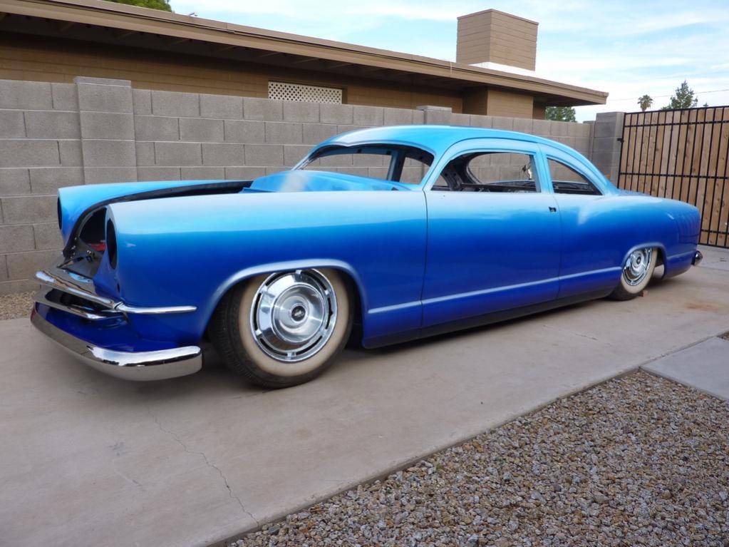

    I put the Kaiser caps on and hated them. I like the dish of the steel wheel, so I think I'm going to look for some chrome steelies or have mine chromed. I'm still open to suggestions.

    maybe james d could photo shop some chrome reverse on it. just too see. i think thats the way to go.. i think i already mentioned i think the car is a lil to wild to have hubcaps, or painted wheels.. cant wait to see a good profile pic of this sumbitch!

    To my eye with that incredible paint, chrome reverse with some bullet centers would fit the bill perfectly. Can't overstate what a beauty this car is! Kudos man...

    First of all i want to tell how cool this car is
    and second thing is some photoshop i did, sorry don't know from what year or model this hub caps are

    I like the chromed steelies and the full smoothie caps the best.
    FYI, in order to properly chrome plate the factory steelies, the centers will need to be removed from the rims, both plated seperately, then welded back together. I could plate them once disassembled, but I'm not set up to put them back together.

    Chorme steelies would look right at home on it. Are they stock Kaiser wheels?

    They are actually the steel wheels off my old 94 caprice. The cop car donor had similar wheels but with holes to cool the brakes. I really dig the shape of the Caprice wheels, they are really smooth.
    If I blow the wheels apart like Josh said maybe I'll paint the outer hoops and chrome the centers or vice versa. Could be tricky to weld them back together without burning the paint and chrome though. I'm sure there is a trick to it.
    I would also want to smooth out any manufacturing marks because there are some lines and numbers on them, and weld up the valve stem holes and move them to the inside. Sure would be fun to check the tire pressure but it would be worth it to leave guys scratching their heads at the car shows.
