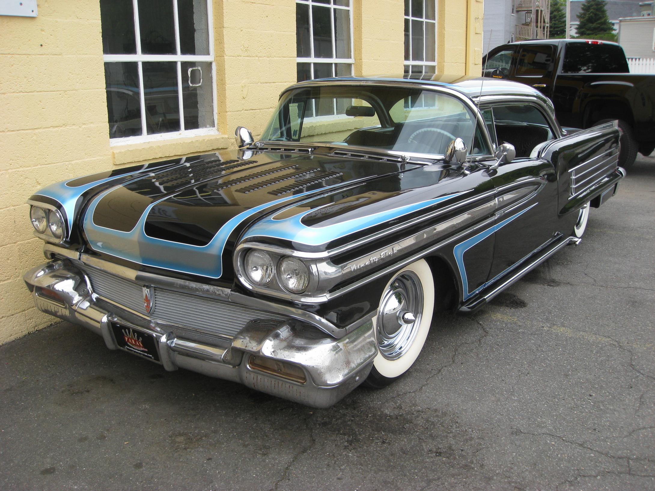

    Here's my friends car. He bought this project from me several years ago and he build it. I would have liked it more chopped, just like you did!
    Notice the notch below the rear quarter window...

    Nice! I like the dip on the beltline. I dig the later tail lights too.
