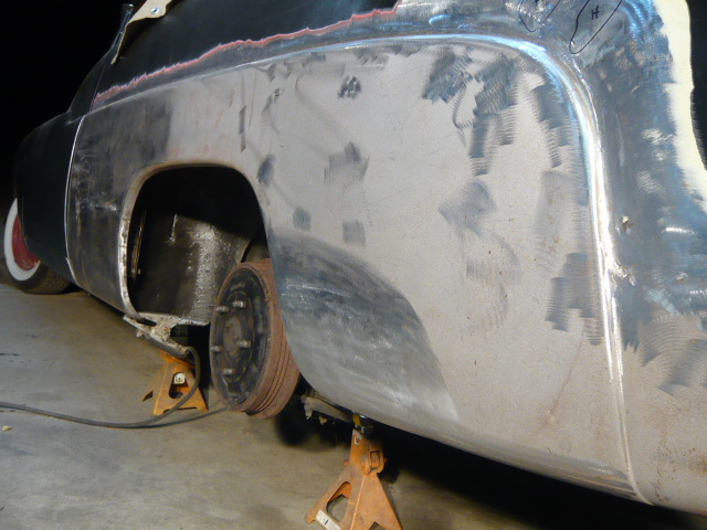

    Got the quarter panels removed and blasted, trunk blasted, and next up is to repair the rust on the body and quarter panels then mold them on...more pics soon!

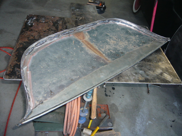

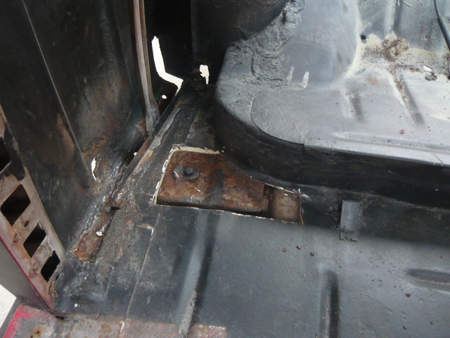

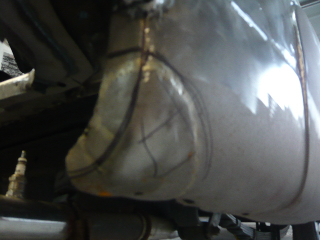

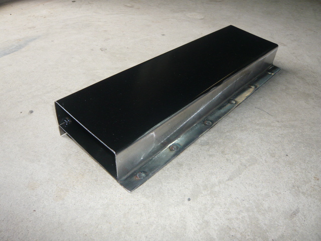

    Tail lights are finished and in epoxy primer, and also made some progress today on the inner rockers, which are just about finished. Here are a couple teaser pics...more pics soon when the whole job is finished...Octavio did a great job on the bodywork on the lights.

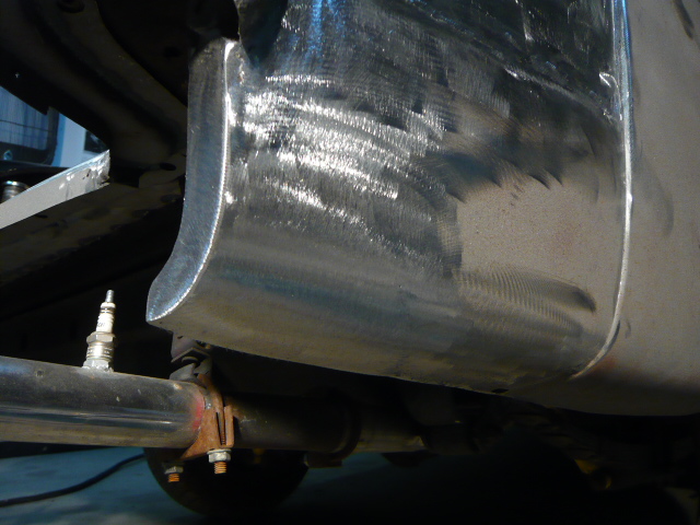

    It's been a while since I've posted, but progress has been steady on Lee's Merc- quarter panels are finished, inside and out, wheelwells patched, and rear valance is fixed and molded on. Next up is frenching the skirts- I'll post some pics up soon...we're doing both style- smooth and flared (stock '51s).

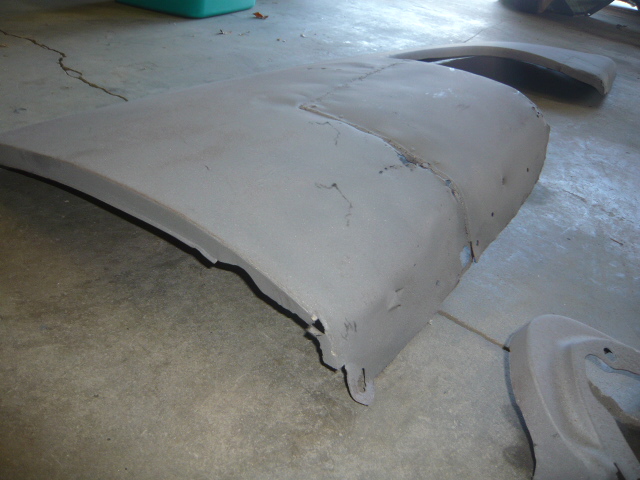

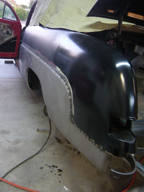

    Here are some pics of the quarter panels after they were blasted. Someone had previously "patched" them by brazing poorly-formed sheetmetal over the original rusted panels. Not only did we have to patch the rust, but the warpage from their brazing did a number on these panels. They're straight and solid now though :)

    god damn rob... that quarter seam is sick!!! you are one patient sum*****!! awesome..

    Thanks guys! Yeah that quarter panel seam is always time consuming. I think I have a pic with the DeSoto teeth sitting in place...I'll look tonight.

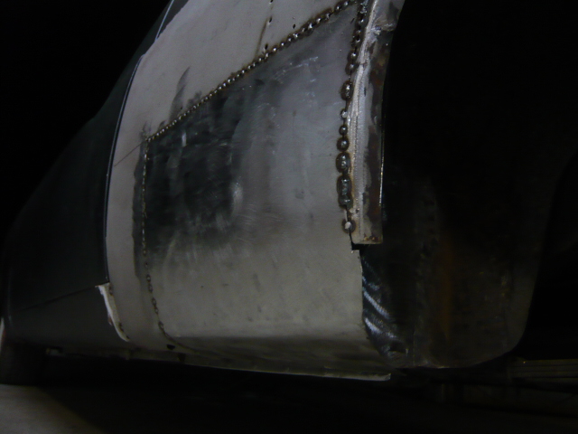

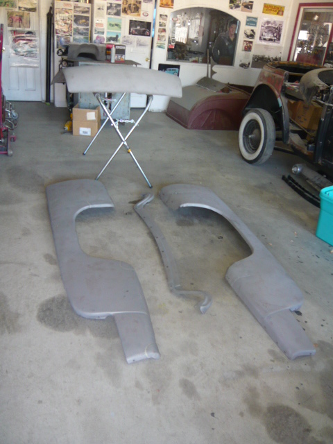

    Started frenching in the fender skirts...going to do a pair of '49/'50 and '51s...more pics when they're finished :)
    I want to thank Paul Bragg for the idea on the pins and latches to mount the skirts, and Rik for having pics of that on his site...Rob

    Very, very nice! I love the skirts and never noticed the pics on Rik's site of Paul's set up. You can bet I will be searching them out now...

    You truly are gifted...if I may ask, how is the long quarterpanel seam filled? Looks like smooth lead, but it is outstanding, as are all the pix. Thanx for posting them.

    Nice work on the skirts ! ...I sent Paul a pm last year with some questions about how he does his flush fits...he asked for my address and sent me a video tape !! Great guy and amazing talents !

    Thundershorts- to fill the quarter panel seam, I bolt on and fit the quarter panel the best I can and weld it up very slowly as even a little bit of heat makes that top edge body line on the quarter panel dance around a lot...then I carefully grind it with a 3m stone. Yes, time consuming... :)
