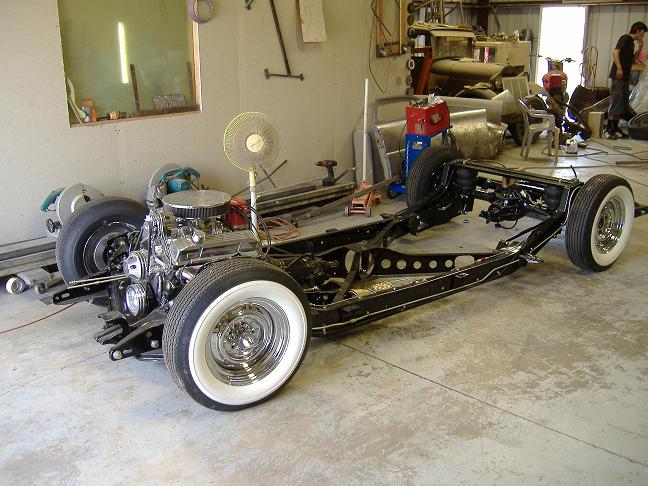

    slddnmatt
    this is the stock frame with Fatman bolt ons and bags all under this merc.
