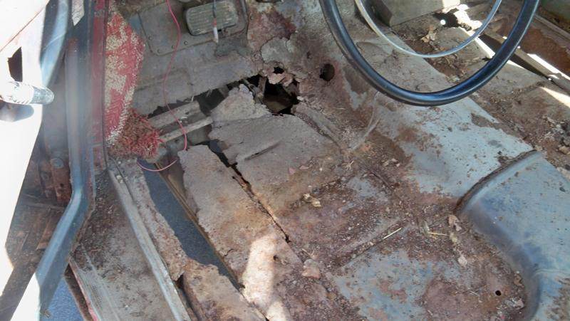

    Finally getting started on rebuilding this old custom, main problem is that the lower third of the car is rusted out (looks like it sat in water for a period of time, lots of sand packed in between floor and mounts) and has to be replaced. Fortunately the rear fenders are in reasonably good shape, the flathead really sounds good and most of the pieces were with the car. For now I'm concentrating on rebuilding the body and then will decide how I want the car to look but have a ton of ideas, just hope I am around to finish them (not in any hurry on this car, just enjoy doing the work). I started by purchasing a set of outer rockers from Sherman because I didn't feel I had the equipment to make them and because I needed something with the correct dimensions to start building from. Once I had those I repaired the door posts, made the inner rocker (thanks to some help from HAMB guys who sent me pics. of correct rockers), and have the p***enger side ready for floor boards. Have started replacing rear fender wells, made spare tire wheel well, and formed floor pans. I figure this project will probably be like all my others, take 7 years to finish- I am slow but will update as I go. 100_1775.JPG IMG_0028.JPG photo 23.JPG photo 1.JPG photo 15.JPG photo 13.JPG IMG_0341.JPG

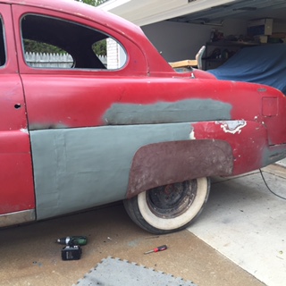

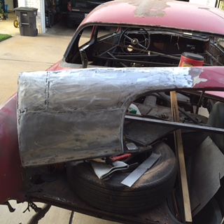

    Had a good week-end!
    Side panel was more rusted than I thought so had to replace the entire panel IMG_0567.jpg
    Thanks for looking, still having fun%$#%$%@!

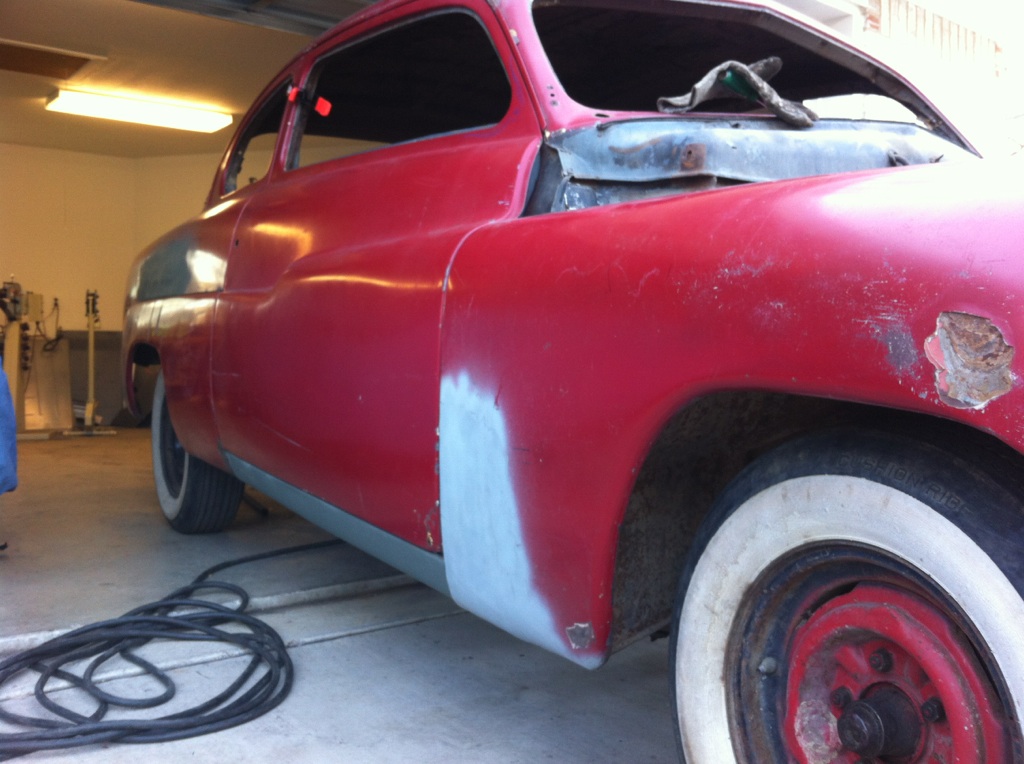

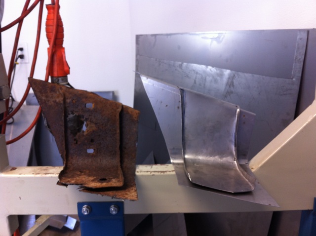

    Continuing to have fun! Rust everywhere!
    IMG_0442.JPG Made patch and spotted in for lower front fender panel
    IMG_0578.jpg Made patch for right front inner fender well
    IMG_0582.jpg Welded in patch
    IMG_0586.jpg Primed and ready for fender
    IMG_0589.jpg Beginning to look like a Mercury, happy with fit.
    Thanks for looking, obviously a long way to go but am enjoying it.

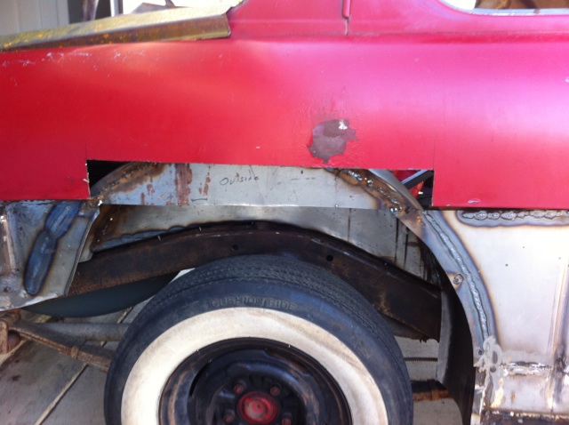

    I continue to find rust everywhere, it is really hard for me to understand how it got this bad but it is what it is. Here is my current progress
    : photo 53.JPG I had to cut out the entire drivers side fenderwell area, installed fenderwell photo 3.JPG
    made and installed new fenderwell and rebuilt upper part of quarter panel photo 50.JPG
    and cleaned up
    Starting work on fender, I know I'm not going to make Stray Kat with this car this year but hope remains eternal for next year! Besides, my sons aren't any further along than I am! Stay warm.

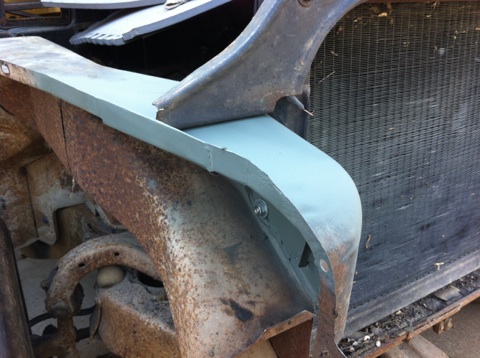

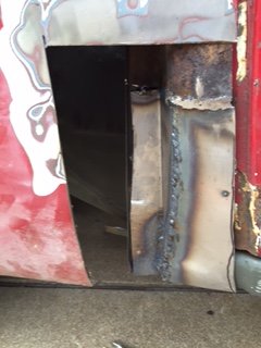

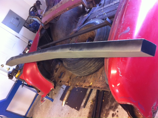

    The Stray Kat 500 really got me pushing to get back on this project so in spite of a lot or rain lately I was able to get most of the rusted out sections repaired.
    IMG_0376.JPG Finished Drivers side front fender brace
    IMG_0389.JPG Installed outer rocker panel
    IMG_0394.JPG Finished patch
    IMG_0393.JPG Repaired inner fender
    IMG_0385.JPG Glad to be putting it back together!
    Now the fun part begins! With having to remove much of the fenders due to rust I'm going to free lance the look I want, will start with a pair of 53 Buick rims I found and go from there. Still haven't decided if I'm going to make a wagon or chop the top so will be working on front and rear until I do. Thanks for looking!
