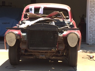

    I still have a lot of rusted metal to replace but needed a break so started on the front end, as I mentioned before I was able to get a set of Buick headlight rims so started from there.
    Removed the rusted sections of the front fenders
    Made backer plates for headlights
    Attached rim to see how they would look, not going to French them is as I like the looks of the rims.
    Made filler panels
    Filled in fender
    Finished Drivers side
    Ready for lights!
    Will start work on rear, trunk pan has to be replaced and I want to install vertical taillights and I will be able to take out rear bracing after that without affecting whether I chop it or make a wagon. Also thinking about modifying the hood, I like the look of a flatter V hood something like the 53-54 Chevy's.
    Thanks for looking!

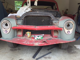

    Decided to finish up the headlights before moving to rear.
    Holes cut for lights
    I found these buckets on e-bay, amazingly good shape
    Added Bezel, someone told me these were not 53 Buick bezels but didn't know exact year- whatever, I like them.
    Primed and ready to go!
    Of course none of this would have happened without my BIG helpers (grandchildren!)
    Now going to start on rear, lots of rust issues so will get that taken care of, still trying to plan out a lower flatter hood line and will attack that after the rear is done. Thanks for looking and hope you have a great summer!

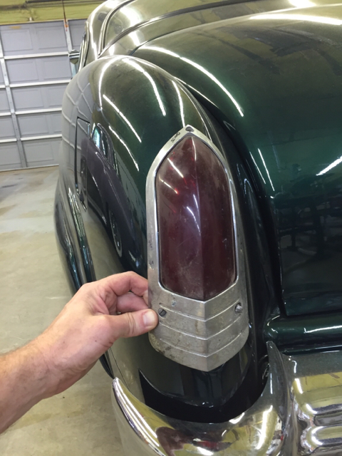

    Well, actually, I might have something unique. I think I remember my dad once saying he had considered '52 (?) Buick tail lights on his '51 Merc way back when. At the Stray Kat, I found one such light at Too Tall Okie's shop and bought it just to hold up to my Merc and see what it might have looked like just for grins. I haven't taken the light apart yet to try it out, but I'll make it a point to do that over the next few days when I get a chance and post you up a pic. Never know, might look kinda cool. ;)

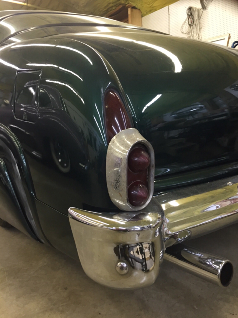

  13. Sancho
    Joined: Apr 24, 2001
    Posts: 5,036
    Sancho
    ;) (Photos are Moriarity's)

    Those both look good. The housing I have looks like it would nearly bolt on vertically, which is I recall my dad saying...that it was a pretty much bolt on change.

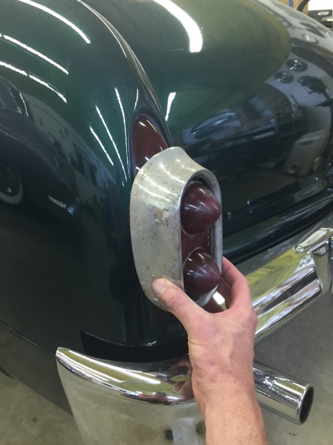

    Here are a couple pics of the Buick one held up against my fender. I really do think the chrome housing would just about match the shape of the Merc fender and make it nearly a bolt in deal, but I have that '54 Chevy Lee lens in the way to be able to know for sure. [emoji6]

    Well.....I just happen to have a set of '49 Buick lenses laying around somewhere I had intended to use on my Fleetline. Lemme see if I can find them and hold them up for a pic when I get home tonight. ;)

    Ok, here is my 49 Buick lens held up to the top edge of the fender, where I guess you would consider putting one...

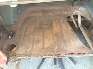

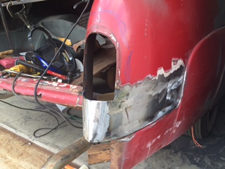

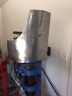

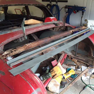

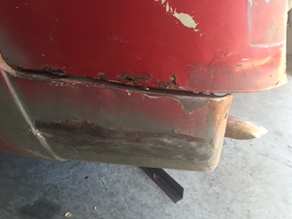

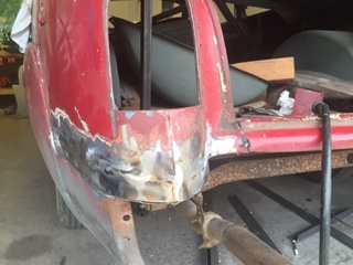

    Been working on the rear of the car, as with the rest of the Merc there are plenty of rust issues. Unfortunately I also got a close up look at the frame and it is pretty much shot- actually behind the rear axle the frame has rusted thru. Don't know exactly what I'm going to do but repairing it is not one of the options. Several large swap meets coming up so I hope to get lucky!
    IMG_0520.JPG IMG_0521.JPG IMG_0524.JPG IMG_0525.JPG IMG_0598.JPG IMG_0598.JPG
    Cut out sections
    Made rear body brace
    Made and welded in panels and floor pans. I did not use the wheel well yet as I don't know if I really
    need it.
    For now the taillight openings are the same as the original ones because I haven't had time to find the taillights I want to use. As I said earlier I plan on vertical taillights and have had some great suggestions. With the upcoming swap meets I hope to collect many needed parts!
    Next step is replace this piece, picture doesn't show it very well but it is completely rusted thru. Wray Schelin (best sheetmetal instructor I've ever met) looked at it and his only comment was "that's going to be tough to do!". Guess I'll be working on it for awhile.
    Thanks for looking, hope you had a great summer!
