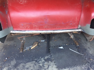

    It's hard to believe its been August since I've updated but I haven't had a lot of time to work on the Merc. so progress has been slow!
    IMG_0642.JPG As I said earlier the trunk latch cross piece was rotted out and had to be replaced.
    IMG_1833.JPG My brake is only 36 inches so I had to form the cross piece in 2 sections, weld back together and then shrink to fit. Really appreciate the shrinker/stretchers!
    IMG_1840.JPG Welded it in and trimmed it up.

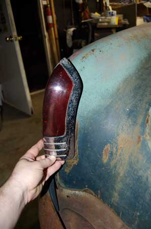

    IMG_1903.JPG IMG_2087.JPG Rear is finished but waiting for decisions on what to do for taillights. I was able to get a set of 49 Buick taillights that will fit nicely starting just above the break of the fender and I also picked up a set of 1 inch wide by 9 inch long LED trailer lights that I could French in and mount vertically, really having a hard time deciding what to do!

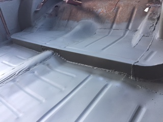

    IMG_2085.JPG In the meantime I've started on the floors and hope to have those finished in the next 2 weeks, then it will be time to decide how to finish. I've decided not to make a station wagon and am leaning toward a 3 1/2 inch chop with the vertical tail lights. I'm not into wild customs but do want something "different" so if I can't get a good idea soon I may just sell it.

    Please no trailer lights ...ever ! Baby Lincoln tail lights are the same as a Canadian Monarch, bolt right in if you could find a decent set.

    I think the '49 Buick tail lights would look great and I agree with koolkemp that the trailer lights should not be considered. Those Monarch lights are great but I've been looking for over a year and never saw a single one for sale.

    Thanks for the comments regarding the taillights, I'm trying to find a "flat" surface taillight that blends into the fender- something like the 49 buick or vertical "frenched" taillights or even the original 51 merc taillights which Mick had suggested lowering on the fender. I'm going to keep checking swap meets etc. to see if I can find the "perfect but never been done before" lights.

    I vote for the '49 Buicks over the trailer lights. The Buicks would look good flipped vertical rather than the horizontal that they were in the Buick. This pick is from someone thinking about it for a 51/52 Chevy, but the look would be similar...

    Hey Dr. Dave, you really are a GREAT salesperson! Thanks to your earlier help I agree that the 49 Buick taillight looks good and am leaning more that way but will still keep looking around until I get the floors finished.

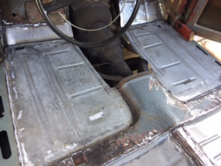

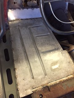

    Weather has been great lately so getting a little more done, I've gotten rid of most of the rust and replaced the lower third of the car. I'm really looking forward to the rest of the project and hope I never buy a rust bucket again!
    Started cutting out floorboards and beading them, using 18 gauge cold rolled.!
    First board in!
    Ready for seats!
    Primed and on to next project!

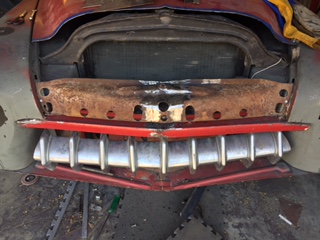

    This grill came with the car and while I don't know what it is from I really like it. The ends were butchered so I may make a floating grill out of it but I'm also looking at "flattening the hood and bar to match the V shape of the grill. In addition I plan to pancake the hood to give a better profile- should be fun!

    Pretty sure that's a '54 Chevy car grille bar with an extra bar cut down to extend the ends and some extra teeth added, I have a near identical one on my shop wall.
    It would be easier to take the center tooth out of the grille, cut the bar to give it more of a V shape, then weld the bar back together, the center tooth will cover the weld if you're careful and you won't have to touch your hood or grille shell. That's what was done to mine.

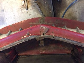

    The summer has been flying by and I havent gotten anywhere near as much done as I hoped to but at least I'm back on the Merc. As I said earlier I'm going to flatten the hood and may pancake the hood an inch or 2 depending on how it looks after taking the beak out.
    This is the stock look and I'm going to pull it back 3 !/2 inches and arch the hood to match the grill.

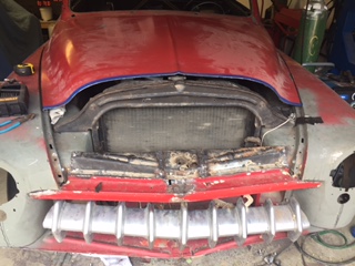

    The profile now looks like this and I'll pull the hood back to match.
    The splash pan has been trimmed to follow the new profile, this will be a template for a new splash pan.

    As I said earlier the grill ends were butchered so I've trimmed back the ends but don't know if I'll leave it like this or trim it close to the guard and then "float" the grill. I'm also not sure what I'm going to do about a bumber either, been thinking about rolling a pan and not doing a bumper- too many ideas and not enough action!
    So far I'm happy with how it looks but obviously have a long way to go! Thanks for looking.

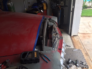

    Progress is slow, spent quite a bit of time planning how I wanted the hood line to look and at least have a plan:
    Cut hood
    Cut and reshaped hood latching bar
    Pulled hood pin bar from hood
    Reshaped latching bar and installed
    Started making patterns for finishing hood
    I still don't like the final shape of the hood (too high) so am planning to section or pancake the hood going from o inches at the windshield to 3 inches at the front fender. I think that will get a flatter smooth look that I'm trying to achieve.
    Thanks for looking .and I do hope to get more done with fall here!
