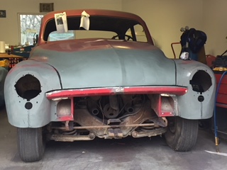

    Finally got a little more done but obviously a long way to go!
    Decided to section hood 2 inches which resulted in a 4 inch drop (hope that makes sense).
    Began filling in new pieces
    And finishing
    Ready for Dewey!!!
    Before and after
    Still have some fitting issues to take care of and after that will make the apron and mount the grill, hoping a lot faster than I have been so far!
    Also a good friend of mine is working on the 53 Buick stainless headlights and says he is almost finished. I don't even want to guess the hours he has put into straightening these out, I know I would never have the patience to do it! great to have good friends.
    Thanks for looking.

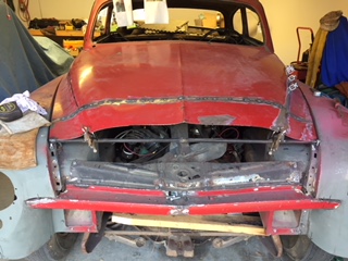

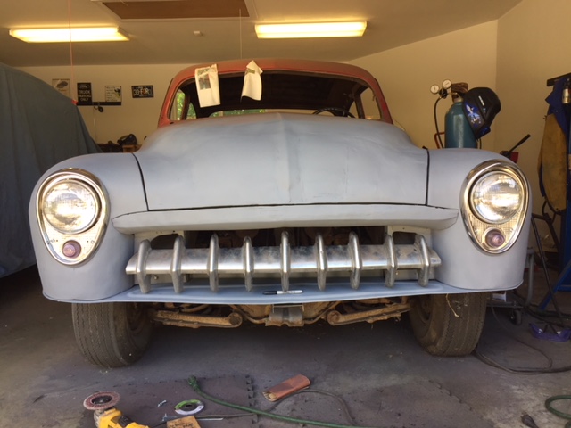

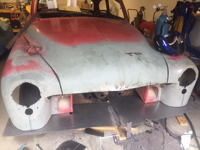

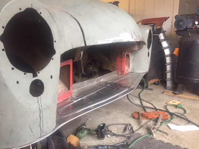

    Cut out the apron pattern, bead rolled and lipped it:
    Decided the grill opening was too tall so slit the bar and widened, filled gaps where needed:
    Primed it and re***embled- the rims my friend reworked for me turned out great but I'll never know how much time he spent on them, really appreciate his help!
    Next I'll permanently mount the grill, cut and fit the bumper, then plan to start the top chop. So far so good, thanks for looking!

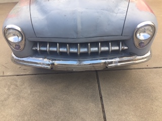

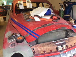

    Still slow progress but at least getting something done!
    This is the gap created by pancaking hood.
    Wanted to keep center section so started with that

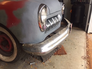

    Narrowed and tucked bumper but eliminate guards
    Trimmed to mold around fenders.

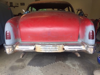

    Trimmed and molded rear bumper the same.

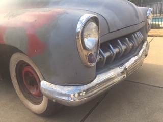

    Tried at least 10 different taillights from a 49 buick to cadillacs to LED lights and didn't like any. Happen to see a Merc. posted here with taillights I really liked and posted asking what these wonderful lights were from to which Dr. Dave posted the obvious, a '51 Merc.!
    Trimmed the housing and installed, I wanted a flush fit and hope to find some plain red lenses- I thought I had seen some a couple of years ago on a Merc. but if I cant find any I'll try to make some.
    I like the look and appreciate whoever posted the original.
    Slowly getting done!
    Next is pancaking the roof and chopping the top. I plan to take a total of 4 inches out of the top, probably 1 inch pancaking the roof and 3 inches chopping it. I won't do anymore that that as I want to be able to comfortably fit in the car.
    As always thanks for looking and appreciate any comments/suggestions.

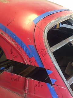

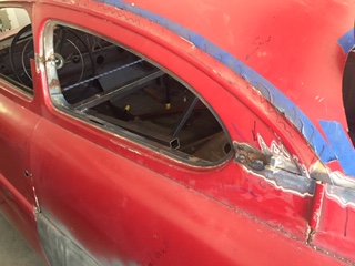

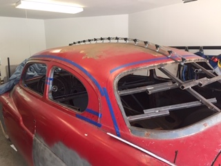

    Nobody accused us of being fright, picked the hottest day of the year to start the chop!
    Sancho and kidcampbell71 like this.
  22. wide34
    Joined: Mar 2, 2006
    Posts: 716
    wide34
    from Texas

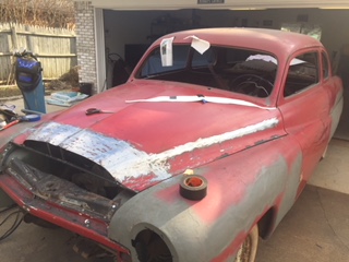

    Templates set, doing a 3 inch chop and will then pancake the hood 1/12 inches
  23. wide34
    Joined: Mar 2, 2006
    Posts: 716
    wide34
    from Texas
    Door posts, c pillar welded in place, A posts will take some work
  24. wide34
    Joined: Mar 2, 2006
    Posts: 716
    wide34
    from Texas
    Will lower rear window in place next. Thanks for looking.

    I've been looking at the A posts and may change the way I'm going to finish the chop. As I said earlier I'm going to pancake the roof which will involve cutting off the roof top panel so it would seem to make sense to cut the front half of the roof off about midpoint of the door and then move forward and weld back in place. This should minimize the stretching I would have to do to the posts- does that make any sense?
