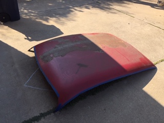

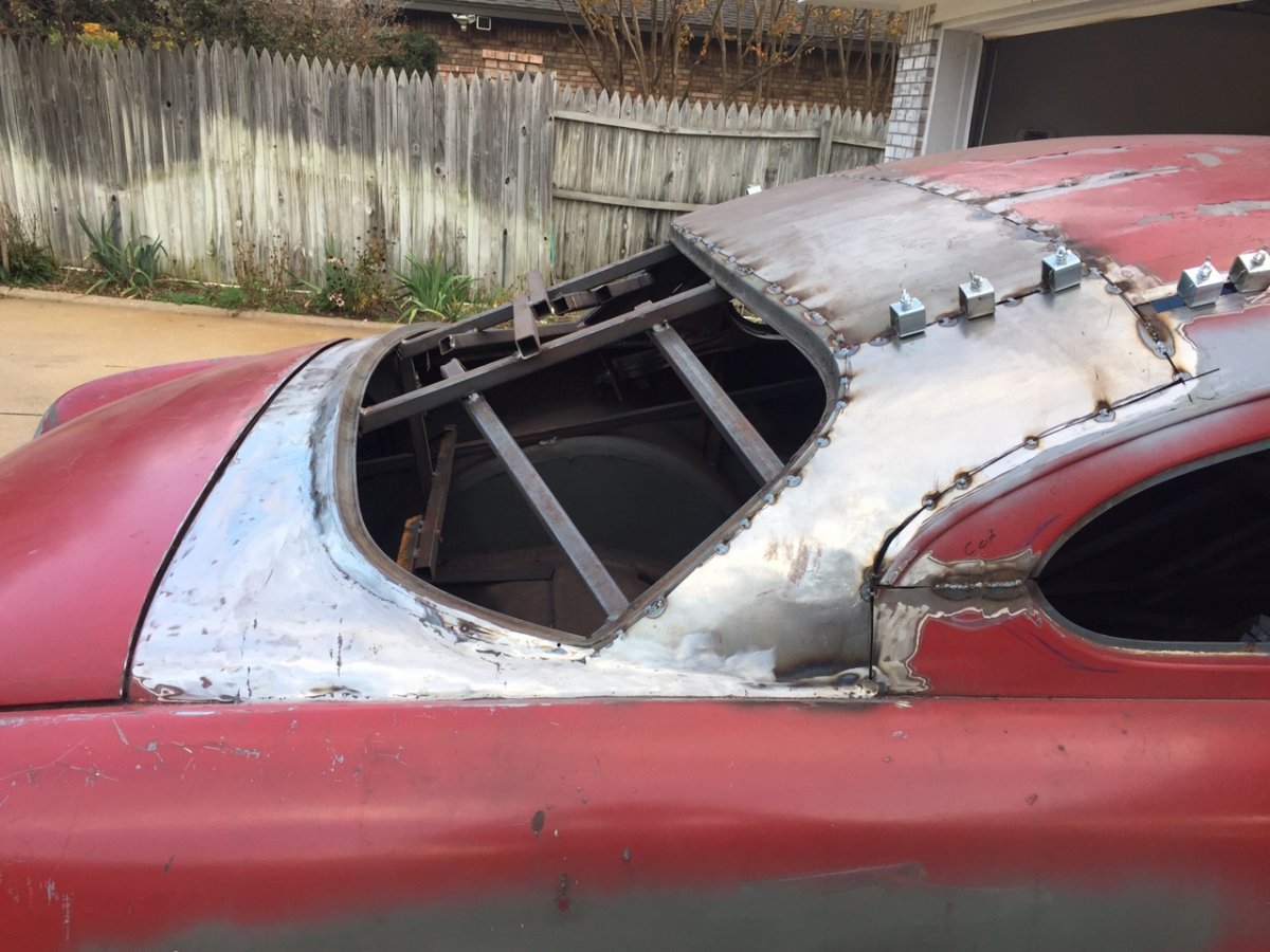

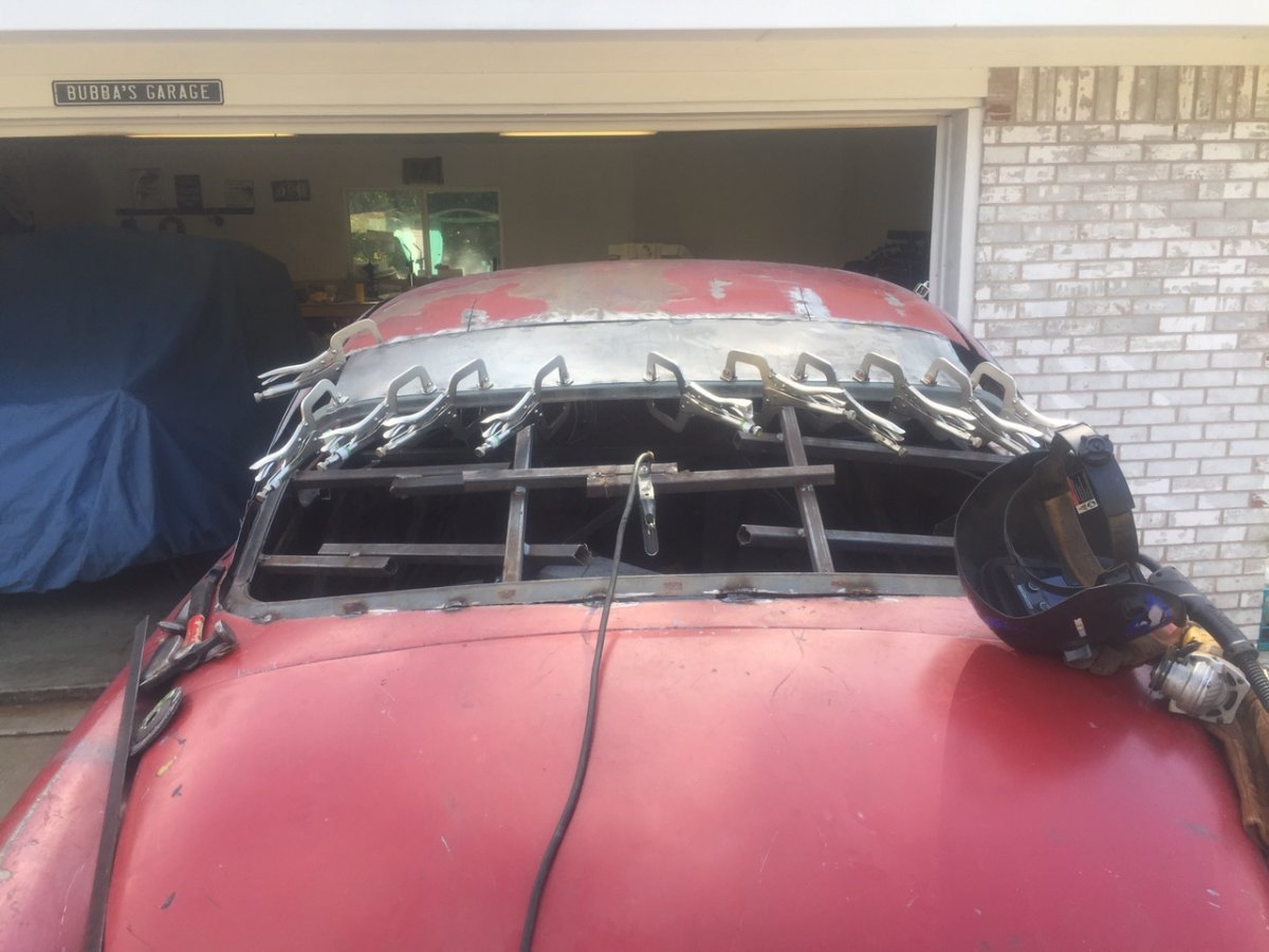

    Finished pancaking the roof, I would have liked to lower the entire roof line another 2 inches but as I said in the beginning this will be a "driver" and as such it will be comfortable so I lowered it as much as I could and still fit in the car
    Trimmed 1 1/2 inches from the header
    Trimmed 3/4 inch from both sides
    Tacked in place, we did reverse roll the roof but my English wheel is mid size and unfortunately we left some creases in the roof- will pound out later.
    Finished welding roof
    Ready for paint!

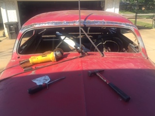

    I really would have liked to use a 49-50 rear window but they are far more expensive in this area than I'm willing to spend so will stay with the 51 window. I'm planning to keep the back of the lower window in place and lower it while raising the roof to end up with a uniform blend and then fill in the gaps (hope that makes sense). If I run into trouble fitting it I can always slide the window forward but I prefer the "longer" look.

    Unfortunately one of the problems with lowering the roof is that the corner of the rear window falls below the belt line and I would like to use the chrome strip. I’ve been moving window around and looking at raising the roof to find the best way to do it, may take some time to get it right!

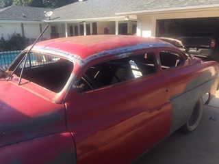

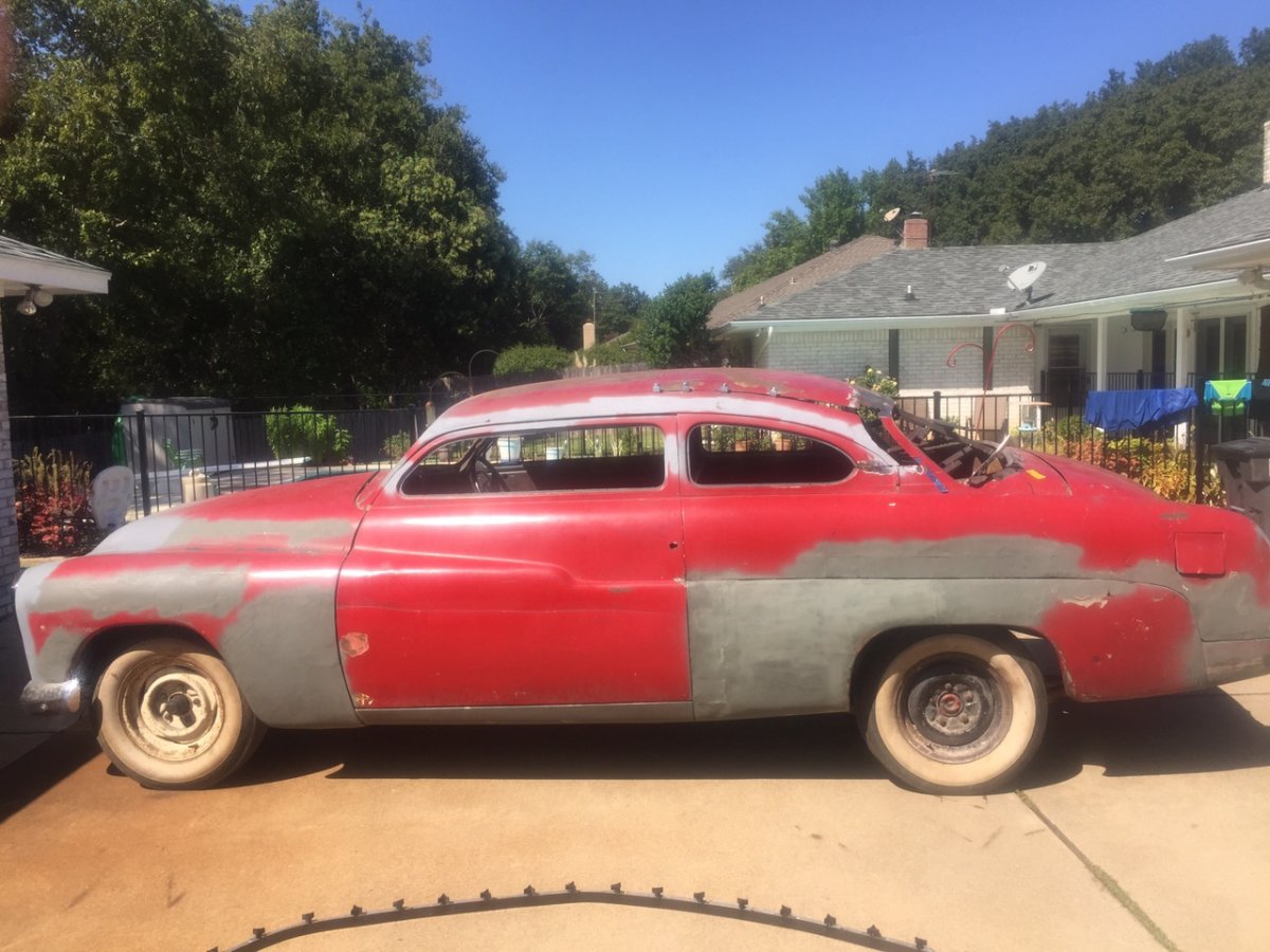

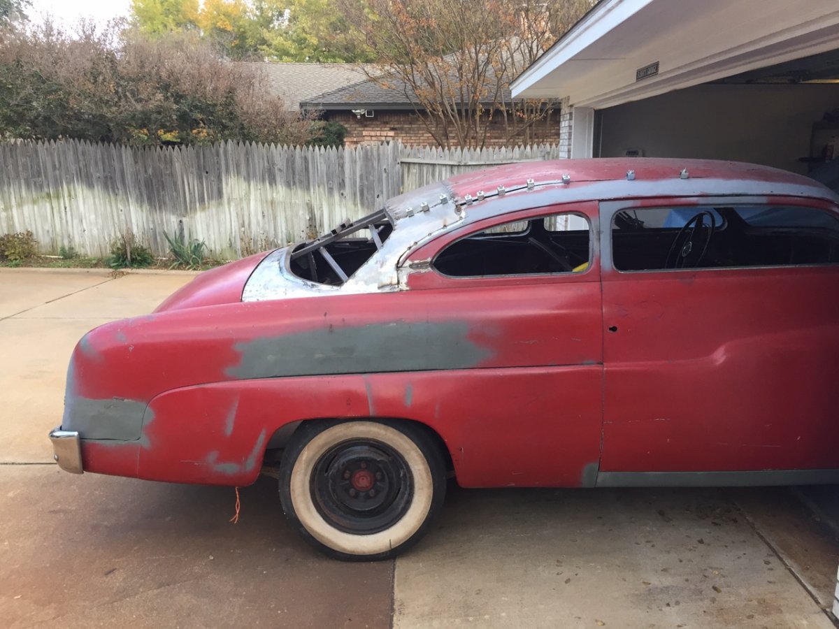

    By pancaking my roof I’ve really created a low roof line to blend into so I’ve raised it but would appreciate any comments on the look-
    From these 2 angles I think it looks ok
    But when I lay my scribe on top the rear roof line looks way to high
    Appreciate any comments but I think I’m going to have to drop the window more to make it look right and the cut out the belt line which I had wanted to save.

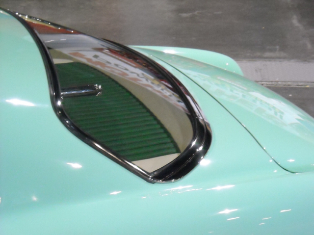

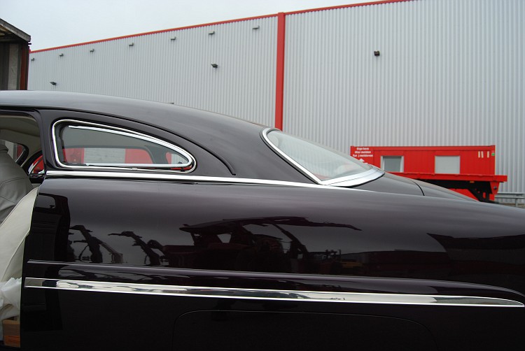

    Yeah, I'd agree, I think you might be coming back up too far in the back which kinda makes the flow go the wrong direction. Thank goodness you are able to get the car out and be able to mock it up and stand back. You'll find just the right spot, I know it! :)
    Here's a **** Dean '51 Merc chop with a '51 rear window. This is probably the most laid down '51 window ever, so there's hope and a place for your window. ;)

    That is one of the best looking chops I’ve seen. Would really like to duplicate it, better get back to work[emoji4]!

    Does anyone know where I can find a back window as flat as this one? Every window I've seen including mine has a "hump" toward the bottom. Thanks for any help.

    I agree with you, that is the flattest '51 rear window I have ever seen. Mine had a big hump in it, too, but towards the top. I happened to have a friend who ended up with a pile of Merc parts, including several rear windows. I went through the whole stack and picked out the flattest one. Seems there is quite a bit of variation in them from the factory. I didn't know that until I read the Rodder's Journal article on Mercury Charlie's Merc. He went through I don't remember how many rear windows to get a flat one that fit the flow of his chop.

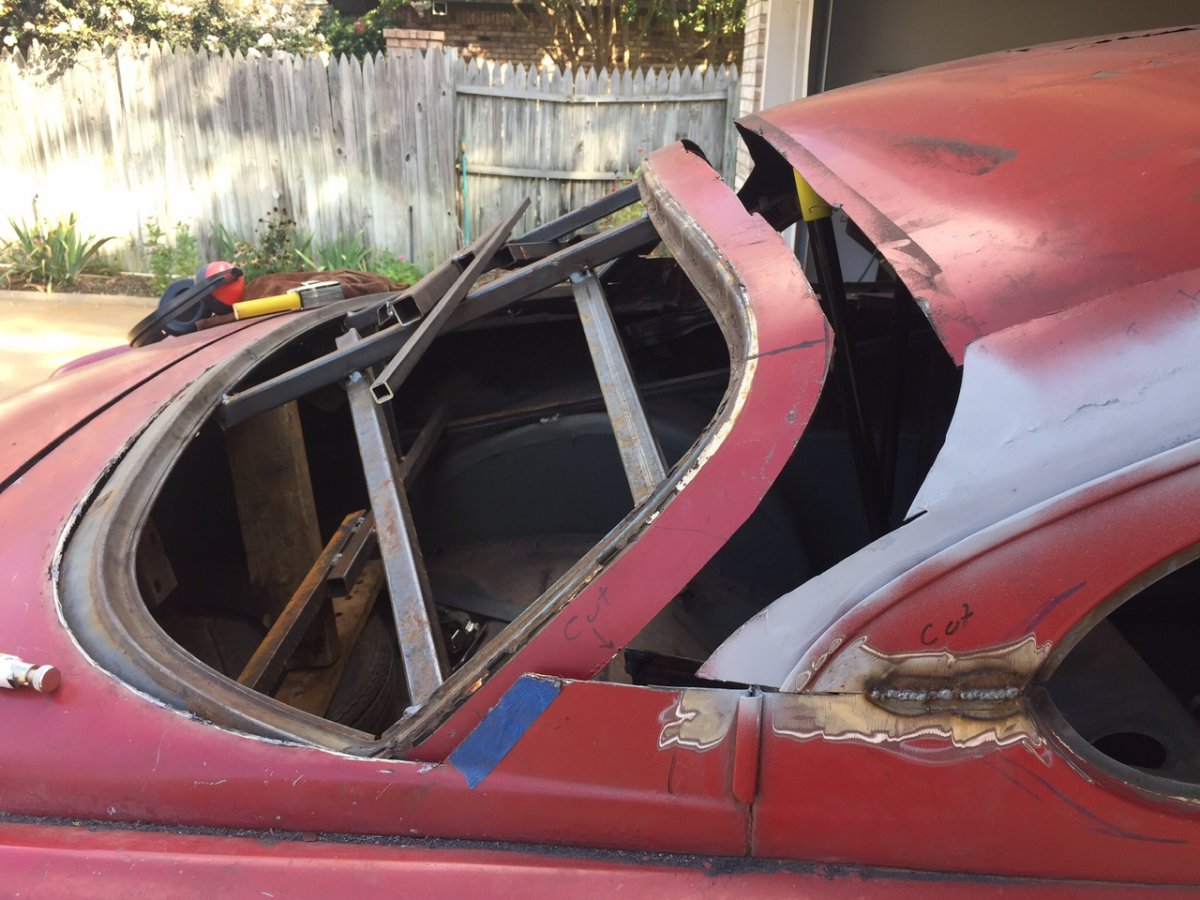

    While pancaking the roof resulted in the look I wanted it also created problems with blending in the rear window. I had wanted to keep the back of the window attached while lowering the front to meet the roof line but I wasn’t able to do that so had to cut the window free and reposition.
    Once that was done started filling in the side panels
    I believe I’ve got the flow I wanted but won’t know for sure until I can lay the window back in.
    Back to finishing up!
    Thanks for looking.

    Rear window is secure now, I think I’ve got the angle right but won’t know for sure until I can set the window back in. I am looking for a flat window and do appreciate the suggestions, would really appreciate it if anyone knows of one for sale.
    Will finish the rest of the welds, remove the bracing and start putting the package tray etc. back in place. Thanks for looking.
