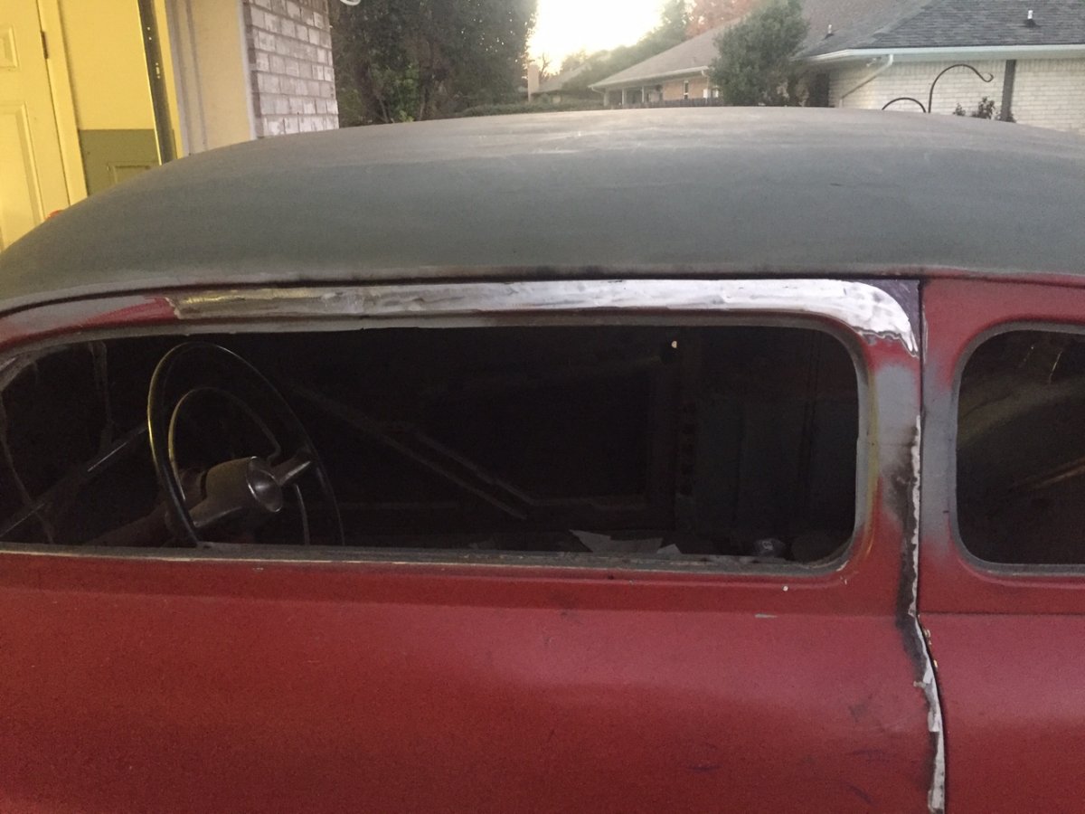

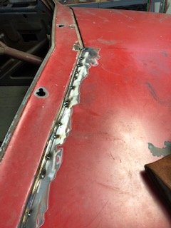

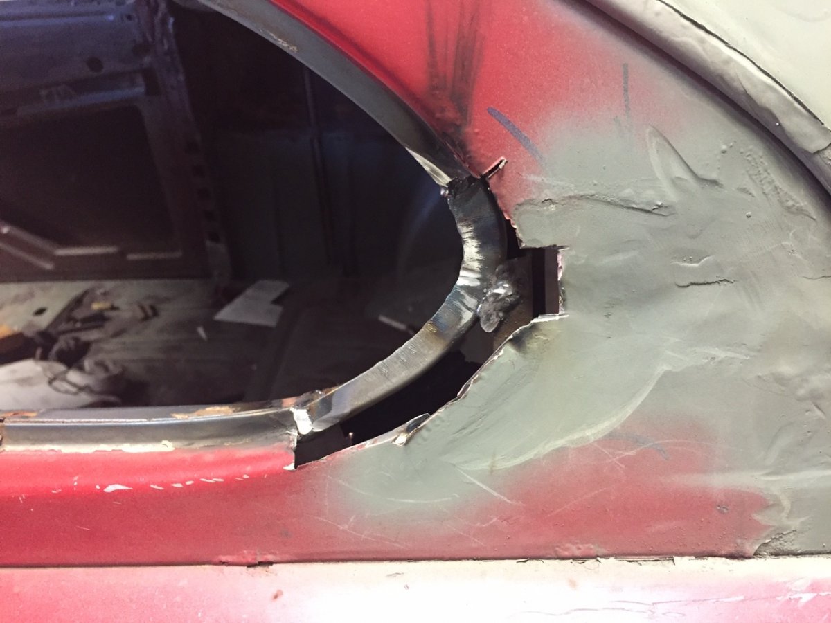

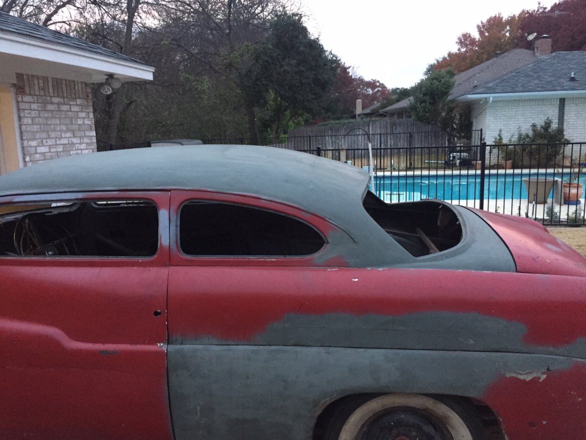

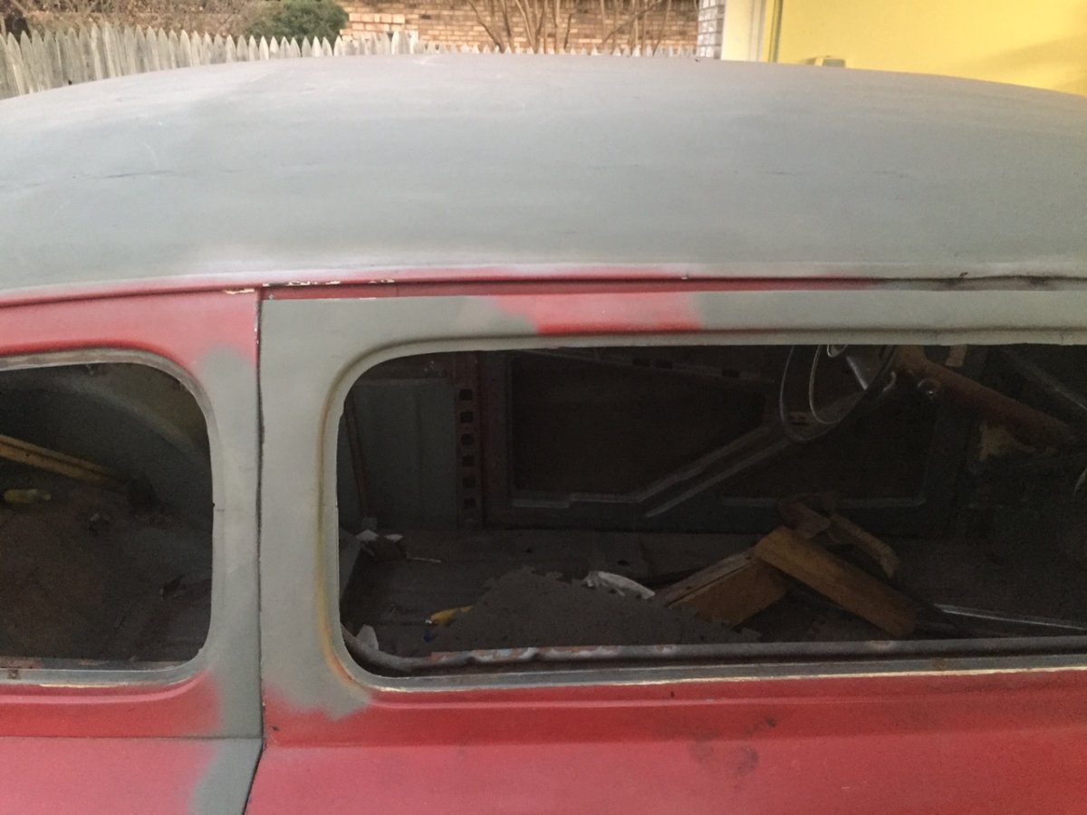

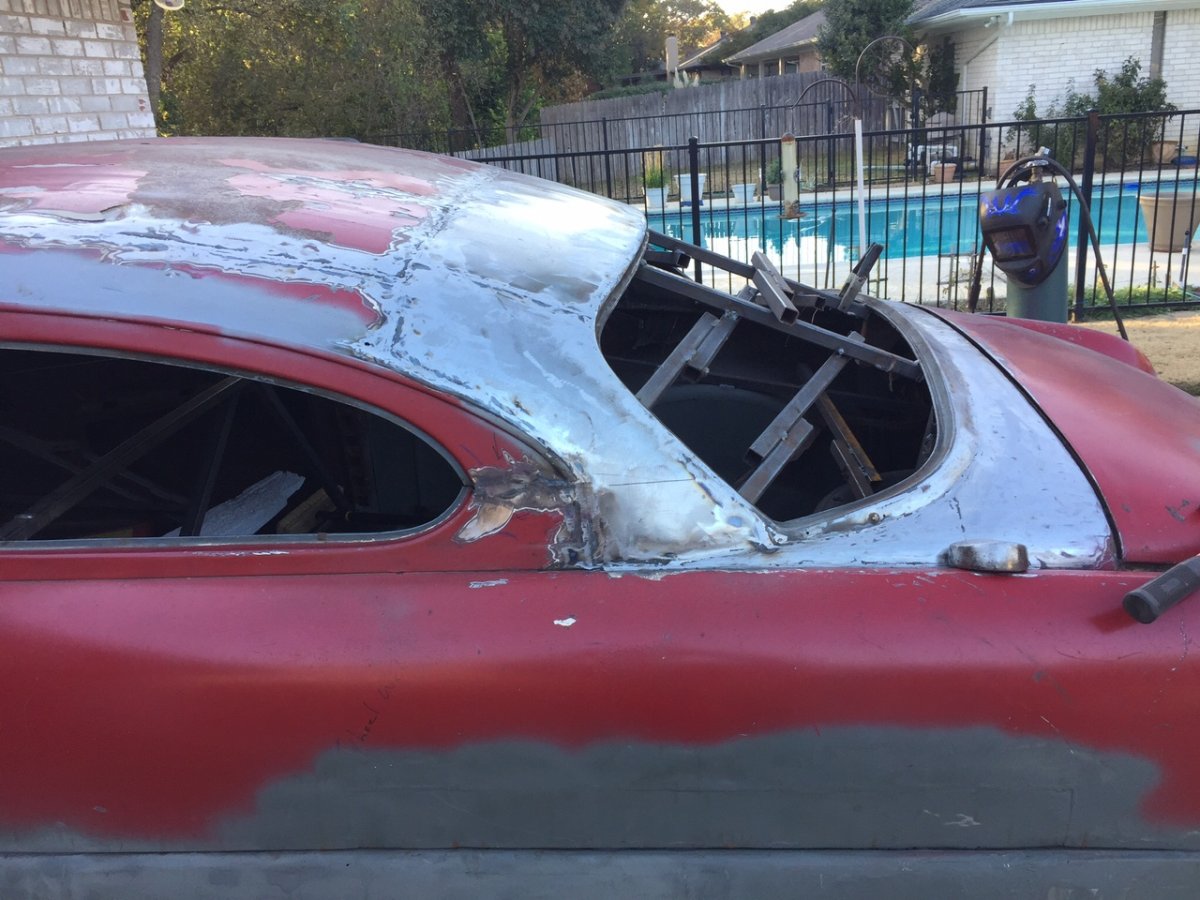

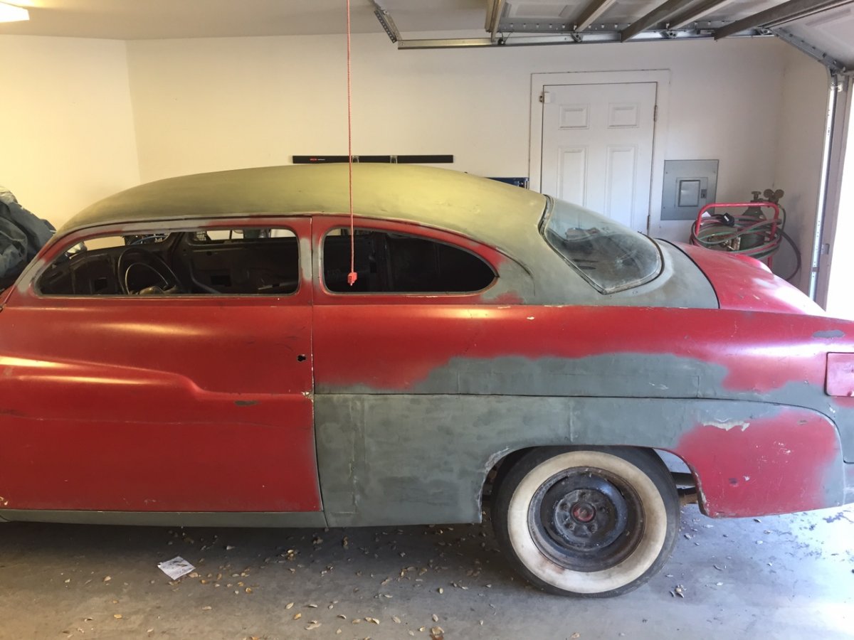

    Finished welds
    Removed bracing, Sanded down roof and primed.

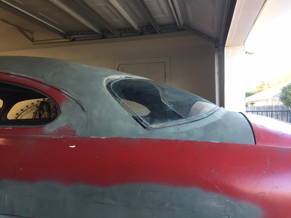

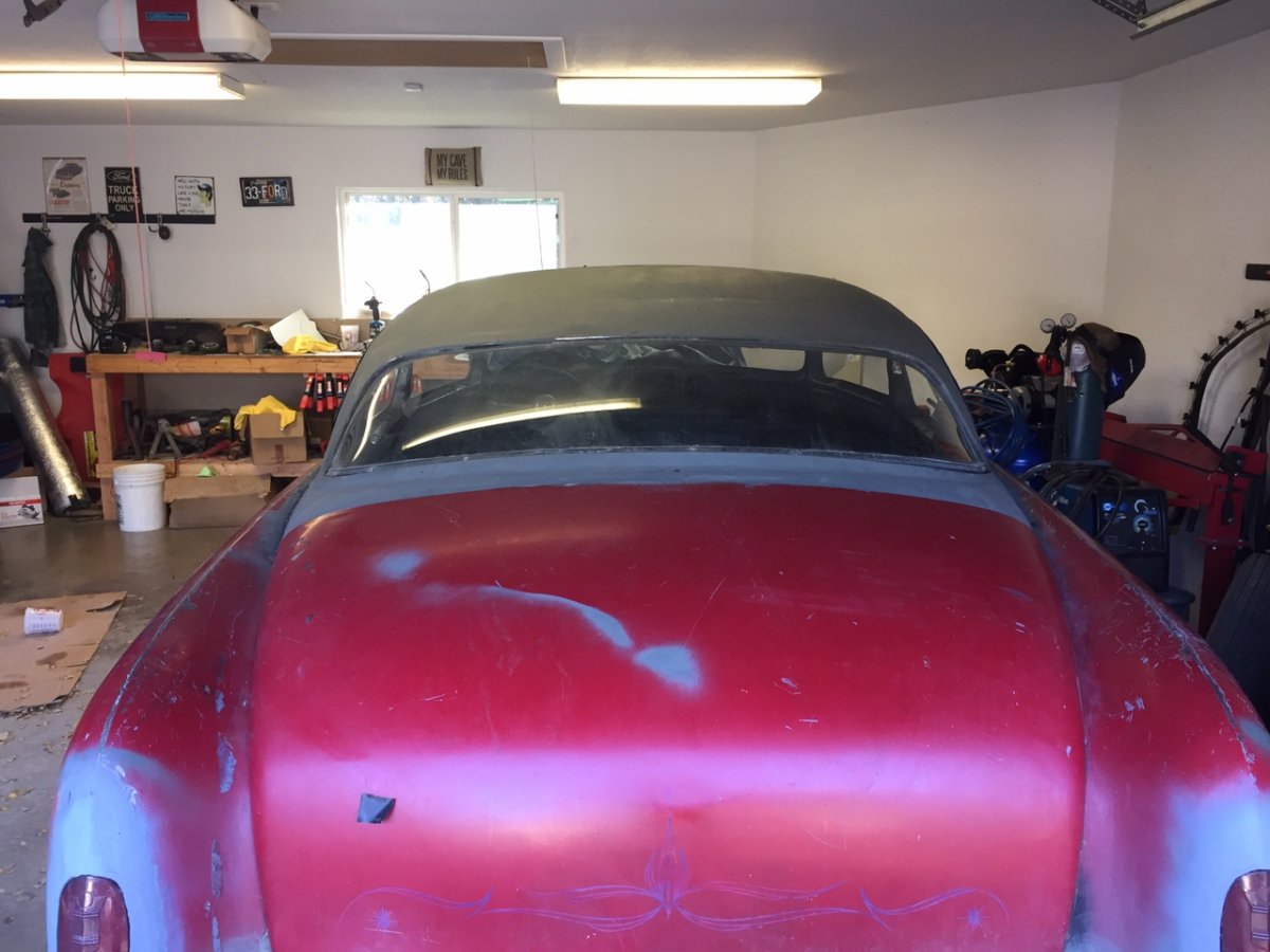

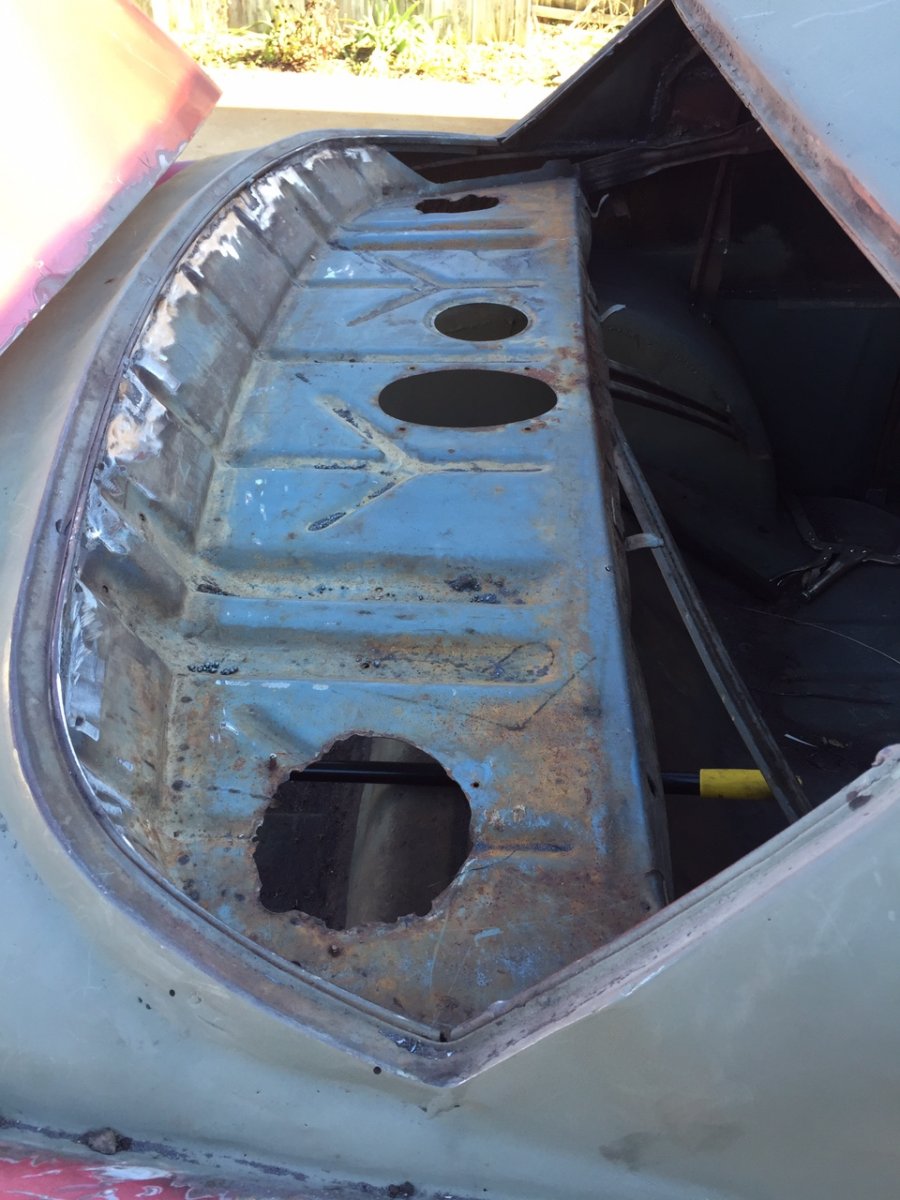

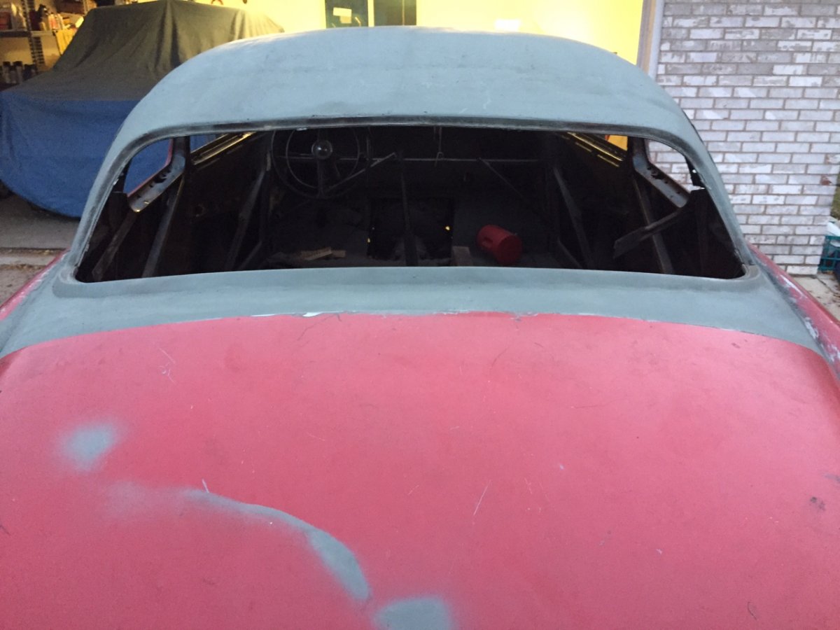

    Reinstalled package tray and bracing

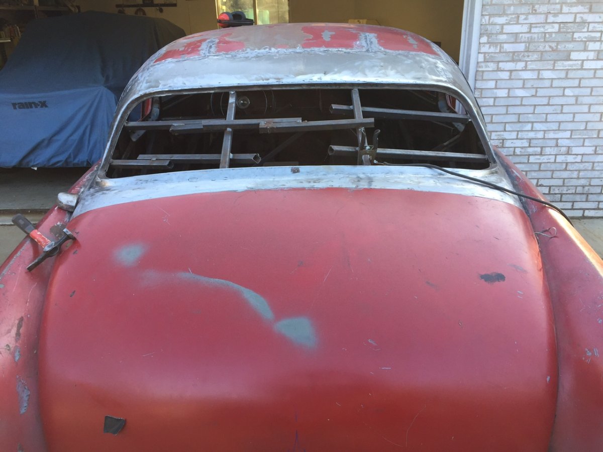

    Laid in rear window-
    Will be finishing up some patch pieces and then going to get it chemically stripped and dip primed. Happy with it so far[emoji4]!

    Looking good!!! Really like how the body line came out at the bottom of the window for the lower piece of trim. I saved all those pics to my reference folder for when I redo mine. :)

    Great job on the rear window. It flows nice without the hump that many end up with to disrupt the smooth transition.

    Really appreciate your comments, I'm looking forward to seeing yours when its finished- hope you get some time to work on it. I keep looking at mine thinking "if I really busted my **** I could be ready for Stray Kat", then reality sets in when I think about how much I have left!
    Thanks for the comment, it took several tries to get it there but glad I kept trying.

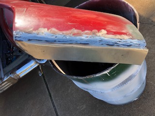

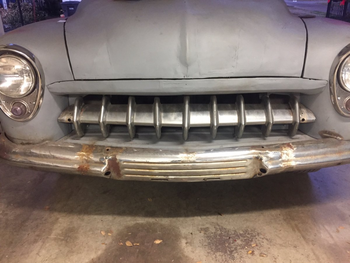

    Starting the detail work, finishing quarters:
    Filling gaps in doors
    Finishing details are not my strength so I need some advise- would doors look better rounded off?
    If the doors would look better how about the hood and trunk?
    Appreciate any thoughts and thanks for looking.
    Sancho, Squablow, drdave and 2 others like this.

    I would round the corners on the hood and the lower trunk.If you were leaning the post I would definetly round them.If your not rounding I think they look better straight IMHO

    Brilliant-using the 51 rear window is the only way to go. That flow is perfection to the
    profile look from the windshield to the rear of the top. I really admire your thinking.

    I agree....since all the other corners are square, I’d keep everything matching and leave the doors square too

    I agree all corners have to be either rounded or left square- I’m having a hard time deciding which would look better but am coming around to thinking the hood would look weird rounded.
    Decisions decisions decisions......[emoji4].

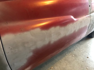

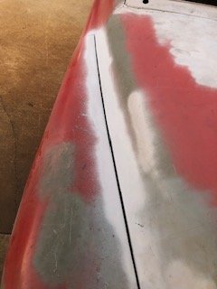

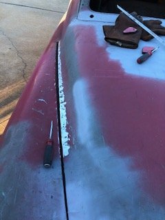

    Filling gaps, because of repositioning the hood and roof I've got lots of them:

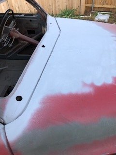

    Pulling dents and getting latches installed:

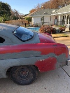

    Bought new rear window gasket and laid window in opening to make sure there wouldn't be any gaps. Someone else will have to install it for me!

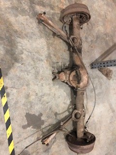

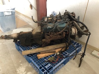

    Found a 351, c6, and 9 inch rear (I'm a ford in a ford guy!). 351 is from the 70's so definitely will be rebuilt, amazing the top end kits that are available. Thought seriously about trying the coyote engine but in the end knew that I couldn't program it and I still like to have some control over how it will run:

    Man, you’ve been busy!! Lots of good progress. I will have to say with the back window, I had installed all my other windows myself, but was nervous with that back window, so I paid a pro to install mine after I painted the top half of the car a few years back. Took him four hours. Drove the car to Indy and back and when I got home I noticed the bottom of the wi Dow had popped loose from the body. Decided to try fixing it myself, so I pulled the whole thing back out and dad and I had it reinstalled in less than 20 minutes. Still in, no leaks. You can do it!

    Now I know who I’m going to call to put it in[emoji4]! I hate to admit this but it took my son and me an hour just to get the gasket on the window!

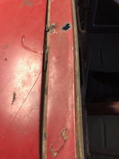

    I think (hope) I've finally gotten rid of all the rust!
    The doors weren't as bad as the rest of the body so very thankful for that!

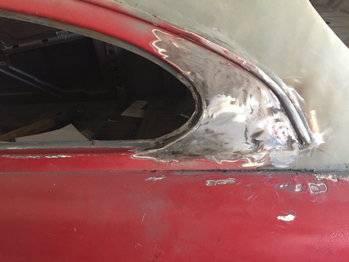

    The left rear fender was worse than I thought, there are several layers of metal covering up the rust in the front photo and while I tried as hard as I could to find a replacement fender there just doesn't seem to be any out there so remade the front half of the fender
    I'm hoping that end the rust battle but still have to get the body stripped so time will tell!
