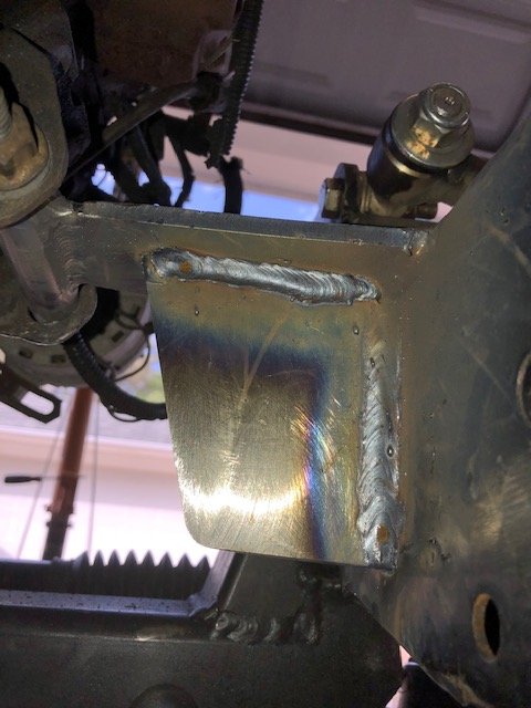

    Made up mount brackets and welded in
    Motor angle is closer to 9 degrees as it sits now, don't think it will be a problem with the new rear sump pan.

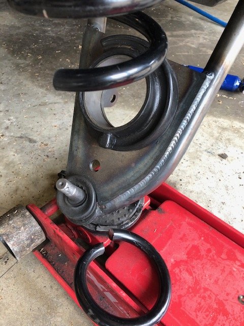

    Exchanged the dropped spindles for regular height spindles and installed. With the engine in the springs were way to stiff so cut 1 coil,
    Arms still aren't parallel but I'll wait to do any further cutting until I have all the weight back on the front end.

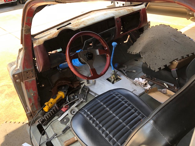

    Continuing to put Merc together.
    Finished building transmission tunnel
    Found out I had a FMX transmission instead of a c-4 so had to modify shifter to fit
    ****oned up and ready to start on the steering.

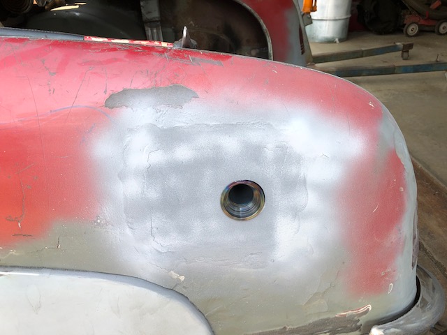

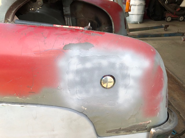

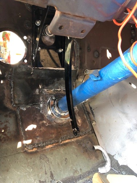

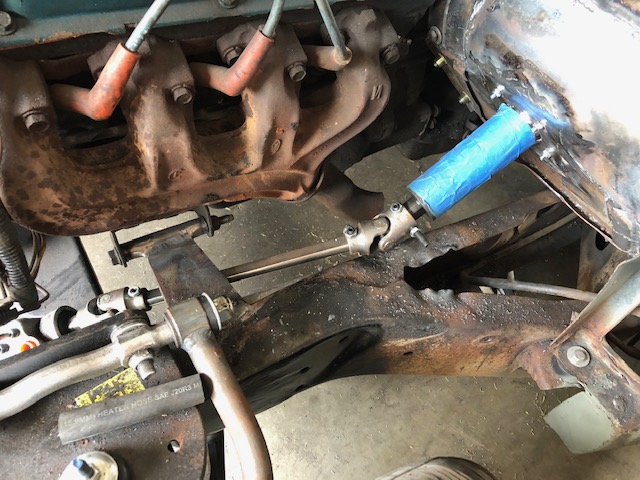

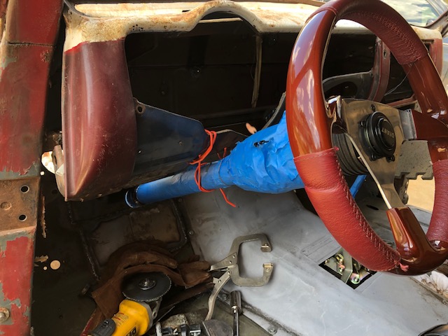

    Still haven't decided on the seats but need to make a decision this week if I'm going to get the body to a sandblaster by Sept. 1. In the meantime have completed the detail stuff that needs to be done to get the rest of the car ready for blasting (that just sounds bad doesn't it.
    Installed the steering column and joints.

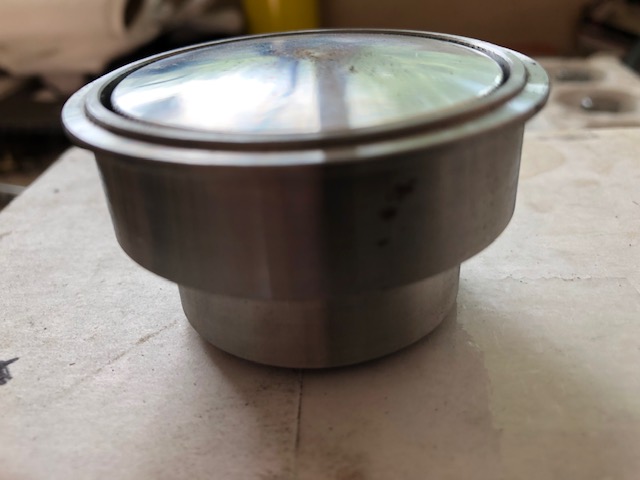

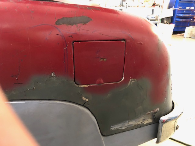

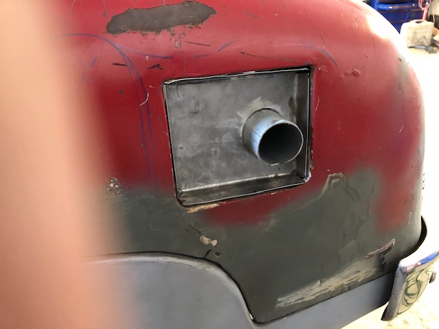

    I found a motorcycle gas nozzle that I liked and eliminated the gas door.
    IMG_1613.jpg IMG_1617.jpg IMG_1616 - Copy.jpg IMG_1618 - Copy.jpg IMG_1619.jpg

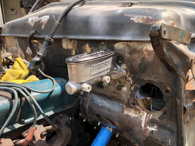

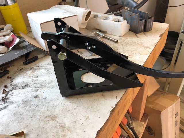

    Found a brake ***embly with a 10 inch arm that combined with a wilwood 15/16 inch piston will allow the Mwrc. to stop without power brakes. If it wont I'll most likely go the hydro boost route.

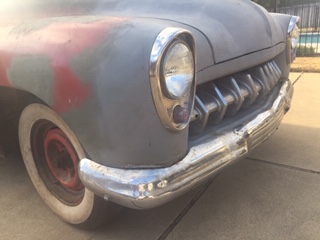

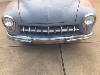

    One thing I'm still debating and would appreciate comments on is the headlight rims. Originally I was going to french them in but a friend of mine spent a gazillion hours straightening out the rims and they look great so I felt I needed to install them as is. Still not sure that's the right answer.

  24. loudbang
    Posts: 40,351
    I vote for leaving them alone do not french :)
    drdave, Slopok and echo ed like this.
  25. Squablow
    Joined: Apr 26, 2005
    Posts: 19,046
    Squablow
    I also vote for a no-french, and maybe some less obtrusive parking lenses.

    I really appreciate your taking the time to post. Not sure what I can do about the parking lens but I won’t French them in, funny how I keep changing my mind!

  28. guthriesmith
    Joined: Aug 17, 2006
    Posts: 13,241
    guthriesmith
    Another vote for not frenching them in. I like the look as is. And, glad to see you are making some progress!

    I sure appreciate your comments and as I said earlier I’ve decided to leave them as is. I’m trying as hard as I can to make Stray Kat next year but as we all know sometimes life doesn’t let us do what we’d like to do! Hope you are doing well.
