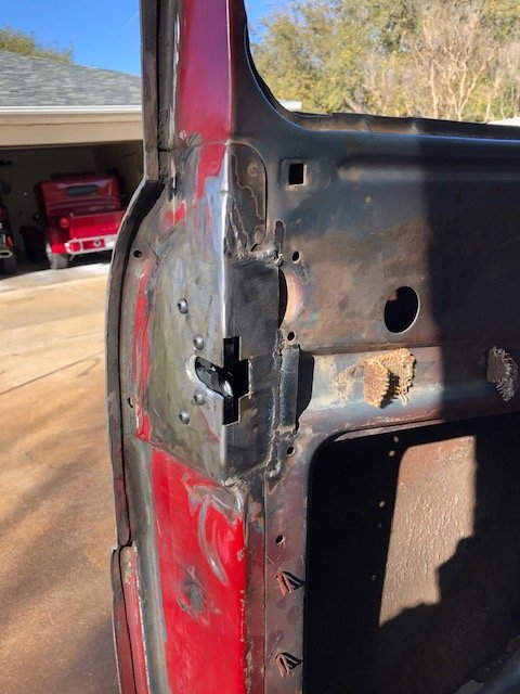

    Decided I wanted to eliminate the window wing and go with a single pane gl***. Wanted to use the Nu Relic regulators but the drive motor sits under the vent wing window so no room for the single pane gl***. Went with the Specialty regulator and it fit nice.
    I'm a big fan of bear claw latches and the installation in a Merc. straight forward.

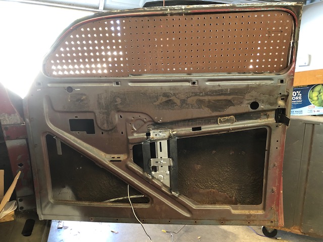

    This is the final look of the car, waiting for some door solenoids and will then tear it back down and send to media blaster.

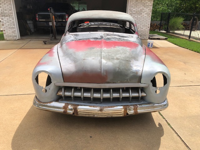

    Did get it back from the media blaster (as with everything else nowadays a week turned into a month!) and really happy with the workmanship and the fact there weren't any new rust areas. There were spots where they had to take off more than an inch thick bondo (someone bondo'd right over dents etc.) but I'm really amazed at how well the bondo held up as it was done at least 40 years ago!

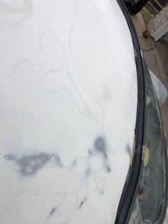

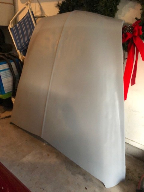

    I've started on the body work, hood is finished and yes there is some bondo on it as a skim coat, my metal work isnt that good!

    Thanks Dr. Dave, I'm able to keep it to a skim coat but am amazed at how good of "sculptors" some people are and how well the old putty looked. I often hear stories of thick putty falling off etc. but this putty wasn't going anywhere. Don't know if anyone remembers "Black Magic" putty but it was popular when i was a kid and rapidly replacing leading. This putty was much better than Black Magic yet was at least 40 years old!

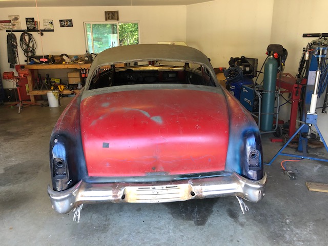

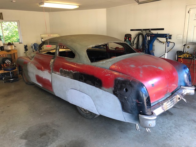

    Setbacks keep slowing me up but am making a little progress. While working the roof I discovered that the rear window frame twisted at some point, my guess is either when I put the body on its side to finish the bottom of the car or when the media blaster put it on his rotisserie. I had taken all the window bracing out prior to that, lesson learned the hard way.
    I had to pie cut and weld frame to get back to straight, gl*** back to fitting!

    Finished working the body and primed, painted the firewall but color is a little darker than I want. I will have someone else paint the car as that is definitely not my talent so hoping they can come up with a better color match .

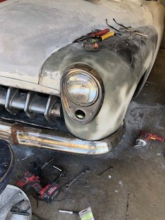

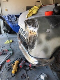

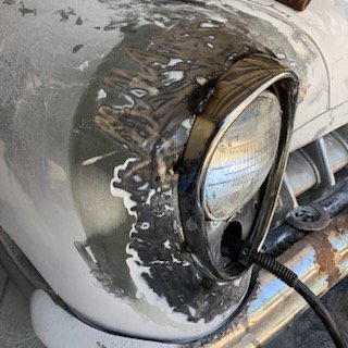

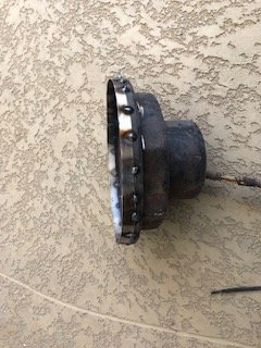

    Still plugging away! One reason this keeps dragging on is that I change my mind about how something looks! Current example is the headlights. I was going to use the 53 Buick frames and leave them exposed but the more I looked at it I didn’t feel they flowed into the fender.
    Decided to french in the frames, added 1/2" to the buckets to get a deeper offset.
    My friend had really cleaned up these frames so starting to weld them really seemed wrong but he was ok with it!

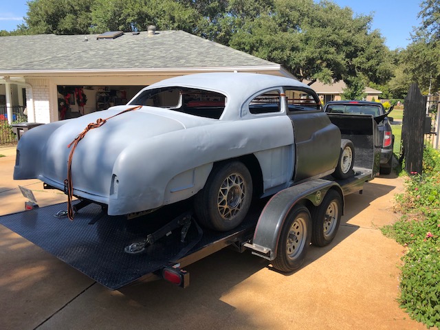

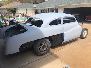

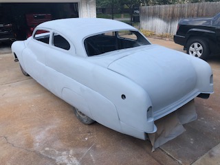

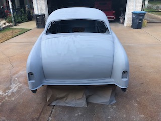

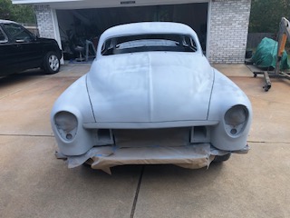

    Finished body work and primed
    Really glad that's finally done, not my favorite thing to do in the Texas heat!

    Man, you are about to gravy time now! Nice job on the headlights, I really like the flow with them molded in.

    Looking great and I also love the way the Buick headlights flow being molded in! :cool:

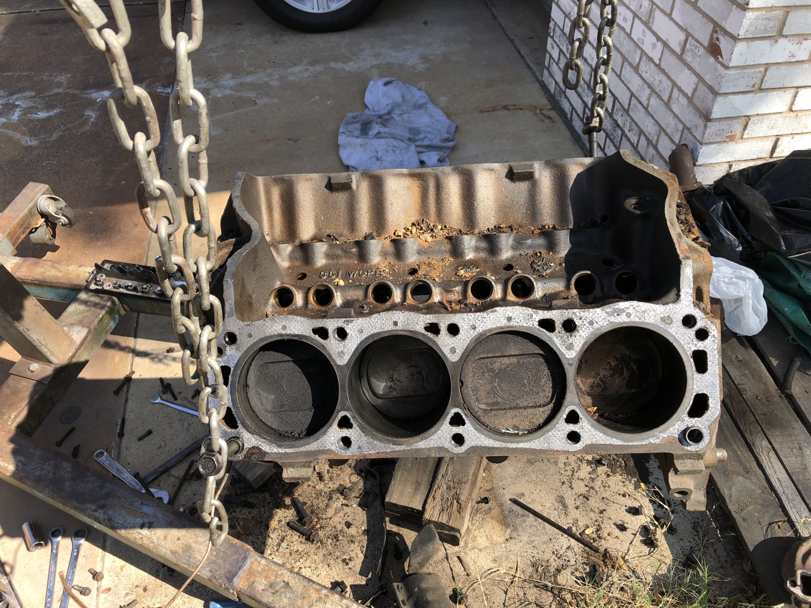

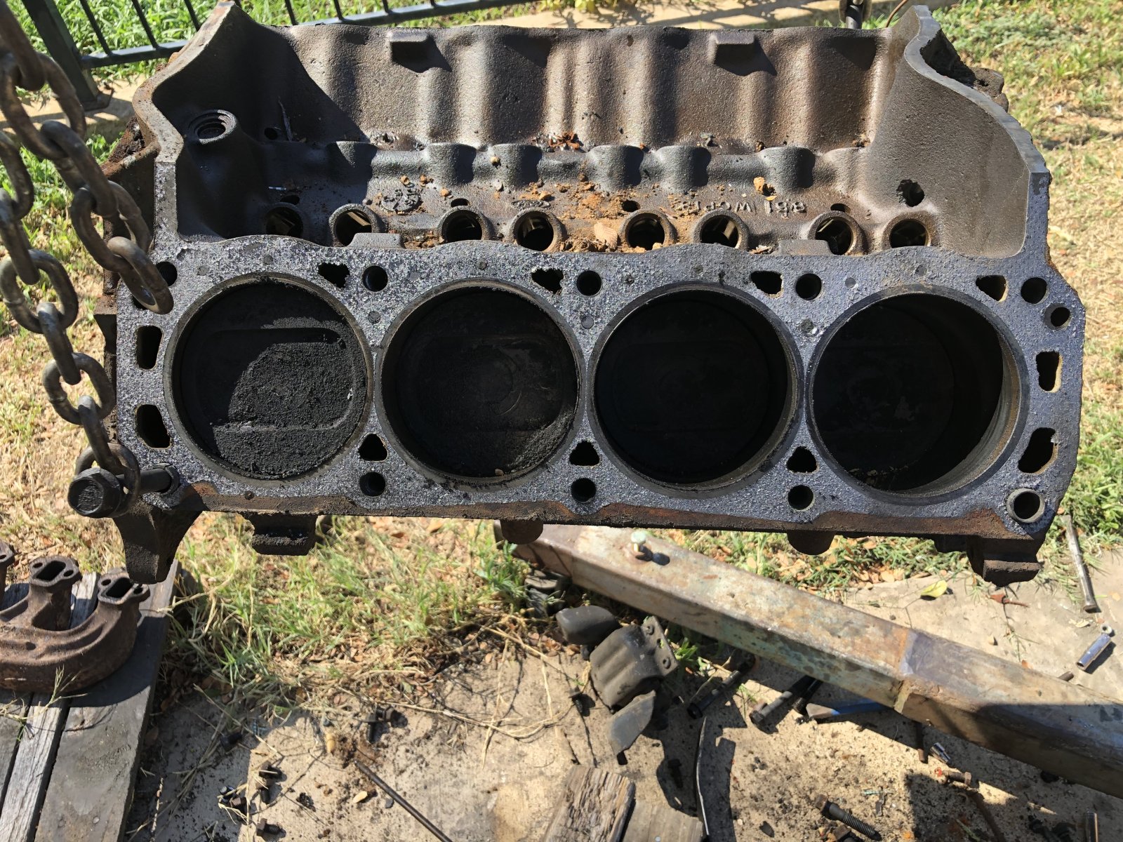

    Really got lucky with the 351w, cylinder walls are like new, bearing clearances good. Will get vat treated and then ***emble- was able to pick up performance heads, intake manifold, and cam at an auction. Will have local transmission shop rebuild fmx transmission.

    Nothing is ever simple for me! My engine is turning into the engine from hell! Took it to a machine shop that has done our forklift cylinder heads for years and after not hearing anything for 2 months thought it might be a good idea to check on progress. Answer was "you need to come and get it, I can't keep any help and simply cant get to yours!". Really sad as this is a third generation business that has always done good work and when I picked up my block there must have been 50 other engines waiting to be worked on. Owner offered to call around and see if anyone else could do it and story was the same. I contacted one of the major shops and while they could do it the wait list was a minimum of 3 months to start on it but they recommended another shop that grinds their cranks and he only had a 30 day backlog. Now the $'s start to flow, he found one of the cylinders needed to be sleeved so here we go again! Hope to get it back before the end of the year.
