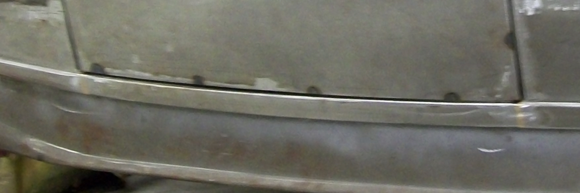

  6. As I remember them a Brake don't do ya much good for the outer Rockers. They have a Bow as well as an arc. I guess I could go put a strait edge on the bottom of my door to double check. I kind of remember some story's about a member getting some on and not being able to close the Doors due to the lack of shape. His were made in a Brake.
  7. If so, I can do two things.
    One is bend the outside profile. Shape with a shrinker then add the door sill area. And then bend the lower flange.
    The other is bend the outside profile, then apply heat along the flange edges in small areas to shrink it. This will arc the rocker slightly. Then add the door sill area
    I made a this rocker in a brake then manipulated the shape to arc
    Pist-n-Broke likes this.
