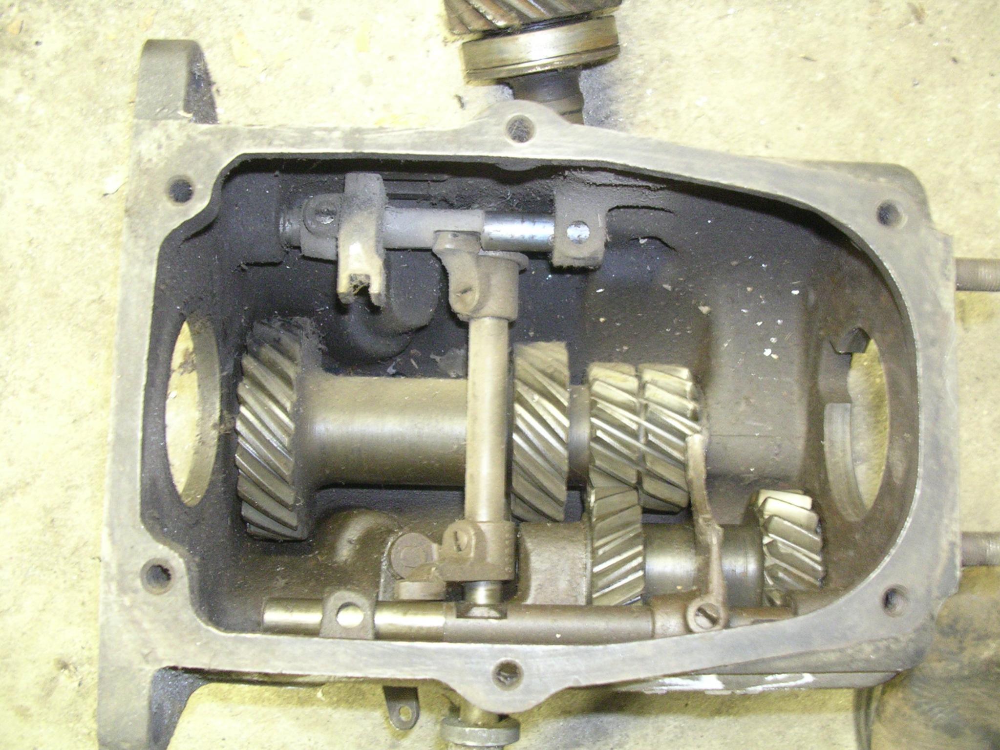

    Any interest in trying to share info on this thread? I can put up some pics later of a Selector case without the upper shafts so you can see how the small and large levers work.

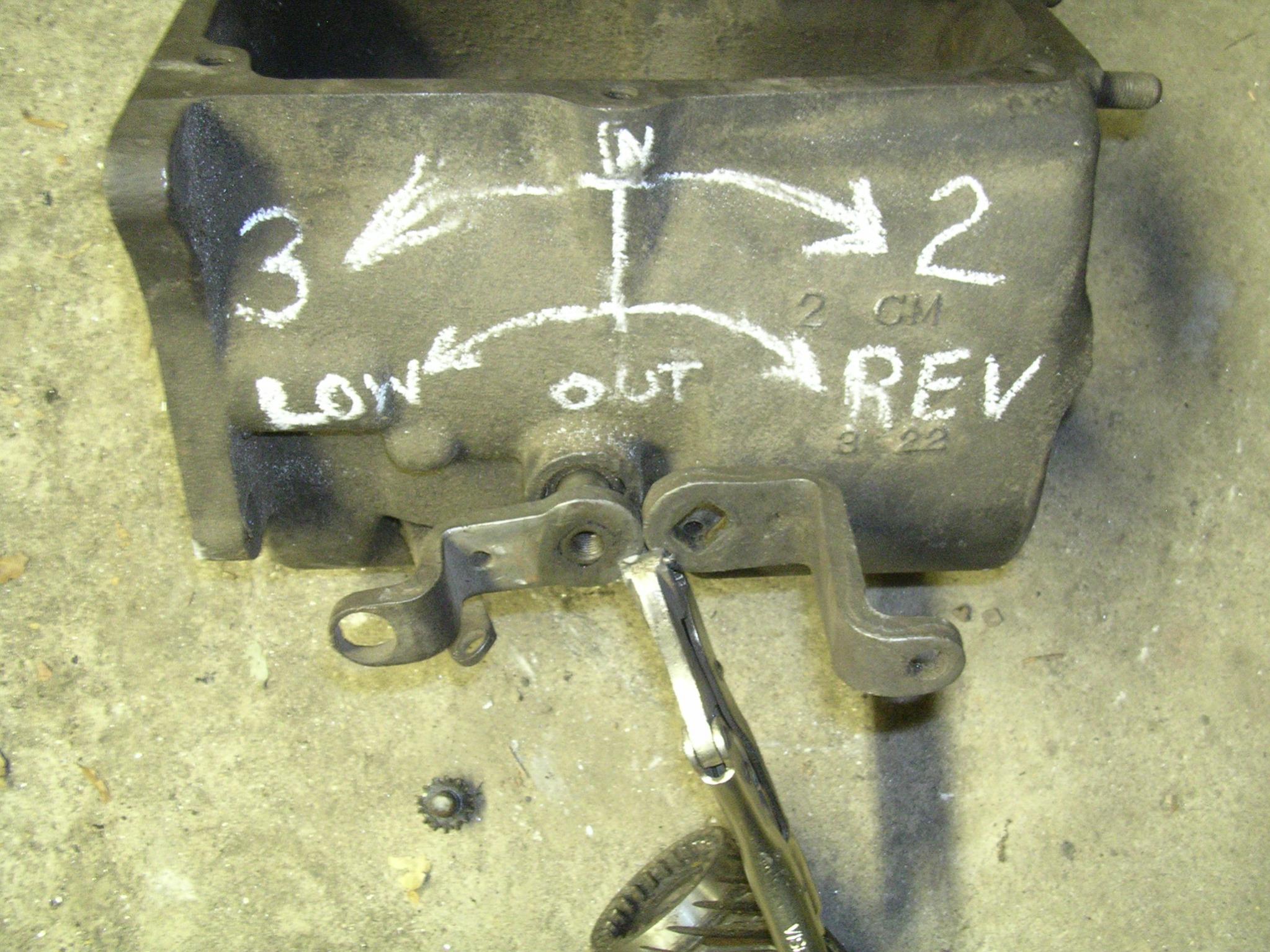

    Here is a start. Pics are huge, so keep expanding them.
    Inside pic shows how the shift rails work. If you really look close to where the smaller shift lever area is, towards the driver side front, you can see how the small lever helps to move the cross rail from side to side.
    2nd pic shows the shift pattern, and also shows a different year/make of a selector lever with more offset and a smaller linkage hole. I am showing it clamped on the way it would sit if you rotated the arm 180 degrees to get the pattern right. The shaft has only 2 ways the arm can be "clocked". This pic shows the trans in 2nd gear, and you can see that the angle is not good for a shifter with a horizontal shifter rod like all side shifters have. So, you'd need to cut the arm and rotate it so it will point straight up in neutral.
    I'll do another post soon on some basic ideas.

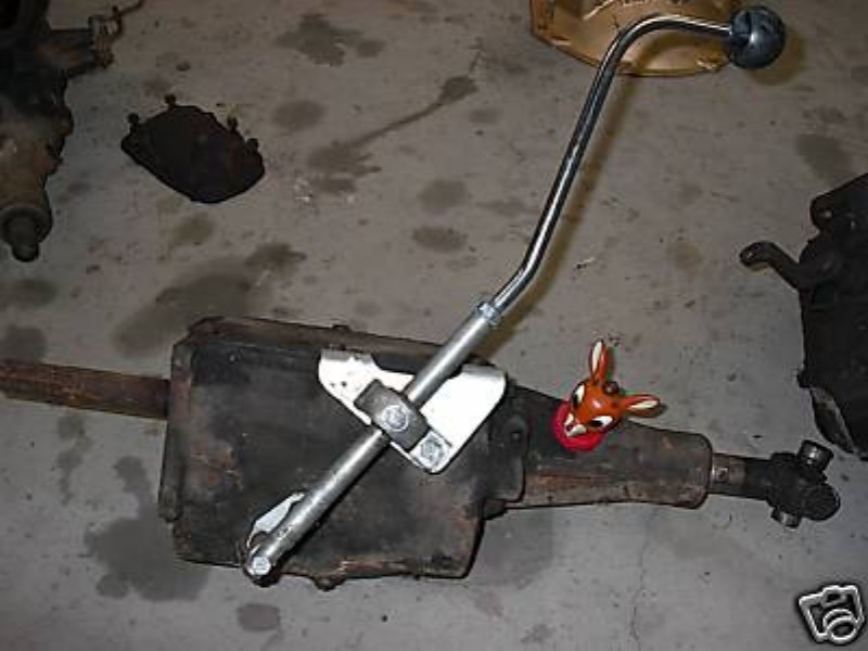

    From the other thread pics..
    Here is a pic of what I think is a Dragmaster shifter and it appears to be somewhat like Tubman built. This one would have a backwards pattern, also.

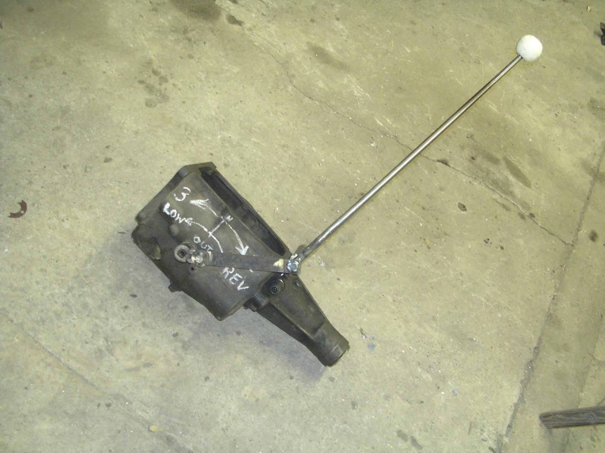

    Anyways, I did work on a shifter this afternoon. I was trying to see if that homemade setup would work well if you pushed the shifter sideways for the two gates. I thought it might be a problem because it looks like someone put 2 drilled oil holes on the top cross shaft bushings to make it slide better?
    I got mine together with a 24" oversize stick, and it will not move over good enough unless you hold the shift handle about 1 foot up from the trans. So, it can work with a short shifter, but that's not what anyone would want. The stick I made straight, but can be bent to fit each car.
    I thought about what Owen just posted about making the shifter move up or down for the gates, and I then thought about a T trigger under the shift knob to do the gate movement. I kind of thought that would look bad, so I quit for the day.
    I later had a brainstorm on how to make my shifter work as nice as a Hurst 3 speed stick. I will do the modification maybe tomorrow and let you know if it does work like I hope.
    Right now, my shifter moves 7" going from 2 to 3, or from Rev to 1st., maybe that's too short of a throw for most people?..I can easily change it to go more. ...and yes, it does have the normal H pattern, not backwards. :cool:
    R 2
    1 3
    I am wondering about floor pan clearance on my design. I don't know anyone around here that has a stock body 50s GM car to look at.
    Here's a crummy pic:
