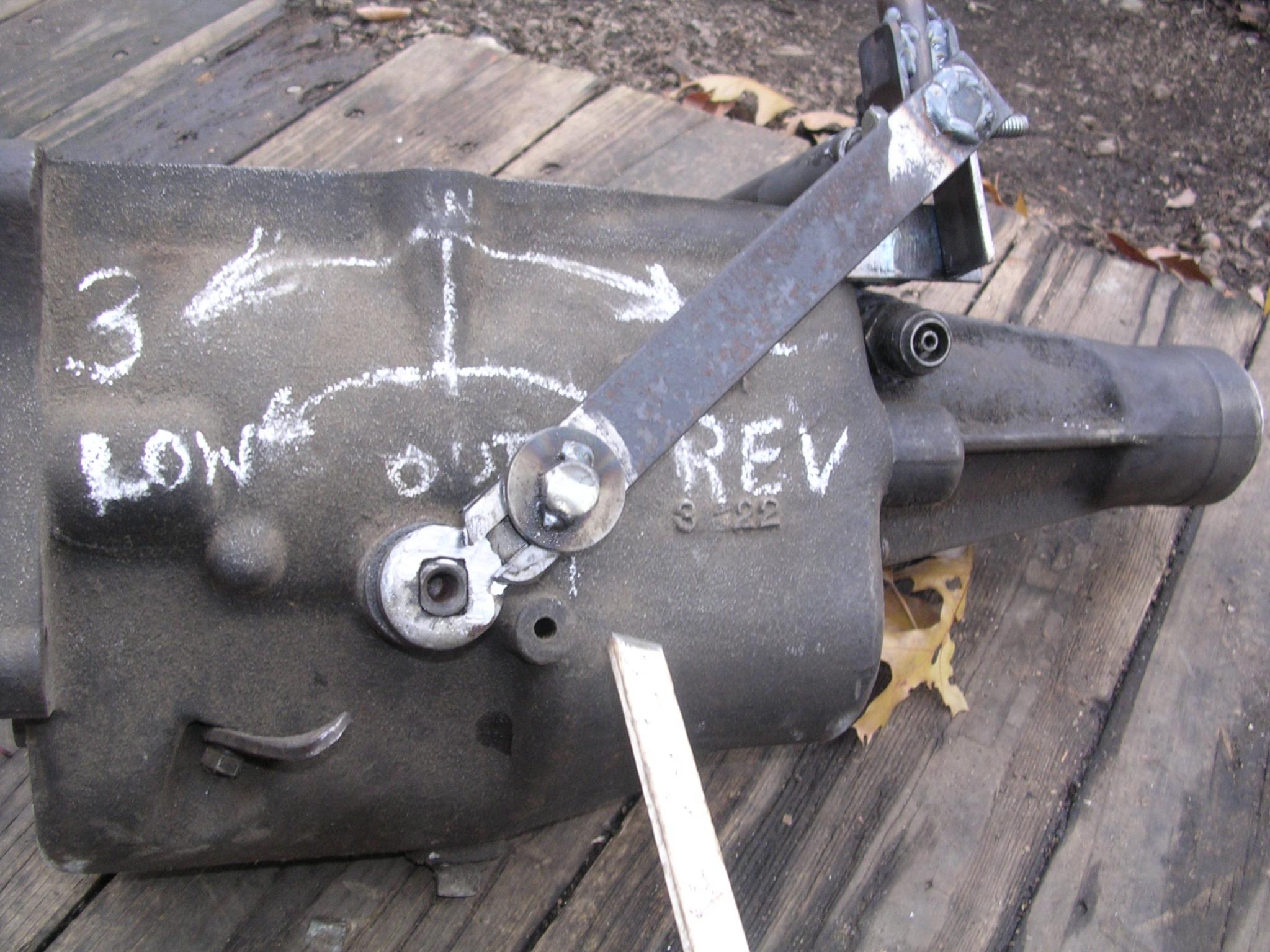

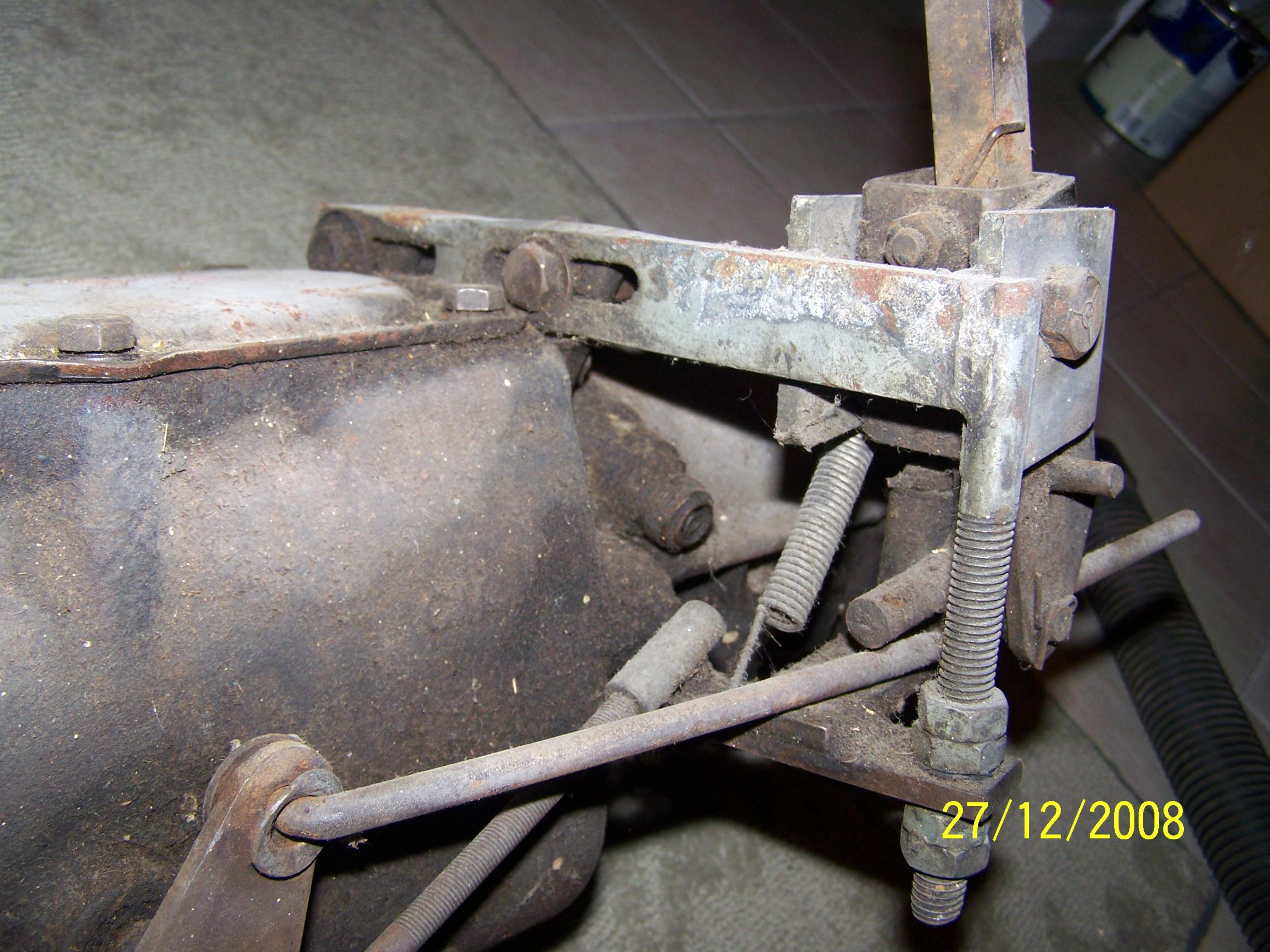

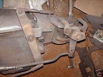

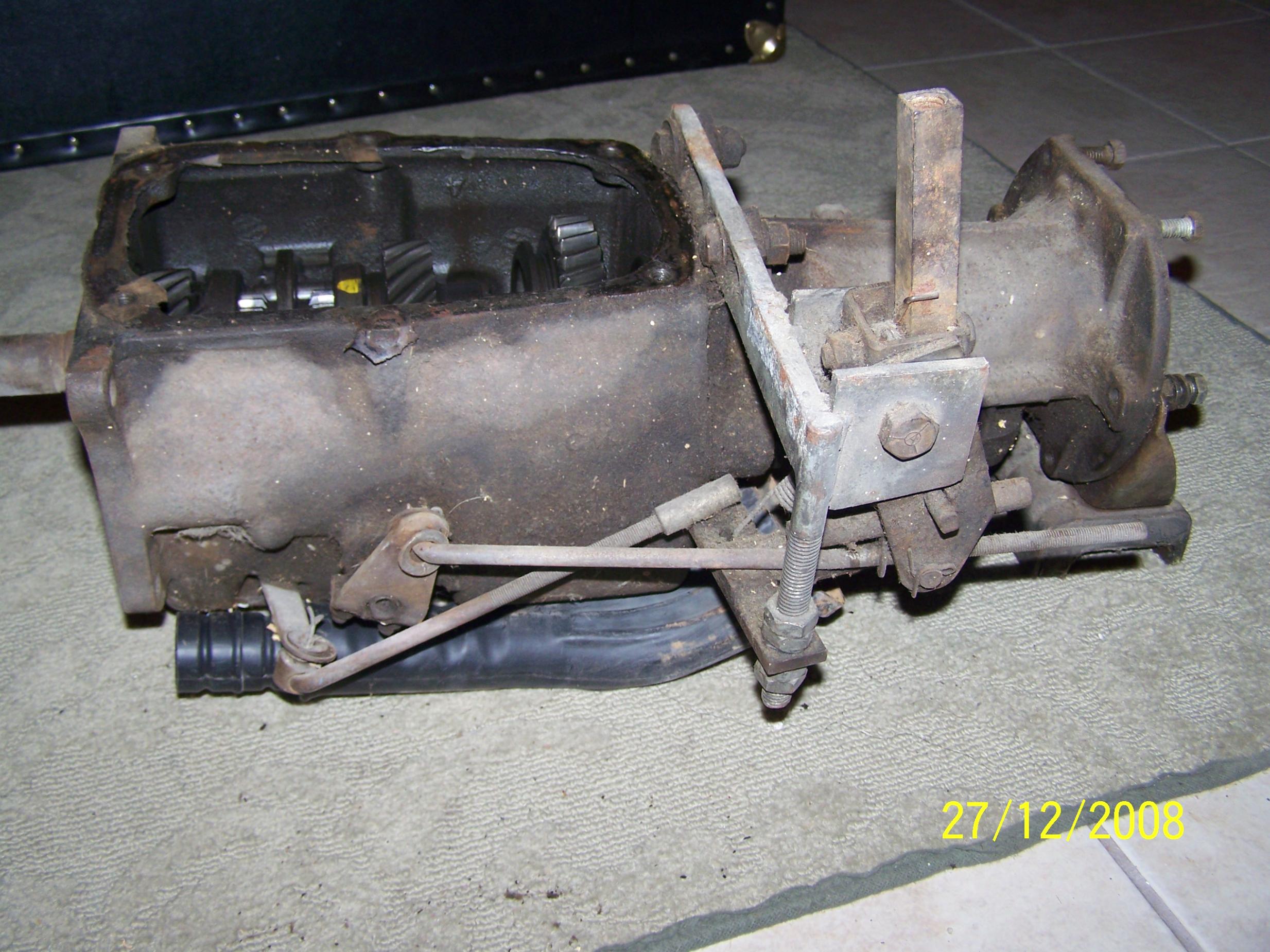

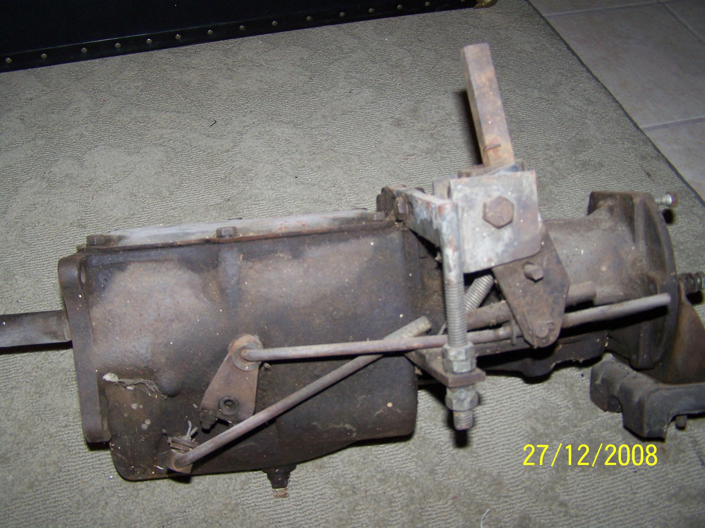

    My prototype is done except I really think the tall shifter is too tall. The extra height just makes it feel wrong.
    Let me do 2 seperate posts with pics to make less confusing.?
    First post and pic deals with how I decided to mod the original side lever. In this pic, I am pointing to that area.
    I first cut off the tail of the orig Olds lever, leaving just a round piece with the oval shape hole that would be hard to make from scratch.
    Next, I made a very short flat lever to weld onto that round Olds piece, and aimed it "back" and "up", towards the centerline of the top cross shaft when the trans is in neutral.
    On that new short lever, I drilled a 3/8 hole, then welded a nut on the back. Then a 3/8 bolt with a big flat washer welded to the bolt.
    Then I made the long rear lever that welds solid to the top cross shaft. These 2 levers point right at each other in neutral.
    On the lower front end of that long lever, I made a long 3/8 wide slot.
    The fork goes in between the big washer and the new short front lever.
    So, when the top cross shaft moves right or left, it pushes in or pulls out on the Olds selector shaft.
    This setup really works good in my opinion, and probably easier to build than making that "dual fork" connector linkage shown on that old homemade shifter.....and less slop in using one fork, rather than those 2 forks on that other one?
  8. F&J
    Joined: Apr 5, 2007
    Posts: 13,291
    F&J

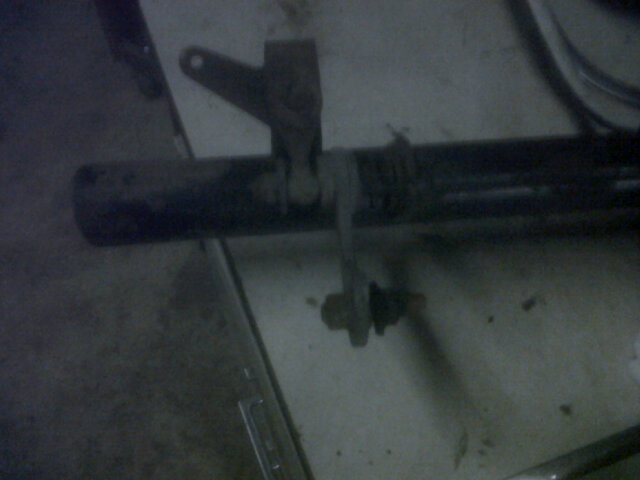

    Now the upper cross shaft details; Kind of confusing to describe, but study the pics for a while..
    In hindsight, I could have mounted the cross shaft a bit further back which would allow it to be lower than it is. If you do that, a stock floor might be tight there too? Anyways, keep the speedo cable in mind when building this stuff.
    The cross shaft is 5/8 dia round stock, and the tube it rides in is just black pipe. The pipe has 2 tabs welded to it for the 2 upper tailhousing bolts.
    Yesterday I had the stick shift welded solid to the cross shaft, and it just did not want to slide over very good.
    So I cut the stick off and welded 2 short pieces of flat stock to the bottom of the stick. I then drilled a 5/16 hole through the two plates and the cross shaft itself. One piece of those 2 flat stock tabs, hangs lower and rests at a "skid plate". Now when you move the stick over to the left for reverse or first, that skid deal forces the cross shaft to move over, even with the spring.
    You might also see a 1/4 x 1/4 x 1 inch "stop" welded to the top of the cross shaft right above that skid deal. I had to put that there to keep the stick from falling over to the right side.
    Here is the bad news: When the trans is in reverse or 1st gear, the cross shaft is over to the left....and now, the skid and the upper stop are no longer keeping the stick from having side play. It works fine, but just feels wrong because of the side to side play. I can't figure a way to fix that.
    If you are building a shifter of any design, I think it might be good to build a rough prototype first to see the new problems, rather than put a ton of real fussy machining time into it and later be forced to s**** part of it.
    Good news is that it does shift in a normal pattern. I did not mess with the linkage ratios and here are the movement specs:
    From 2 to 3, the shifter moves about 6-1/2" inches, same when going from R to 1st.
    Side movement in the neutral gate is about 4.5 to 5"
    The only thing I may do is shorten the stick by 8" or 10". I am pretty sure it will just feel better than being too long. I was trying for the LaSalle or 37 Buick shifter style, but now I am going for the Hurst mystery shifter look.
    More ideas would be good. Change the entire design, or parts of it?? I am out of good ideas right now:confused:

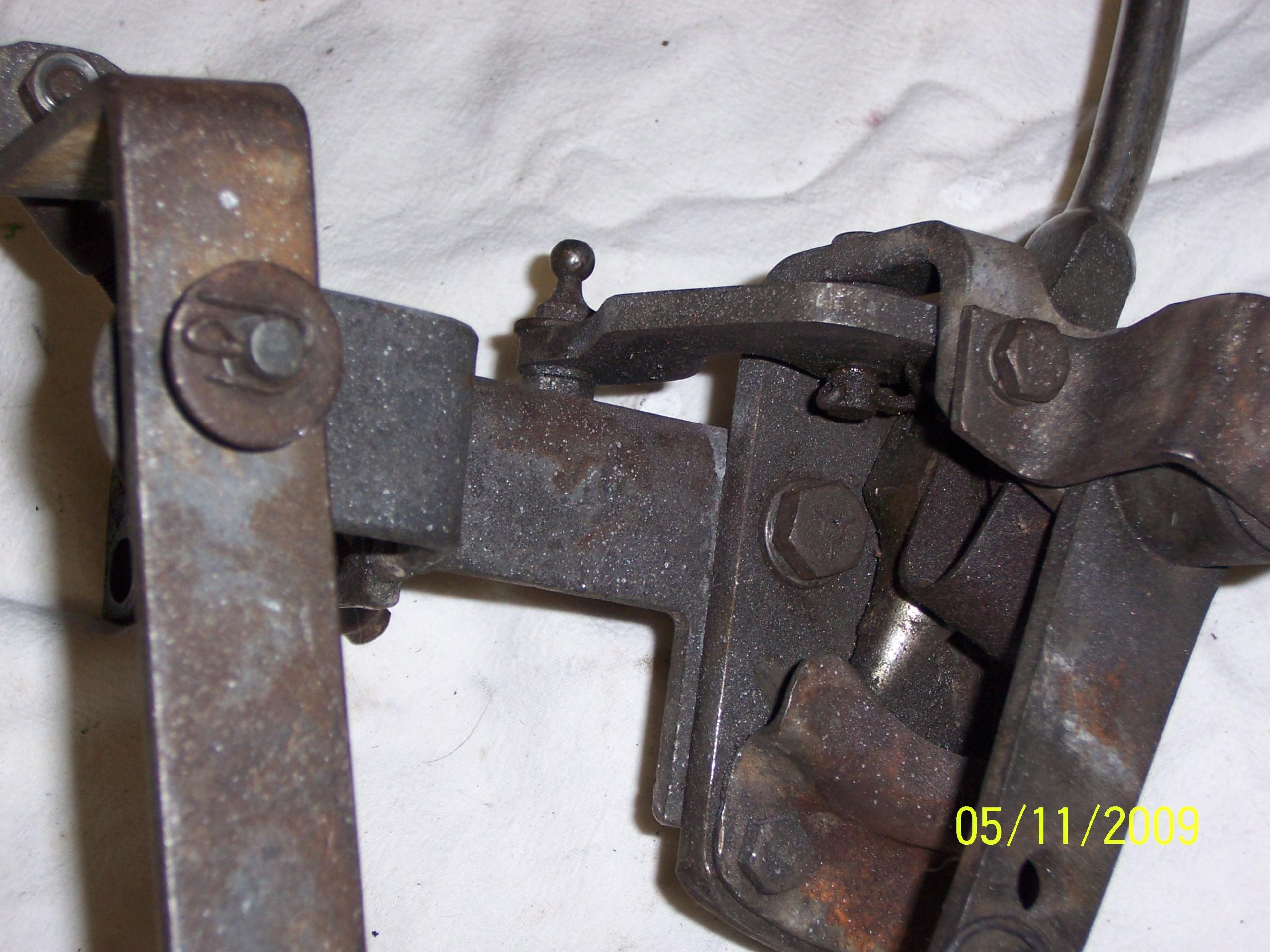

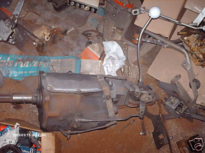

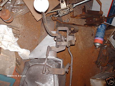

    Here are some pictures of a Foxcraft shifter. The January 2010 issue of Hot Rod Deluxe also has an article on Nailhead shifters starting on page 84. It talks mostly about the 5-bolt trans, but the shifters are similiar.

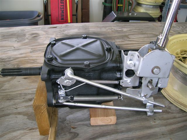

  13. buford26
    Joined: Jul 25, 2005
    Posts: 154
    buford26
  14. buford26
    Posts: 154
    buford26

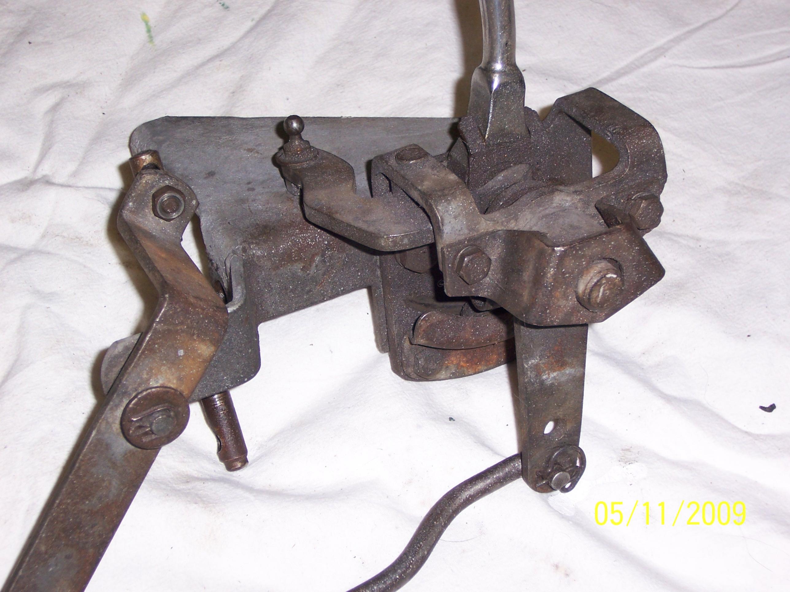

    Here are some pictures of Ansen shifters, I think they are from one Heathen had.
  15. Gman0046
    Joined: Jul 24, 2005
    Posts: 6,256
    Gman0046
    Thats the Ansen I used. Thanks for sharing the pictures.

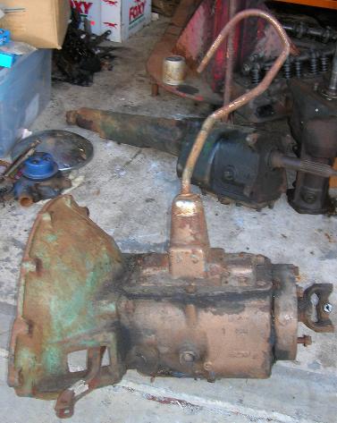

    Also, the people who mentioned the Buick top shift trans from big cars:
    I did do the swap that uses all the guts from the 51 up OLDS selector into a 37 Buick Big Series trans case/w top shift.
    I was told by a guy who had a Hollanders Interchange book, that the 37 Buick was one year with the case casting number that he sold me. I don't know if that means the case and top cover needs to be from a 37 big Buick, or could it mean that some of the gears were different in between the late 30s big buicks?
    That 37 Buick trans I used; it is a closed driveshaft, not open like Olds, and the input shaft and spline won't work with Olds Rocket engines. It bolts up fine to the 51-up olds bell, but won't work unless you put all the Olds guts and Olds tail housing on it.
    I need to do a tech on the swap. It is real easy except the Olds tail housing area needs mods to bolt up to the Buick case. No fancy machining needed. I do have pics somewhere.

    Here are some more pictures of the Foxcraft shifter.

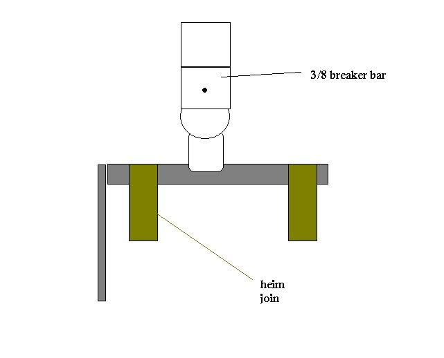

  28. hotflint
    Joined: May 9, 2009
    Posts: 310
    hotflint
    VERY GOOD THREAD!

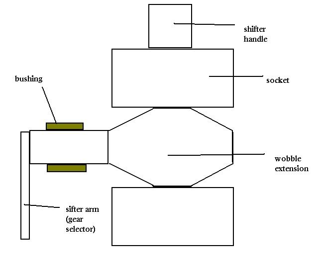

    I broke down the ansen shifter in my head a little bit, its actually alot simpler than what you might think, the most complex part is having the same joint go forward back and side to side
    Firstly to get the shifter gates working it has a crab claw shaped plate with a bell crank on it that goes to a ball joint that is connected to another bell crank and another ball joint ***embly attached to the gate arm moving it forward and back
    second is the shifter arm to select the gear which is welded to a shaft that goes through the shifter handle
    this next part because I couldnt see it well is what I imagined in my head
    in this way it allows the shifter arm to move forward and back and the handle to move side to side using materials easily available to everyone
  29. hotflint
    Joined: May 9, 2009
    Posts: 310
    hotflint
    Re thought my idea a little if I welded a 3/8 breaker bar drive end to a shaft had one end extended to weld on the gear selector lever, ran the shaft through 2 heim joints it would allow fore and aft movement, and side to side movement. The side to side movement would operate the crab claw bell crank which operates the gate selector.
    sorry ths is so crude
  30. F&J
    Joined: Apr 5, 2007
    Posts: 13,291
    F&J
    ^ I can't seem to grasp what the drawing means, but a couple of years ago, I was thinking of using a mini steering U-joint to try to reverse the backwards pattern on that simple Drag-Fast? shifter picture that was posted.
    I keep thinking simple is the way to go to cut down on work but also reduce slop in having less parts?
    I did just come up with an idea for a totally different shifter that is centered right at the side lever. The main side lever will do all the shifting, and the lower lever will just be used for a spring to allow spring tension when you move the handle to the 1-R side. I don't have the proper size heims here, but maybe I could make a wimpy version just to show.
