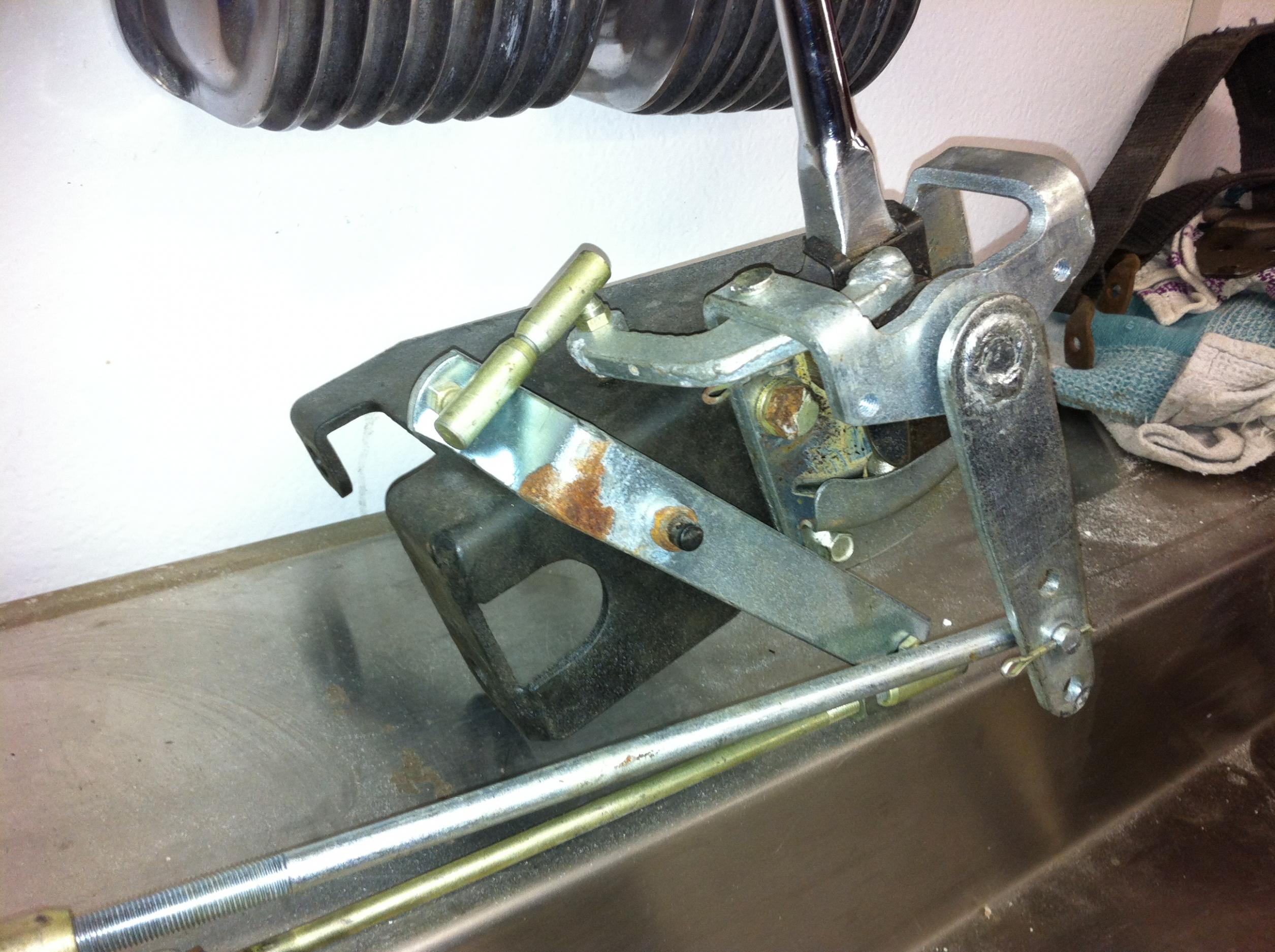

  3. Just an update, Dave (hotflint) built it today. It works slick! Dave is way smarter than he looks:D
    Seriously though, Dave is damn smart when it comes to this kind of stuff. He should have skipped Millwright trade school and taken mechanical engineering instead!
    Unfortunately though, we have no camera tonight so you'll have to wait until tomorrow for pictures.

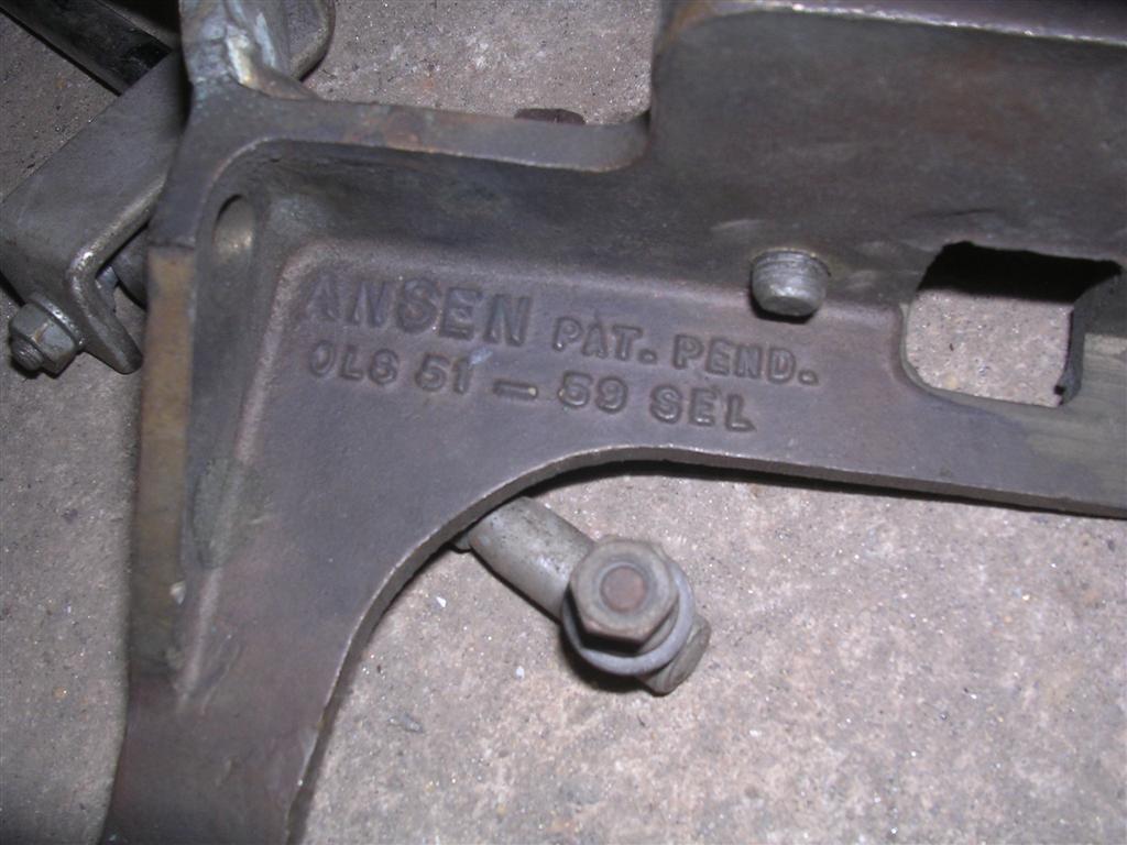

    Joined: Apr 5, 2007
    Posts: 13,291
    F&J
    X2, still waiting.:)
    I was on the phone just now with an old time Olds racer who has some parts for an Ansen Selector shifter. He said he has a mounting bracket made of bronze? He said the Ansens "were made of bronze" ??
    Anyways, he has a bucket of old linkage from shifters and says he can't remember, or recognize, if he has any more pieces to the Ansen.
    Just wondering if anyone knows of bronze parts used on any brand of Selector shifter?

  23. F&J
    Joined: Apr 5, 2007
    Posts: 13,291
    F&J
    Someone talked about the Ansen bronze shifter mount. Here are 2 pics of a partial Ansen I bought from a guy who ran it back in the late 50s to early 60s. He lost some parts over the years.
    See the Ansen name, and what it fits, cast into the bronze part.
    I think I can make the rest of it, and it does seem like it would have the correct shift patter, by looking at some pics I saved.

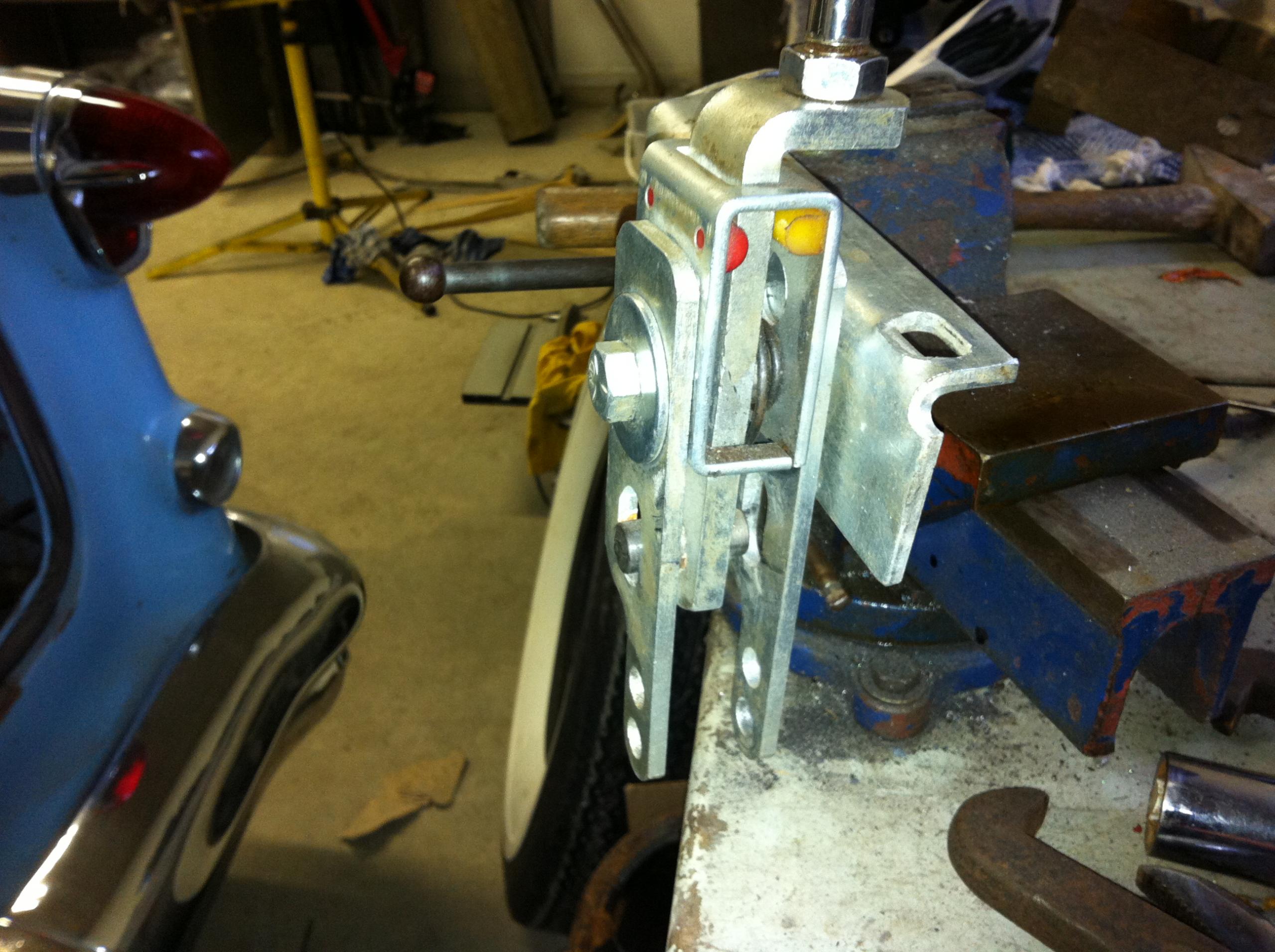

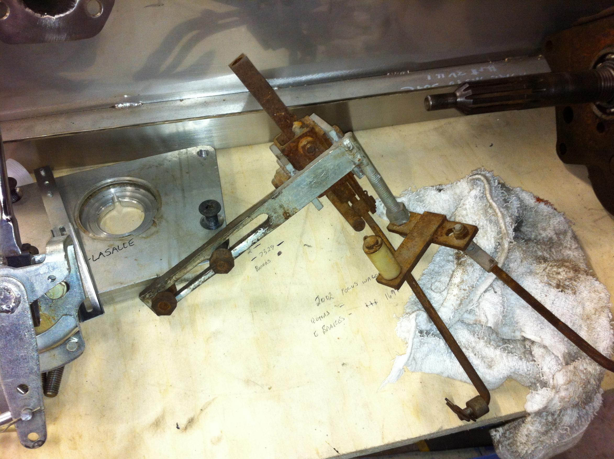

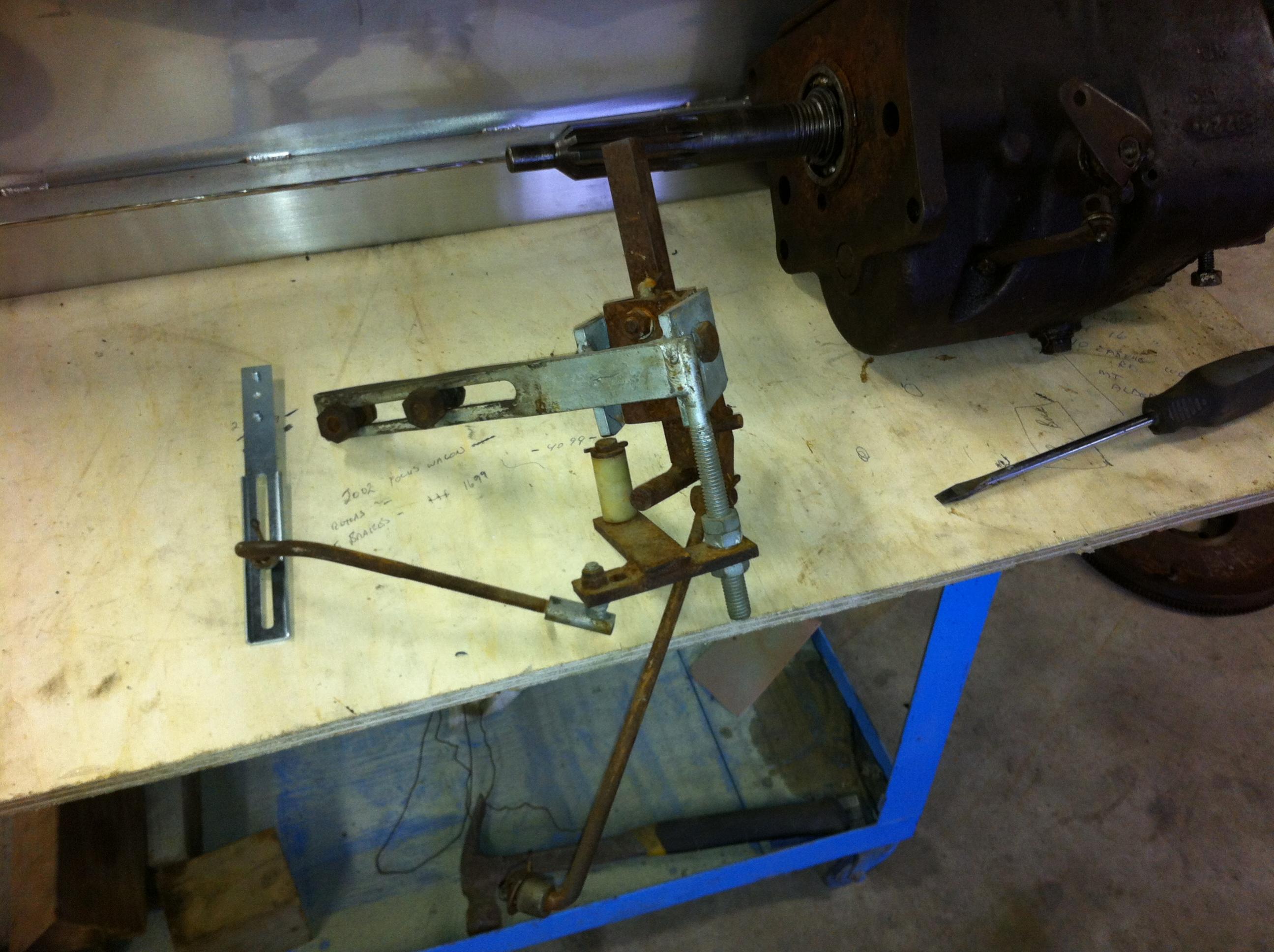

  25. Are you sure this shifter is home made? I just aquired this identical shifter on a olds trans, and I mean identical, everything is the same. Plus the mounting bracket with the threaded rod has a galvanized coating on it. I can't see someone going to the trouble to get his work galvanized. could this be just and unknown maker? Or did your shifter just some how make it to me?
  26. buford26
    Joined: Jul 25, 2005
    Posts: 154
    buford26
    I don't own that shifter. It was for sale with the trans on ebay a few years ago. The owner said it was home made and sent additional pictures when I inquired about it. The only other company that I know of that may have made shifters for these types of transmissions was Foxcraft, although I have never been able to find any information to support that. If you see post #56 of this thread there is a file called "HRM_CTRE.pdf" and the last page of that file has a table showing some shifter companies and nothing is shown for Foxcraft.
  27. HEATHEN
    Joined: Nov 22, 2005
    Posts: 9,059
    HEATHEN
    from SIDNEY, NY
    The pictures you posted are indeed of a Foxcraft shifter. I once had a N.O.S. selector shifter from them and, although it looks as if it started out as a conventional three speed shifter that was modified after the fact, it was Foxcraft that did the modifying.
  28. buford26
    Posts: 154
    buford26
    Maybe Flash Caddilac can post some pictures of their Foxcraft shifter now that we've figured out what it is.

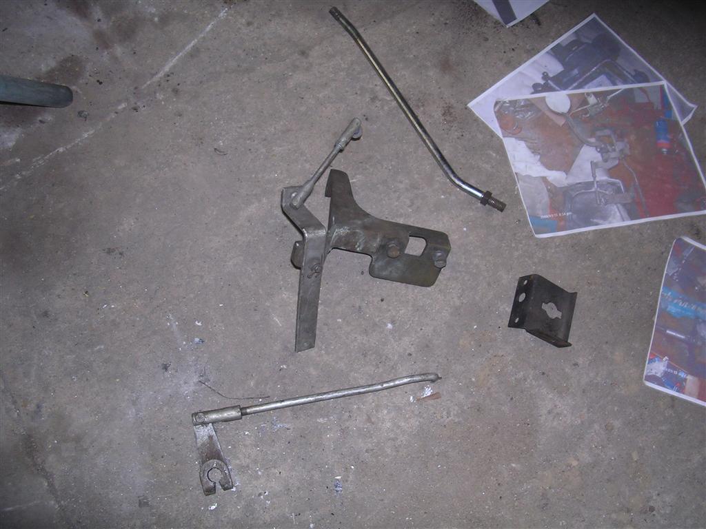

  29. sure can post some pics. it was one the trans but i tore it down. it looks like it would work good. what year are these from?
  30. also here some pics of a nos ansen posi shift, it has a mounting plate for a pontiac trans but the mechanics are the same for the selector. i feel it would work better then the foxcraft but ive never seen them in action. seeing as we are on the topic of shifters there i have another unidentified 3speed shifter, is it possible that this is a foxcraft also?
