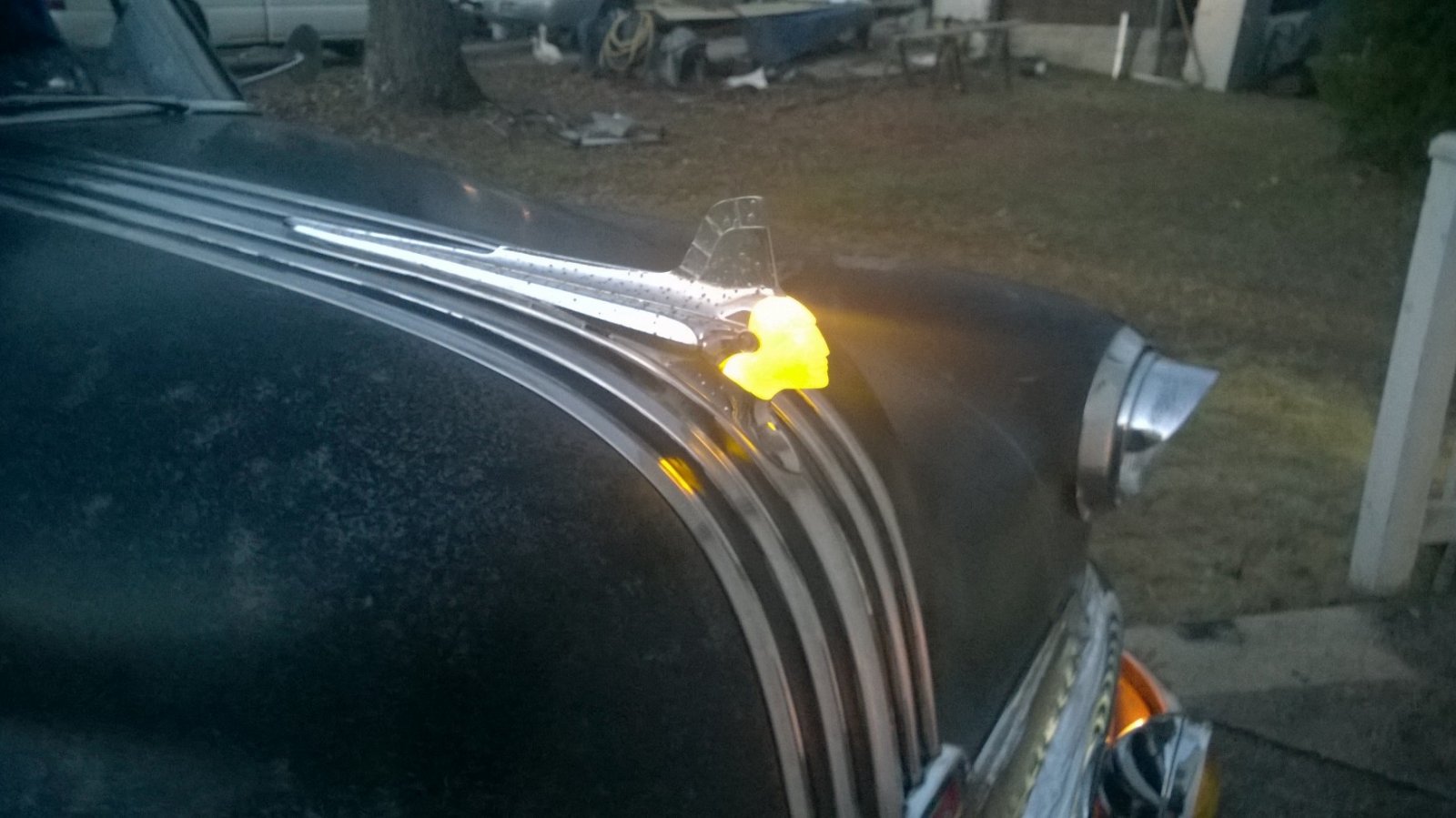

    Well I replaced the light bulb in the hood ornament with a 6v amber LED. And it's alot brighter and doesn't get as hot. get-attachment (48).jpg get-attachment (49).jpg

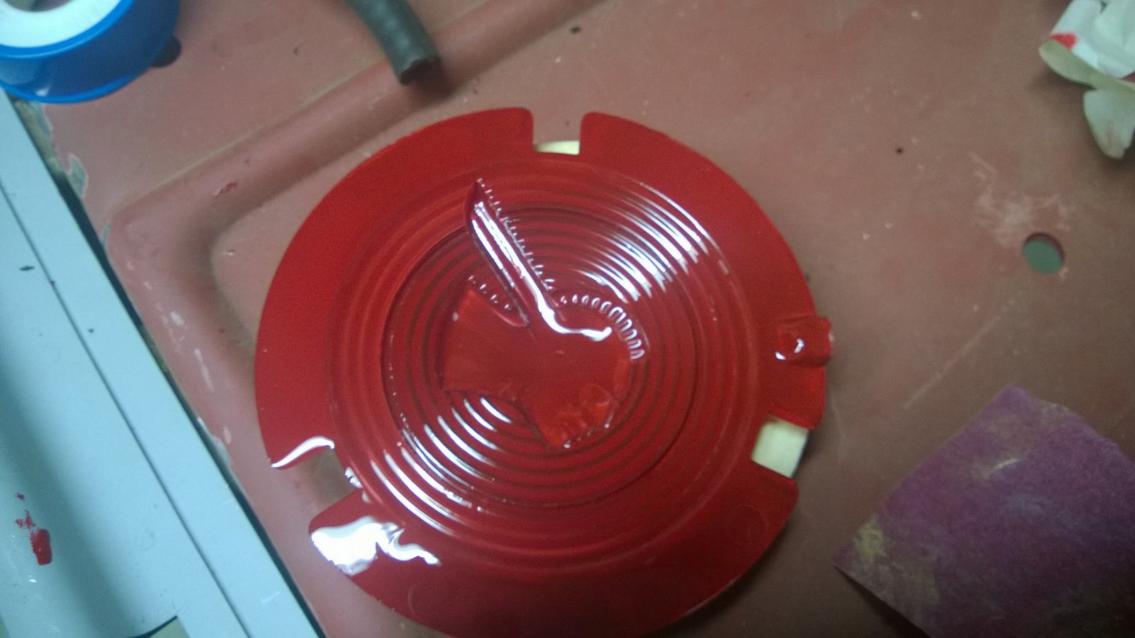

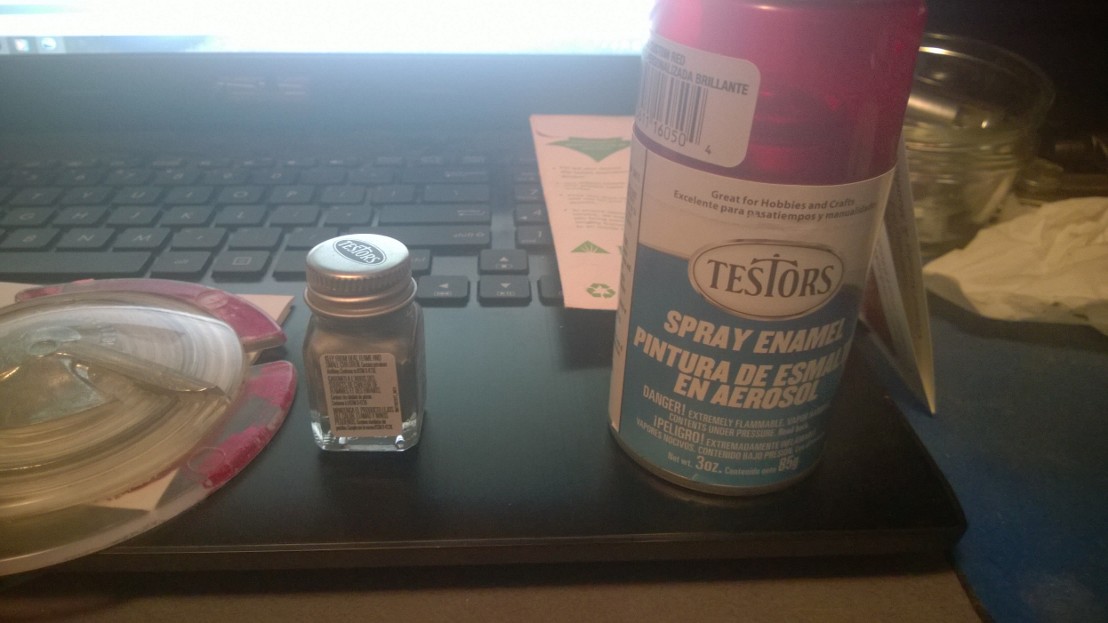

    Right now I'm in the middle of repainting the grill emblem. I cleaned it with a green scotch bright pad. Then I am going to paint it with testors silver enamel and testors translucent red enamel paint. get-attachment (44).jpg get-attachment (45).jpg

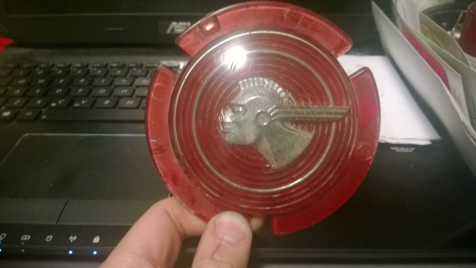

    It doesn't look to bad I think it turned out pretty good. get-attachment (2).jpg get-attachment.jpg

    Looks like it turned out pretty good.
    Thats what I did with the one on my 52... plan to do my 51 the same way.

    now paint the back of the emblem with silver spray paint and it will make it brighter .

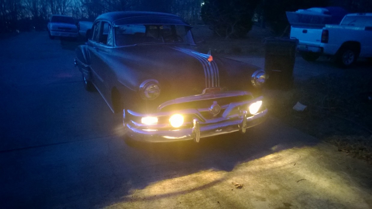

    I used some turtle wax rubbing compound on the trunk and doors today. I still have to do the roof and front clip before I can wax it. The paint looks pretty good to be over 60 years old. get-attachment (56).jpg get-attachment (57).jpg get-attachment (58).jpg
