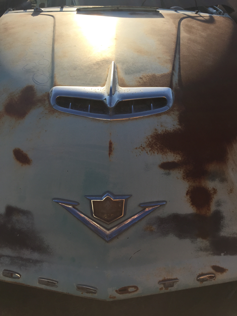

    I have been toying with the idea of adding this hood ornament from a 53 desoto into the roof over the rear window but I'm not sure yet. Just an idea what do you guys think? ImageUploadedByH.A.M.B.1426814535.178771.jpg

    I'd like to see the hood scoop mocked up in place. I have a '62 T-bird scoop cut out of a hood and had the same thought to go on my '53 Ford, to give it a '58 Impala type look. Just not sure if it'd look right in real life.
    Neat car, looking forward to seeing more.

    To me, a scoop might work if it's done with more subtlety; using just the bottom of the trim piece - say like this:
    The stock DeSoto scoop looks good, but wouldn't that big piece of chrome draw a lot of attention to itself right where you don't want to distract from the graceful lines you've given to the roof? Just a thought.
  9. What do u mean? Nothing is broken?
  10. Thanks for the input I think u may be onto something. I'll cut it out and set it up there and go from there but I think it may draw to much attention like ya said.

    As far as the scoop is concerned, I don't feel the curved face is well suited to job. JMO. Good thought, though.
    Before you go cutting, why not take some pictures at the proper angle, and see if one of the good people on the Photoshop thread will fix you up?

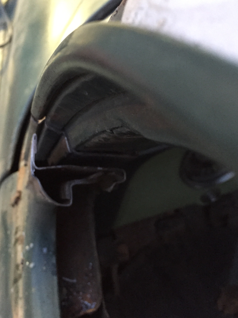

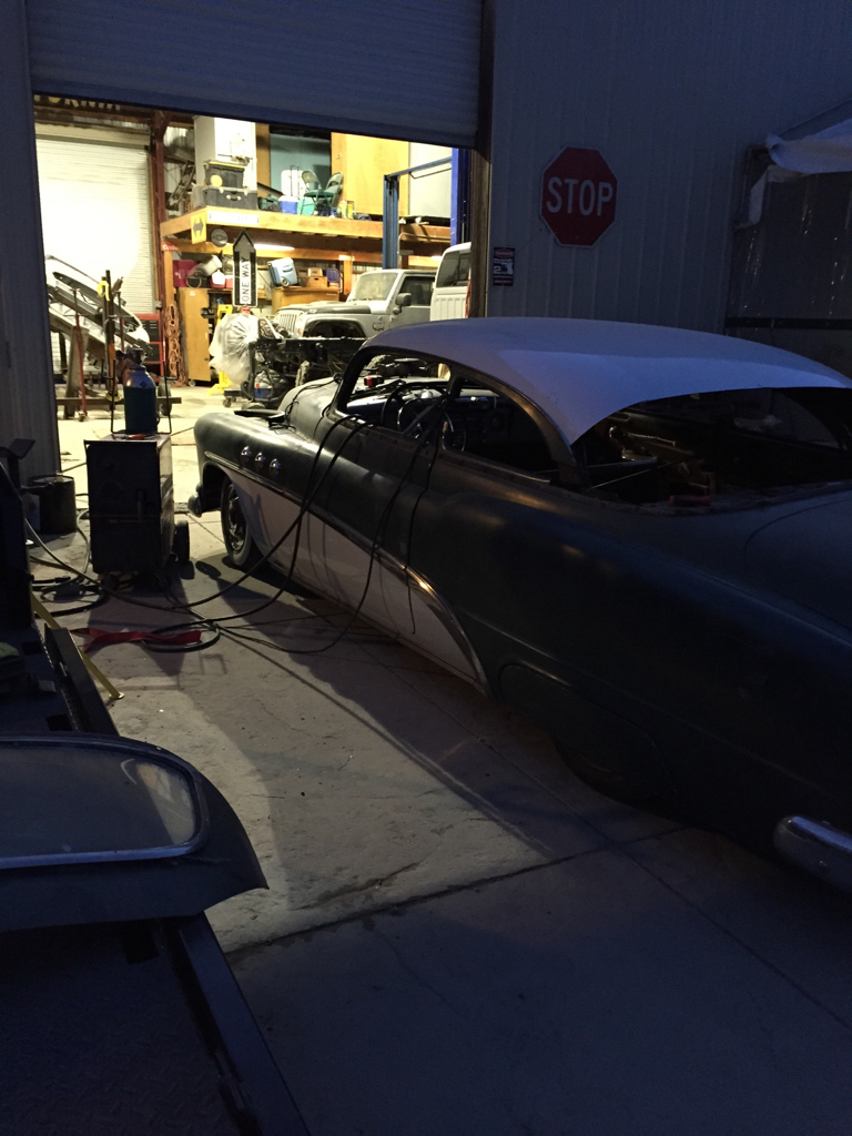

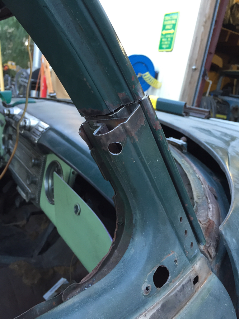

  15. Well got in some more work tonight. (Thankfully I didn't need much recovery time from my weekend extravaganza in Vegas) wish I could make it for viva but I can't. Not a whole lot but it's progress! I wanted to add some inner structure support so I made some small tabs out of 18 gauge then driled top and bottom of where i cut on each pillar then I will spot weld and sand.
    ImageUploadedByH.A.M.B.1427250669.624179.jpg ImageUploadedByH.A.M.B.1427250691.501111.jpg ImageUploadedByH.A.M.B.1427250707.826076.jpg
    I also did the door frames.
    I then put the roof back on and lined up the windshield had to make some relief cuts up top to cheat about a 1/32" each side ( I did this up top instead of the bottom to make it easier on my door gaps since they were already pretty cherry at the bottom)
    ImageUploadedByH.A.M.B.1427250838.776323.jpg ImageUploadedByH.A.M.B.1427250854.750521.jpg ImageUploadedByH.A.M.B.1427250868.189813.jpg ImageUploadedByH.A.M.B.1427250886.301610.jpg
    Tomorrow i plan to get my a pillars tacked better and then make the relief cuts to get the c pillars in line then proceed to the b pillars. I took a picture of where I'm thinking to cut to move the inner structure of the c pillar over (it needs to be pushed out since I moved the roof forward instead of stretch the roof) what do you guys think of the cut plan? Should I cut further up on the roof? Multiple cuts? Or start off with what I have marked and go from there?
    Man she sure is taking shape and I'm SO glad I didn't cut any more out of the pillars I think the roof sits perfect!
    Thanks for the help and insight -Nick

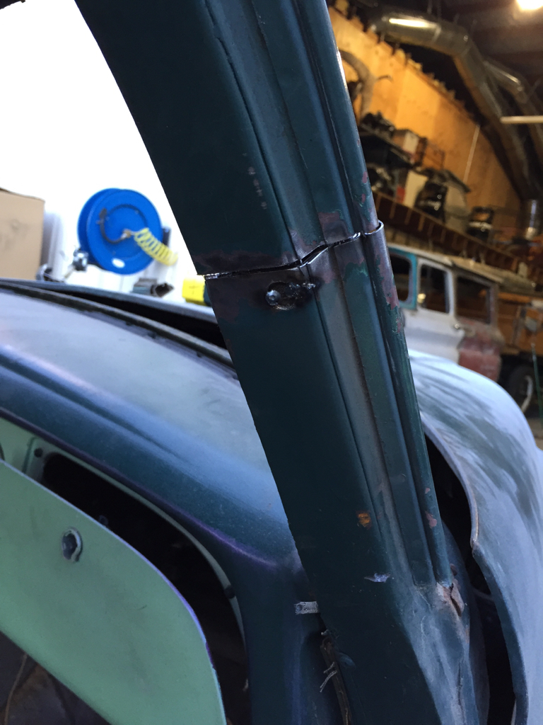

  29. I got some good work in last night I've got the a and b pillars on the p***enger near completion I sleeved and plug welded all portions for strength like I shower in my pictures before. I also got the rear Chevy window plumb and tacked in place. It's gonna take a little more work then I thought to get the belt line moldings to match, but nothing worth doing is easy right?
    Next up im going to build the bracing for the inner structure of the c pillar then once this side is complete I will move to the driver side then start again on the rear window and English wheel some panels.
