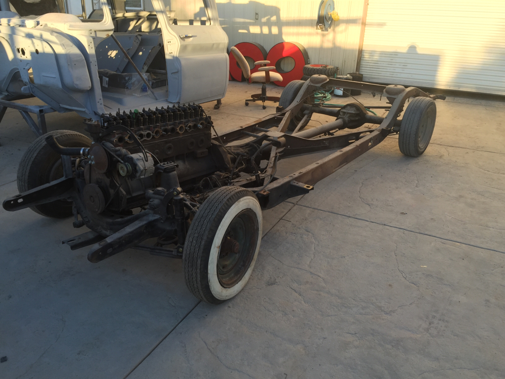

    So I got a wild hair up my ass to pull the body off last night. I wanna box the frame and re strengthen where I can. Keep in mind I'm trying to finish this cat before September 26 so I'm on a giant push. ImageUploadedByH.A.M.B.1439481620.583084.jpg
    Also I am thinking about ditching the 50 Chevy rear window and putting the three piece rear back in. I'm not huge on a tiny back window and I really want to keep it all Buick, thoughts?
  23. Question: Why are you intent on boxing the frame? With leaving the straight 8 and changing to a later transmission and open-driveshaft rear, it seems that placing the front of the wishbone near the center of the X-member and coming up with, say, a triangluated upper control link system, you would be fine. That looks like a pretty stout frame system.
    If u look closely this side of the frame rail was already tweaked from hitting speed bumps etc. so I had to weld those peices of tubing in temporarily just until I could get the car back in my shop so now I'm going to straighten it perfect then plate the mid sections and build some nice gussets top and bottom of the x member.
  25. ImageUploadedByH.A.M.B.1439511812.763819.jpg ImageUploadedByH.A.M.B.1439511844.162403.jpg got the frame cleaned up this afternoon, hope to get some work on it tonight. I'm going to do a compression test on the spare motor I have then do a tear down of each and see which is in better shape and go from there. ImageUploadedByH.A.M.B.1439511947.665116.jpg
