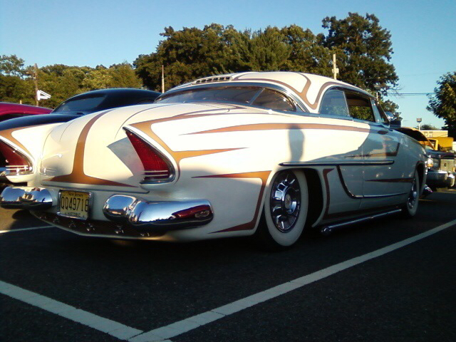

    On my Ford I used one piece of lexan to make up the "3" piece rear window. I then drilled it to fit in the window dividers. Can't tell its one piece. Your car is looking great. ImageUploadedByH.A.M.B.1439693755.672643.jpg ImageUploadedByH.A.M.B.1439693793.789495.jpg

  18. That's a great idea I may have to go that route! Was it tricky to get the Lexan to bend to the curve?

    Thank you. It wasn't too tricky. I used lexan the same thickness as the stock gl***. Cut it to fit with a template, left it outside for a few hours in the hot summer sun and with the help of a buddy, we fit it into the opening. I welded 2 small tabs to hold the corners in. I used the stock weatherstrip and after the stainless went on, it looks great. It's been in there for about 6 years with no problems at all.
