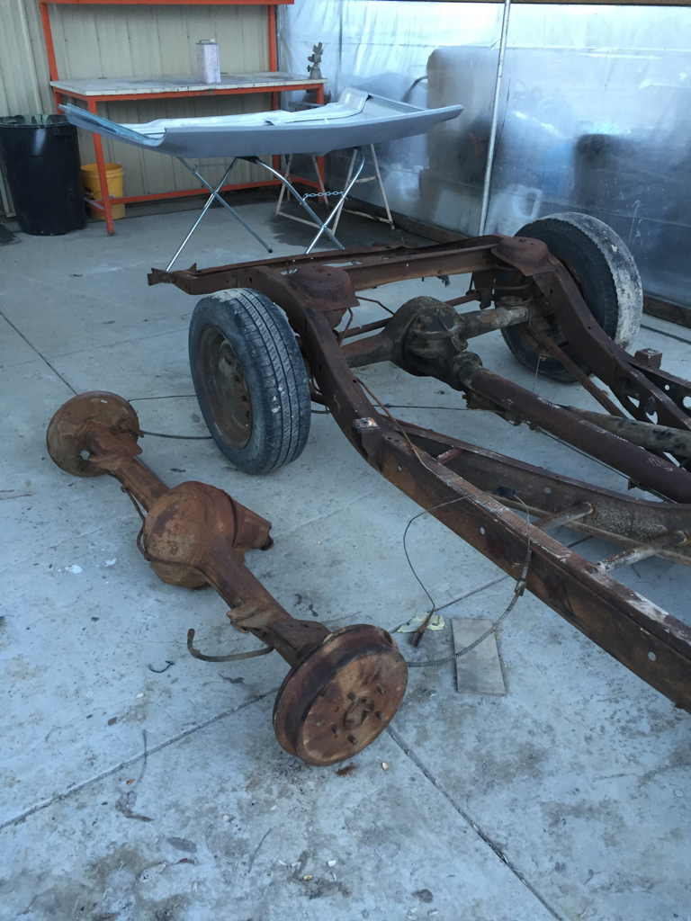

  3. R ImageUploadedByH.A.M.B.1451961954.739269.jpg I picked up a 52 olds axle today hoping it would be the smaller body olds but it wasn't it is 3.5" wider then my Buick axle. I'm switching to open drive does anybody know if this 3rd member will swap into my Buick housing? Thanks..

    I want to know if that olds center would fit the buick too. Id certainly try it.

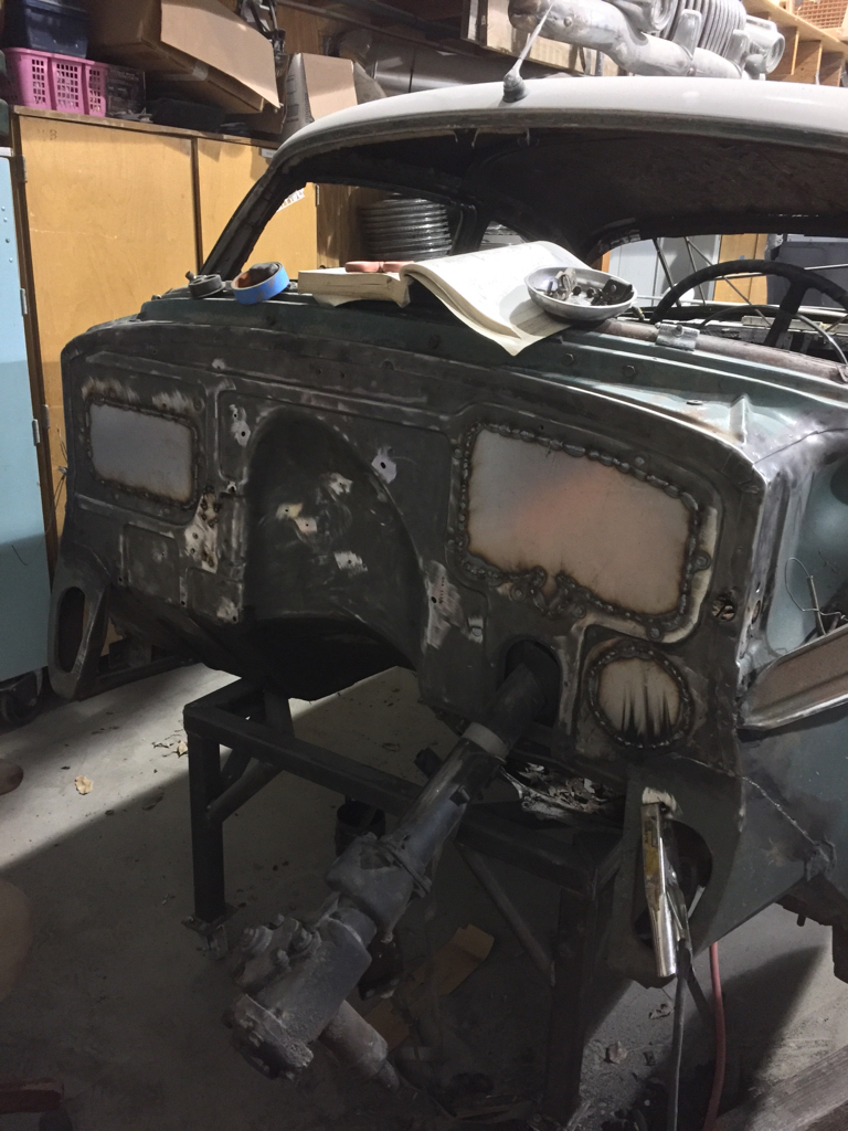

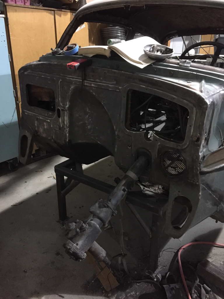

  6. ImageUploadedByH.A.M.B.1451963035.562908.jpg started shaving my firewall! But first labeling all wore as I pull them from the fuse block at the access panel which will be no more!

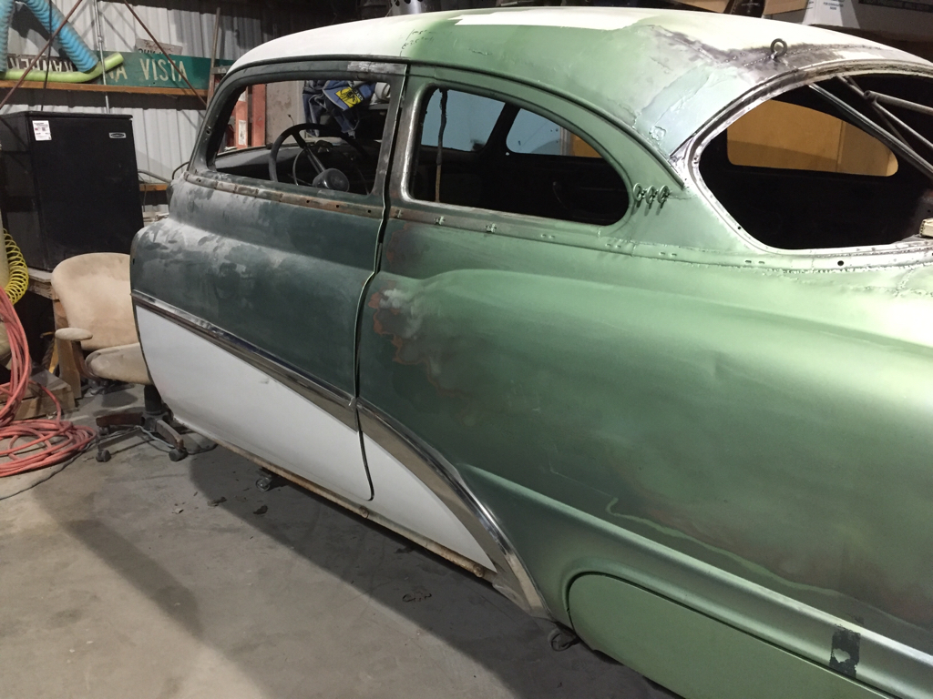

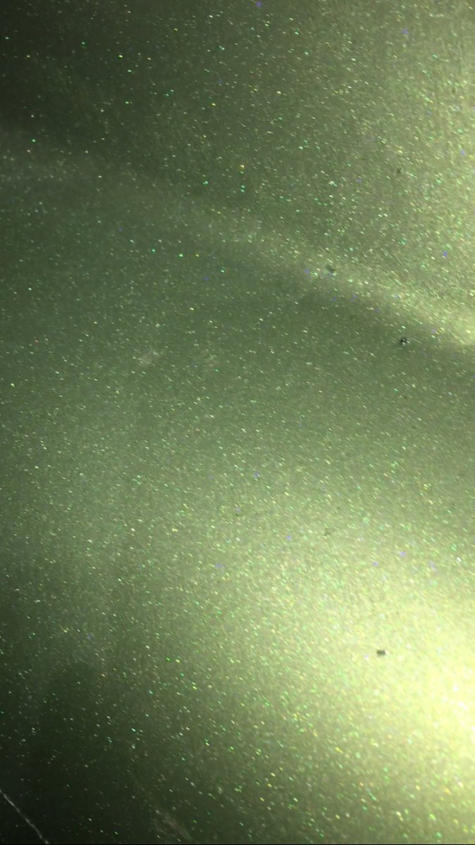

    Also been playing with a bunch of colors at the paint shop! Think I found the green! With a pearl white roof and white under the molding.. I got excited and had to spray a quarter panel. It's no where near ready for paint or was it prepped. Just had to see it on the car! ImageUploadedByH.A.M.B.1451963175.197361.jpg ImageUploadedByH.A.M.B.1451963198.492670.jpg

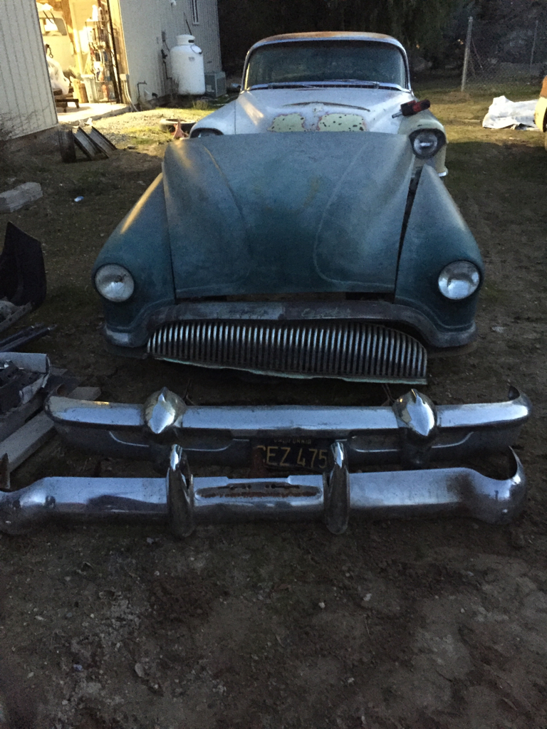

    Also got my bumpers and grille pulled from the 54 prts car! ImageUploadedByH.A.M.B.1451963233.293078.jpg

    Progress glad too see your back on it.
    That green will bring out the body lines nicely. Good flip flop in the pic.

  9. ImageUploadedByH.A.M.B.1451972660.667654.jpg got almost all of the patch panels in just a bunch of holes to weld up now!

  11. Thanks dude. I'm hoping I can swap thirds on the Axkes I have. I just got the motor back from the machine shop and am going to adapt a th400 but I wanna keep the same lug pattern as I'm keeping stock front suspension.

    I have some doubt that this will work.
    The center may bolt to the housing but the axles will give you some trouble.
    The buick uses c clips at the spider gears, where as the olds uses pressed bearings at the axle flange.
    Not saying it cant be done
    But it could be a horror show.

    The only chance you have is if the spider gear sets will swap over. Again im doubtful.
    Maybe the gurus can chime in here.

    If it used C-clips, wouldn't it be a back cover access? Both are drop pig styles, so I think they would both have axle retention at the outer bearing flange, just wondering?
  16. I'll let you know what I end up doing, if I try it.
  17. I'm gonna tear into them next week and find out.

    A friend of mine used a 71-87 Chevy pickup rearend in his '55 Buick to keep the same bolt pattern and it fit real nice although his car is a Roadmaster so I'm guessing it's wider to start with. The bigger bodied '58 Edsels had a smooth back 9" with 5 on 5" pattern, might be a bit harder to find but could be an option.

  20. Thanks I'll keep that as an option! Yeah a roadmaster is the same size as the cadillac's.. I have a few axles at my shop but all wrong lug pattern! I'll keep searching if my 3rd member swap doesn't work..

    I've got a truck 12 bolt under my 54. If you decide to go that route, I could give you the skinny on what you need to do.
    LONG likes this.
  28. Yes I would like the skinny please!! Same bolt pattern?
