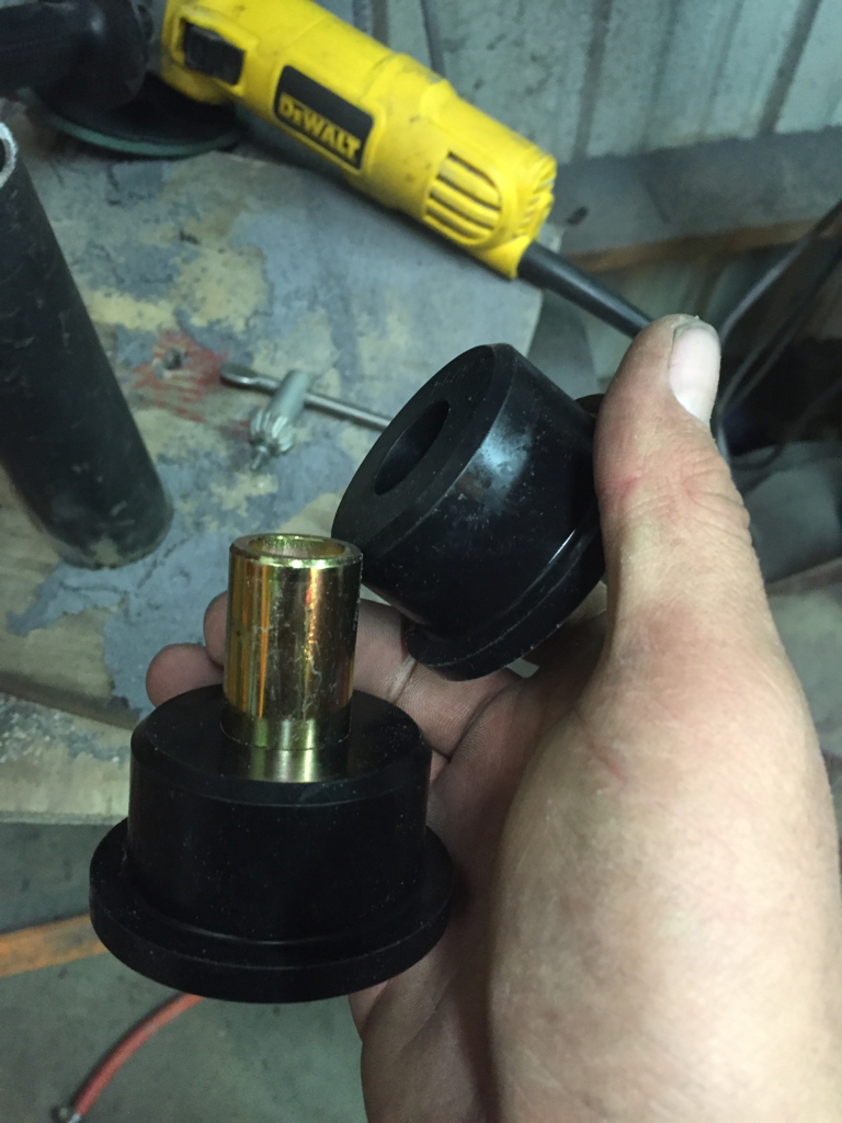

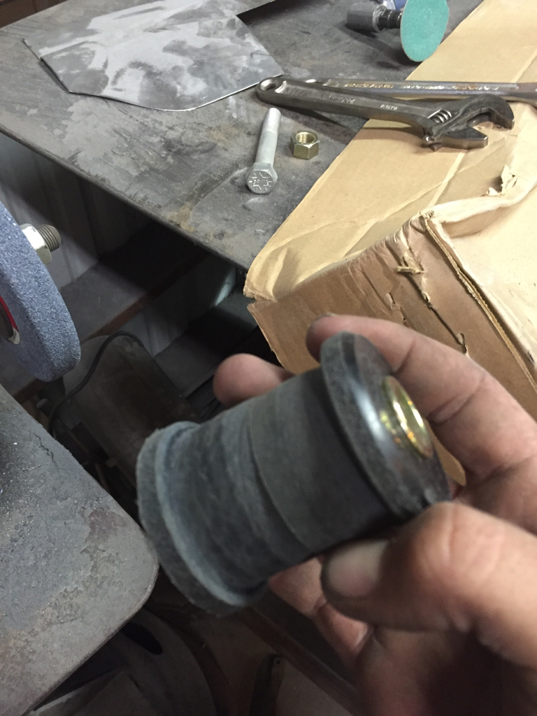

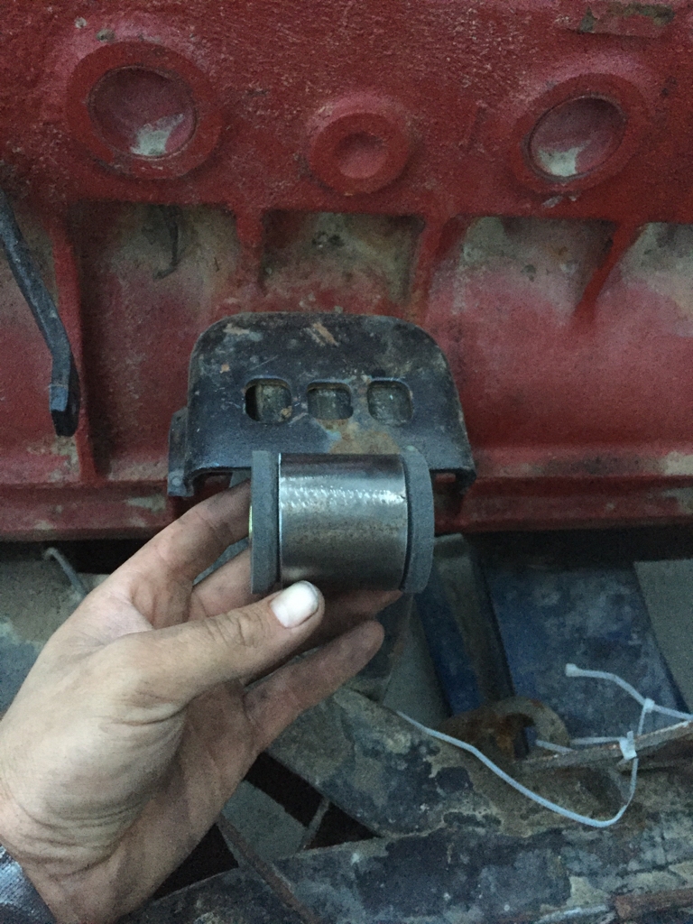

    I got new bushing's to make motor mounts today because mine are shot and the factory design isn't that great, in my eyes. I accidentally ordered them a 1/4" to big so after a little work chucked up in my redneck lathe (drill press) I got them turned to 1.75"
    I will mount it something like this I haven't figured out an exact plan yet. ImageUploadedByH.A.M.B.1453346473.199155.jpg

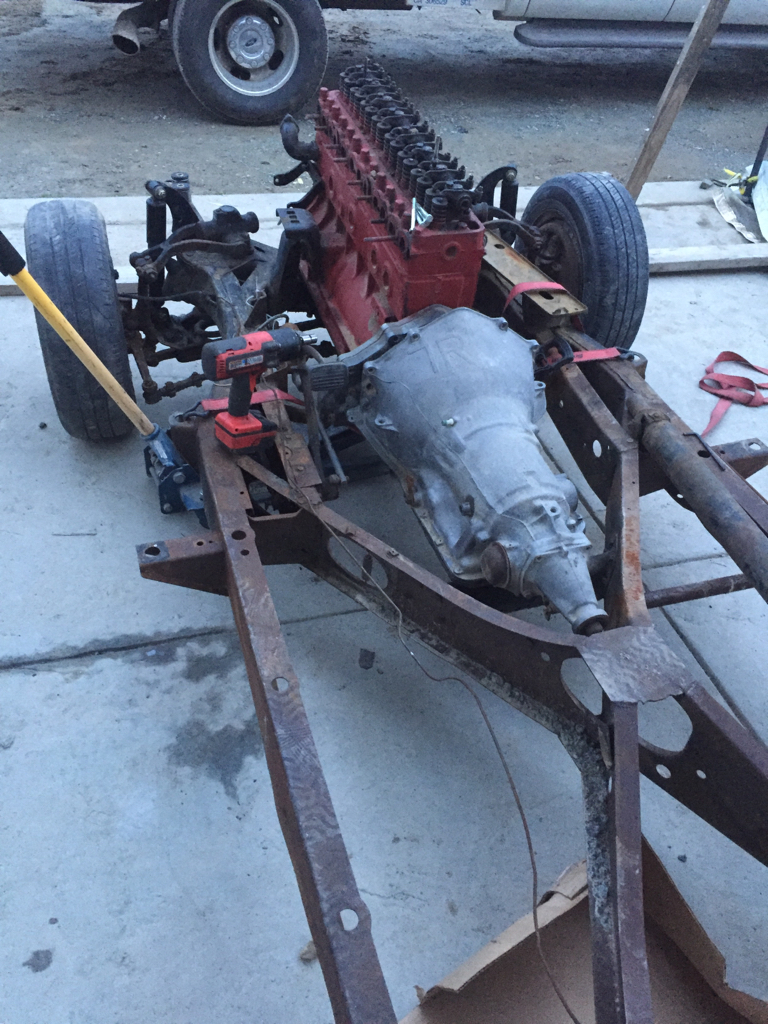

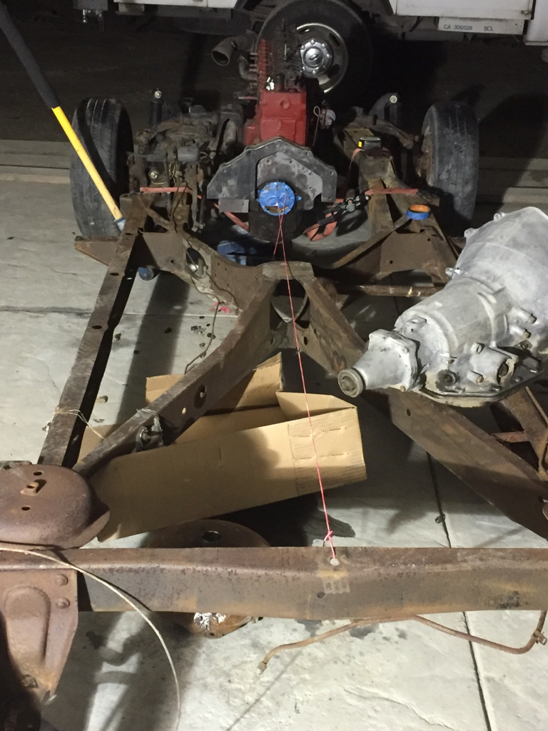

    I got my Bendestons adaptor on my "mock up motor" then I set the Trans behind it just to see where I'll need to make the transmission mounts. Then I took the Trans back out and ran a center line down the frame so I know the motor is nice and straight. ImageUploadedByH.A.M.B.1453346780.356068.jpg ImageUploadedByH.A.M.B.1453347119.503755.jpg

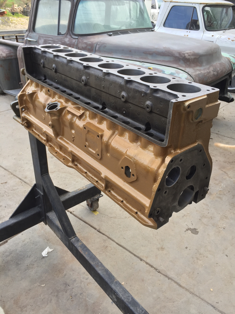

  24. ImageUploadedByH.A.M.B.1457379595.315516.jpg ImageUploadedByH.A.M.B.1457379615.505625.jpg ImageUploadedByH.A.M.B.1457379634.132077.jpg
    Got my block nice and clean along with the head. I also got all the threads chased then painted everything. Laid out nicely. I was shooting for more of a gold and it came out a little browner than I wanted but I still like it. Now it's time to start getting the motor together. I'm still in the air on which Trans I want to run but I'm now leaning towards a 700r4.
