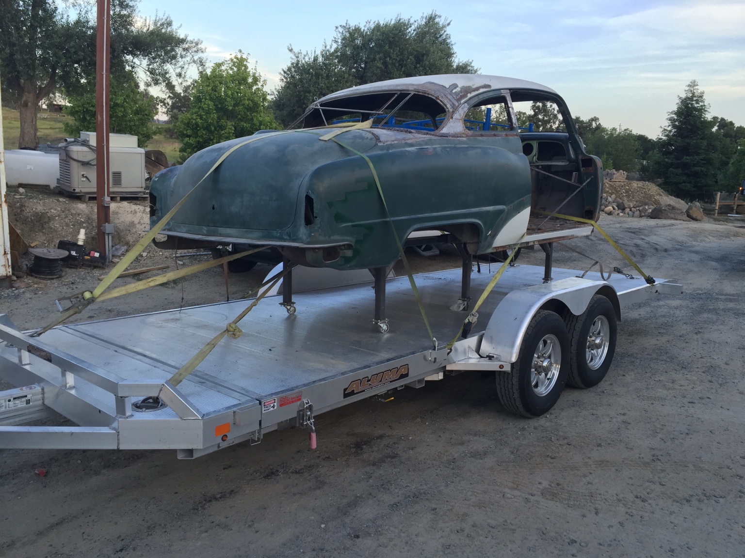

    Got the body and doors loaded up heading to get blasted in the morning!

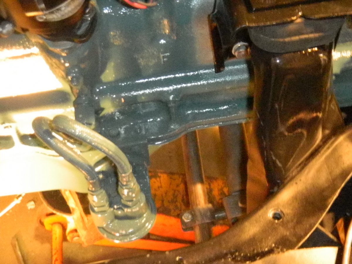

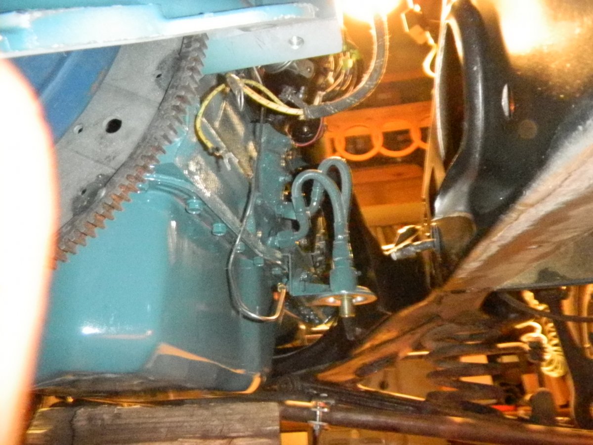

    Here is a pic of the one on our 263. It is bolted to the pan rail on the right side of the engine just below the distributor. DSCN2259.JPG DSCN2259.JPG DSCN2255.JPG DSCN2255.JPG

    Everything is the same except for a "detour" out to the filter and back in to the same vertical section of the oil gallery coming directly from the oil pump. To make the plug that goes between the two tapped holes, I used a grade 5 bolt. I turned it down in my lathe to exact size of the vertical gallery diameter. That gallery is a machine bored hole that the oil pump mates to feed oil to the engine. I then cut the plug to be just shorter than the distance between the 3/8" NPT tapped holes. Next, with the engine on it's side, I carefully pushed the plug into position, stuck the nipple of a red Loctite tube into the set screw hole and gave it good squeeze. This injected Loctite around the plug and filled the threads of the set screw. I then inserted and tightened a case hardened set screw to secure the plug from ever coming loose or shifting.
    After the drilling and tapping process be sure to blow out with high pressure air and a gun cleaning brush all the oil lines in the block. This should including removing the plugs on both ends of the main gallery and it's 4 cross gallery plugs. These 4 oil line feed oil to the crank and cam bearings. These 4 lines are where the old motor's crud is lurking to spoil a new set of bearings.Even one that has already been hot tanked. CLEAN CLEAN CLEAN. Don't reduce the orifice size that feeds oil to the rocker shaft. The rocker shaft need as much oil pressure as can be gotten, oil should be push through shaft rocker holes and through the rocker, through it's adjuster and down the push rod to feed both hydraulic or solid lifters.
    Hope this info can be useful.
    Best Regards and good luck with all your endeavors, KB.

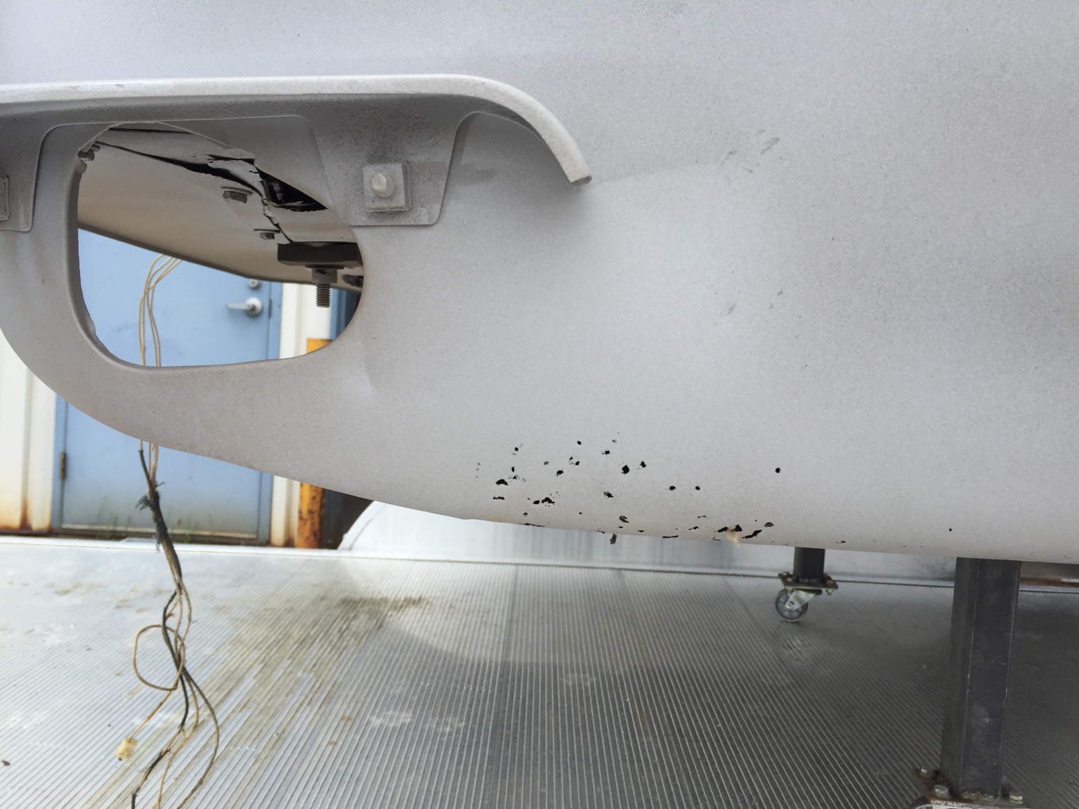

    Well got her back from the blaster! Not many surprises I knew the floors were bad. Little surprise sent on the passenger side and the last pic shows rust under the rear window crank. Really weird spot. Picked up a sheet of 18g yesterday time to get busy!
