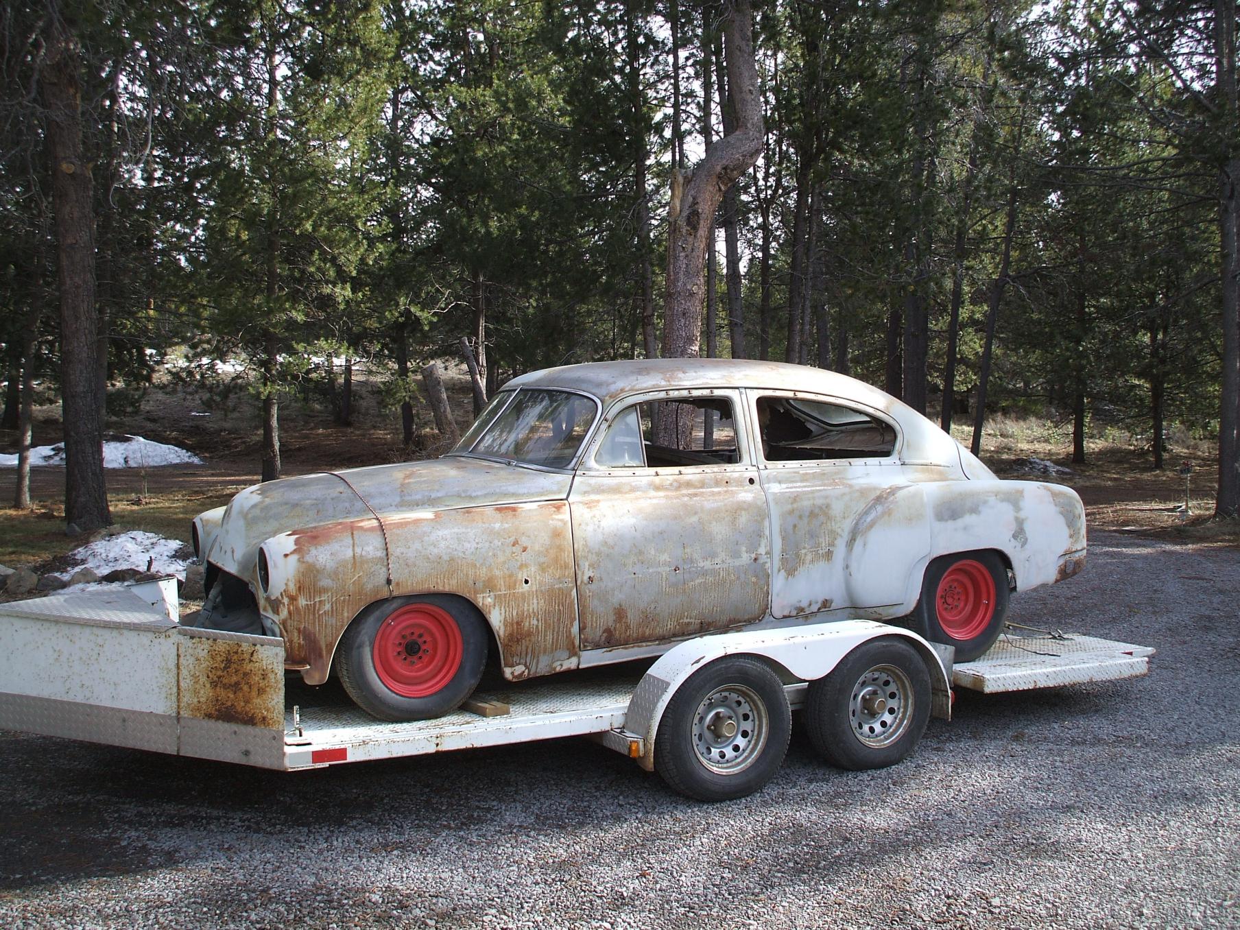

    not sure if I'd destroy that sound deadner/insulation in the decklid (bootlid)...it is sandwiched in between the inner structure and outer skin...if you do get it out how will you get something back in there without removing the outer skin...BIG JOB....you might just trim out the openings and leave it where it's sandwiched tight...
    That was what the previous owner did on this fleetline project I just picked up
