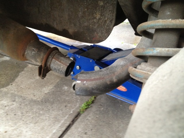

    So I had a day off yesterday, and a****st the ****tered showers we finally parted the jag from its rear end. It was relatively straight forward, if not time consuming.
    In the photos you can see I've removed the front end and the car was resting on its rear wheels and two wheels laid flat either side at the front (all 6 of the jack stands I have access to are being used, and besides, it's more professional this way...)
    So I jacked it up from the centre of the diff/cradle and removed the wheels off either side. Due to there being a gas tank installed in the boot, they used some thick plating to reinforce where they secured the tank to the boot floor... blocking access to the nuts holding the diff mounts to the body.
    So we tediously removed the 4 bolts from the inner side of the mounts on either side (just visible in the photos) and ran into our next problem: The exhaust that had been re-routed THROUGH the cradle, between the axels and the body. So busting out the angle grinder, we cut through it on either side of the diff - on a side note, whoever ran that exhaust must have spent a ****** long time on it, it's very tight quarters in there.
    Once done, we grabbed the pry-bar to drop the diff down and all went to plan. The last thing holding it in place were the two front sway bars (?), the ones that stop the diff tipping forward.
    The rubber was totally shot and had fused the arms to their mounting point, so I grabbed the propane torch and melted those ****ers off. Cop that, environment.
    And that was that, the diff was now free. So we wheeled it out and had a look at it. It seems it's been robbed of a caliper on one side (fu) and may have a slight seal leak, but otherwise there's no free play in it and it appears to be alright. I'll give the guy a call I bought the car off and see if I can get the caliper off him... unlikely but worth a shot.

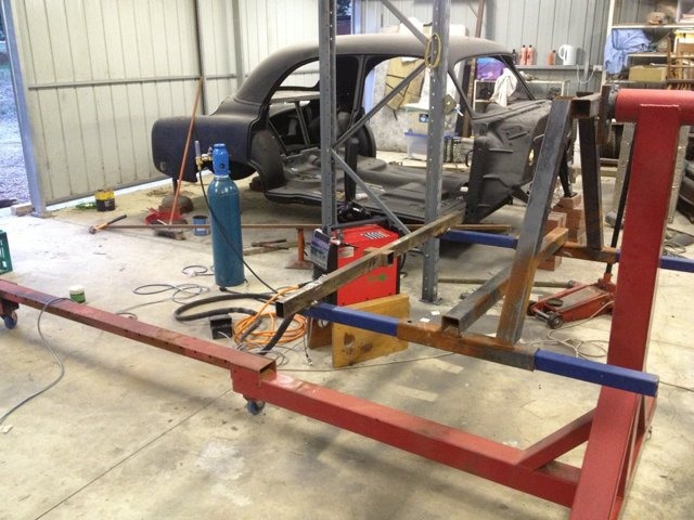

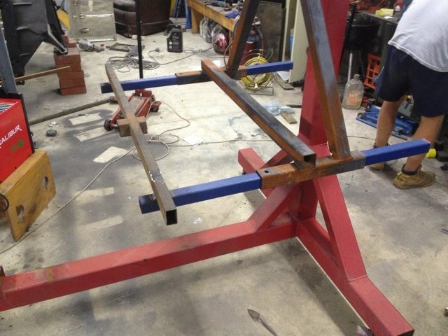

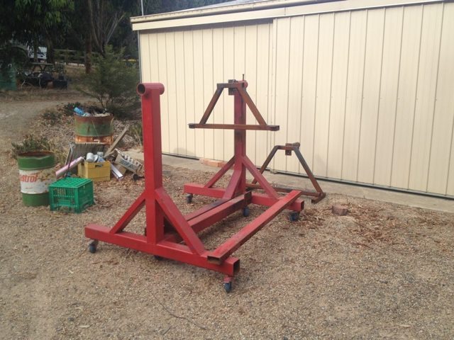

    So I spent most of yesterday measuring, cutting, squaring, drilling and welding and have finally got the rotisserie ready to go. Just need a couple if people to come around and help lift it on.
    Slow progress is still progress!

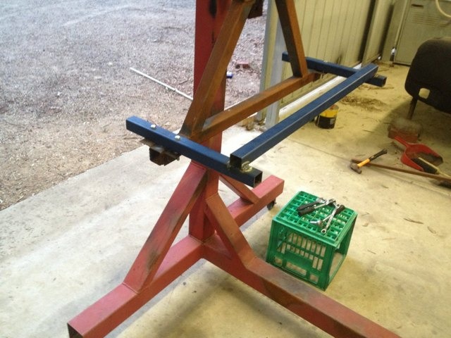

    Body is now on the rotisserie! Just have to make up a bracket for the front end to drop it down about 160mm (as it was originally made for a '57 chev). Hopefully ordering some patch panels from the states this coming week or two! Photo's to come.

    I'm solid mounting the front end and then will just make up some brackets for the shocks. Some people will say the front end "just lines up" and while its close - it doesn't.
    And we just picked the body up and put it on the rotisserie, two people at each end.
