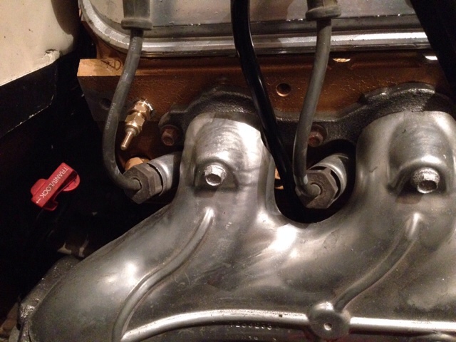

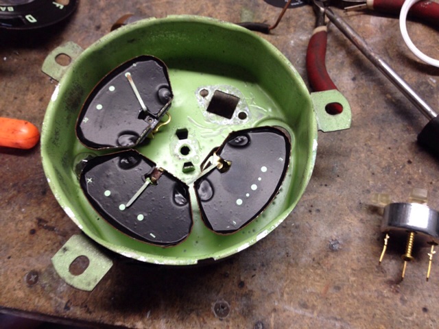

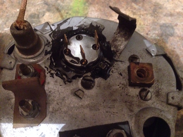

    And I started making sure all the gauges worked before hooking them up, and sure enough, the mechanical temp gauge didn't work. So I took a cheap mech temp gauge and gutted it, replacing the existing stuff. ImageUploadedByH.A.M.B.1402181074.185875.jpg ImageUploadedByH.A.M.B.1402181090.268427.jpg ImageUploadedByH.A.M.B.1402181146.352603.jpg ImageUploadedByH.A.M.B.1402181182.504716.jpg
    Of course, in the process of mounting the sender for the gauges, the br*** adapter broke off in the head, which meant drilling and retapping the alum head. But it finally seated and all appears to be working ok. ImageUploadedByH.A.M.B.1402181297.818611.jpg

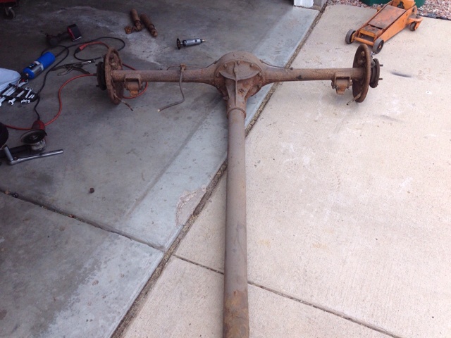

    One of the last big things I've been needing is a rear axle. It still had the original closed rear end, and I had pretty much resigned to pulling a Blazer rear out of the junkyard. But since I don't have a trailer anymore, it was gonna be a big deal.
    Lo and behold, the morning I was thinking about heading to the yard, I look on Craigslist and there was a complete rear axle from a '60 Biscayne for sale, drum to drum, dis***embled for only $50! So I headed down to Pueblo to pick her up! ImageUploadedByH.A.M.B.1403395411.821366.jpg
    The 1st thing I did was remove the old wheel studs and redrill the axle shafts for 1/2" studs (since the Jag front uses them and I didn't want two different size lugs). ImageUploadedByH.A.M.B.1403395063.571684.jpg
    Removing the original axle was a bear...60 year old nuts aren't too keen on coming loose. But after a couple of hours with heat and air tools, the rear was free! ImageUploadedByH.A.M.B.1403395376.504671.jpg
    New was grinding off the old brackets and getting the housing ready for the new perches. ImageUploadedByH.A.M.B.1403395344.021125.jpg
    Got everything in place, welded the perches and put on some underhood black paint. ImageUploadedByH.A.M.B.1403395294.321084.jpg
    Still need some leaf spring plates before solid mounting, but it's getting there!

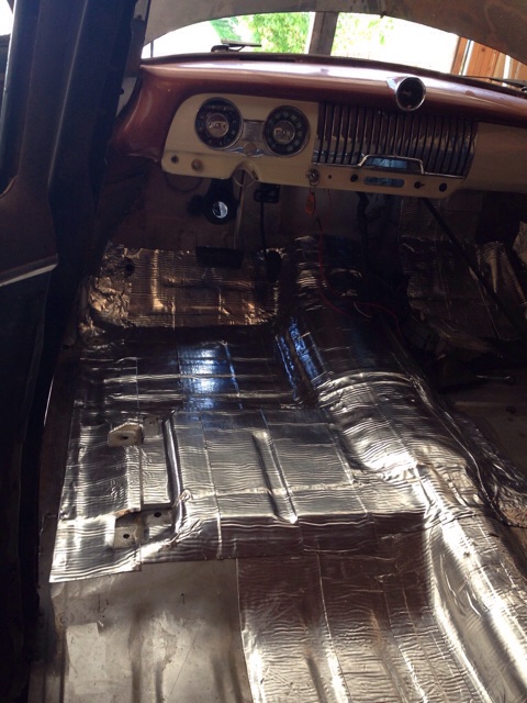

    A little more progress. Been putting sound deadener on the floors. Heard good things about Peel and Seal, so I cleaned out Lowes.

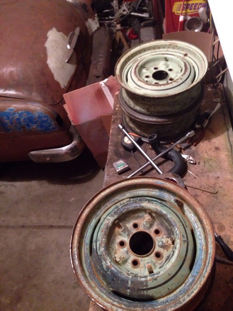

    Thanks to Greg (aka Daddy_O), I was able to get a new set of wheels for the car! The others were rusted in half. Good to meet you today at the swap meet in Loveland.
