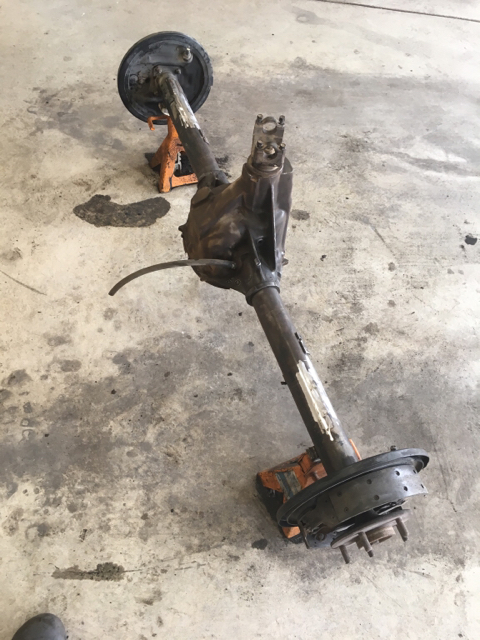

    IMG_0868.JPG Ended up rebuilding the rear axle and replacing the carrier bearings. It's not silent, but much improved. Will probably replace the axle bearings at some point, but I'm tired of working on the rear end. Hopeful to get tags this week, and then begin to drive her a bit.

    I've been driving the car for about a week now sorting out the bugs. My biggest issue has been the rear axle. It was making a lot of bearing noise, so I just replaced all the bearings. Sadly, it was still roaring/whining. After taking it all apart for the fourth time...it appears that the gears are worn beyond saving.
    So, off to the junkyard I went, and purchased a rear from a 96 Blazer 4wd with 3:42 gears. Put it in the back of my Audi, and cut all the brackets off. Hopefully tomorrow will weld on some new brackets and get it back on the road!

    Got the new Blazer rear installed, and it's nice and quiet. However, it has highlighted that my driveshaft is out of balance.
    Gotta get that done next...it's always something. But at least it's running!

  16. Great job on this project! Quick question. Was the Blazer rear out of a full-size Blazer? How is the fit in you car width wise? Bolt pattern the regular Chevy 5 x 4.75? I’m asking because I'm looking around for a rear for my '51 Sedan Delivery project. Thanks!
  17. seanbelushi
    Joined: Jan 26, 2011
    Posts: 175
    seanbelushi
    I used the rear from a 1996 S-10 blazer 4WD, which was perfect width and bolt pattern (5x4.75")
  18. Ah okay! I don’t know what the width is on a full size blazer of that era but I was thinking it might be too wide. Thanks for your reply. That really helps me out.

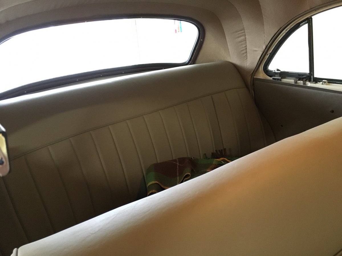

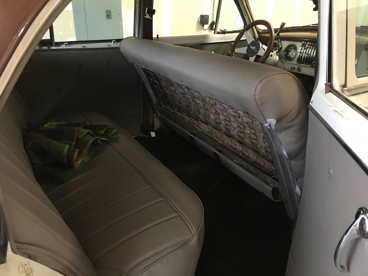

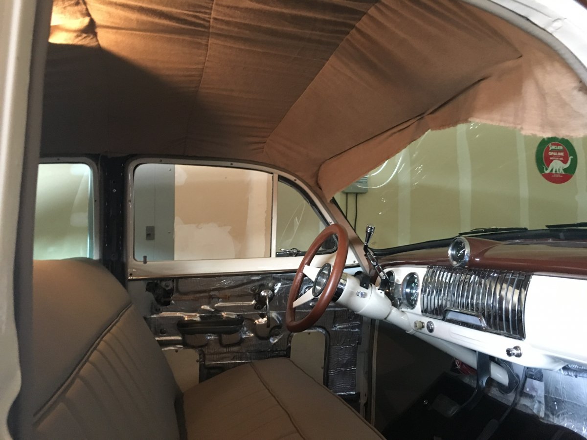

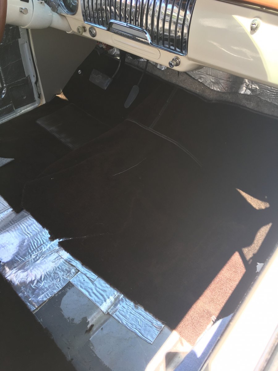

    OK, quick update:
    The car is nearly done. Installed is a new interior kit from National Chevy Association, and I’m just missing the back of the front seat and the door handles to finish.
    1A16DBAD-029D-4406-8FE0-0B2BF8698147.jpeg 7FC1EF0B-2C8B-41A7-A60A-B2610AD422F3.jpeg 4B8D635F-97DA-42AB-B949-576C4B1E84F4.jpeg EE9F1389-B636-44AE-83BA-8D43F7F7CDD1.jpeg
    All that’s left to finish the car is the seat back, front/rear bumpers, new gauges (the current ones are original but can’t make work with the new trans), grill, and HVAC. Hopefully that will come sometime this year.
    Thanks to everyone who has followed along with this build process. Off/on it has taken nearly 8 years but it’s been a great process.

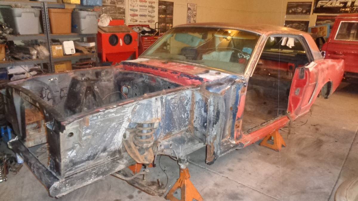

    The 52 build continues, albeit slowly. Been working on the non-H.A.M.B. friendly Mustang for a while.
    The 52 has been put out in the cold for now, but it’s coming back soon! IMG_0259.jpeg

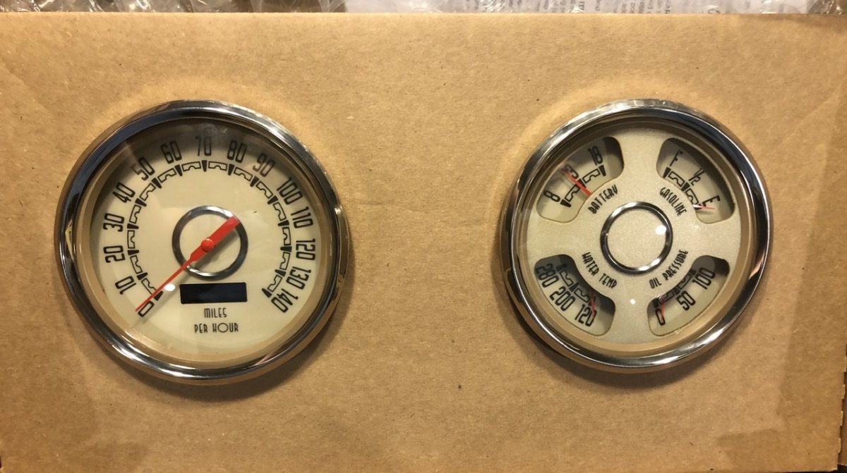

    Picked up some gauges for the ‘52 from New Vintage USA, they’re the Woodward series and they’re beautiful. Hope to have them installed soon, and will post a review on my youtube channel.
