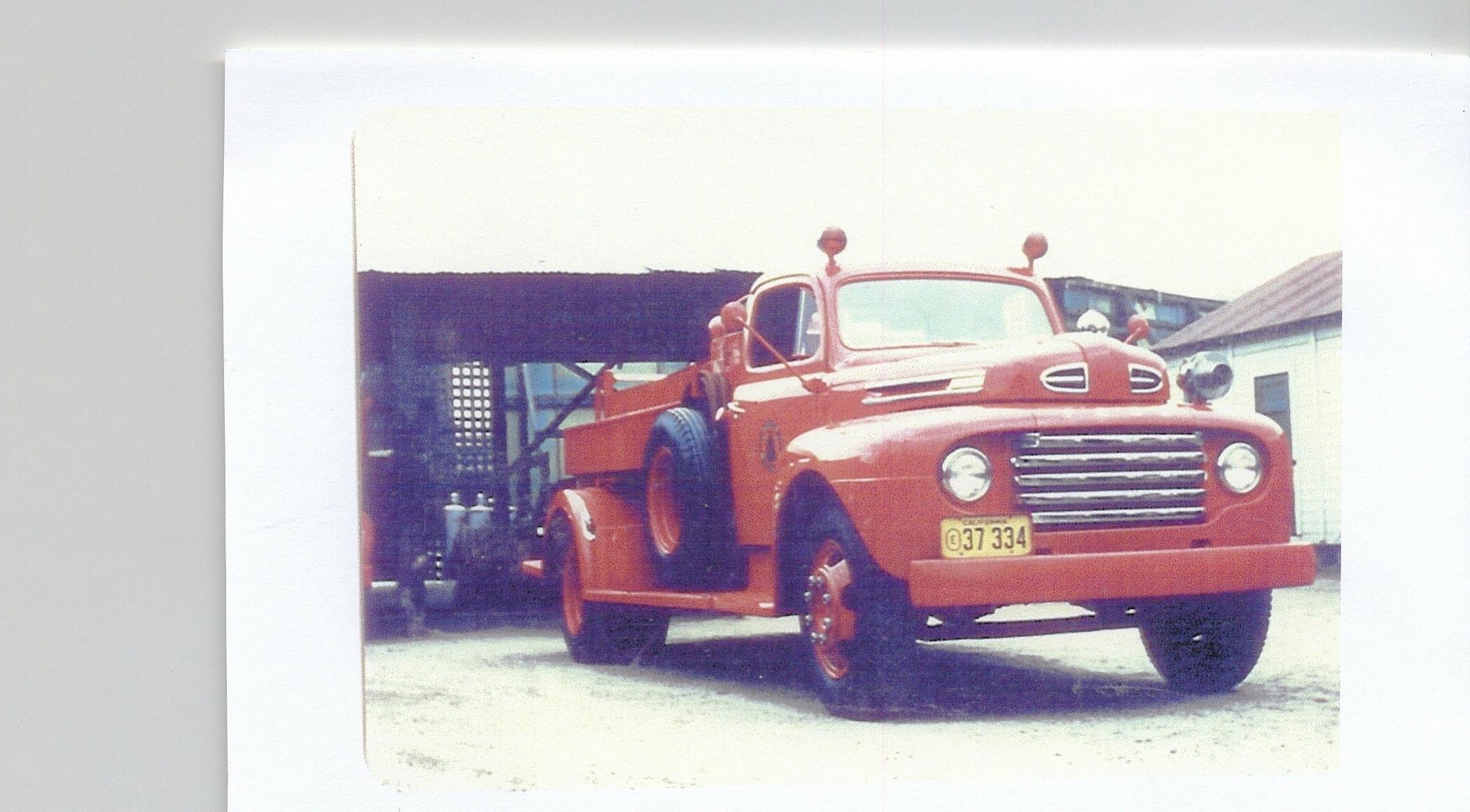

    All of that vintage F series came stock with a behind the seat gas tank unless it was an f-5 or larger which had an option for a set of saddle tanks. We got the stock version in our F-8's and had a aftermarket 36 gallon steel tank installed under the skid pump package. Those all served until 1974 when they were sold. I saw one last week still running with the 336 V-8 flat head and the aftermarket tank still functioning. They are available on line. I also see a 18 gallon version online also.

  15. Abomination
    Joined: Oct 5, 2006
    Posts: 6,772
    Abomination
    I've seen this setup from the factory - the filler was inside the rear fender though. Inside the wheel well!
    It was on an old flatbed or something.
    I figured I'd use the stock, in-cab tank and the delivery tank as well. If I have the space, and am towing a camper through the mountains, why not?
