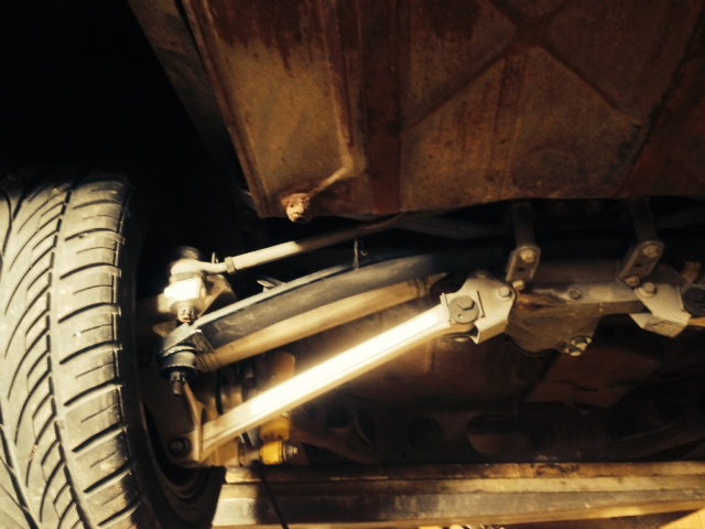

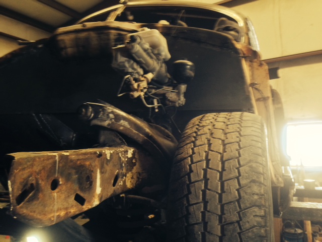

  4. Here is an update, I decided to stub the front of the car with nova rear steer suspension mostly because of the aftermarket parts and the ability to fully tune the suspension with tubular control arms. The other reason is the disc brake availability, I will be installing 13" rotors with the tubular control arms. I installed a c4 corvette rear from a 1993 corvette and will add coilovers in the back again fully tunable, the hudson will not only stop now but out corner the rest of the hudson's. The brake booster is from a 1988 Thunderbird turbo coupe along with the pedal assembly, I will use a gm tilt column, this Hudson is a real Heinz 57.

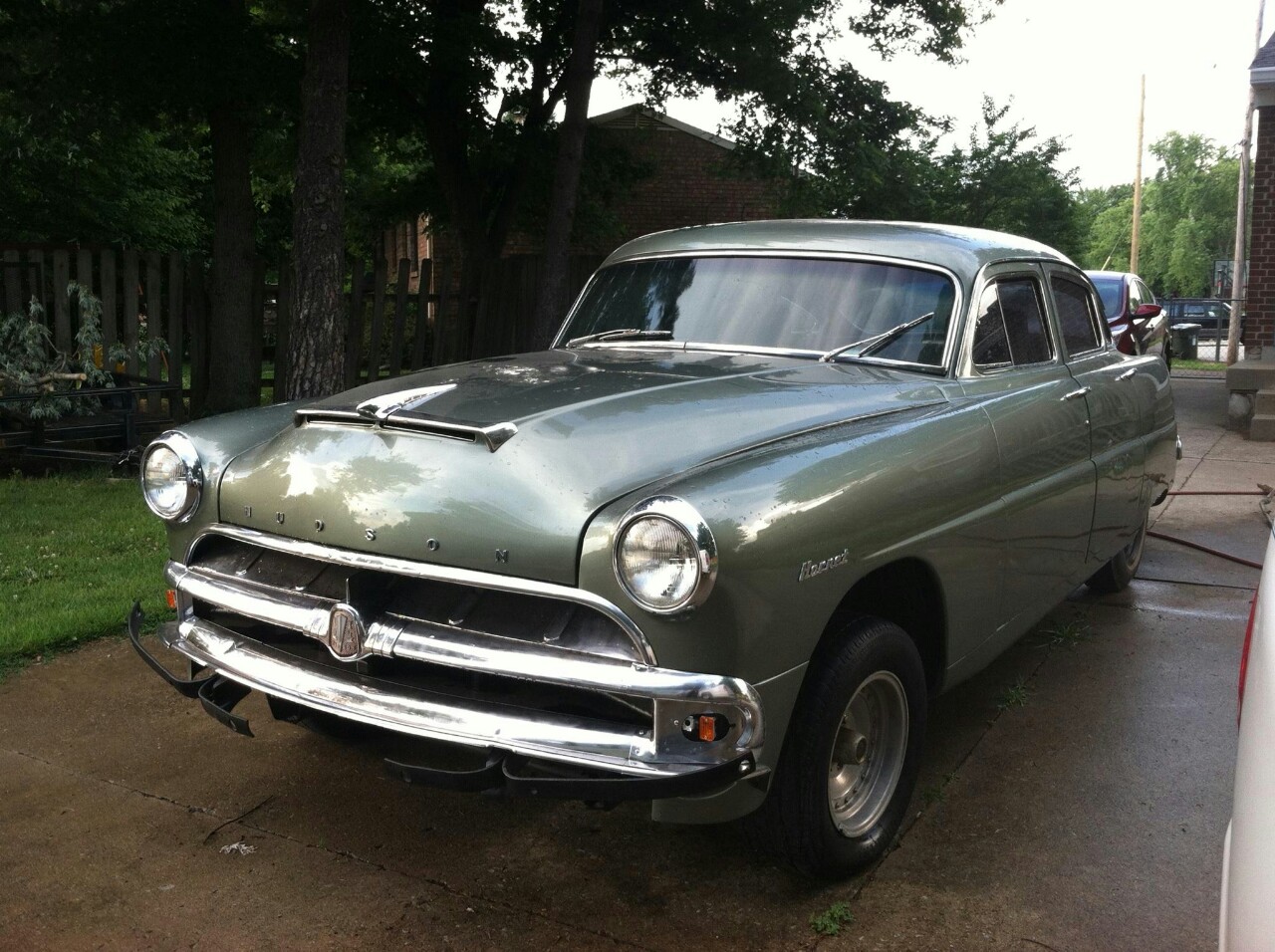

    Nice ride looks good when done. look up KGAP for all your rubber needs. here is my 54 Hudson hornet. 1954 Hudson Hornet.jpg

    "don't chop it! when thinking about motor & tranny swaps-remember the steering is behind the engine cradle you will need a rear stump pan for any swap,460 rear stump pans can run high $$'s"
    460 rear sump oil pans are actually cheap and easy to find, they came stock in Ford vans
