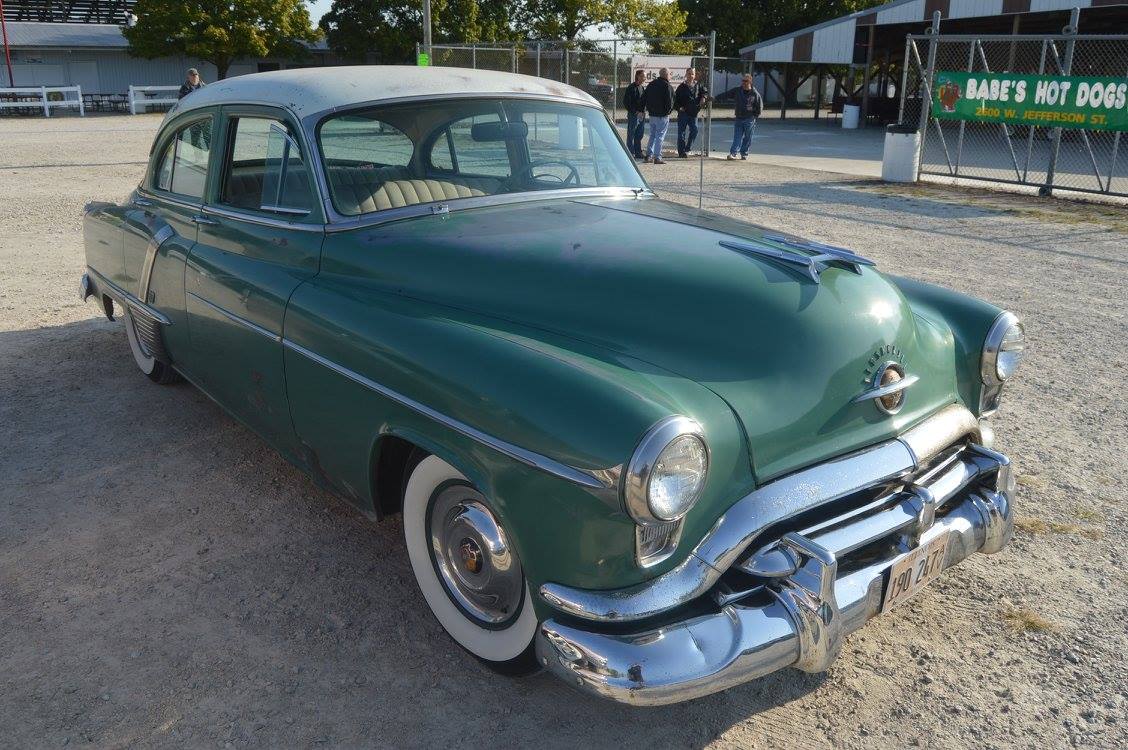

    IMG_1236.JPG Took 10 minutes to try out 1000 grit wet sand on the drivers side rear quarter. Then a quick wax. Not bad for 10 minutes. Hit it with some compound, polish and wax and we should be in business. You can see the difference where the door meets the quarter panel.

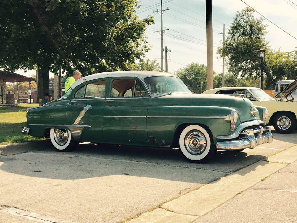

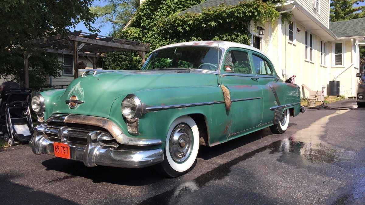

    Made some great progress this weekend! Back on her feet with her newly painted wheels and Coker WWW bias plys (thank you Alliance!) We got around the block one and a half times, then it started running funky - anytime I would put my foot into it, it would act like it was starving out, and would nearly stall out. Fuel pump, fuel filter, and all new fuel lines. We are wondering if it is possible that since it really hasn't run like this - or this long - in YEARS, that some carbon loosened up. It is certainly only running on 7 cylinders. I am going to start with checking the plugs, and then if needed, do points, condenser, cap, rotor, plugs. We also got the new master on (ended up with ordering a factory one, as the dual Corvette style was just going to take too much time given my show goals). Brakes are still a little squeamish, not getting much pressure at the back, but plenty at the front. Going to replace all the lines at the back, including the rubber line from the frame hard line to the rearend, and also rebuild all the wheel cylinders.
    All that being said, the goal was to get it on all fours this past weekend and drive it. Which we did! Maybe not as far as we would have liked, but as we all know, set goals, but don't expect things to always go as planned! If we always thought things would go perfect, we would have quit working on these things years ago!!
    More to come!

    So after much deliberation and conversation with my club buddies (and some help here as well), it was determined that I was getting TOO much fuel. A club brother had a nice Holley regulator laying around, so we put that on there, and set it to around 3.75 psi, and man what a difference! I was able to get it around the block without any MAJOR bogging down (still happens if you REALLY lay into the accelerator), but I am also still down on 7 cylinders. New plugs and an oil change this week (the oil was quite g***y from previous flood out) and maybe a couple of degrees of timing advance, and I think we will be onto something. Almost there!

    Got it sorted out!! Been really enjoying driving this thing. I cannot get the grin off my face!! Even with the bias-plys, this thing runs and drives better than my '50 Chevy ever did. With all new AC Delco 45S plugs, shes running about 4.5 PSI of fuel. Also did an oil change, (talk about a pain in the *** with the canister filter - the cheap paper gasket that came with the new filter didn't seat well, and when I fired it up...well...you can imagine. Had to hand cut a new one from rubber cork gasket material - all good. Going to buy a spin-on filter conversion). Topped of the trans with Dex-Mercon, all new rear lines in the back. Stopping great, shifts great, cruises great. The bogging issues is a non-issue now. Could NOT be happier. Already been out and about, local cruise nights, and out to Jalopyfest, local trad show. What a blast! Also scored some short number '52 plates, and got some pinstriping done.
