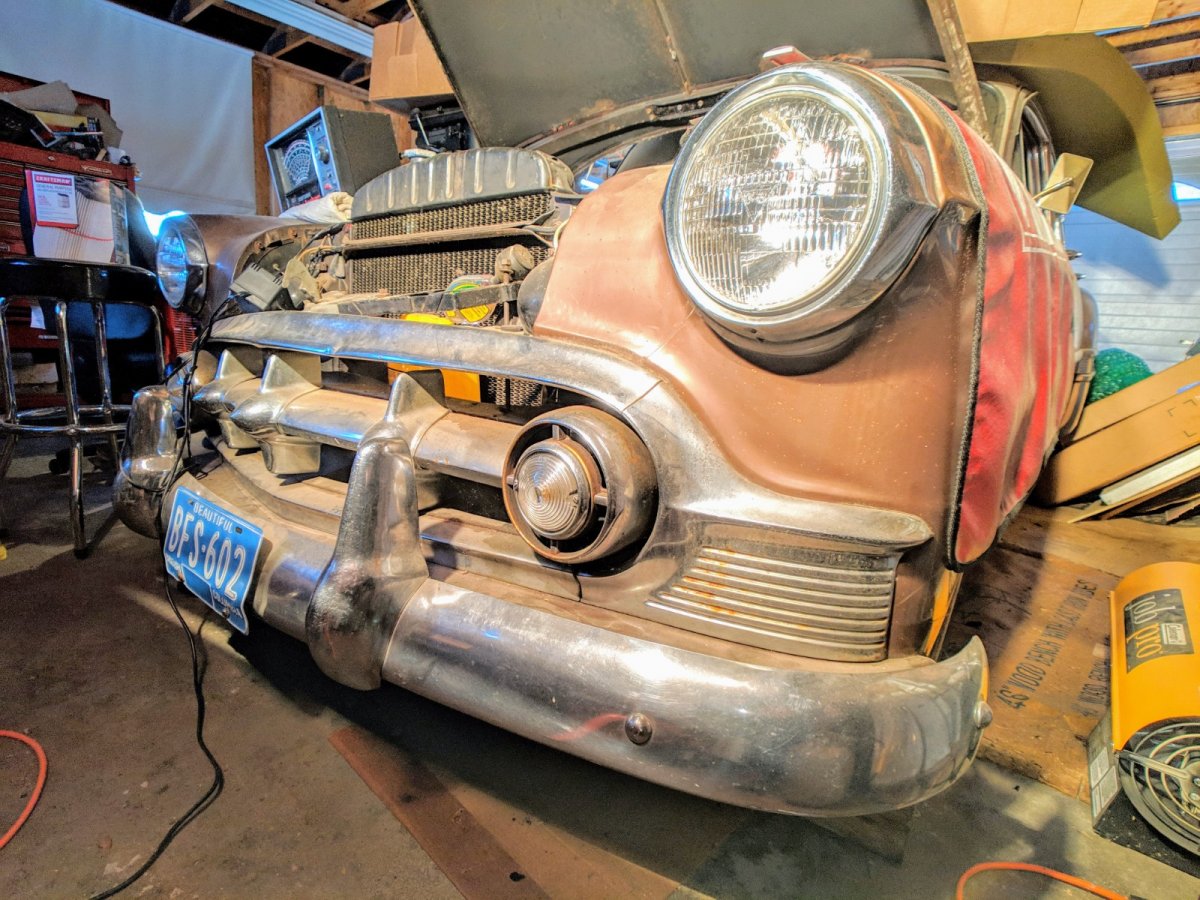

    Hi Everyone!
    I've done a few of these posts back over the past few years, but now the rubber is about the meet the road. I've gone from looking for alternative cars to realizing what I have and making the most of it.
    Long story short-ish: I'm 36 and I've grown up as my Dad has ever-so-slowly worked on his 1953 Bel Air (four door). The car has been in our family since it's first sale. My Dad purchased it from a relative in the Lower Mainland (BC). The car is in immaculate condition, but has effectively sat since 1977. My only memory of driving in the car while growing up was when my Dad got it operational (almost) until we then had to roll it to a stop after the brakes gave out. Ever since my Dad retired he had big plans to get things going on the car...until the unthinkable happened. All of a sudden he couldn't walk and was medivac ed to Vancouver for spinal treatment. Turned out that he had a non-cancerous tumor on his spine. Luckily it was non-cancerous and they were able to get it out, but on the other side of the coin, my Dad now has very very limited use of his legs. Getting better slowly, but far from rolling around on a creeper. I've been saving up over time and I've got enough set aside that I think, with a bit of hard work and a bit of expert help, we can get this thing on the road this year.
    I'll attach a number of photos to this post and some of the subsequent posts to come. Get ready for a ton of questions from a rookie!

  11. indyjps
    Joined: Feb 21, 2007
    Posts: 5,397
    indyjps
    Looks solid and complete, big bonus.
    Whats the drivetrain plans, tune up whats there? Might be worth pulling and regasket everything.
    Brakes need a thorough teardown and inspect, order wheel cylinders or rebuild kits, same on master cylinder.
    Body and paint look good, ready for a good buff and polish.
    Pull all the chrome (excluding pot metal) build a wood box and line it with plastic. Mix tsp of oxalic acid (wood bleach) or citric acid per gallon of water and let it soak, 24-48 hours. Wipe the parts down every 4 hours or so. Youll be amazed at the results.

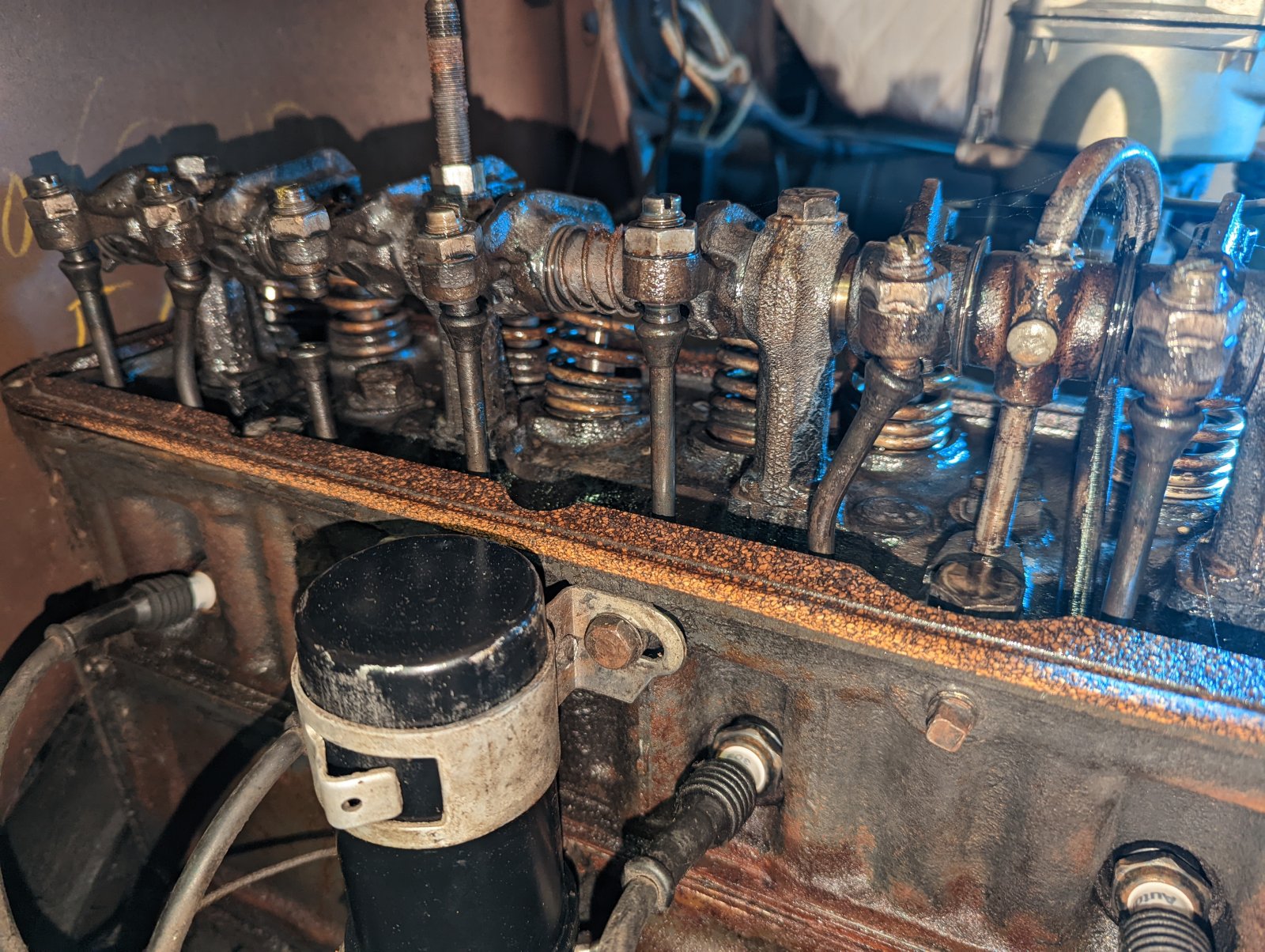

    Well, dusting off this old thread of mine again. Two children later I'm ready to take another stab at getting this car on the road. My dad is on board too but still has little mobility. Note that I have no idea what I'm doing and I'm doing this with Youtube and a prayer, lol.

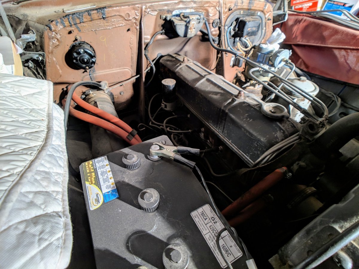

    I was able to free up the engine after soaking the cylinders in MMO. Spent the next while with ignition issues. Ended up getting a new coil, condensor, and points. Now have spark to the plugs. Here's where things went downhill.
    We attempted to start the car a few times with a new 6 volt battery. The engine almost caught once but then no luck. I pulled the valve cover and found a bunch of bent pushrods (see pics). I counted at least 5 that are quite bent and need replacing. A few others have a couple inches of vertical play and I have no idea what that means. Are they broken? Will I screw something up if I pull the bent ones out? I've started soaking the valve spring/guide with penetrating oil to hopefully free up the valves. Next up I plan to pull off the rocker ***embly to give me more working area in there and squirt in some MMO. If I'm able to get the valves to move I plan on replacing the pushrods and trying things again. If not, who knows.
    I'm in Canada and so far I've not been able to souce any pushrods for the 1953 235 (manual) engine. Nothing local, nothing national, and nothing through Rock Auto. Do any of you know anywhere to get them? I called one place and he thinks he can get some shipped from the US, but it will be around $15 per pushrod and $60 for shipping. I plan to replace all twelve of the pushrods while I'm in there, but definitely wasn't anticipating that to cost upwards of $200 by the time they get here. Do you recommend replacing all the pushrods or only the bent ones? I've never done pushrods before (I'm a total rookie at all of this), but do they just slide in once you remove the rocker ***embly or is there more to it?
    Anything else that I'm missing? My Dad is looking at the bent rods as being more catastrophic. Should I give freeing up the valves and replacing the pushrods another try, or am I just going to make matters worse if maybe the valves hit the pistons or something bigger happened?
    Thanks for any insight!

  22. fastcar1953
    Joined: Oct 23, 2009
    Posts: 4,416
    fastcar1953
    PM me. I have a set I will send you. I think you have more problems though. Might want to get a 54 or newer 235 and rebuild it.

  24. Summit_PG
    Joined: Dec 15, 2012
    Posts: 10
    Summit_PG
    from Canada
    Thanks Fastcar1953! PM Sent.
    I'm really hoping that we can make this engine work. I know that it ran as of 10 years ago and it hasn't moved at all in the 10 years since. My fingers are crossed that it is just very sticky/stuck valves, but any other ideas that I should start thinking of?
