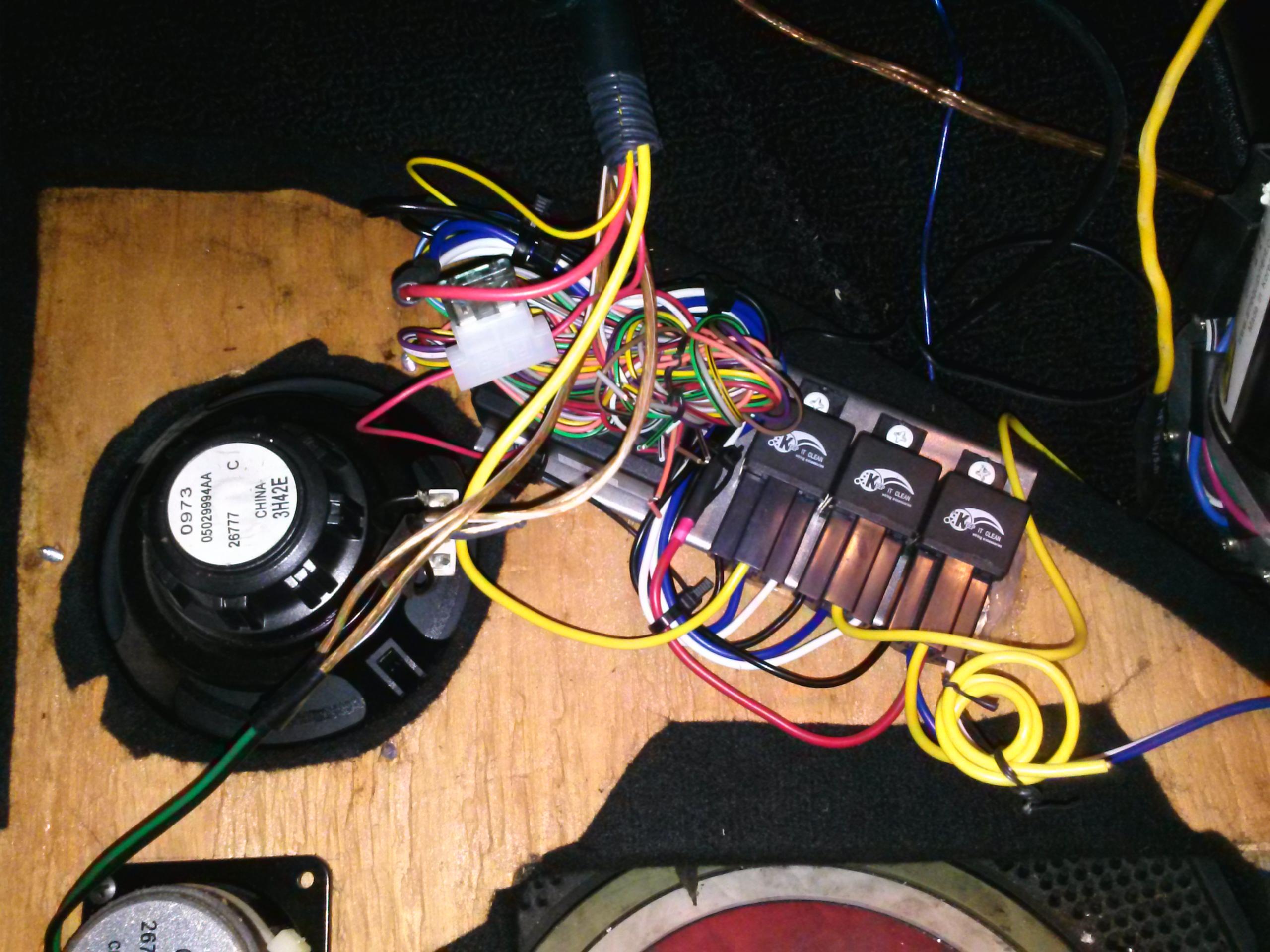

  10. jon83
    Joined: Nov 16, 2010
    Posts: 49
    jon83
    More photos of the door looms used ( two for the p***enger) and where i stuffed all the electronic stuff for the door solenoids. The exposed windshield wiper motor was the previous owners idea.. i liked it, so it stayed. Exposed transmission would be neat too.. but im sure would get quite hot.

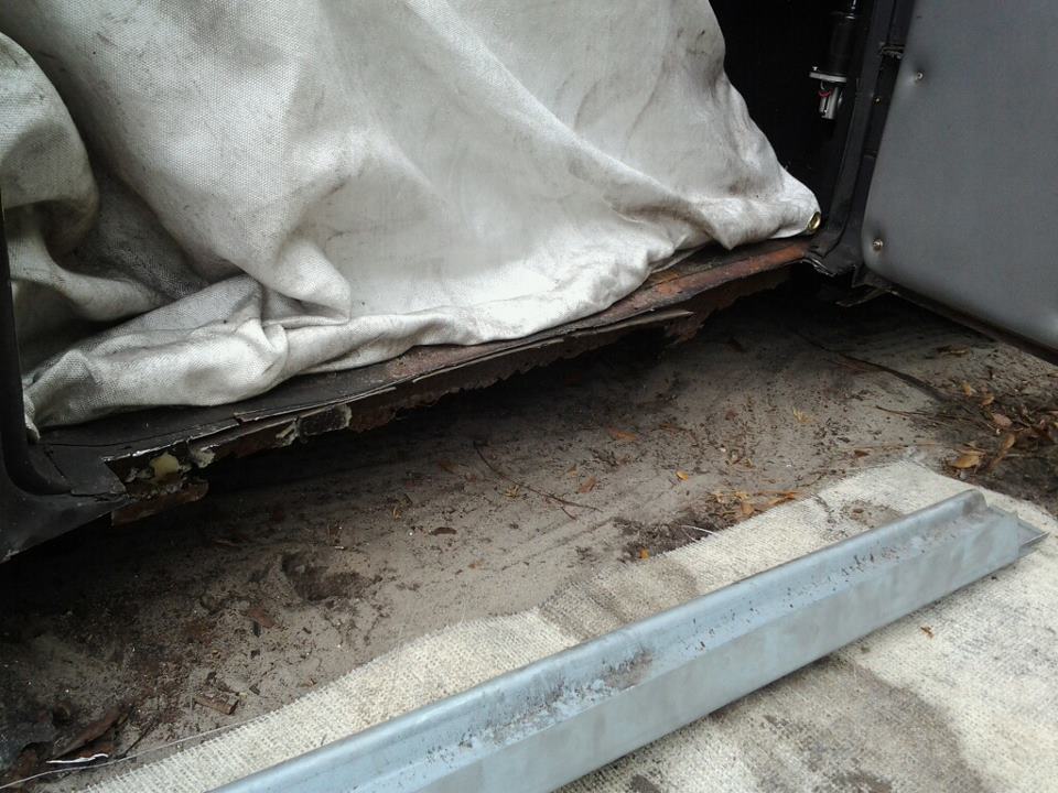

  12. jon83
    Posts: 49
    jon83
    Some more pictures i found of the rusticular cancer i cut out. After market rocker panels just arent the same..

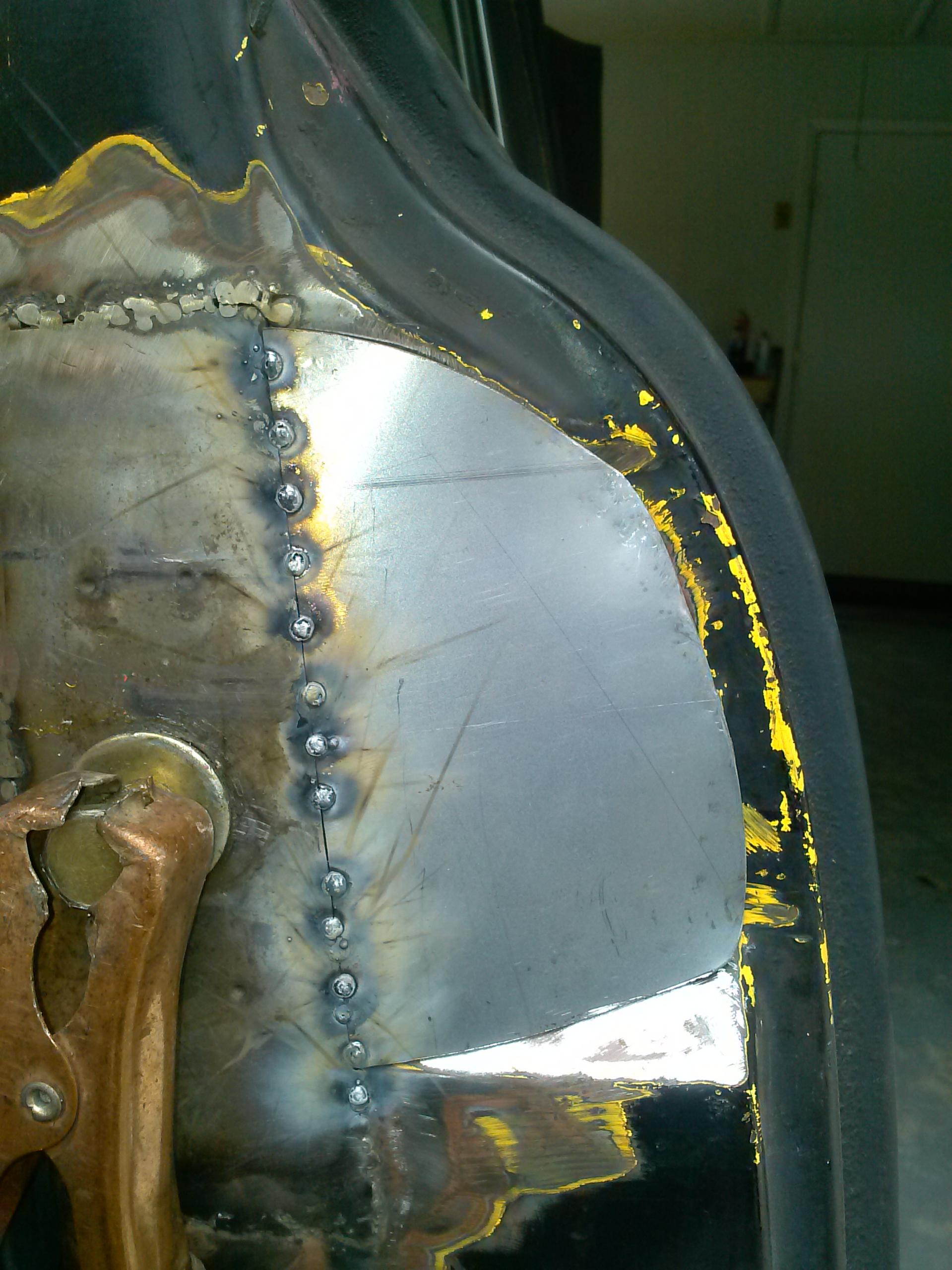

  14. Ulu
    Joined: Feb 26, 2014
    Posts: 1,775
    Ulu
    from CenCal
    Subscribed...
  15. jon83
    Posts: 49
    jon83
    metal box i made with lid for jack and other roadside tools. Its where the nitrous bottle use to be bolted in.

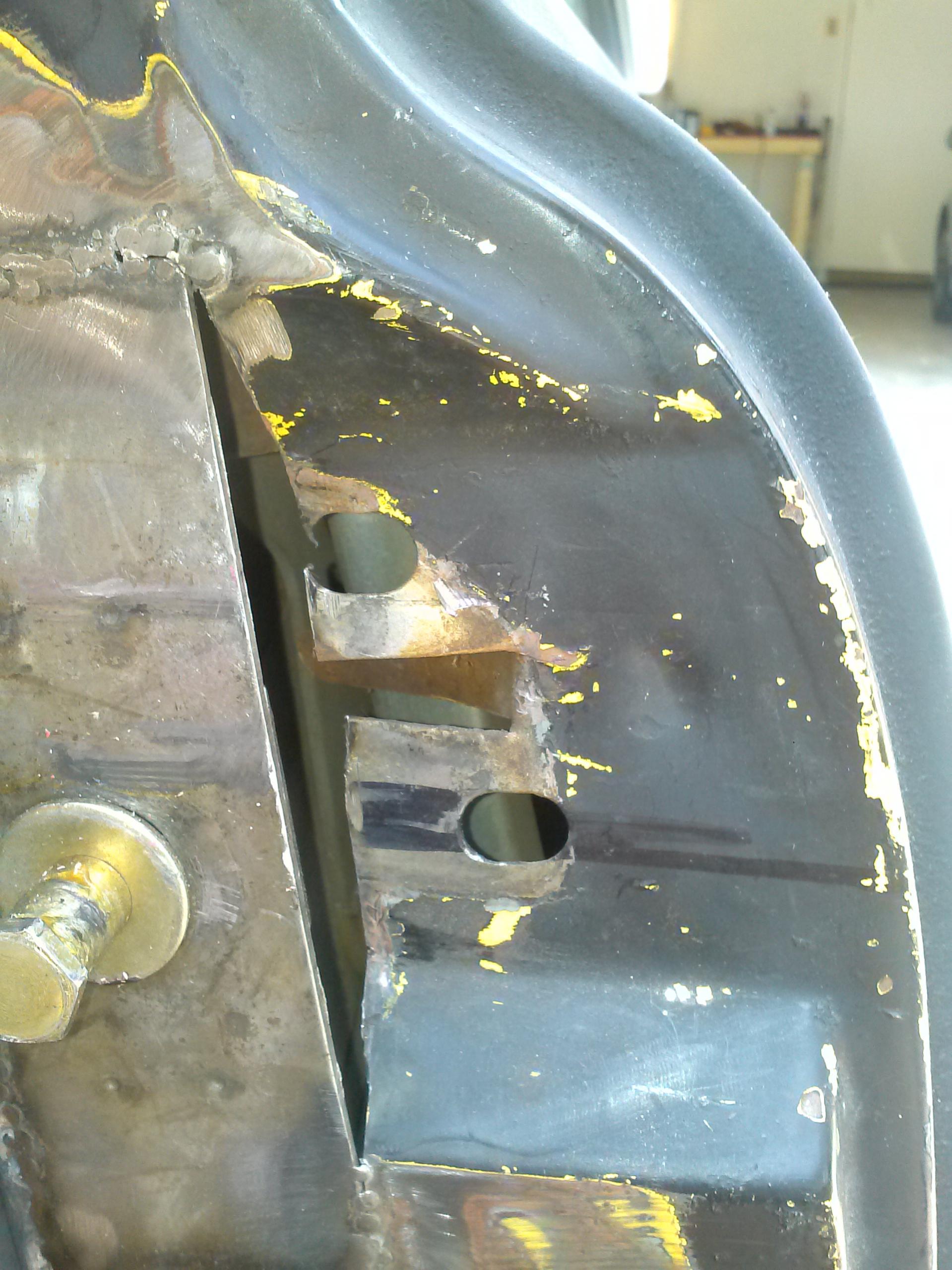

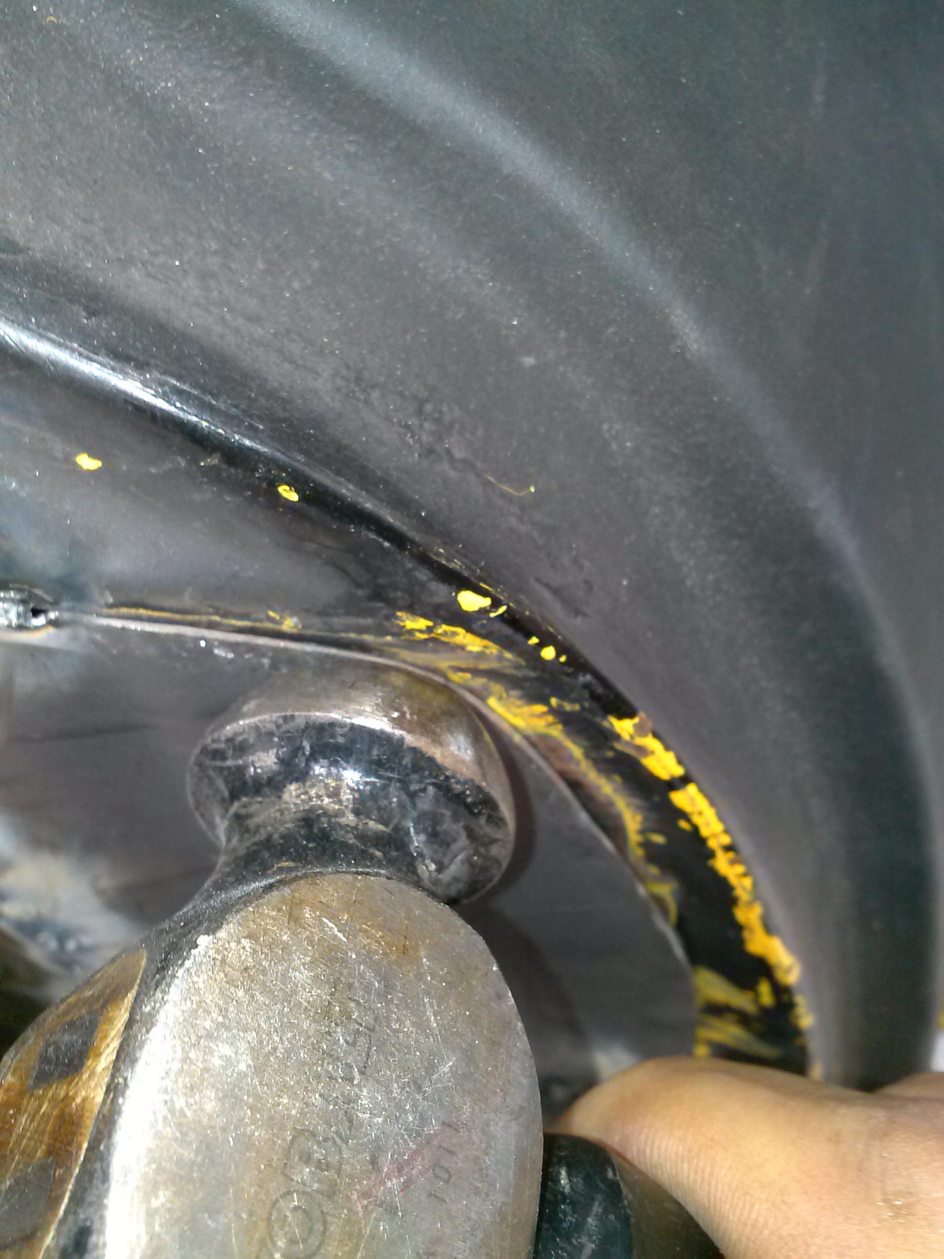

  16. jon83
    Posts: 49
    jon83
    Any thoughts on how to repair this part of the trunk? All i have so far for tools is some basic metal hammers, dollies, mig welder, bead roller, grinder, and just got a shrinker/stretcher...oh and a table top sheet metal bender.
  17. Ulu
    Posts: 1,775
    Ulu
    from CenCal
    Ya need to make a new "z" flange & roll it to fit the round corner. Then weld it to the inside of the body.
    Since you don't have a set of rolls you might consider just having someone roll that "z" for you
    Ohh...I see you do have a roller. You just need to do the setup to make the z then.
    (Hmmm...the "strikeout" function doesn't seem to work on this forum.)
  18. jon83
    Posts: 49
    jon83
    i have a roller.. but no tipping dies yet.. i think ill have to do it someday in two pieces. I can make the "C" shape, but more squared, with the table top bender. but i can only bend one way. so the C+7 shape..if that makes sense using the keyboard, i cant get.
  19. Ulu
    Posts: 1,775
    Ulu
    from CenCal
    Oh, yes, I see now the shape is more like a question mark.
  20. jon83
    Posts: 49
    jon83
    yes a question mark would be the easier explanation. Im just going to have to do It in two pieces if needed replace anything below that channel area. Now how do I make the curve? hmm.

  22. chopolds
    Joined: Oct 22, 2001
    Posts: 6,404
    chopolds
    from howell, nj
    Do it in 2 pieces with the shrinker stretcher.
