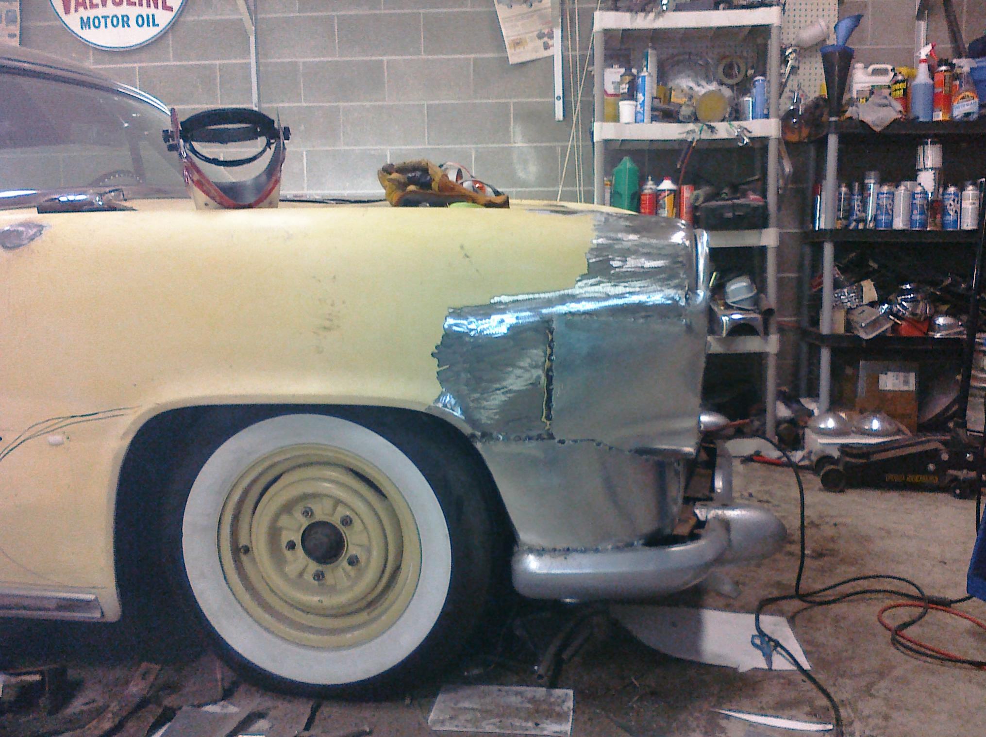

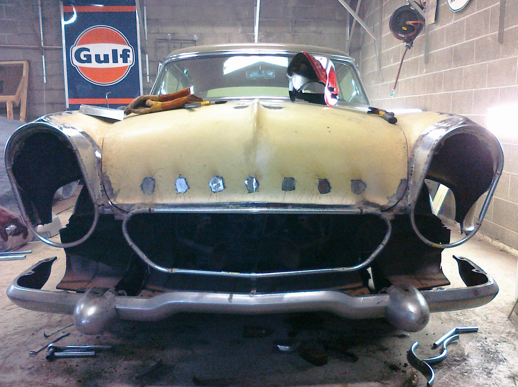

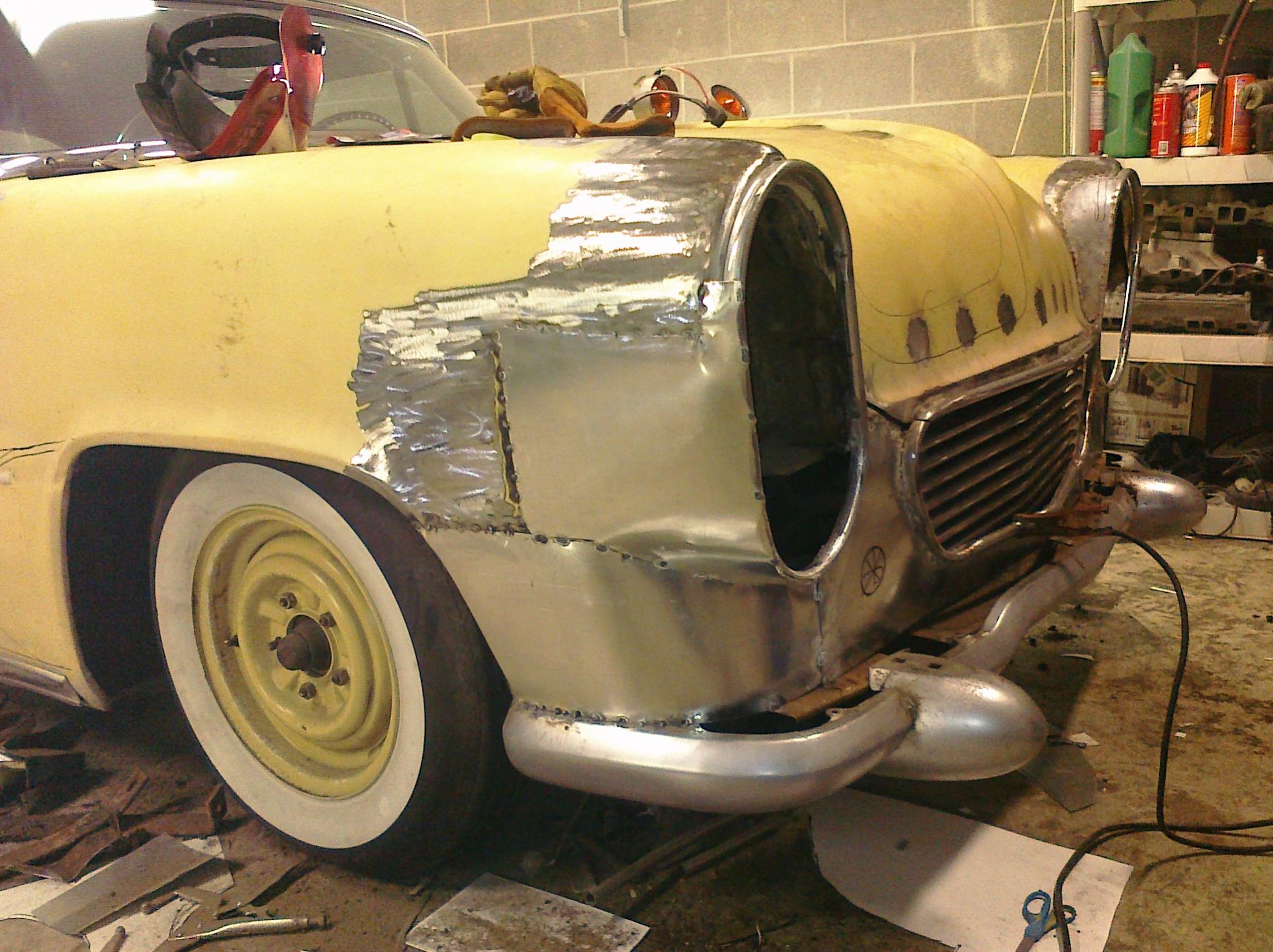

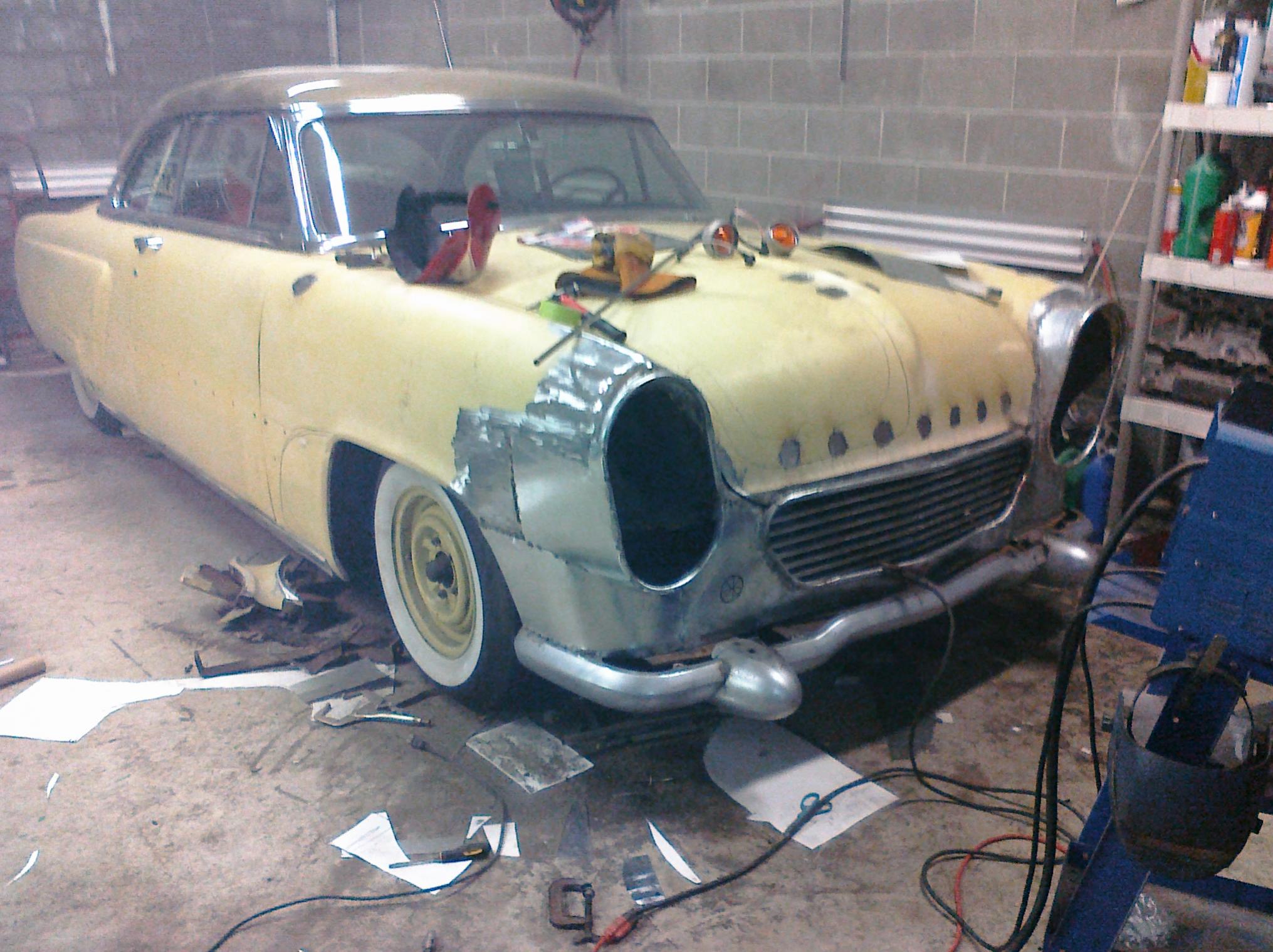

    some more progress

    I'm not in the cheer squad on this one. I think the lights look too big and the grille opening too puny and mealy mouthed. And the bumper is way too low.
  14. 4Door54
    Joined: Oct 24, 2009
    Posts: 250
    4Door54
    from Nor*Cal
    I kinda gotta agree with X38. I like the concept, but the proportions dont look right.
  15. Jay-acerra
    Joined: May 9, 2007
    Posts: 57
    Jay-acerra
    from pa
    I was kinda worried about the bumper height also,but there is really no room to move it up anymore,it has been moved up about an inch and a half from the stock location already,once the turn signals are maid and set in place they will take up some of the bare space around the grill and pull it all togeather,Thanks again for the replies

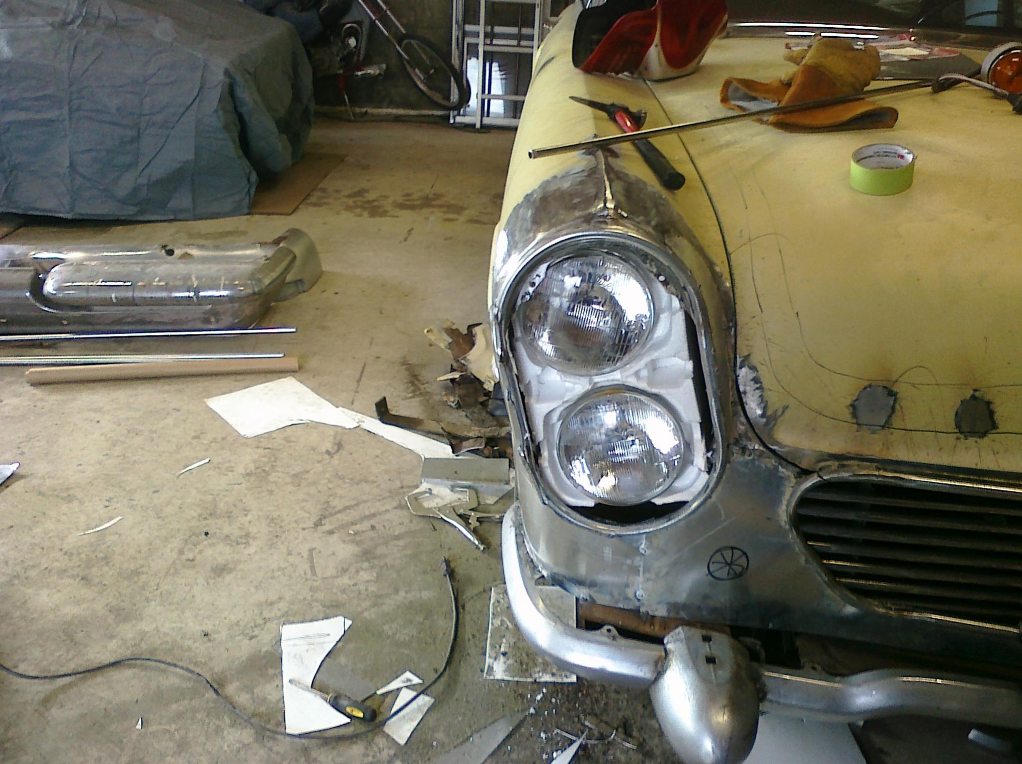

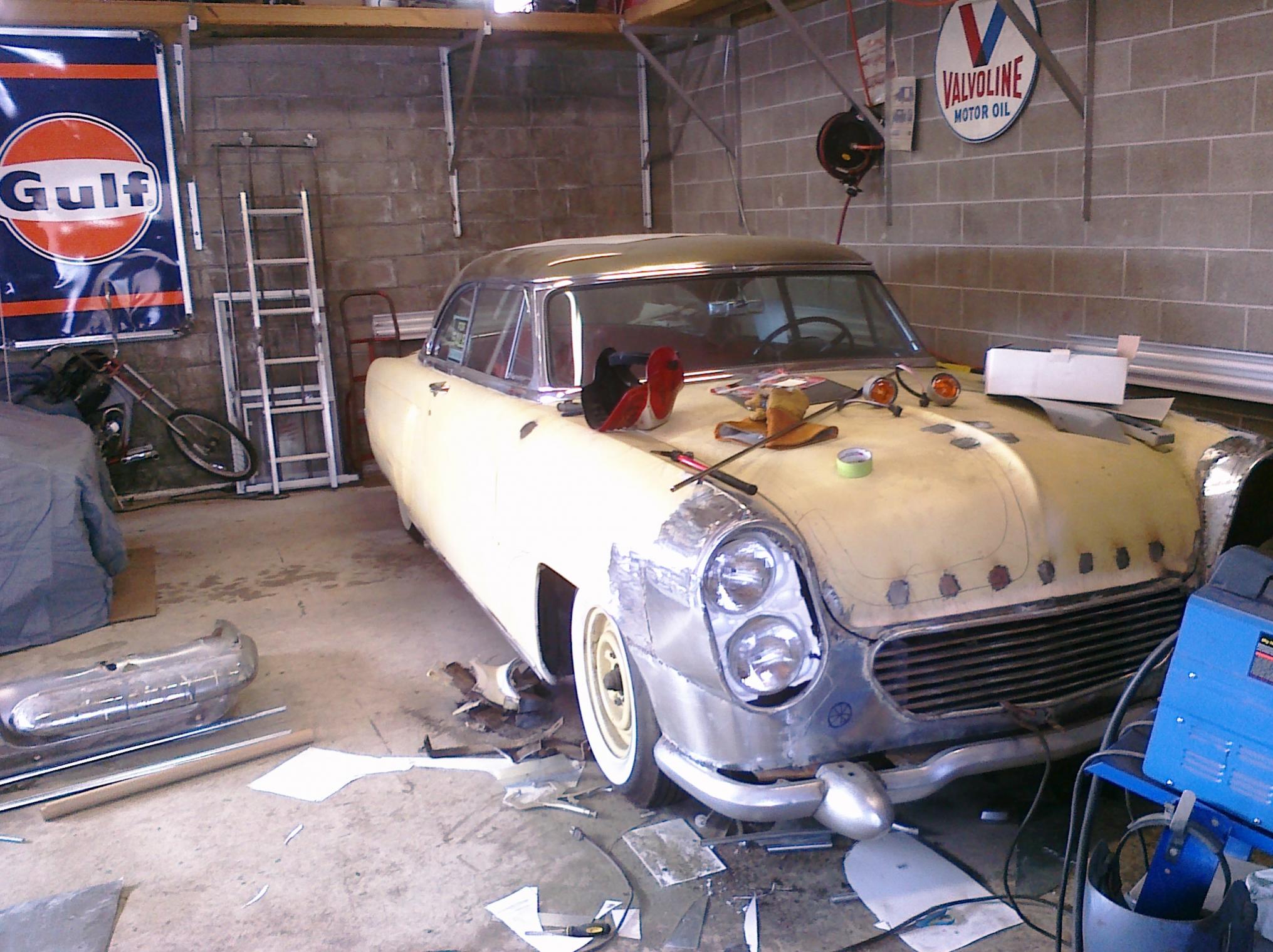

    A few quick mock-up pics of the lights to show the size of the openings.

    Hmmm..... lights do look a tad big. LOVE this style of custom tho'!

    -Cool build!!,maybe go without front bumper??
  22. LincolnLars
    Joined: Sep 21, 2010
    Posts: 17
    LincolnLars
    from Sweden
    I think the picture is a bit fooling,this is a big car,and I doubt that the headlights are as big irl as they seem in the pictures...??
  23. Jay-acerra
    Joined: May 9, 2007
    Posts: 57
    Jay-acerra
    from pa
    yes in the pics they look much bigger then in person
  24. moefuzz
    Joined: Jul 16, 2005
    Posts: 4,951
    moefuzz
    It defiantly looks better with the lights in there but just my humble opinion is that the headlights need to be recessed to give some depth of field/character.

    Are those 7" bulbs?? I can't really tell, but if they are, you might be inclined to use 5 3/4" bulbs and shrink the bezels down some...I think that would give it a tighter, crisper look...just thinking out loud...
  30. Jay-acerra
    Joined: May 9, 2007
    Posts: 57
    Jay-acerra
    from pa
    Yes they are 7 inch bulbs,the front bumper is the original center bar of the grill flipped upsidedown and shortend.
