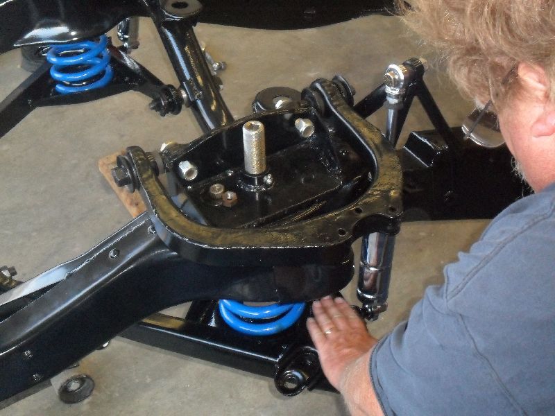

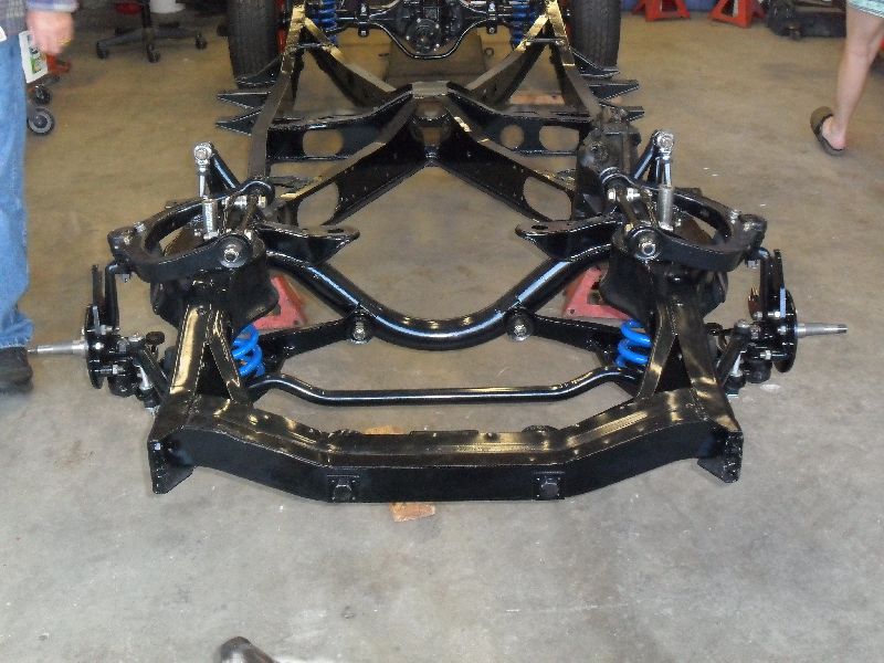

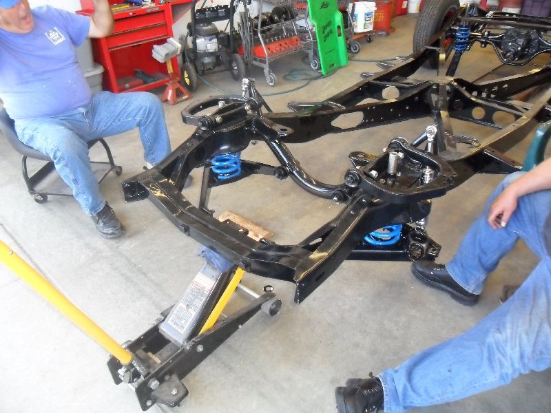

    Your English is perfect, no worrys. The arms are copys of Chevy truck arms from 60-72 I believe, pretty much the same as Nascar uses. I bought a complete kit, crossmembers, arms, springs, panhard bar from Hotrods to Hell in Northern California. Good luck, Mike.

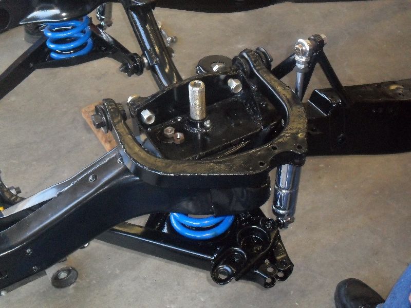

    cornernfool
    Heres some of the frame notch for the newer steering box and one of the box itself.
    kidcampbell71 likes this.

    Thanks! I was trying to find a powerbox that doesn't require a frame notch but I might have to go the same route as you.
