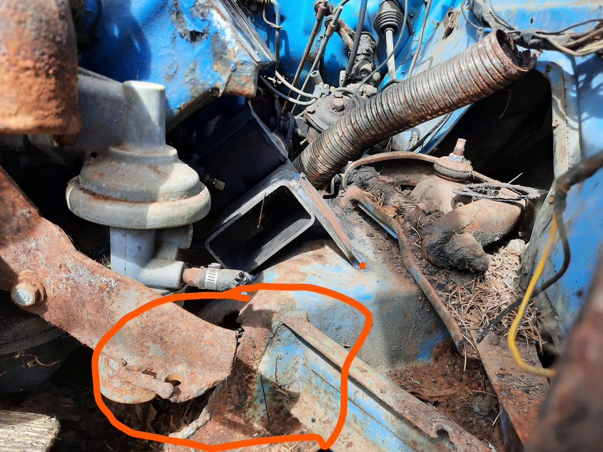

    Take another picture showing more of what is to the left of it. This is the same area in a '53 with a 302 using Butch's mounts. I would guess it's a piece cobbled in to use the y-block they had a part called a "steady rest" https://www.fordbarn.com/forum/showthread.php?p=1767306 Since 1953 fords still had the flat head. Butch's '53 swap.jpg

    the steady rest fit on front bolted to block at front behind crank pulley

    that is a bent, hurst style mount that used to be mounted to a crooked piece of angle iron!

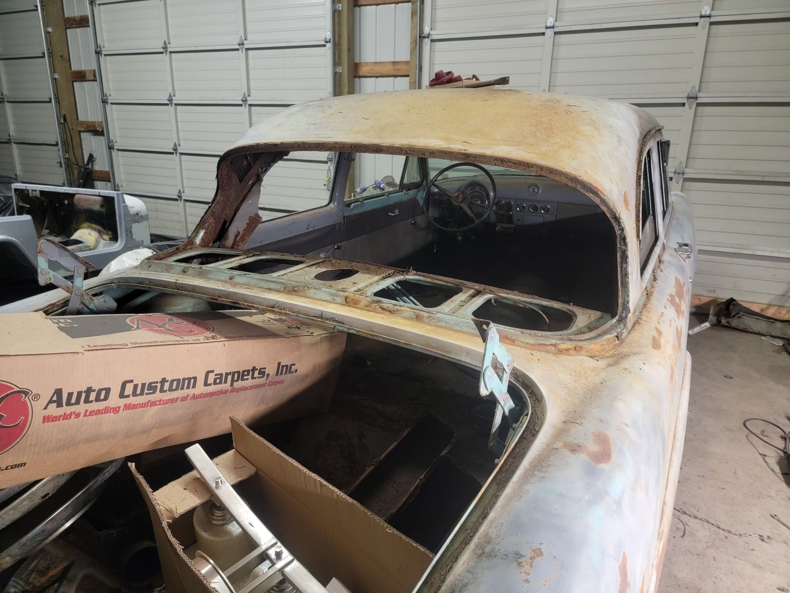

    Figured id go back and pull the back glass with my bud 20211105_165911.jpg 20211105_173211.jpg

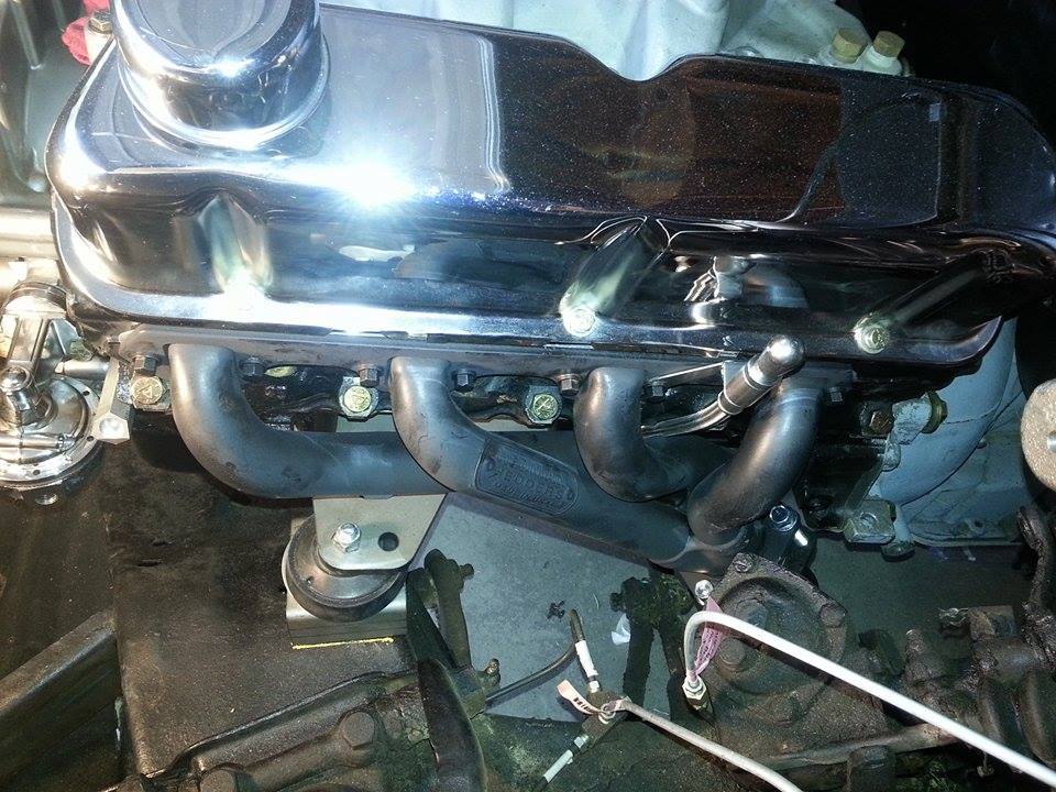

  23. That arm-burner exhaust has got to go.... LOLOL...

    The crossover pipe? Itll likely get headers at some point idk. At this point i am trying to get the floors,roof and rockers patched, painted, interior in, start run and drive and im handing the keys over to my pops. Was supposed to be an 80th birthday gift but i will be lucky to have it ready for his 81st christmas next month! It will still be a project when he gets it, just an easier one

    https://www.spotlitekustomaccessories.com/store/p8/Ford_Y_Block_Headers.html Company owner drives a '54 with a Y block. ;)

    From the Ford Shop Manual "the back glass has to be removed when installing a new headliner" so it's a good time to do that too.
    loudbang and oliver westlund like this.

    Mine had the steady rest. I pulled it off. It hit the core support
