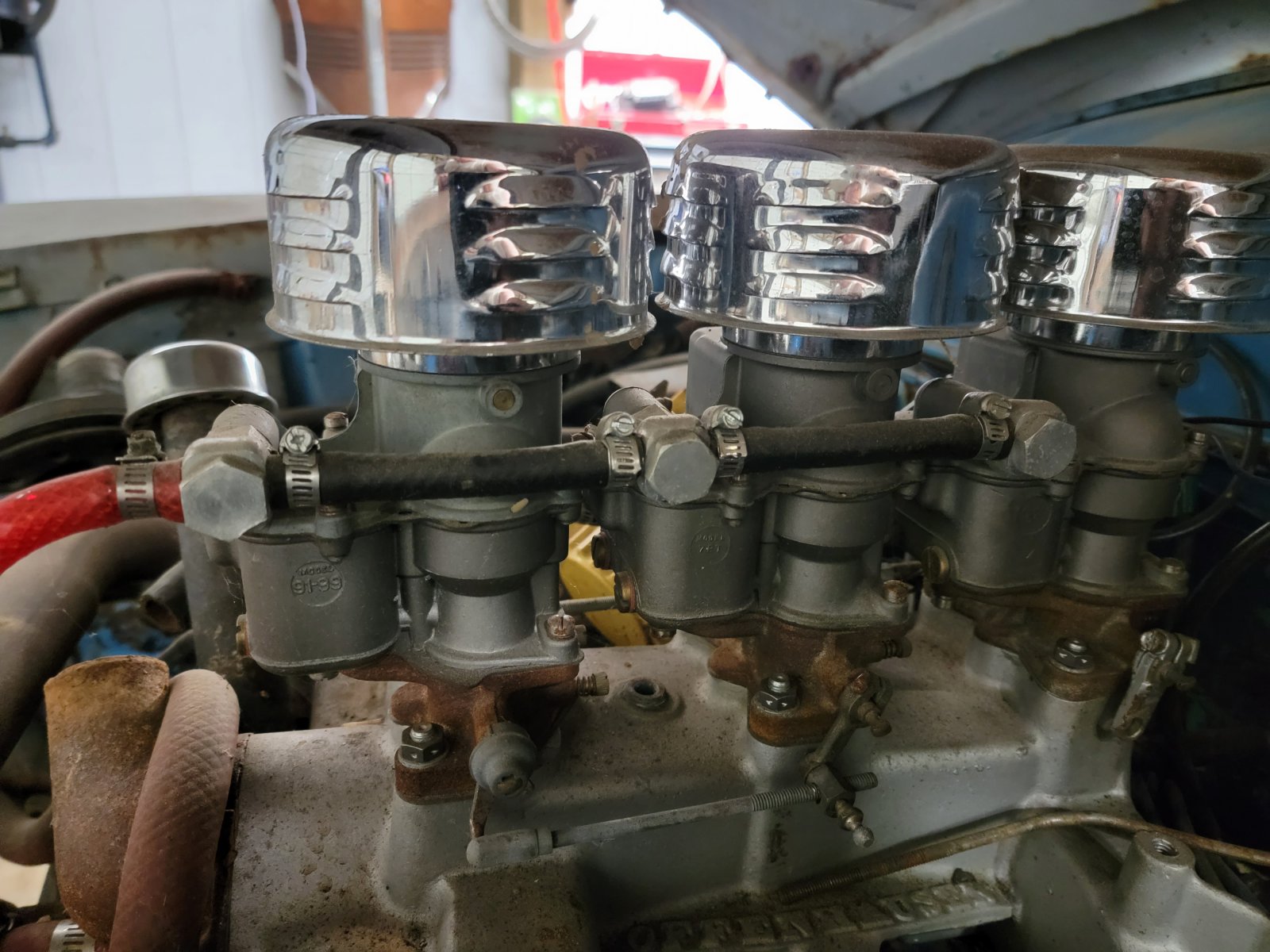

    I could be wrong...but wouldnt i be better off running a fuel metering block than this fuel line setup? Wont this setup leave a carb starved? Wide open i mean...which this will never be, just wondering 20220505_152121.jpg

    Looks like some good parts scores. I agree on the fuel block, what you have there currently is unlikely to give even fuel pressure to each carb.
