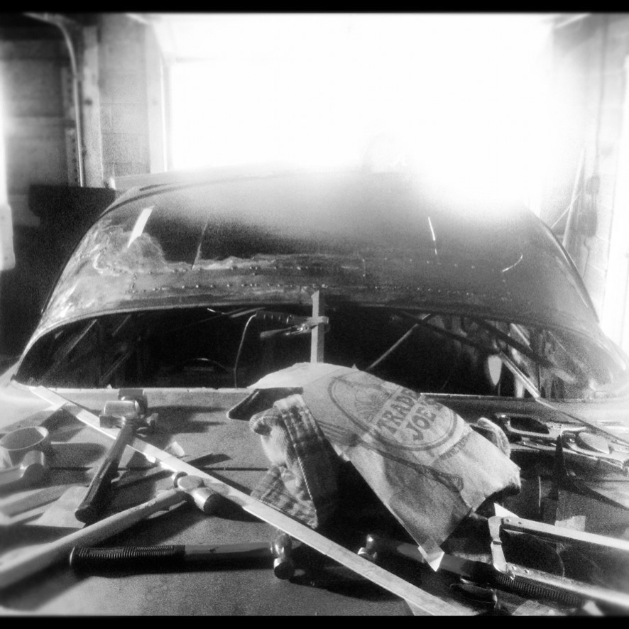

    The slant looks good. Two things that I'd suggest is radius the corners on the window frame at the rear of the door and the rear window needs a little work where the roof should flow to the trunk deck and the pillar should wrap around to meet that line with a radius in the corner to match all the other windows. Just my opinion.

    mrjynx ... thanks for the photoshop help once again ... in that last pic i posted the door is open gining the illusion of the window fame being off... but i think i figured out what to do from here... i will trim the rear window frame out and slope it forward lining it up with the trailing edge of the rear lip at that point making more relief cuts and some filler panels to get that nice slope from the roof to the trunk... as far as the b pillars... i will def slant them... after seeing some of the pics you guys posted im feeling a bit better about how to get this all dailed in... after some well needed rest and looking at it with fresh eyes before work this morning i cant wait to get going on it again... more to come thanks again keep it comin please

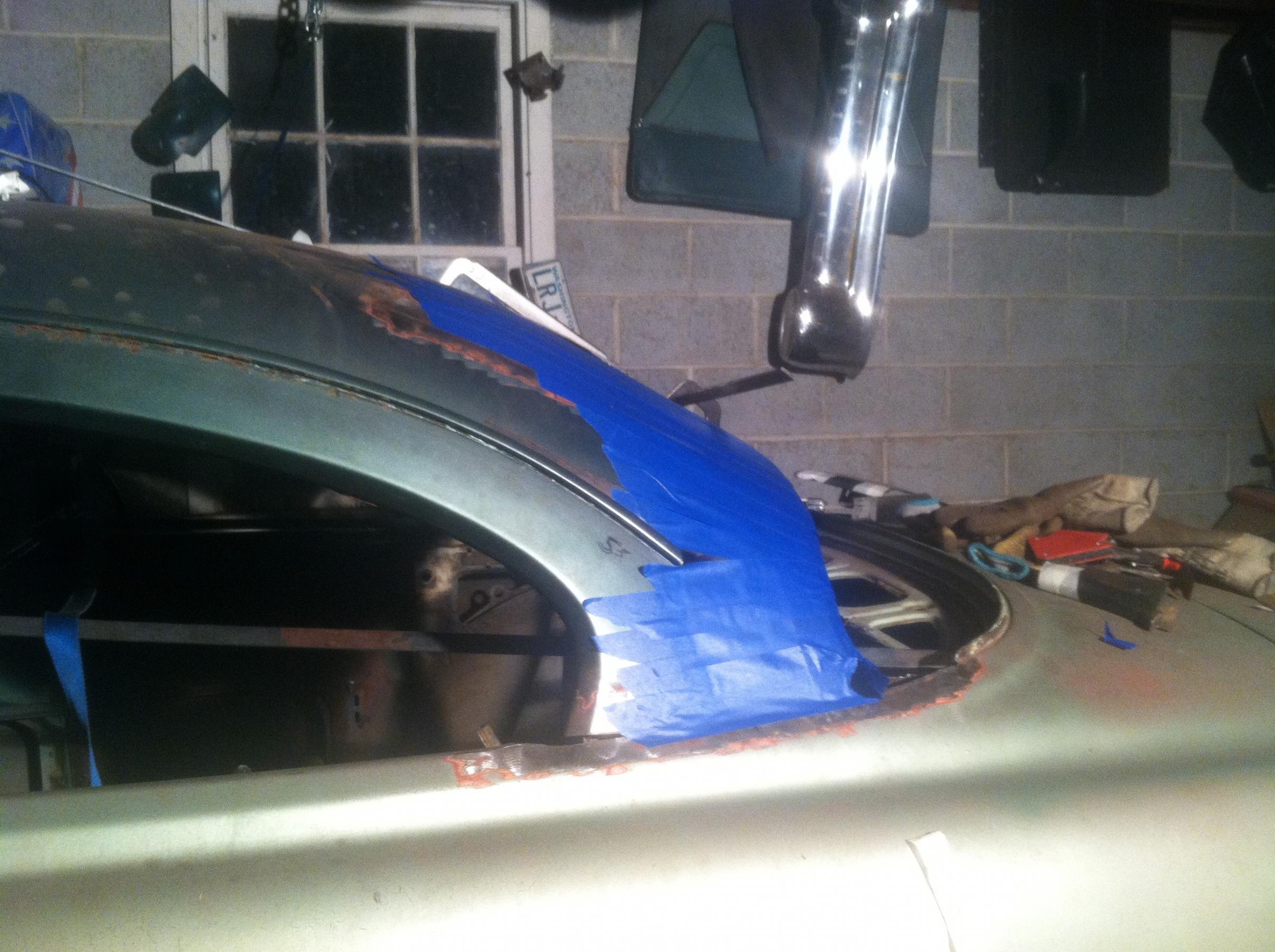

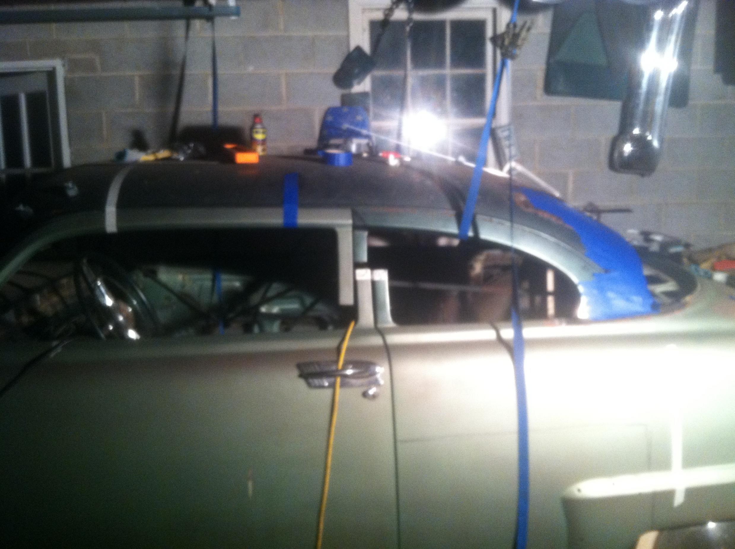

    So last night I started getting the rear window frame re fit and I took the existing frame move it down and back to match the slant on the new roofline and I think it looks pretty good I stuck some tape on there to kinda see the flow and to trace the filler patch areas still have to slant the b pillars but I taped the window frame pack in to check the flow I the window openings and I think when I slant the pillars it will have a nice shape complimenting the new roofline pics are kinda tight cause the garage is small

    You may have to use a dash mounted mirror to see out the rear window but it looks great. I could use some of your energy around my place. So many things to do and so little time.

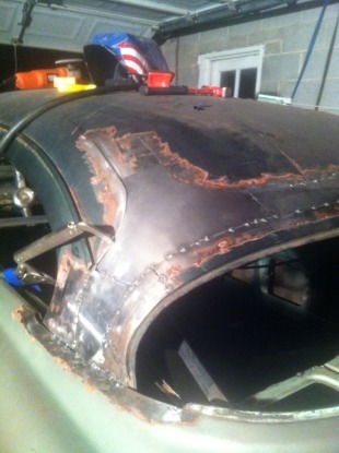

    Progress has been a little slow had to take a break after I got some laser tattoo removal which by the way hurts like hell but got some done today made the sail panel and got it mostly tacked in place ... A little more in this side then on the the other

    So the rear is finally all patched together and about 60% welded and I'm definatly gonna need a dash mounted rear view mirror but it's coming along next up slant the b pillars ... Any advise on doing that?
