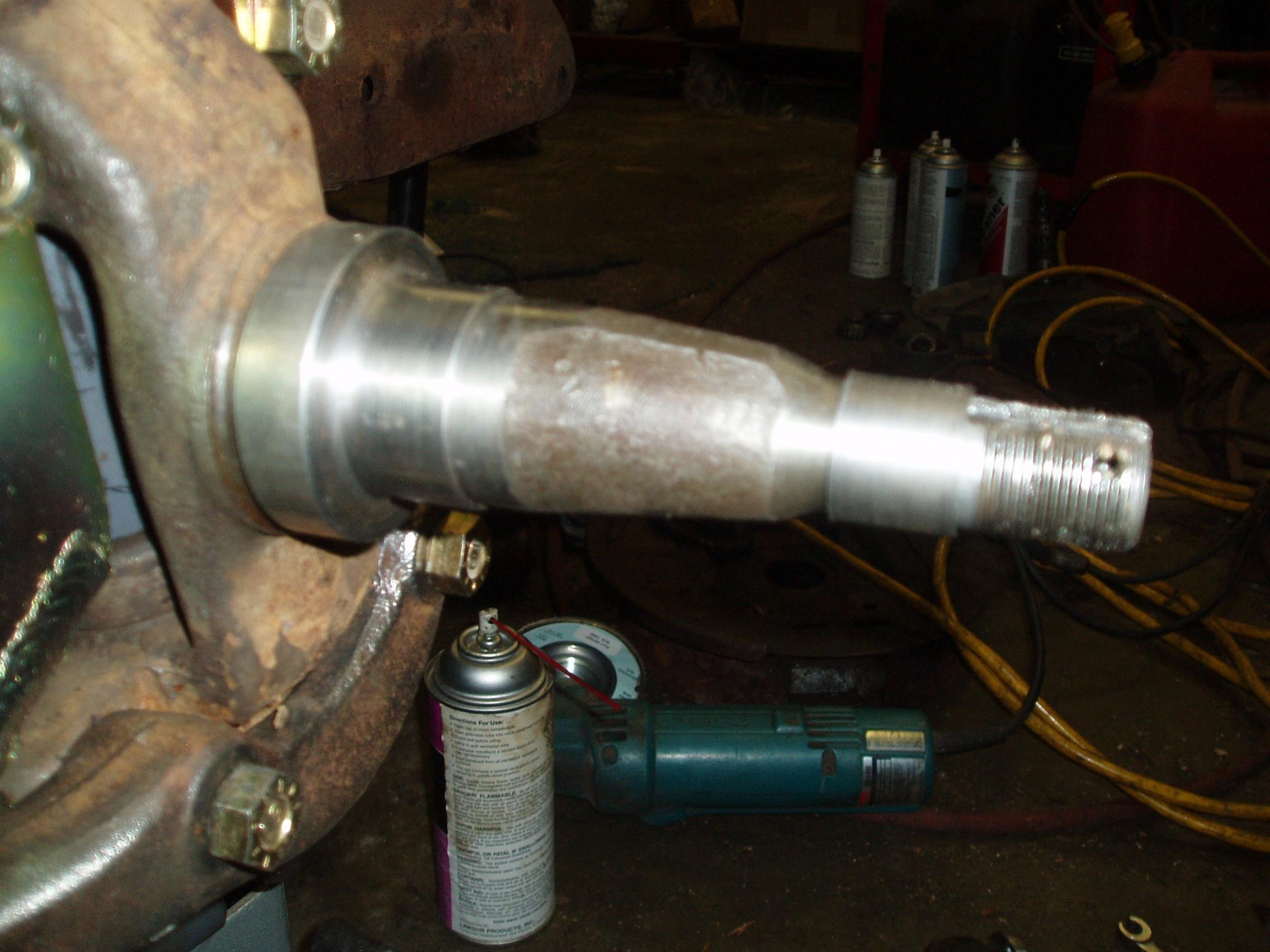

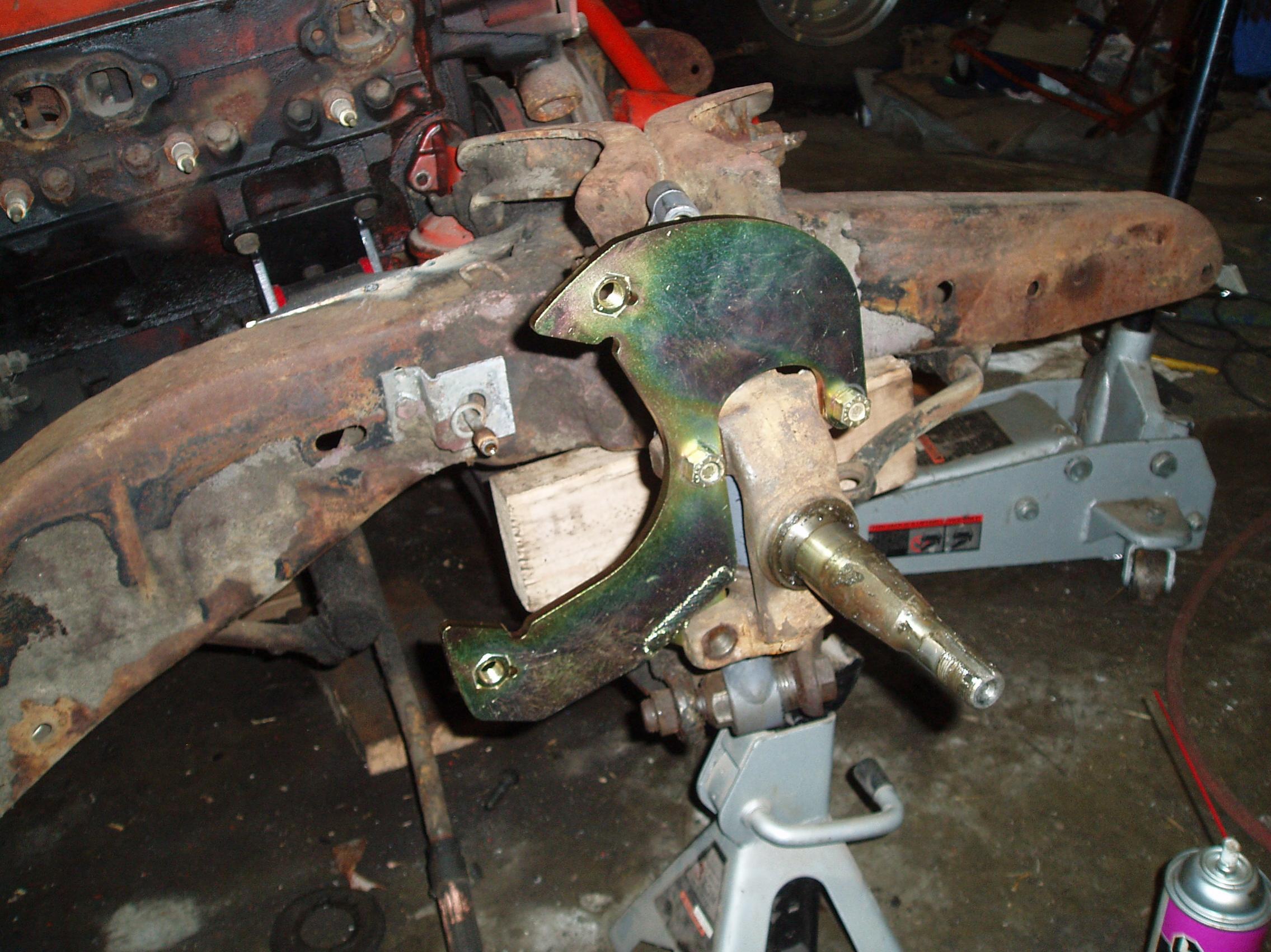

    I used the fatman droped uprights and the scarebird disk kit. I also bagged the stock setup. With the scarebird kit what you get is the caliper brackets and shims to run tapered roller bearings instead of the old ball bearings.(both sides) You also get a list of part numbers so you can go to the parts store and buy calipers, rotors, bearings, ect. Thats where the $350-$400 comes in. I would recomend them to anyone, total quality parts in my opinion. Here are some pics.

  29. cousin steve
    Joined: Aug 11, 2008
    Posts: 63
    cousin steve
    from Orting WA
    Ok gettin good shots is tough but...
