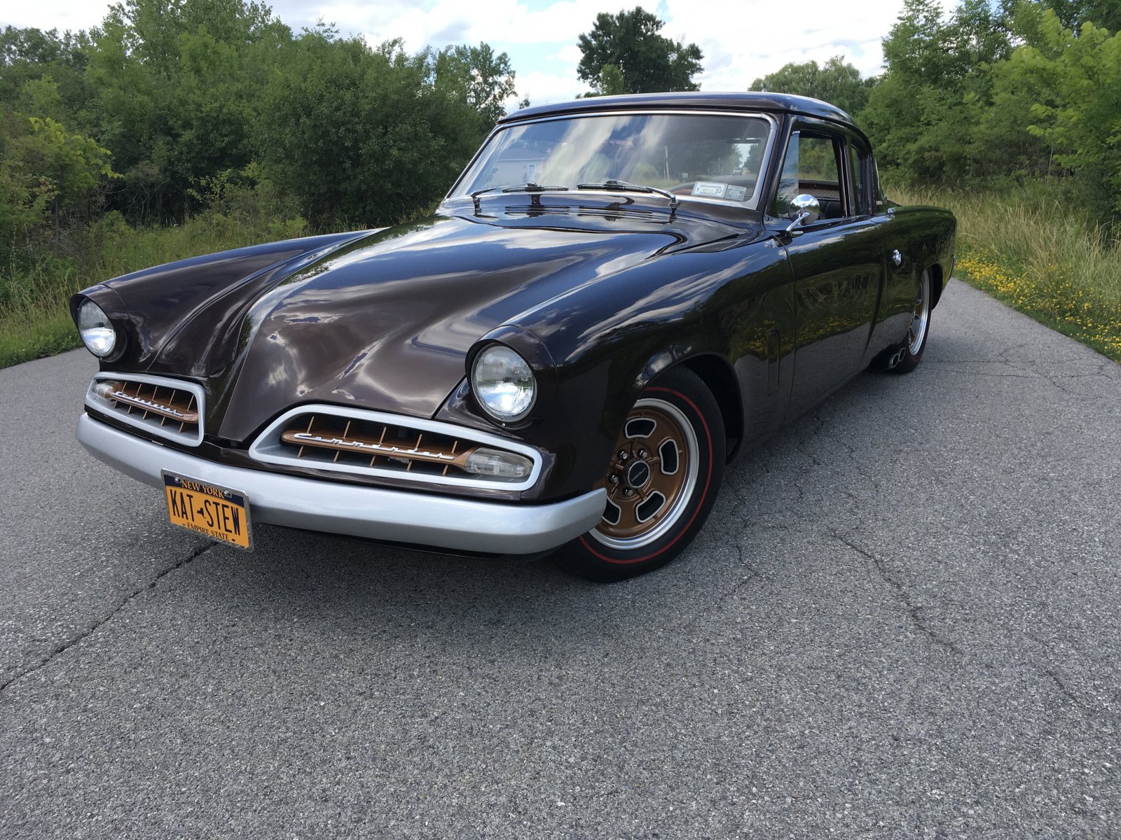

  11. Just finished a 54, great cars Cool looks and very expensive to get the right parts. Good chrome grill pieces could go well over a grand. A lot of Studebaker guys out there that are starting to downsize and if you luck out could buy what you need at a good price,.
    Careful on fenders if replacing 56-63 fenders look like they will work and they will with some work on the Radiator support Area ( Later models had different hood and Rad was pushed forward.
    Rocker panels some are wide open others have reinforcements and if you upgrade to late model its expensive but really worth it on a hardtop.
    Trunk lid may be an issue to find a good one.
    Get it at your Best price and its yours 0F433905-A155-4C30-B226-530D15B209A0.jpeg
