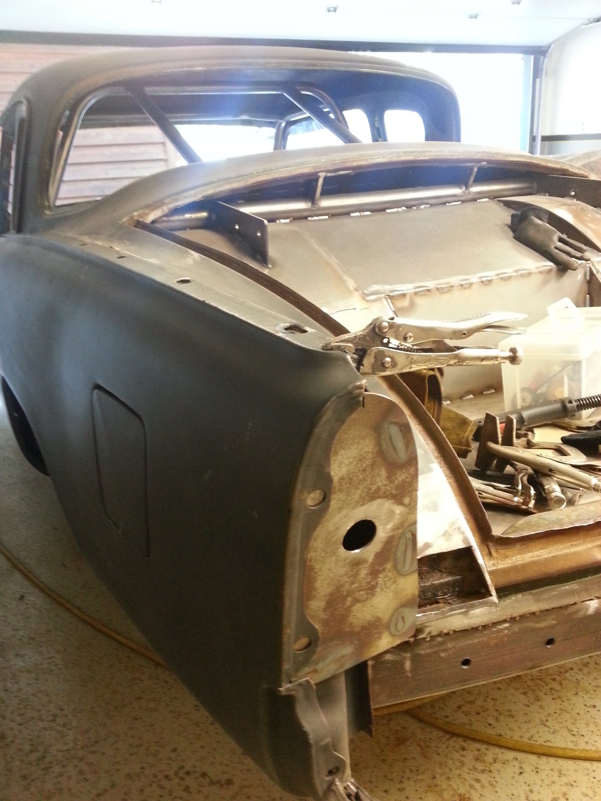

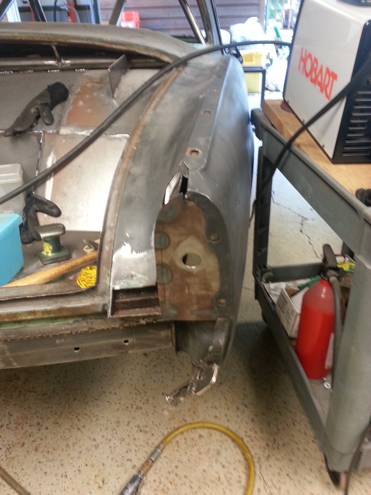

  12. 53studecoupe
    Joined: Nov 25, 2010
    Posts: 379
    53studecoupe
    from Eagle WI
    20150906_171304.jpg 20140831_164359.jpg 20140831_164418.jpg The taillights were rotted out because they are exposed to the rear quarter wheel wells by rubber stips that held water and debris. I replaced them with some 14ga steel and weldnuts that the taillights can bolt to.
