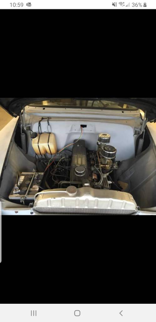

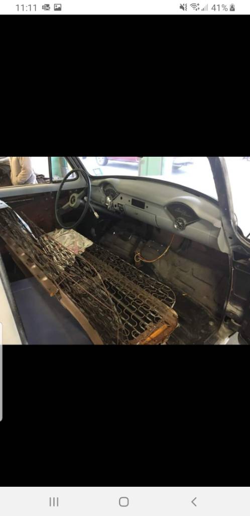

    Said he pulled the 235 because it was locked up and he had a rebuilt 216 he put in it. Also he put a 55 dash but has the 54 to go with it Screenshot_20200321-225944_Facebook.jpeg

    s-l1600.jpg o.k. so the windshield and back gl*** have 150 weatherstrip. It is still a 210 back gl***. I did it to mine. wanted to shave some of the trim. I also filled where the trim was in the corners. The motor looks like a 216 valve cover. There will be a side cover on the dist. side. If it goes around the plugs , it is a 216.

    Only the ‘53 150 had the small back window (however rumor has it there are a very few early ‘54’s that had them). The ‘54 150 had the same rear window as the sedans. This car has no windshield trim which would say ‘54 but who knows- the gaskets with and without are interchangeable (not all models use the same windshield though!) Some differences in the dashes would be stainless discs on the gauges, radio delete in the 150’s, directional arrows- white in 53, green in 54, etc... I think there is a thread here somewhere with a list of the differences between years.

    Looks good ,a lot of work done. those dashes don't bolt in. What's your plan for car?

    That's o.k. I'm not wanting to argue, just never saw one. It's probably a 54 . They would have to change bumper brackets on the front to get bumper to bolt up. They smoothed the firewall . The 216 is going backwards but if you have it i guess might as well use it. A 54 or newer 235 would have been better choice.

    In terms of upholstery I'm aware it's a 55 dash
